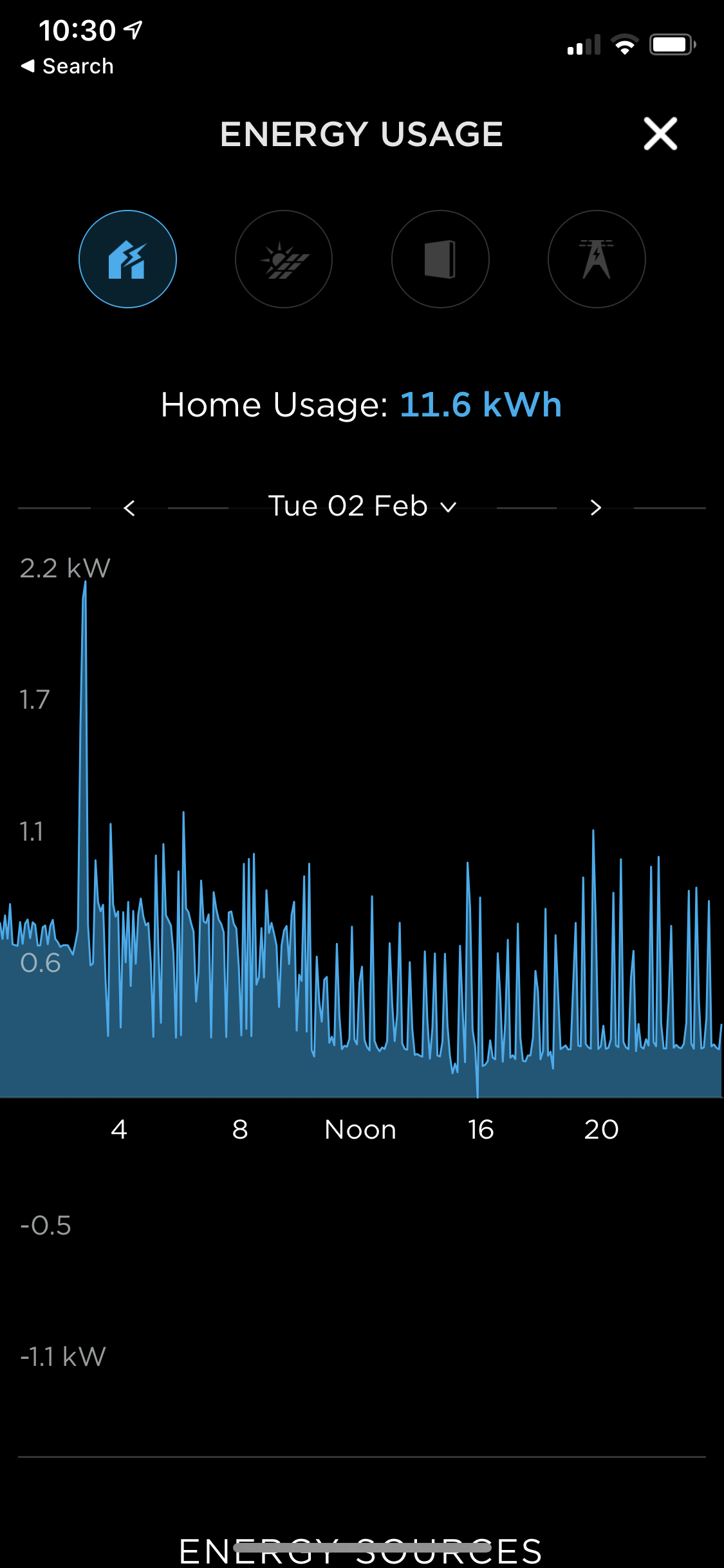

Pocster Posted February 4, 2021 Author Posted February 4, 2021 Got my HA code running . Heating for entire above ground if temp drops below 17c then off at 18c I deliberately did a tight range . Heating came on just after midnight , turned off just after 9am . So effectively I ‘leaked’ 1 degree in 9 hours ( outside temp now around 7c ) Electric consumption for yesterday was around 12kwh . Although not a particularly scientific test - that seems pretty good too me

Pocster Posted February 4, 2021 Author Posted February 4, 2021 9 minutes ago, SteamyTea said: Nor scientific notation. kWh. Or is it a Mac thing. As reported by Tesla app And of course is a recognised unit https://en.m.wikipedia.org/wiki/Kilowatt-hour
