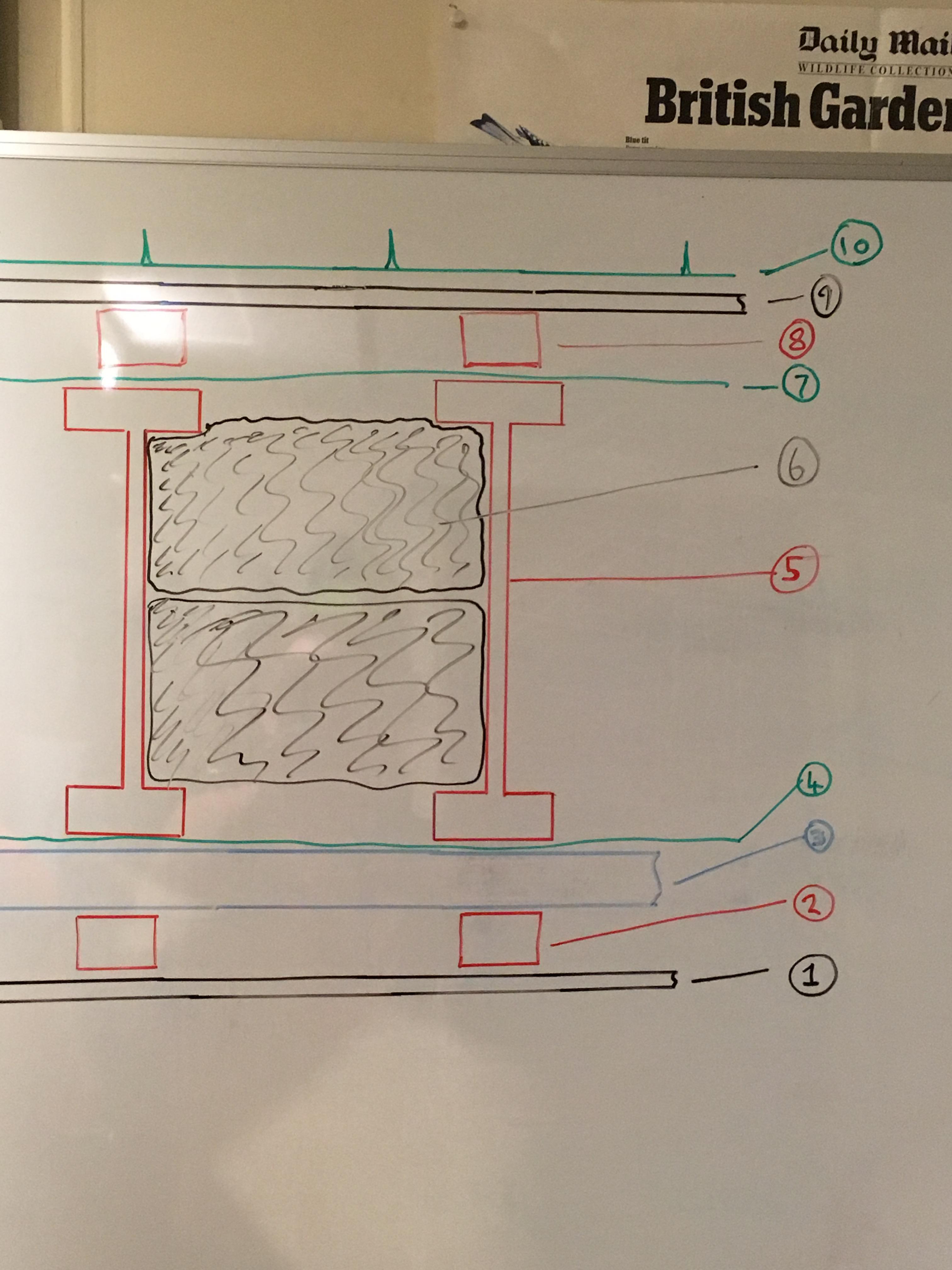

i did this on my icf house
1. Plasterboard
2.service batten
3.pir insulation taped at all joints and sealed to walls
4.was going to be vcl but left this out as I used the pir board to do this.
5.i joist.
6.knauf Omni fit insulation
7.breather membrane
8.counter batten
9.sarking boards- battens
10. Roof covering.
This could all all change depending on your roof buildup
mine is all vaulted.
Be aware of what you will do with ductwork I have had a bit of a drama planning where to put it as I started building before it had all been finalised.

What U or R value have you achieved with this detail?
Is there a reason you used PIR insulation over the foil quilt for the thermal bridging?
What depth are those I beams, What thickness of Omni fit have you got?

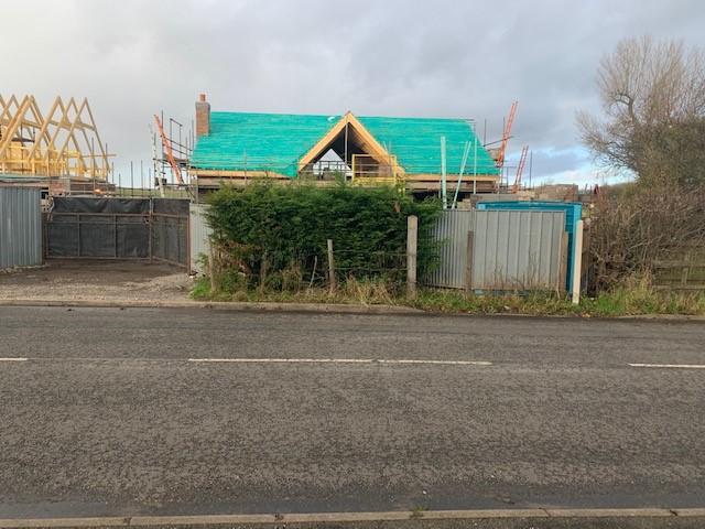

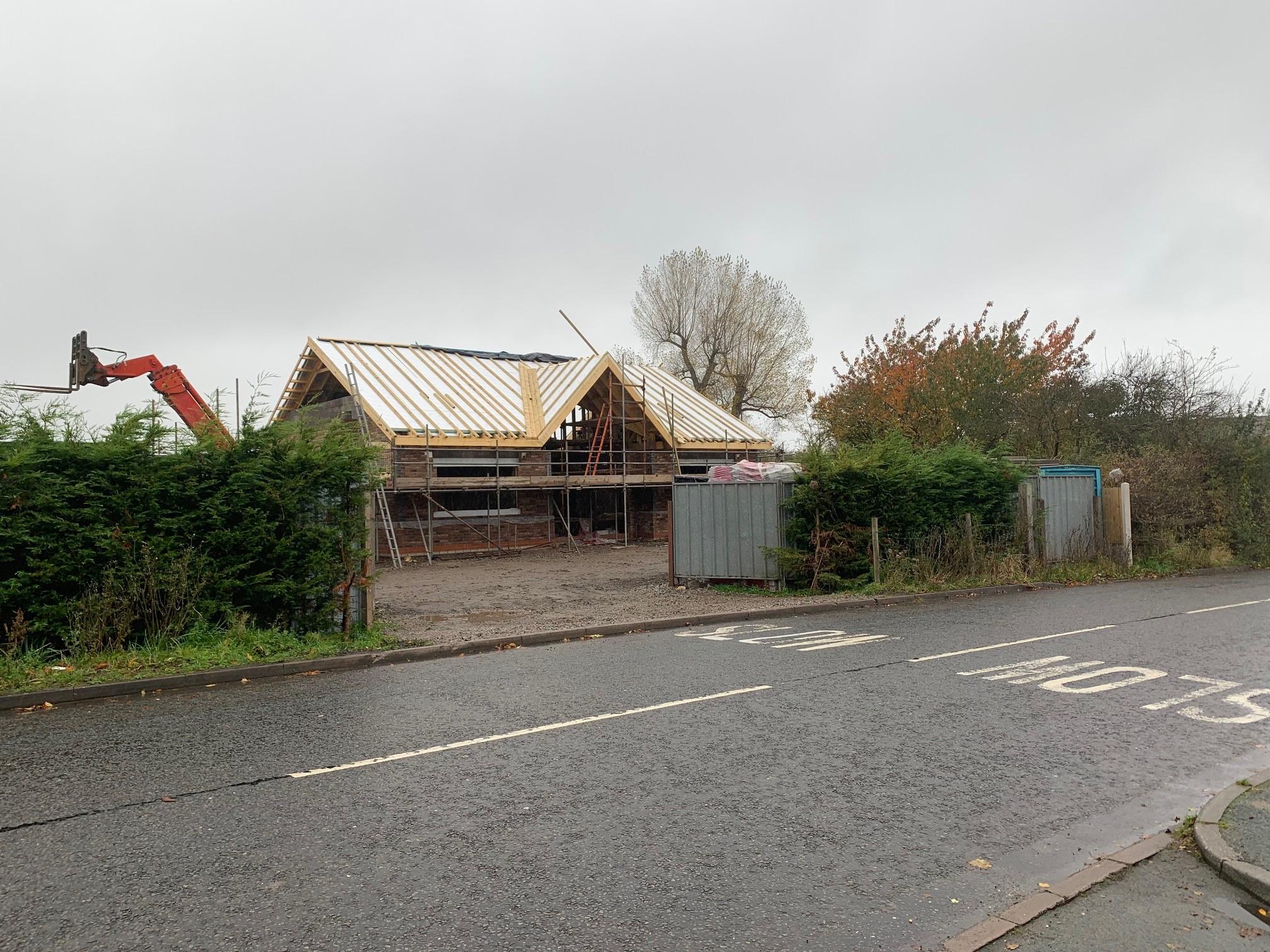

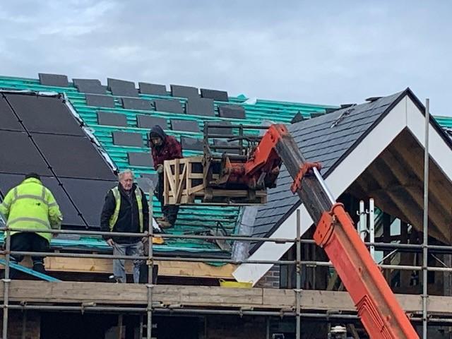

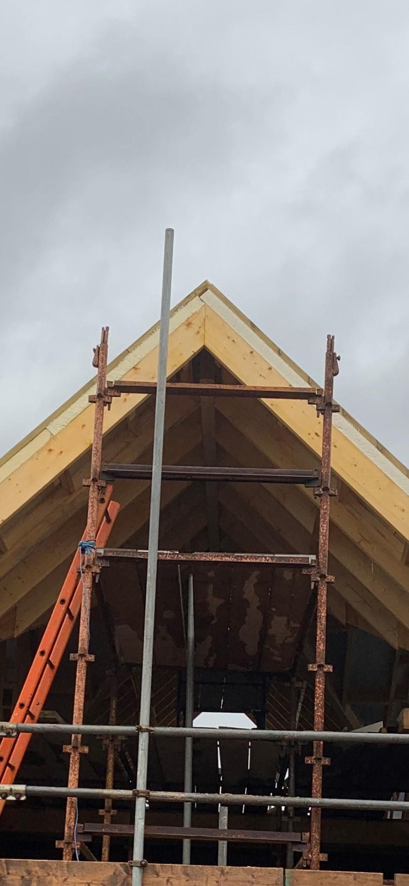

Here's mine

Cannot remember the u value, too long ago.
I beam 225
dont like the quilt stuff
insulation 200
ductwork MVHR

U value 0.18,  slate finish, 3x2 battens on top of rafters using 180mm stainless fixings at 300mm spacing,120mm of  Xtratherm, dry vented ridge.
I believe for a given thickness it offers a lower U value as you have the whole face of the rafter insulated as well.

Johnny is this the detail in the photo? It looks to me like your PIR is directly ontop of rafters

PIR 120mm is on top of rafter secured down by 3 x 2 tanalised timber fixed with 180mm stainless fixing through tanailsed timber and PIR into rafter.
This is then has roofsheold membrane the cross battened for slate
