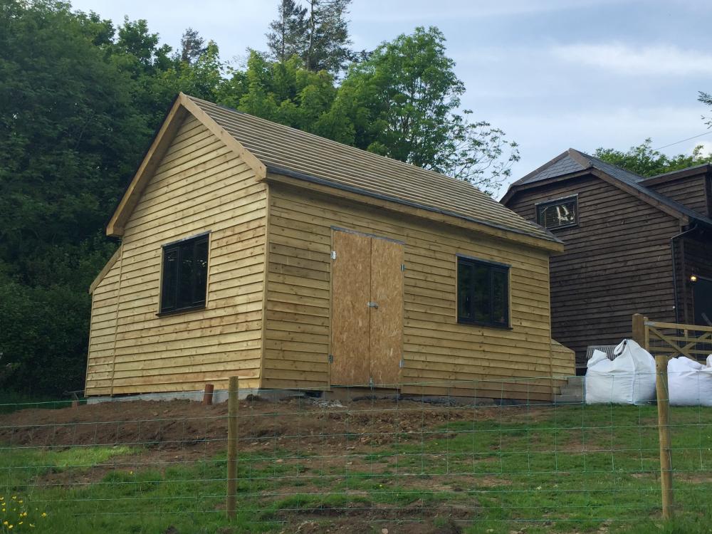

Barney12 Posted January 30, 2017 Share Posted January 30, 2017 2 hours ago, Ferdinand said: If I recall correcttly (please shoot me down @Barney12 if I am suffering from a vivid imagination), Barney's Bat Hotel is the leading operator in the 5* segment of the Pipistrelle Holiday Market. Think Soho House for bats. 1.8m head room. Own private entrance. House cleaning provided annually. And so on. I really wish it was a vivid imagination.! Yes, that cost includes: 1. Ecology surveys (multiple) 2. Mitigation planning and the various reports 3. The costs associated with soft stripping (I.e. remove each roof tile one by one) and catching each and every bat and moving them to their new home. 4. An approximate "over" cost of the workshop with its various roost provisions etc. The best bit............. .............They only stayed one night and none have ever been seen again Here is a more recent picture Link to comment Share on other sites More sharing options...
