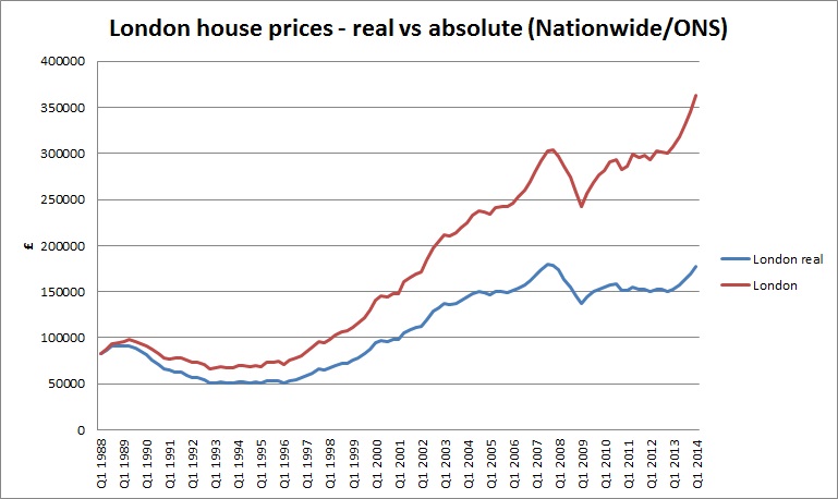

Even in London, fluctuations are rather less than the wibbling attention-seeking people who need to sell newspapers or keep their support-bases in palpitations keep telling us.
This is (RPI I think) inflation adjusted 1988 to 2014 The biggest fluctuation in London was a plus and minus 10-15% in 2 years after the Brown bust.
From
http://www.newstatesman.com/politics/2014/04/five-signs-london-property-bubble-reaching-unsustainable-proportions
(The original article is imo rather fanciful.)

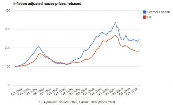

And here is one from the FT - also London:
https://ftalphaville.ft.com/2013/10/15/1666322/wait-what-the-enormous-unnoticed-collapse-in-london-property-prices/
(A much better article)
