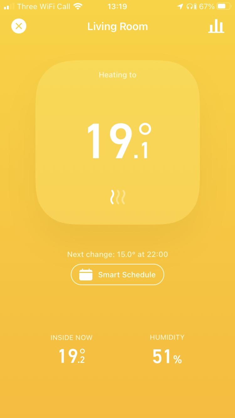

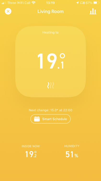

PeterW Posted December 26, 2020 Share Posted December 26, 2020 @joe90 what do you call “high” internal RH..? Running the same HEx as you - so no drain - and seems to sit at 58-62% Link to comment Share on other sites More sharing options...
joe90 Posted December 26, 2020 Share Posted December 26, 2020 3 minutes ago, PeterW said: @joe90 what do you call “high” internal RH..? Running the same HEx as you - so no drain - and seems to sit at 58-62% just popped upstairs and it’s 74% (on a very cheap Chinese thingy), conservatory (non heated and ventilated) is at 85%. Link to comment Share on other sites More sharing options...
