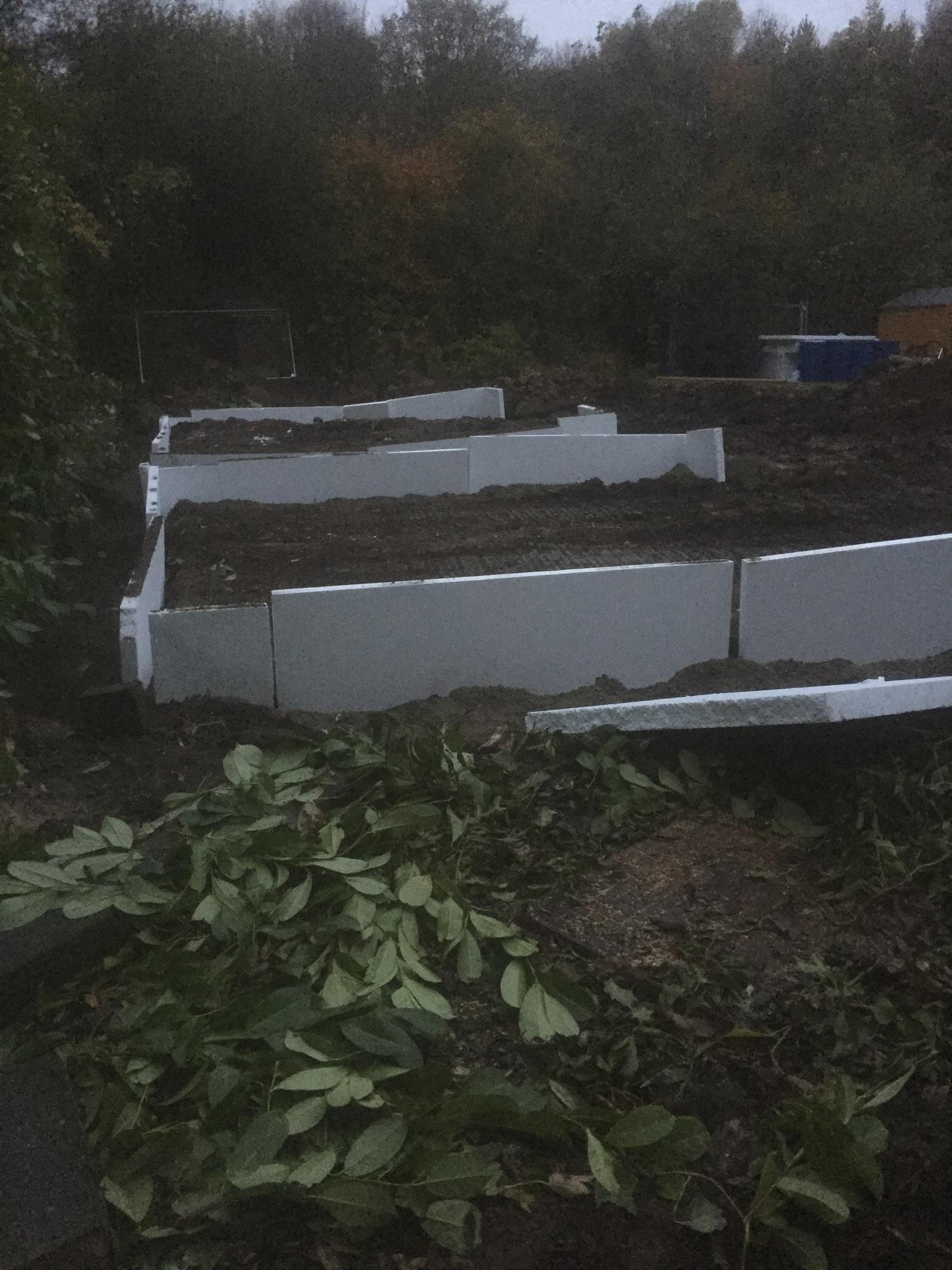

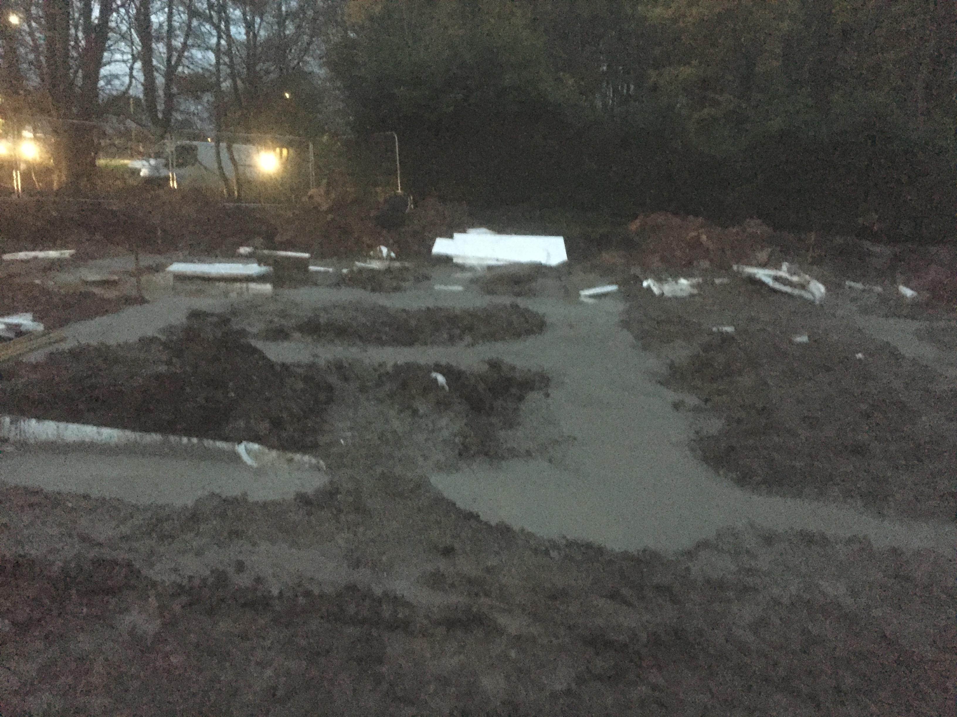

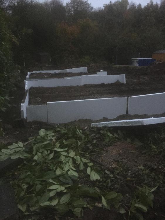

nod Posted December 22, 2020 Share Posted December 22, 2020 (edited) 1 hour ago, brickierob1 said: Hi everyone, I'm wondering the answer to the above question in regards to a rear extension, which is 1200mm deep by 800mm wide. I'm looking for a definitive answer, but I'm unsure there is one. Is their any factors that would contribute to the answer. Many thanks I filled our flush 1800 deep It’s a toss up between the extra concrete used and the amount of brickwork and Labour you save Edited December 22, 2020 by nod Link to comment Share on other sites More sharing options...
