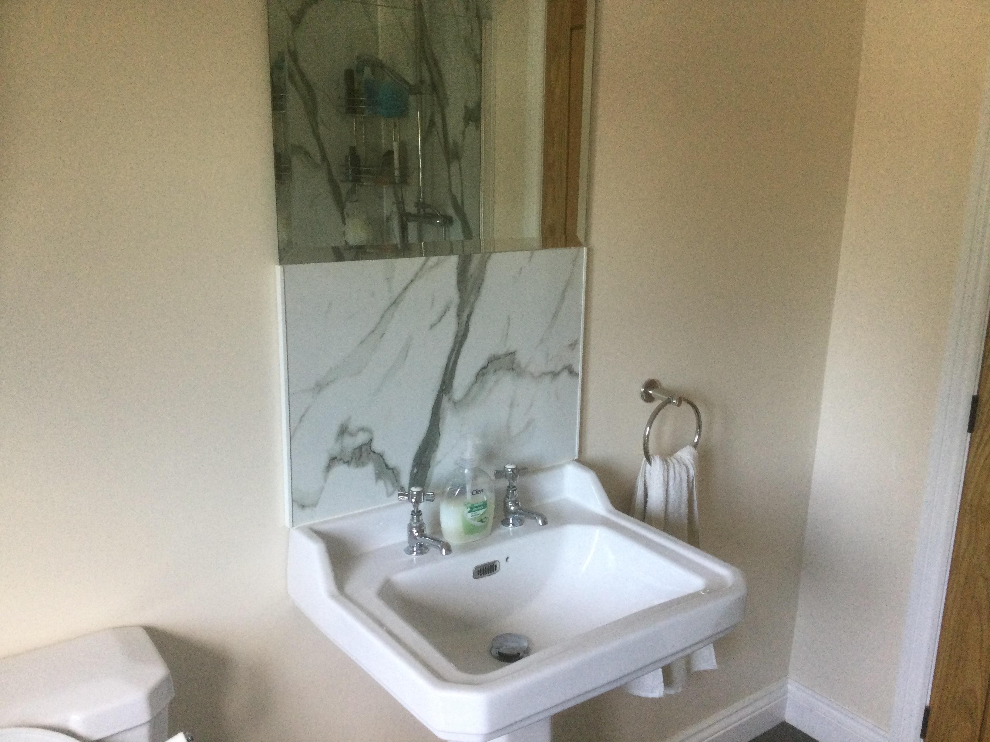

canalsiderenovation Posted November 27, 2020 Author Share Posted November 27, 2020 11 minutes ago, joe90 said: ditto, we also have LVT and skirting (painted well and sealed to the floor) ? Do you have it above your sink as a sort of splashback. We weren't going to but we have some left so were thinking about it but I'm not sure about how this would look with the trims/end caps. Link to comment Share on other sites More sharing options...
joe90 Posted November 27, 2020 Share Posted November 27, 2020 (edited) Yes, works well IMO (you can see the shower reflection in the mirror) Edited November 27, 2020 by joe90 Link to comment Share on other sites More sharing options...
canalsiderenovation Posted November 27, 2020 Author Share Posted November 27, 2020 1 hour ago, joe90 said: Yes, works well IMO (you can see the shower reflection in the mirror) Do you have any trim on the top or is your mirror flush? I can see the sides but what edging would we put on the top? Link to comment Share on other sites More sharing options...

joe90 Posted November 27, 2020 Share Posted November 27, 2020 1 hour ago, canalsiderenovation said: Do you have any trim on the top or is your mirror flush? I can see the sides but what edging would we put on the top? I packed the mirror out so it’s flush with the splash back and had it made the same width, the same edging as the sides would do I suppose. It’s just edging trim. Link to comment Share on other sites More sharing options...
