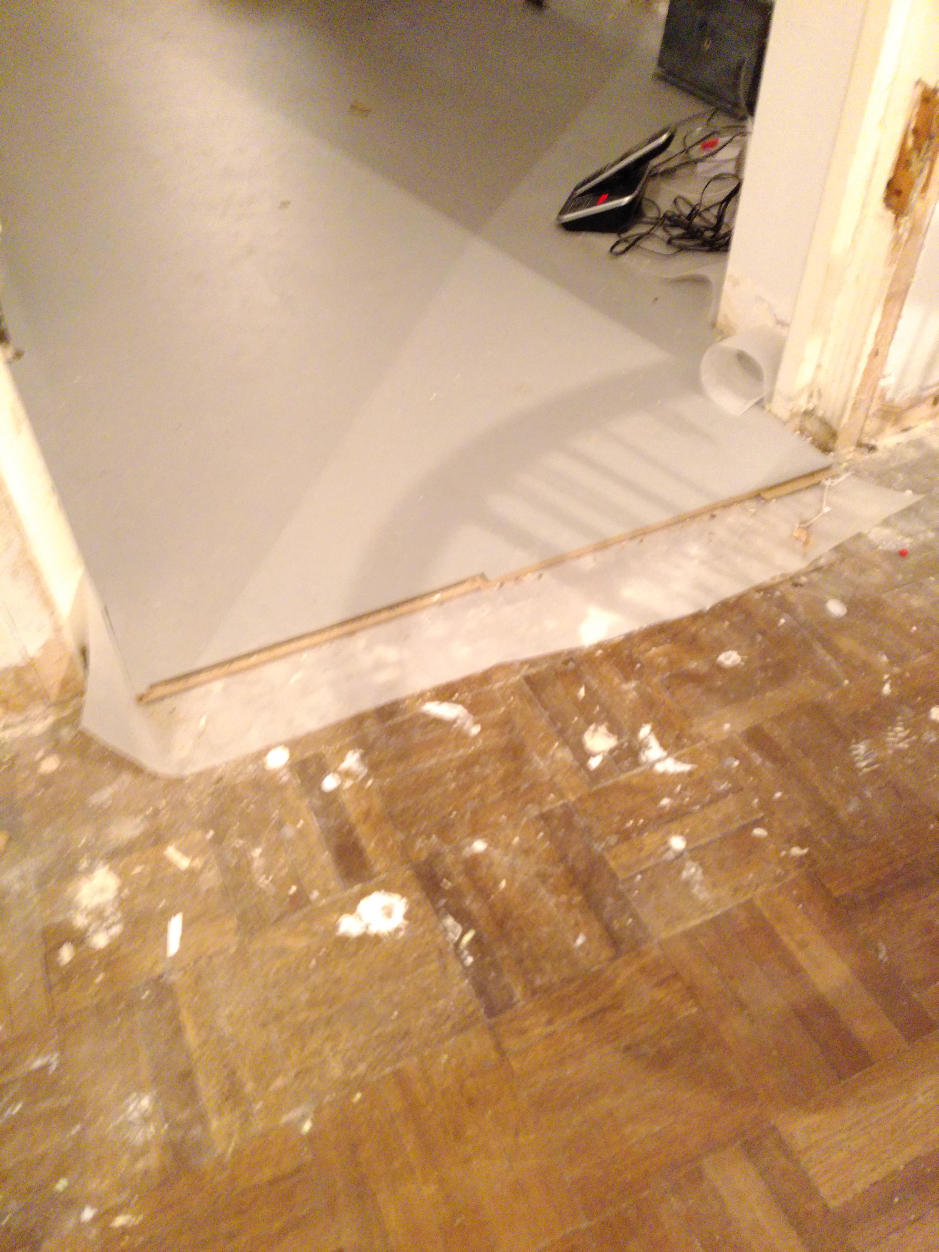

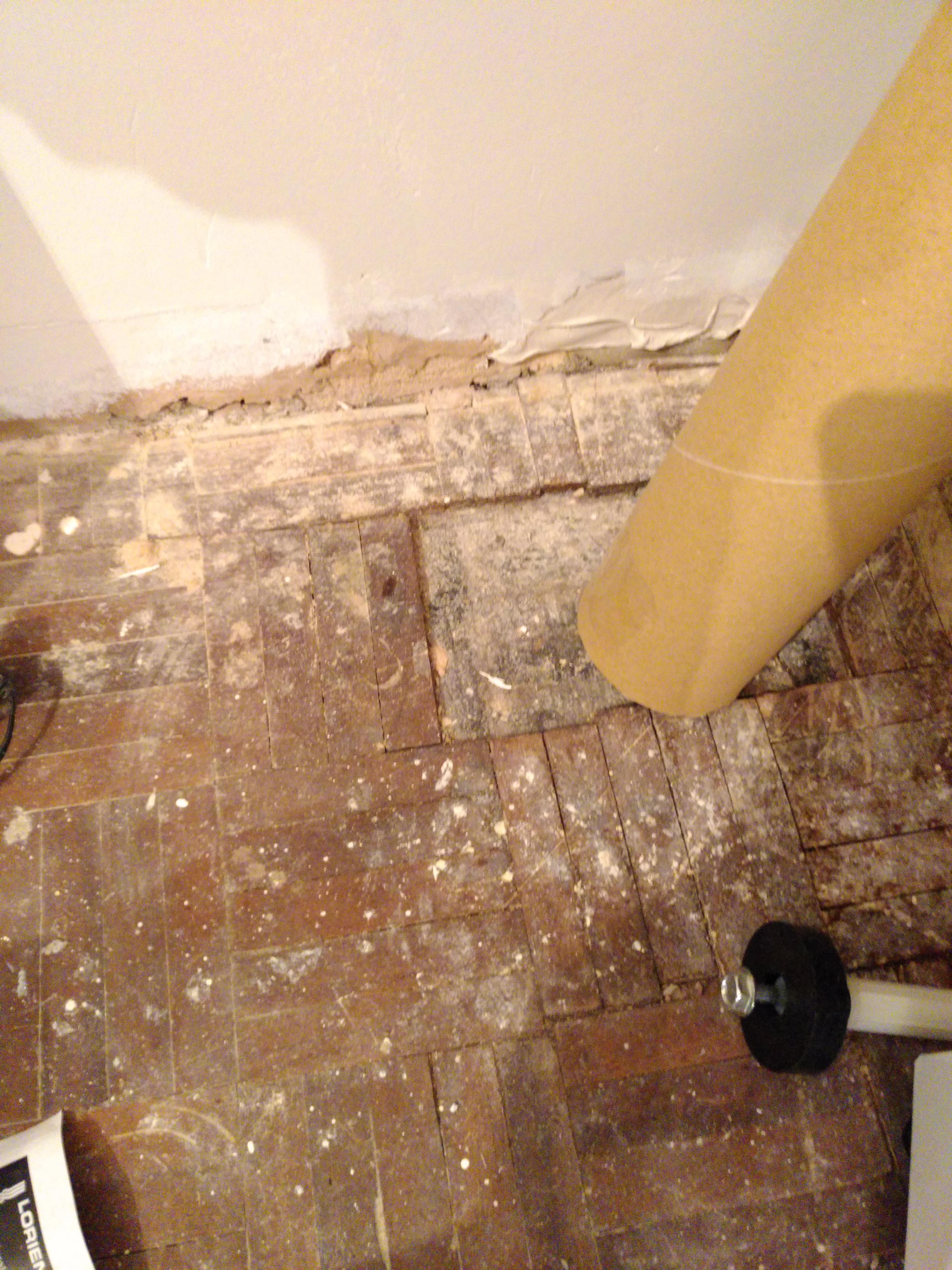

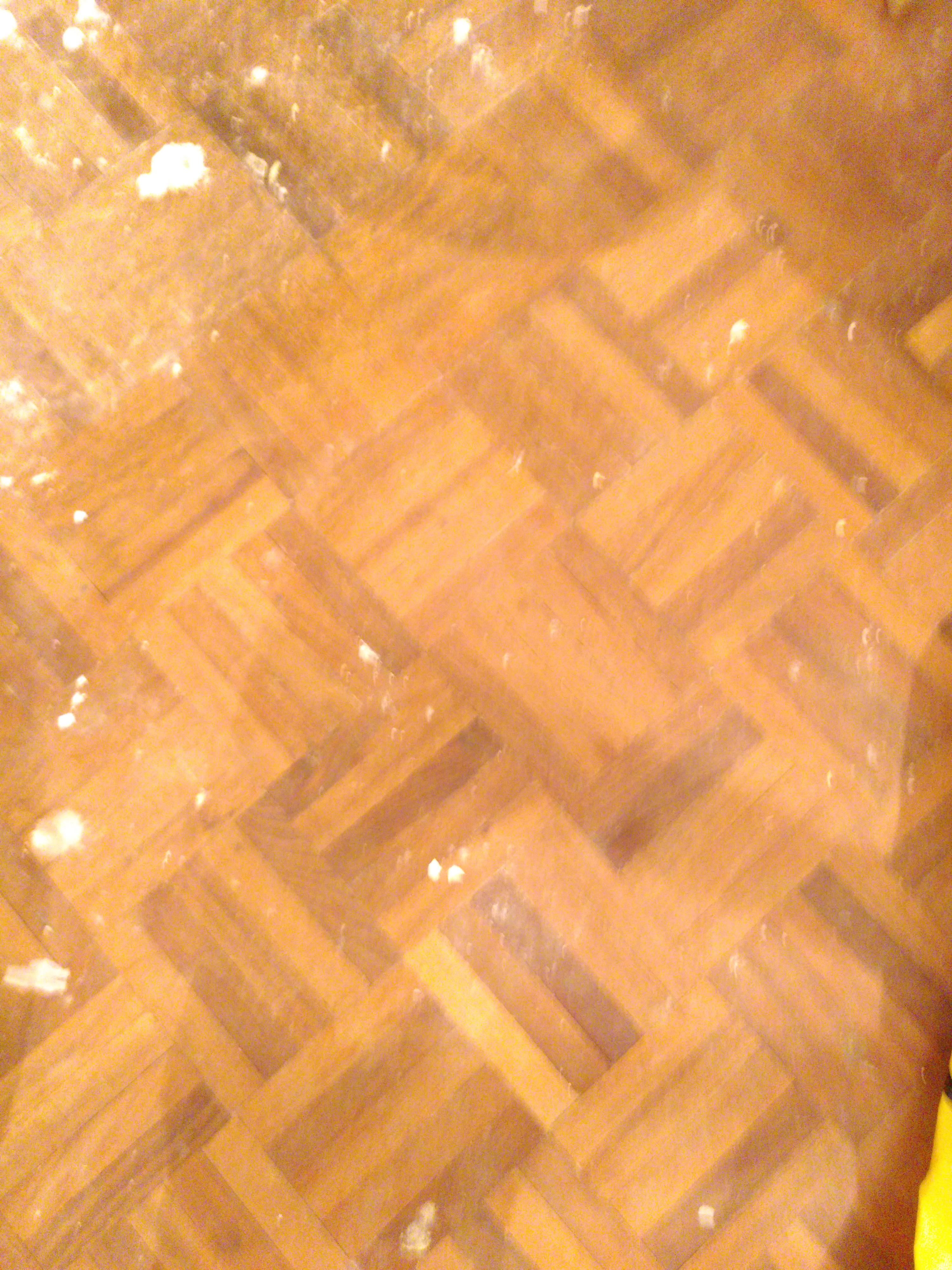

jamesgreenuk Posted November 26, 2020 Posted November 26, 2020 Hello, I'm after some guidance on how best to proceed renovating some nice parquet flooring. My goal is to get the parquet flush with the Forbo layed in the hallway and restore it to a great condition. The build up is concrete with what looks like a bitumen adhesive. Wondering if I lift the floor and pour screed or can build up by laying chipboard at the necessary thickness then re adhere the parquet, sanding, filing then finish. I've attached a couple photos and thanks in advance! James

jamesgreenuk Posted November 27, 2020 Author Posted November 27, 2020 13 hours ago, bassanclan said: How many tiles are loose? Quite a few are loose. 1/10 perhaps. Not adverse to a large project just curious to know what the best approach would be to achieving a level finish across all floor finished. Many thanks, James
markc Posted November 27, 2020 Posted November 27, 2020 cleaning the bitumen off is the hardest part, the pieces usually lift up with bits of stone or concrete attached that all need cleaning off. Sadly bitumen does not go well through woodwork machines so planing is out of the question.

PeterW Posted November 27, 2020 Posted November 27, 2020 I’ve just laid 20 sqm of 100 year old parquet and removed the bitumen off the back with a Triton Bench Planer - it trashed a set of blades but was worth it. You have to use a solvent based adhesive like Lecol 5500 or Sikabond but it lays ok. Mine was T&G so had to be cleaned all sides which made it harder. With the modern solvent adhesives you don’t have to remove all the bitumen but it does smell a bit when it’s being laid.

jamesgreenuk Posted November 27, 2020 Author Posted November 27, 2020 Thanks everyone. It has made me think carefully before I take this job on. In an effort to get the Forbo Marmoleum and Parquet level. (Forbo is 6-5mm Higher) Would grinding the concrete on a gradient towards the parquet be more advisable than raising the parquet? Thanks again for all the comments.

jfb Posted November 28, 2020 Posted November 28, 2020 Much easier to cope with the height difference at the threshold. Could put a wooden strip across on a slight tilt. I think it would be madness to try to raise the parquet for that height difference.
