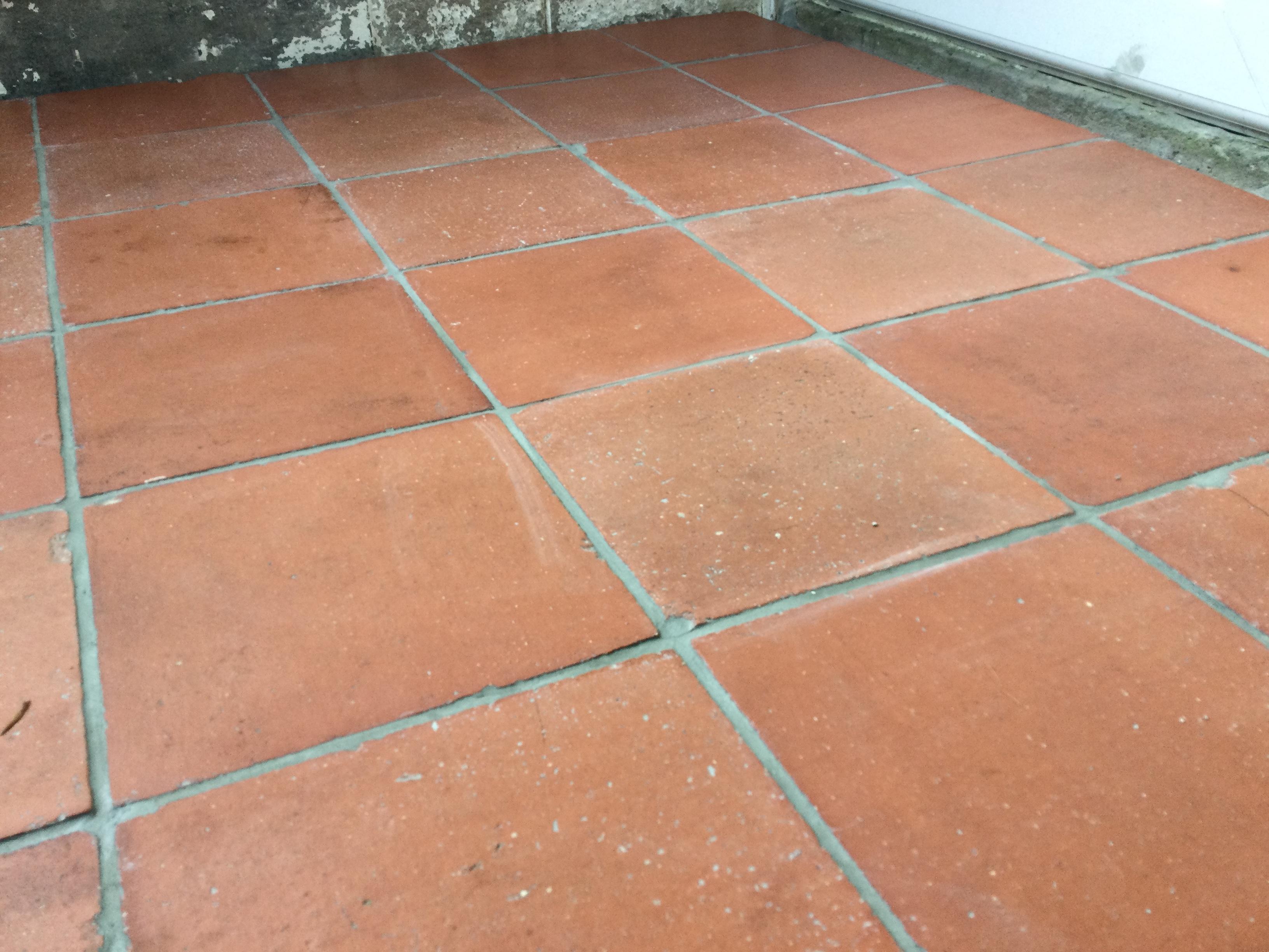

zoothorn Posted May 27, 2021 Author Share Posted May 27, 2021 2 hours ago, PeterW said: 250ml will go a long way if you make a pad with something like an old piece of tea towel over a small sponge. Wrap over and dip it in a dish of the stuff; squeeze excess and wipe over, it won’t use that much. Great tip.. will do just that then. Understand your suggestion of 'clean them up' too now.. getting the glue bits off 1st. The sealer says 3 days to become fully resistant. Hmm.. was gonna grout tomorrow. What would you do about the gaps to wall, & to the old slate? Both around 3/4". Link to comment Share on other sites More sharing options...
PeterW Posted May 27, 2021 Share Posted May 27, 2021 I would use grout if you have enough, if not then the step edge I would do in concrete but mix in some waterproofer or SBR too. Link to comment Share on other sites More sharing options...
Onoff Posted May 27, 2021 Share Posted May 27, 2021 A strong, SBR laden cement/sharp sand mix will be pretty dark and maybe slate esque. A little infill bit I did: Link to comment Share on other sites More sharing options...

zoothorn Posted May 29, 2021 Author Share Posted May 29, 2021 On 27/05/2021 at 20:27, joe90 said: Cracking job zoot, see, you can do it, just need a bit of confidence (and a few pointers from buildhubbers ?♂️). ? Its confidence, & motivation too/ the worst aspect of being 1 here. I'm a bit hesitant about the grout job.. not my forte. Also the depth is about 8x what Ive done with other normal thickness tiles too, so timeframe to do a similar say 2sq ft say is surely vastly different, meaning sponging time & stuff going off all much trickier surely. A heap of pointers morelike! Were your tiles deep ones too Joe? Is it possible to add a dye into mortar I wonder.. all I need is it a bit darker for my 3/4" gaps to 2 walls & slate threshold. Concrete for my 2" gap. Hmm.. so that's what just adding some gravel into a 4:1 mix? I can never see how this addition adds strength to what would otherwise be mortar myself. Link to comment Share on other sites More sharing options...
zoothorn Posted May 29, 2021 Author Share Posted May 29, 2021 @joe90 Hi Joe. Did you run a grout shaping thing over your lines? I didnt do a great job last time I grouted you see, go as usual to clips.. & there seems to be different ways, sponge, no sponge, running a shaping whatnot along lines after you've pressed the grout in, but never seen this before. I dont know where to start. Im wondering if my silicone shaper tool, the type with 4 different rubbery end bits to choose profile etc, whether this is suitable or even ideal tool for the job? Sponge? I always thought this was inherrant to the job, running diagonally across lines, after a period of time for grout to partially set. Link to comment Share on other sites More sharing options...
zoothorn Posted May 29, 2021 Author Share Posted May 29, 2021 Peter was right again, should indeed do the sealer before the grout.. because of the porous nature of the rough tile surface. I'm beginning to think that it makes most sense to, & that I'd like to just be adopted by Peter. Is 49-3/4 too much? zoot. Link to comment Share on other sites More sharing options...
joe90 Posted May 29, 2021 Share Posted May 29, 2021 Try this Link to comment Share on other sites More sharing options...
zoothorn Posted May 29, 2021 Author Share Posted May 29, 2021 @joe90 funnily enough that was the exact clip I bookmarked after watching a good few. I like his light touch. So no shaping thing for him. Cheers Joe. doing the sealer now/ ready to grout tmrw. zoot. Link to comment Share on other sites More sharing options...
joe90 Posted May 29, 2021 Share Posted May 29, 2021 If when the grout is nearly dry it appears a little rough (grainy) you can wet your finger and very lightly rub the grout to smooth it of. Link to comment Share on other sites More sharing options...
zoothorn Posted May 30, 2021 Author Share Posted May 30, 2021 18 hours ago, joe90 said: If when the grout is nearly dry it appears a little rough (grainy) you can wet your finger and very lightly rub the grout to smooth it of. Ok thanks, I'll keep a pot of water nearby.. I like 'Randy's' idea of wetting the float before each grout too. Its only the time leaving it, before attacking it with sponge my only main concern. And my higgledy tiles, many 5 mm high offsets one to the next, not gonna be a breeze this. Link to comment Share on other sites More sharing options...

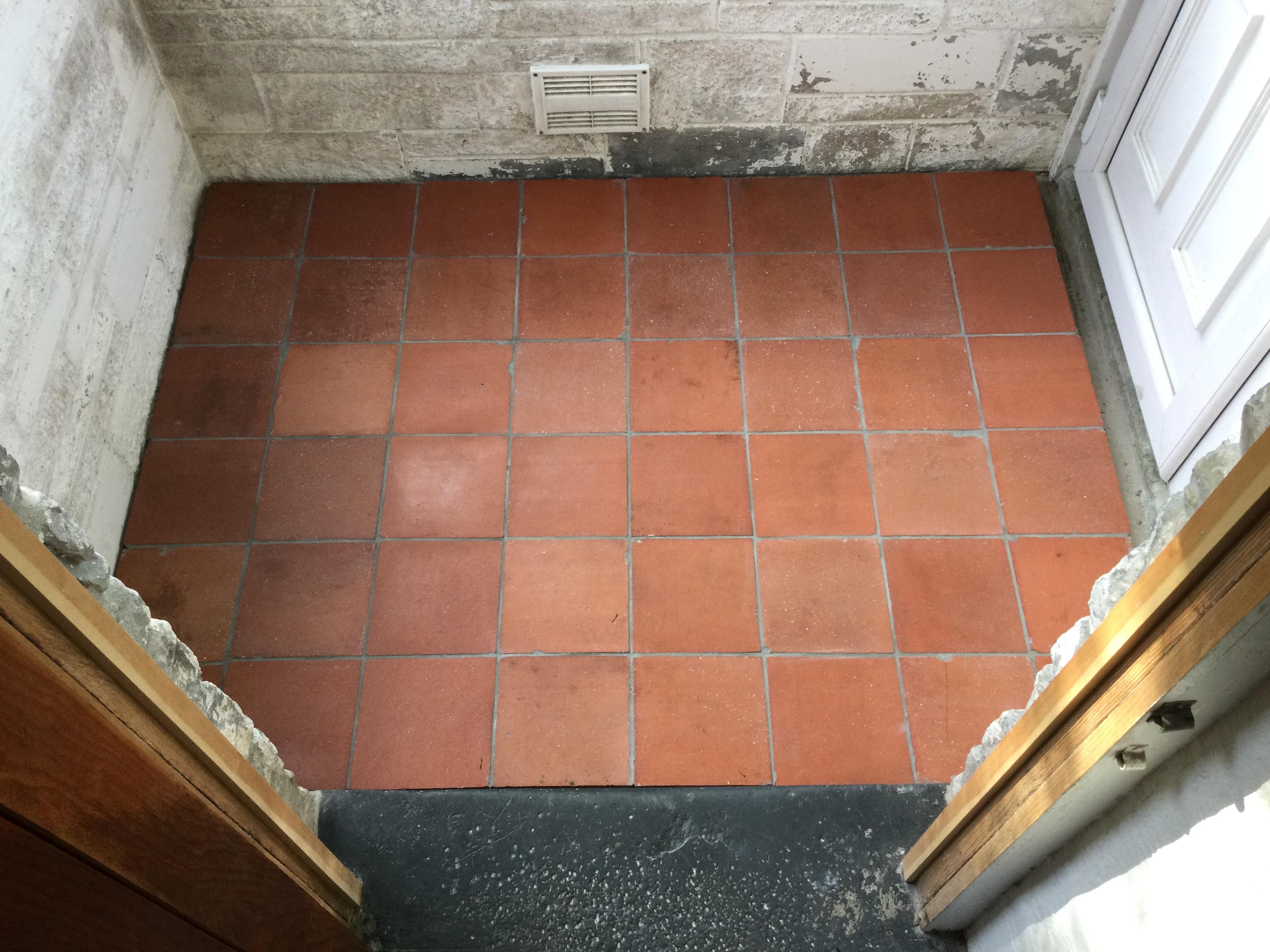

zoothorn Posted June 2, 2021 Author Share Posted June 2, 2021 Ive found a new least favourite job. Me no wanna do floor tiling again! Theres still a bit of grey film over it.. but Randy's vids helped alot. Link to comment Share on other sites More sharing options...
markc Posted June 2, 2021 Share Posted June 2, 2021 Looks good, and traditional, in keeping with the property. well done. I hate cleaning up after grouting Link to comment Share on other sites More sharing options...
joe90 Posted June 2, 2021 Share Posted June 2, 2021 Well done mate, see you can do it! Link to comment Share on other sites More sharing options...
zoothorn Posted June 2, 2021 Author Share Posted June 2, 2021 Thank goodness I needed PeterW's advice, by re-reading replies prior to barrelling in (considering them, & not going my [lazyass] idea of sealing them after grouting..).. & sealed -prior- to grouting. I'd have had a grey disaster if I hadn't I think, so raw a surface they are. 4 coats I did too. thanks- zH Link to comment Share on other sites More sharing options...

zoothorn Posted June 2, 2021 Author Share Posted June 2, 2021 9 minutes ago, joe90 said: Well done mate, see you can do it! Its pulling my finger out Joe.. hard when the sun's finally come out to sweat it on yr knees on a floor fretting all day. Urgh. Downhill now! paint the walls, varnish frame, fill the edge gaps in time: I tried to do with grout but its too much volume, over 1" deep & a good 3/4" along gaps to 3 walls. Maybe mortar fill up to a cm.. then top off with grout-? I'll cut 4x bits when an anglegrinder happens by, & mortar these 4 in (adjacent to door) as Ive no glue left. Save a bit of grout for them. should be ok. 1 Link to comment Share on other sites More sharing options...
