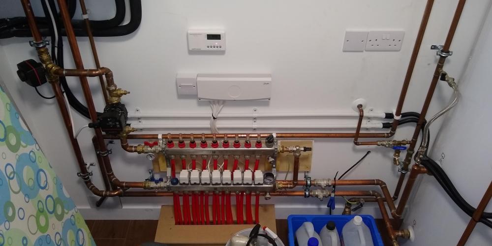

MarcelHoldinga Posted November 10, 2020 Share Posted November 10, 2020 Hi there, I'm new here. We've just moved in to our selfbuild (contractor built) ICF house. The house has 3 bedrooms, a lounge, a dining kitchen, a utility room, an en-suite and a main bathroom, as well as an entrance lobby/corridor. We've got an air to water heat pump, powering wet underfloor heating powered, and an Airflow MVHR system with radial air distribution. The water temperature for the heating is set to 38 degrees and we have 6 thermostats (Honeywell T6360 analog dials), most of which are set around at 19-19.5 degrees. We were advised by one of the engineers that the heating system should be left running 24 hours, so it's ready to provide heat when/where needed, so I took him on his word and have been leaving it running 24/7. I've noticed that the room temperatures regularly register at 3-4 degrees higher than the temperatures set at the thermostat (on cloudy days - never mind when we get a few hours of sun through the windows on a morning). In particular, the main bedroom has regularly is around 23 degrees C at the time we go to bed - way too hot for a bedroom. There is an MVHR outlet in the ceiling and the thermostat that's set to 18 degrees C, yet the temperature in the room gets jacked up to 23. At those temperatures and settings, I've noticed the floor being warm underfoot, which I wouldn't expect with the temp set as low as it is. I've tried to program the MVHR to dump some heat by lowering the supply air temperature and hoping that the summer bypass will kick, but unless I can adjust my heating temperatures before the bypass comes on, I will just end up running the heating to just have the energy sucked straight outside... Does anyone have any tips for managing the temperature in the house so we don't end up being slow cooked overnight? Thanks in advance for any wisdom you might be able to impart! Link to comment Share on other sites More sharing options...

ProDave Posted November 10, 2020 Share Posted November 10, 2020 What I got from reading this was your rooms are too warm, warmer than the room thermostat is set to, and you can still feel the floor warm to walk on. This says to me the UFH loops to the rooms are not turning off when the room thermostat reaches the set temperature. You need to start by looking at the UFH manifolds (post some pictures of them?) there should be a row of flow meters. If you are lucky someone will have labelled them so you know which loop feeds which room. You need to establish if the correct room thermostat controls the correct room. Link to comment Share on other sites More sharing options...
