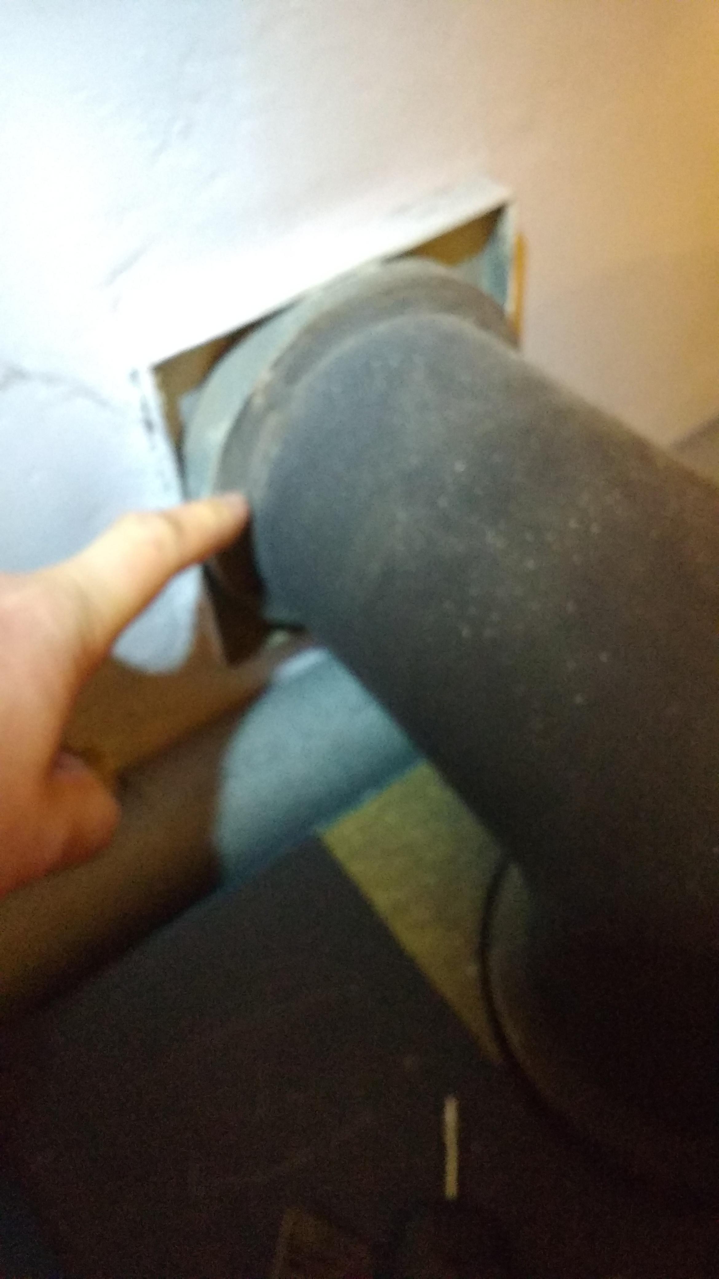

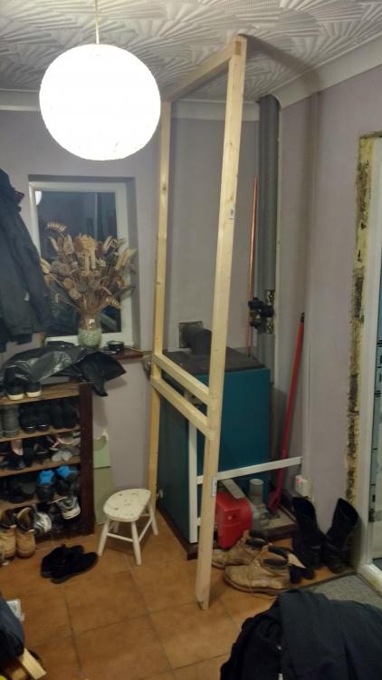

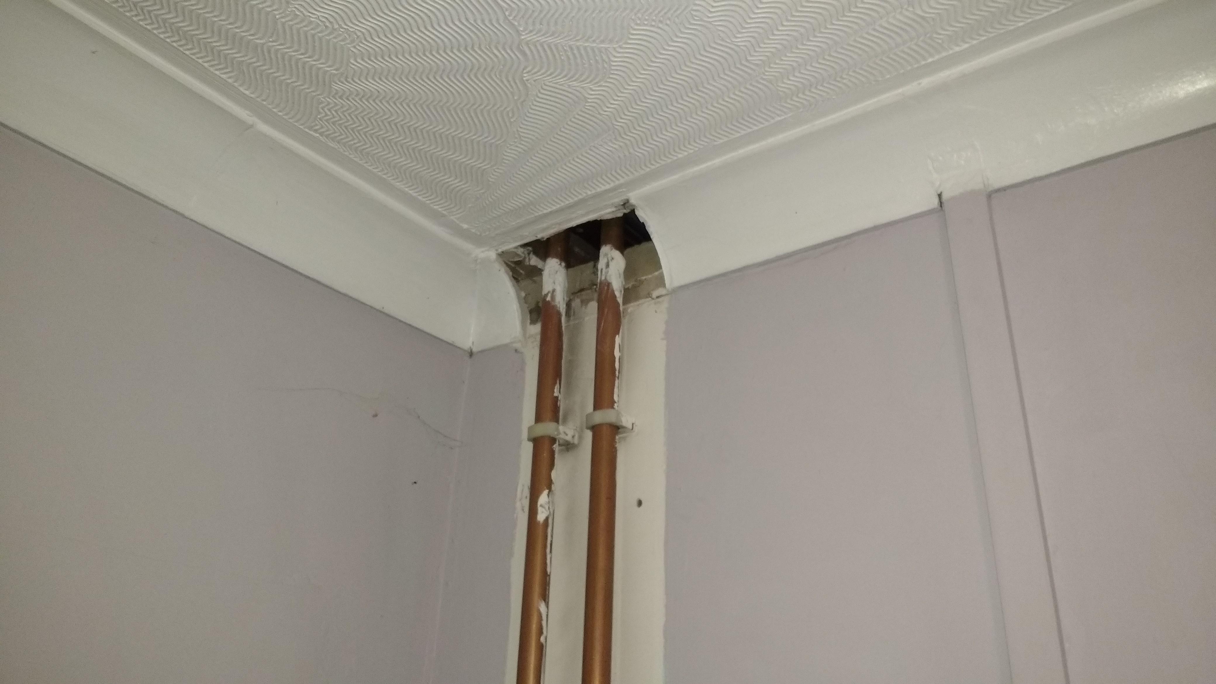

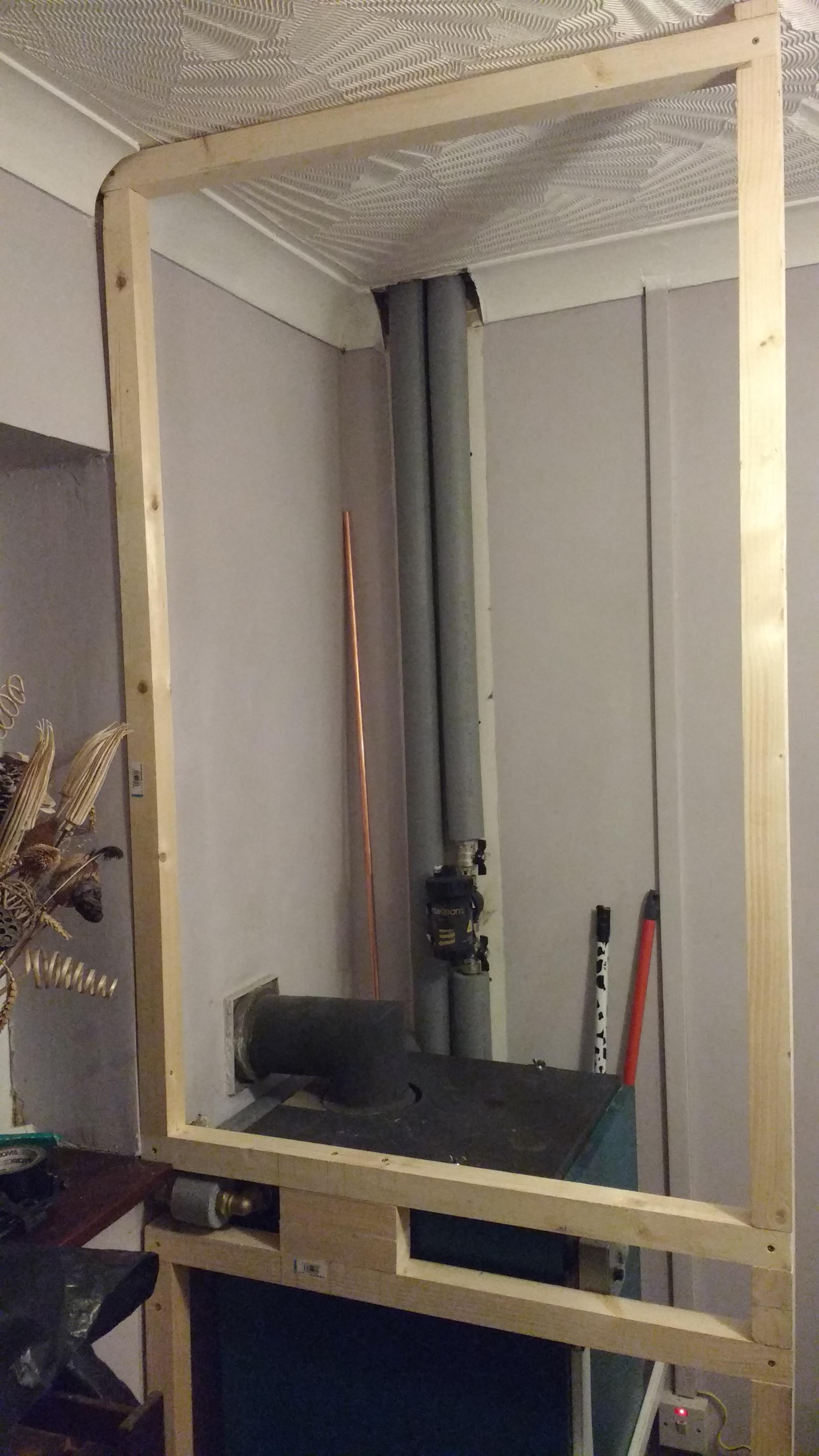

Onoff Posted November 3, 2020 Share Posted November 3, 2020 COVID / materials dependent I want to box in my boiler with an insulated but relatively quick to remove enclosure. The currently uninsulated, two 28mm pipes going up into the uninsulated hipped loft space/eaves. I was thinking to get another bit of coving and fit around these pipes. Maybe as it'll be in a cupboard though.....need I bother? Just neatly pb it from above? I need to replace the fire cement that's got a few cracks around where the flue comes up and out the wall. Rough plan is a full height 2x2" timber frame, clad in plasterboard then packed with Rockwool batts. I'll similarly line the back wall and sides with Rockwool batts. A little worried about fire of course. Haven't even thought about a door yet other than I guess it'll need a vent. Also a tad worried about about any fumes (if a fault) getting up into the loft and in turn bedrooms. All I have here is a full sheet of moisture resistant plasterboard. Good enough or should I go for the pink fire rated stuff? Any thoughts? Cheers. Link to comment Share on other sites More sharing options...

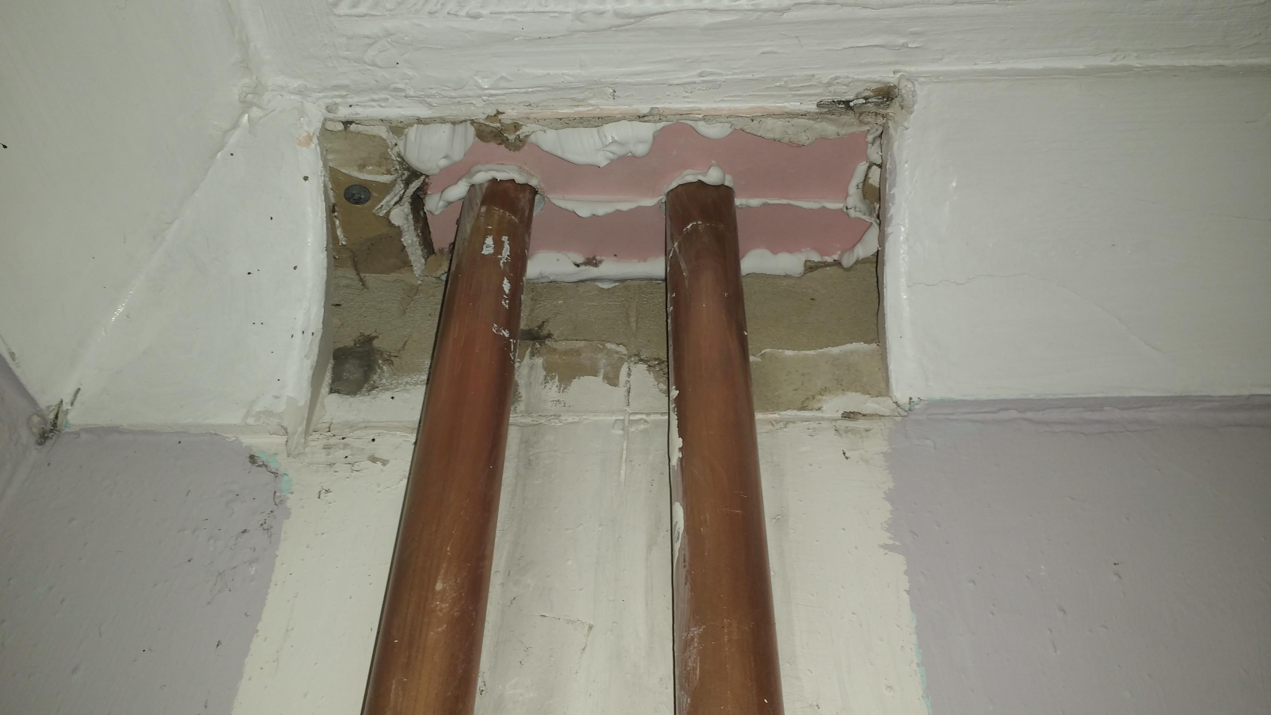

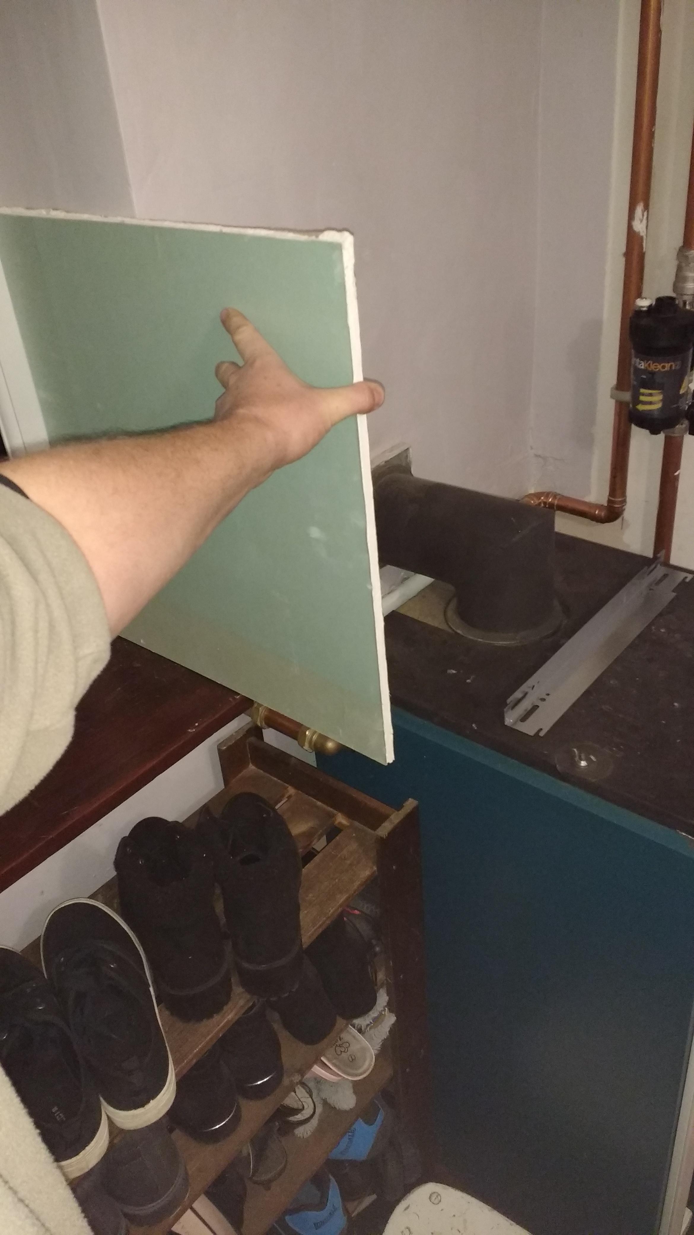

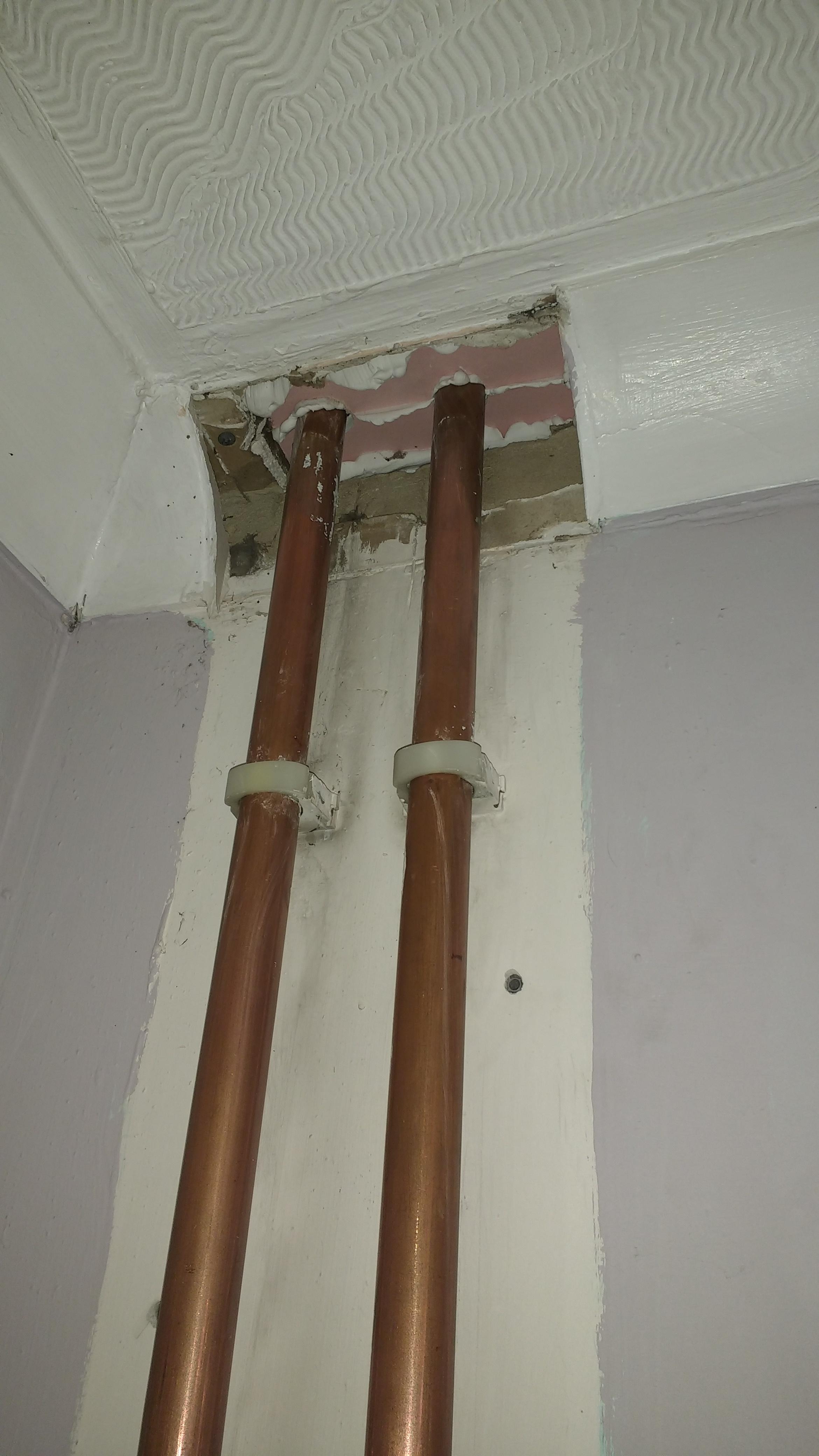

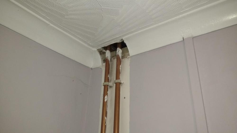

Onoff Posted November 11, 2020 Author Share Posted November 11, 2020 Not my proudest moment! ? I cut a piece of fire resistant plasterboard, drilled two 32mm holes in it, then cut it again along the centerline of the holes. Squidged a load of Everbuild Firemate intumescent sealant on the top side of the existing on and pushed the cut bits down into the mess. IF it sticks I'll fill in round the pipe a bit. Even though this'll be in a cupboard it's still pretty unsightly! Haven't got any coving to suit but then even that's a bit rough. Maybe fill the whole area with fire rated foam and try and form the curve with it? Then there's the Artex ceiling...I'm sure it was the in thing at the time. Link to comment Share on other sites More sharing options...

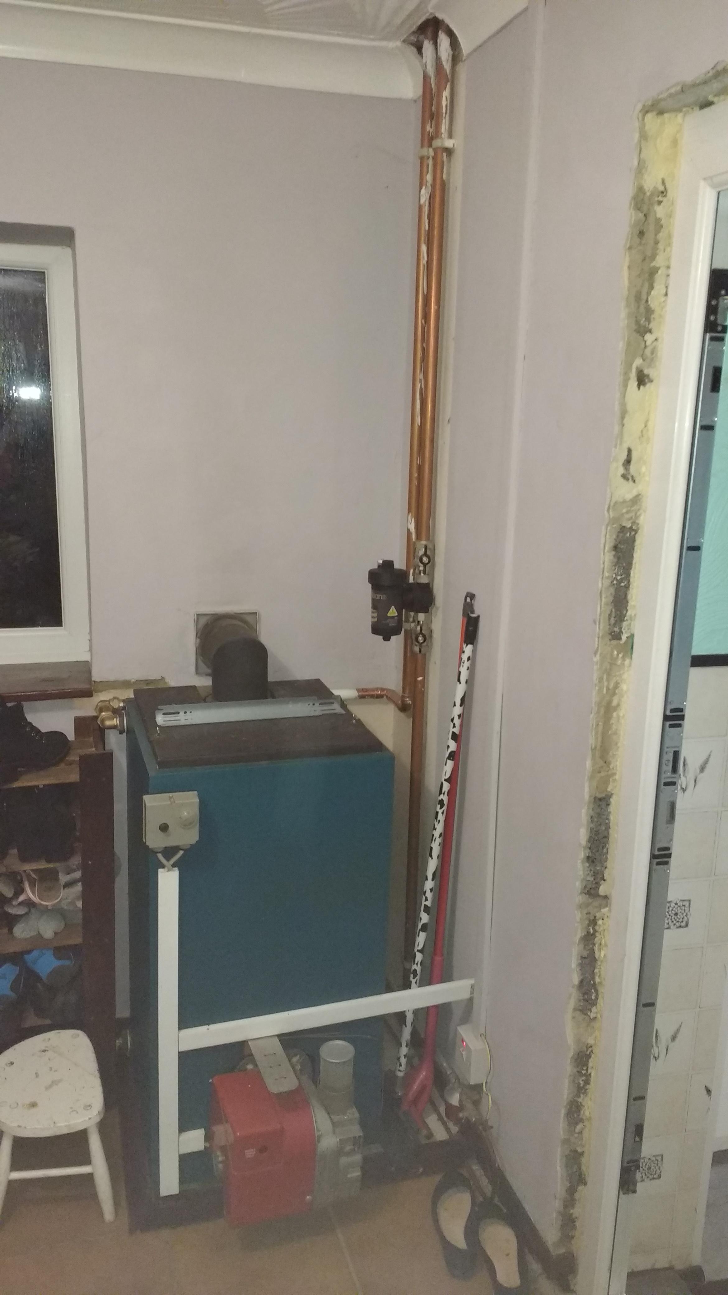

Onoff Posted November 11, 2020 Author Share Posted November 11, 2020 (edited) 35 minutes ago, daiking said: I meant the boiler ? 1998 Warmflow Bluebird 90/120: I've repaired it...a bit: Edited November 11, 2020 by Onoff Link to comment Share on other sites More sharing options...

Onoff Posted November 12, 2020 Author Share Posted November 12, 2020 6 hours ago, daiking said: Gives me flashbacks to the rubbish late 70s ideal Mexico floor stander in the appalling rental we vacated in 2015. Tbh the boiler is built like a battleship and has given good service despite the neglect. The efficiency is pretty good too. No instant hot water like an oil combi would give but I figure less to go wrong at least with the boiler. Well I found out this morning this intumescent sealant is exactly that. Seemingly no adhesive properties particularly. Not sure what to do with those bits of fire rated pb I've "stuck" up there now. Pull them off, top with ply and screw through from underneath? Remove the coving where the cupboard will be maybe and overboard with one piece of fire rated pb? That'd neaten things up perhaps. Or is it really worth the hassle ? Link to comment Share on other sites More sharing options...

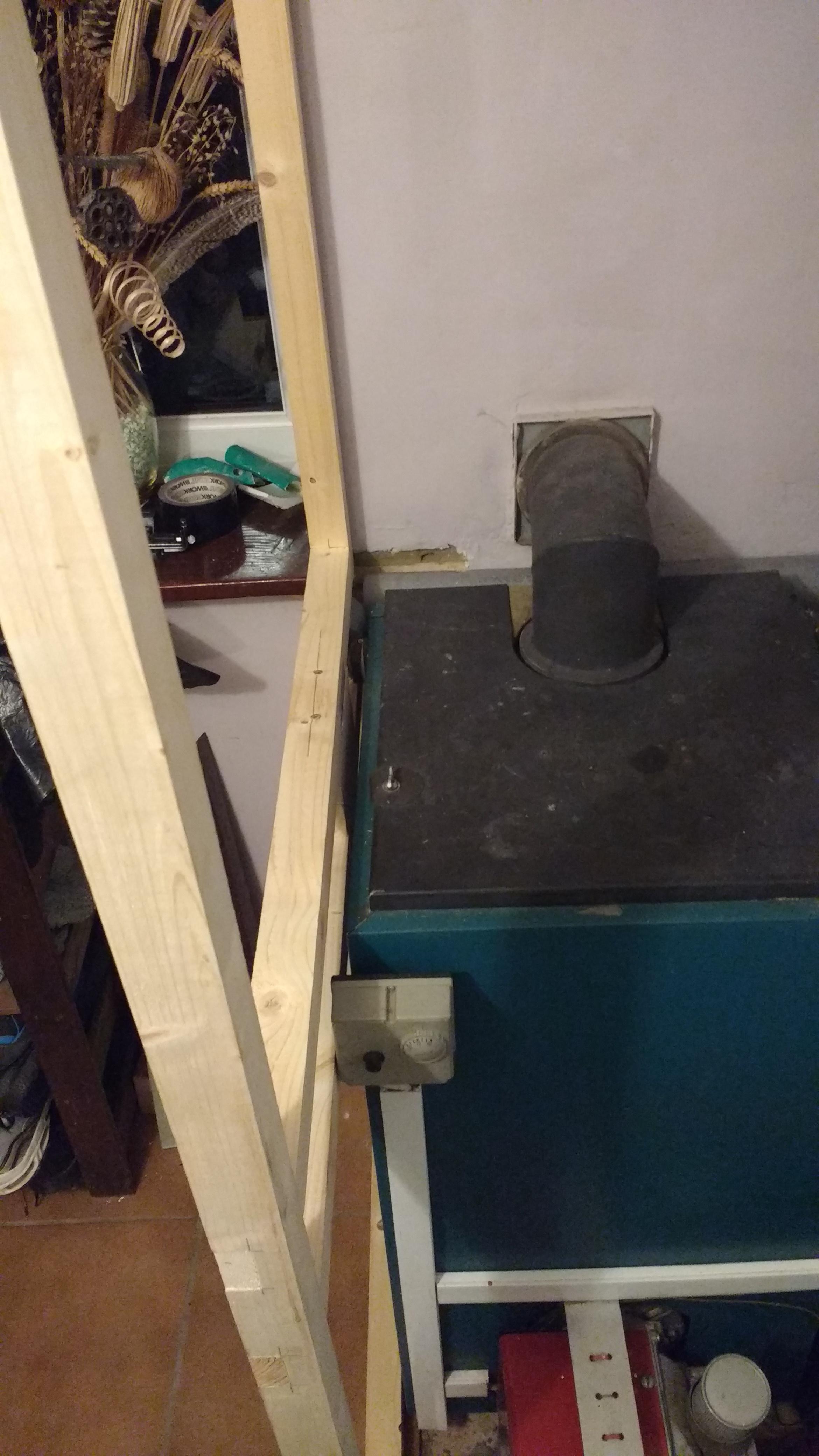

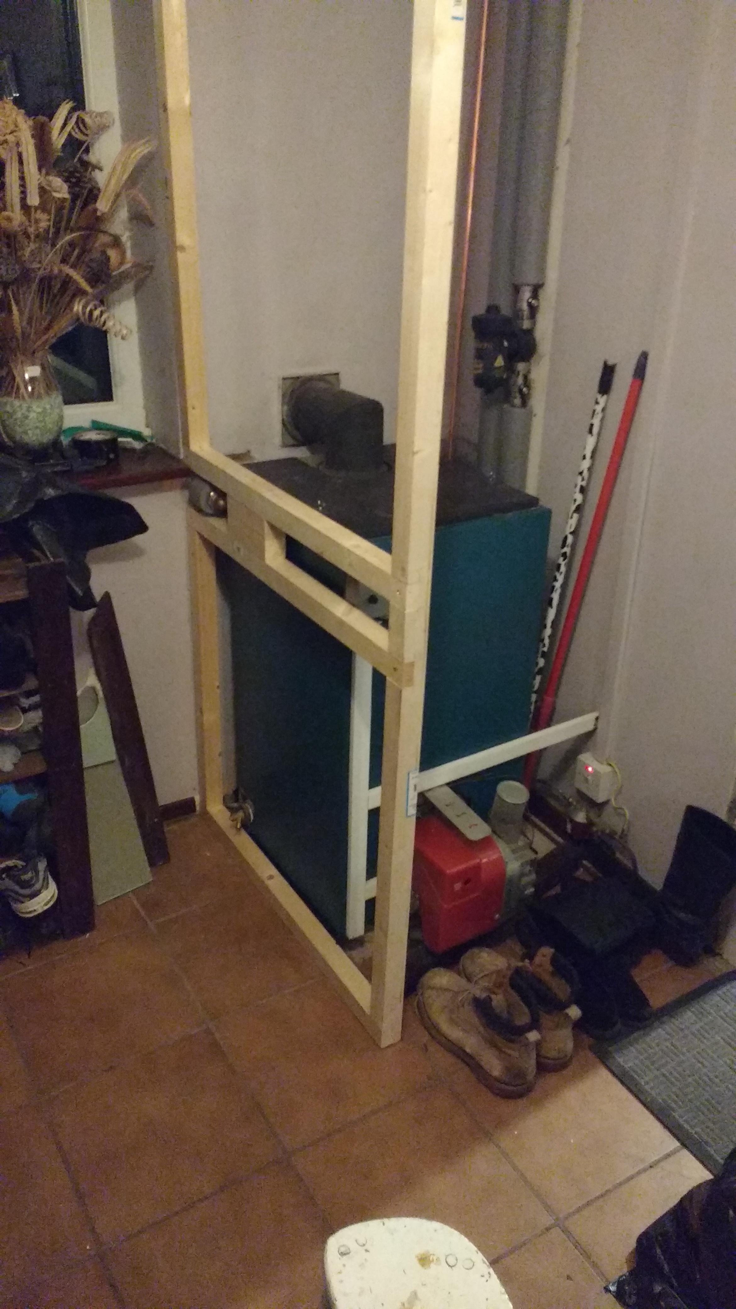

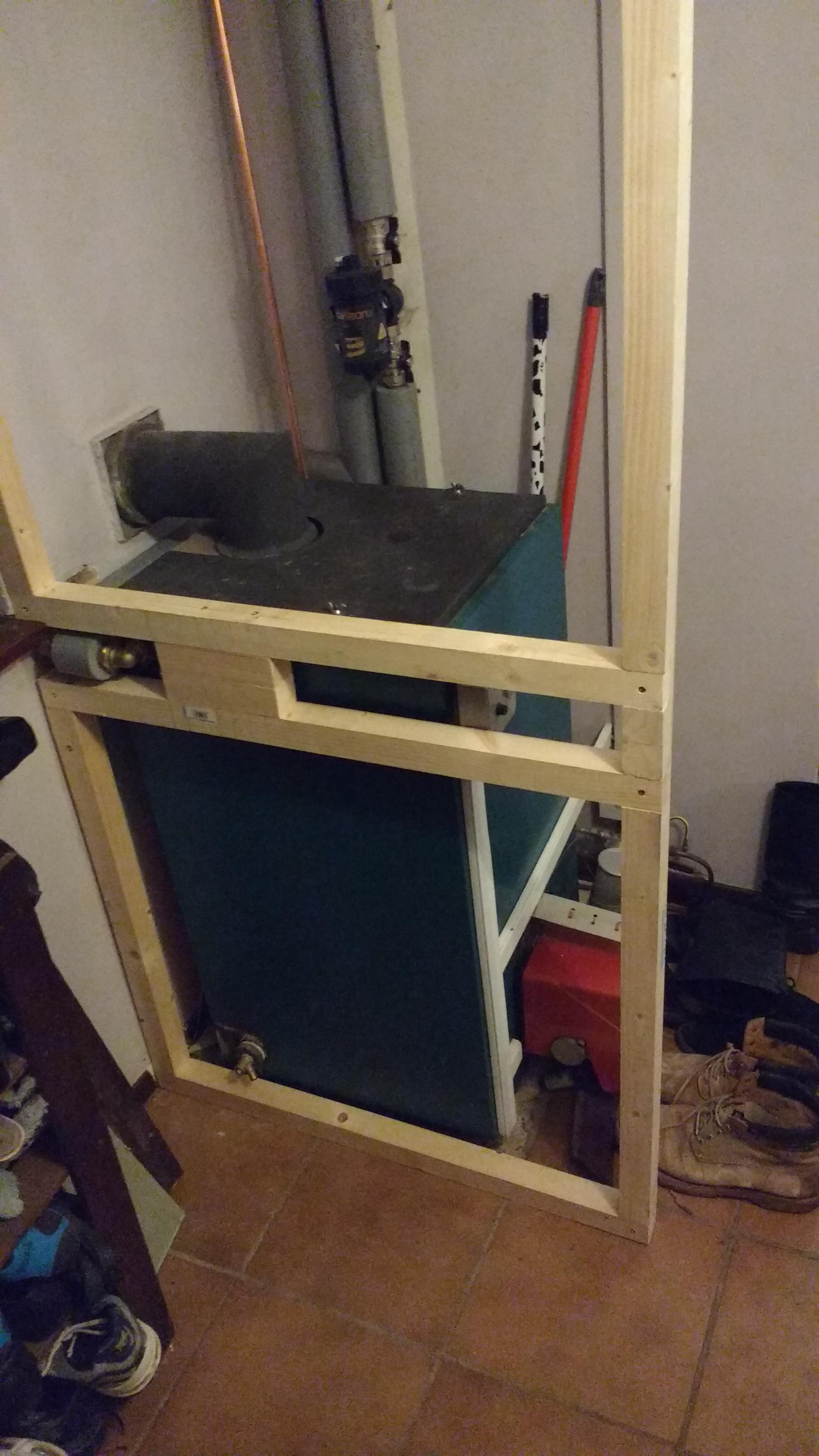

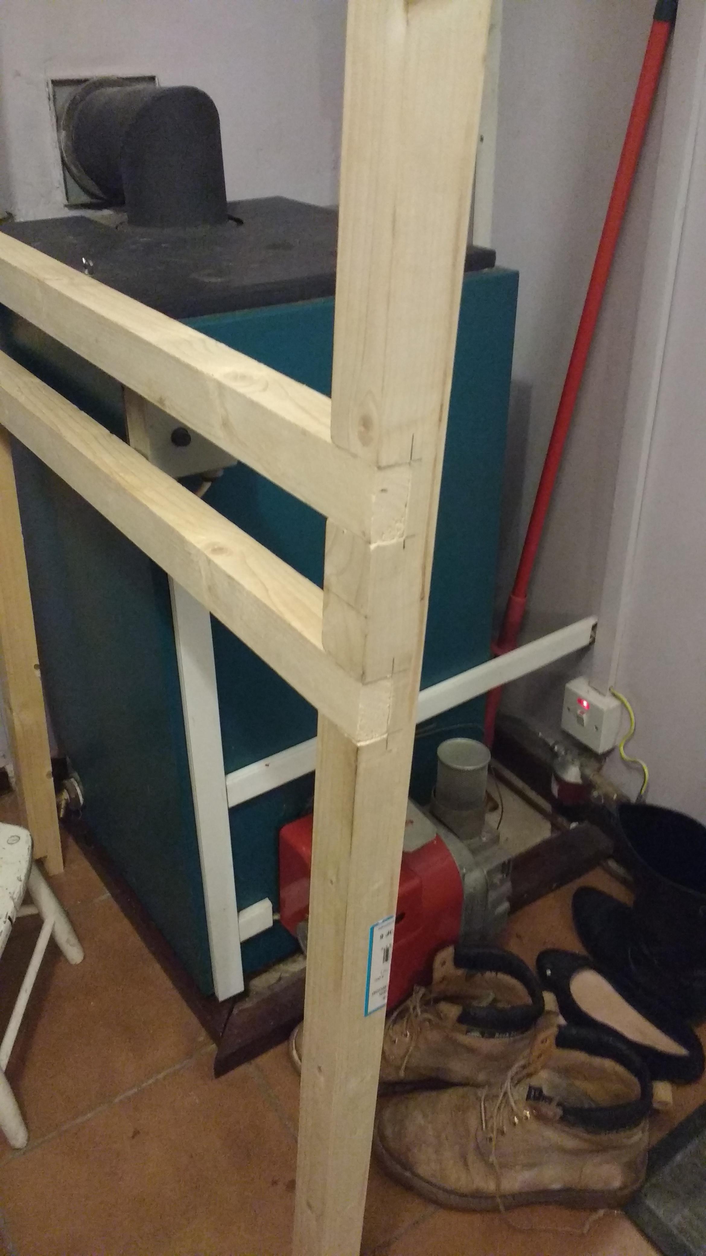

Onoff Posted December 14, 2020 Author Share Posted December 14, 2020 (edited) I've started on framing the boiler in, well I've cut and marked a few bits of 2x2, ready to do some housing joints on the radial arm saw! I figure I should dig out and redo the fire cement. It's a bit cracked. Are all fire cements made equal? (Excuse photo quality). Edited December 14, 2020 by Onoff Link to comment Share on other sites More sharing options...

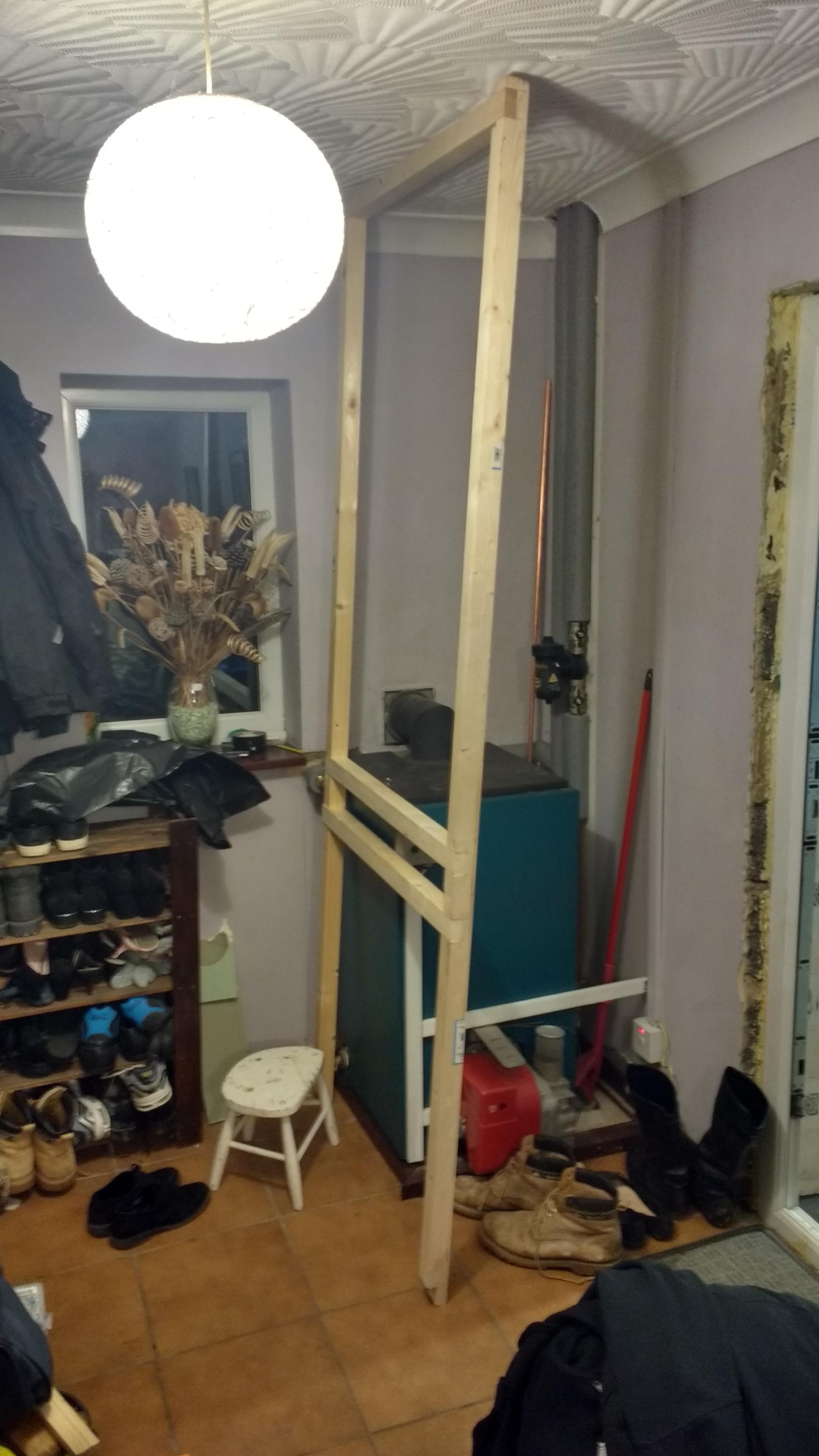

Onoff Posted December 15, 2020 Author Share Posted December 15, 2020 (edited) Not sure where this is going...this Wickes timber is a bit poor tbh. Really don't know if it's going to work. I'll end up with a big warm cupboard. Useful for I'm not sure what. Seems to come out quite far but it's only 2" further than the front of the Riello burner. I've got SWMBO giving it "I didn't know it'd stick out that far!" First time for everything I suppose! ? Still, the fake Makita recip saw had an outing: Edited December 15, 2020 by Onoff Link to comment Share on other sites More sharing options...
Roundtuit Posted December 15, 2020 Share Posted December 15, 2020 Looking good! You can shelve above and use it as an airing cupboard, and its always useful to have somewhere to dry a pair of boots overnight. Link to comment Share on other sites More sharing options...
Onoff Posted December 16, 2020 Author Share Posted December 16, 2020 (edited) 10 hours ago, Roundtuit said: Looking good! You can shelve above and use it as an airing cupboard, and its always useful to have somewhere to dry a pair of boots overnight. Not sure tbh. Surprising how imposing the frame is. Though above the boiler and burner is dead space, you do tend to skirt the burner when you walk in/out and your elbows at least, if not upper body pass through that space. Chamfering the corner might "soften" the look/feel...but could compromise access to the boiler stat... What I really need is a plant room! ? Edited December 16, 2020 by Onoff Link to comment Share on other sites More sharing options...

Gav_P Posted December 16, 2020 Share Posted December 16, 2020 Does it have to go all the way to the ceiling? Could you step it back above the boiler? (A bit like a Welsh dresser). It might not be so imposing then. Link to comment Share on other sites More sharing options...
