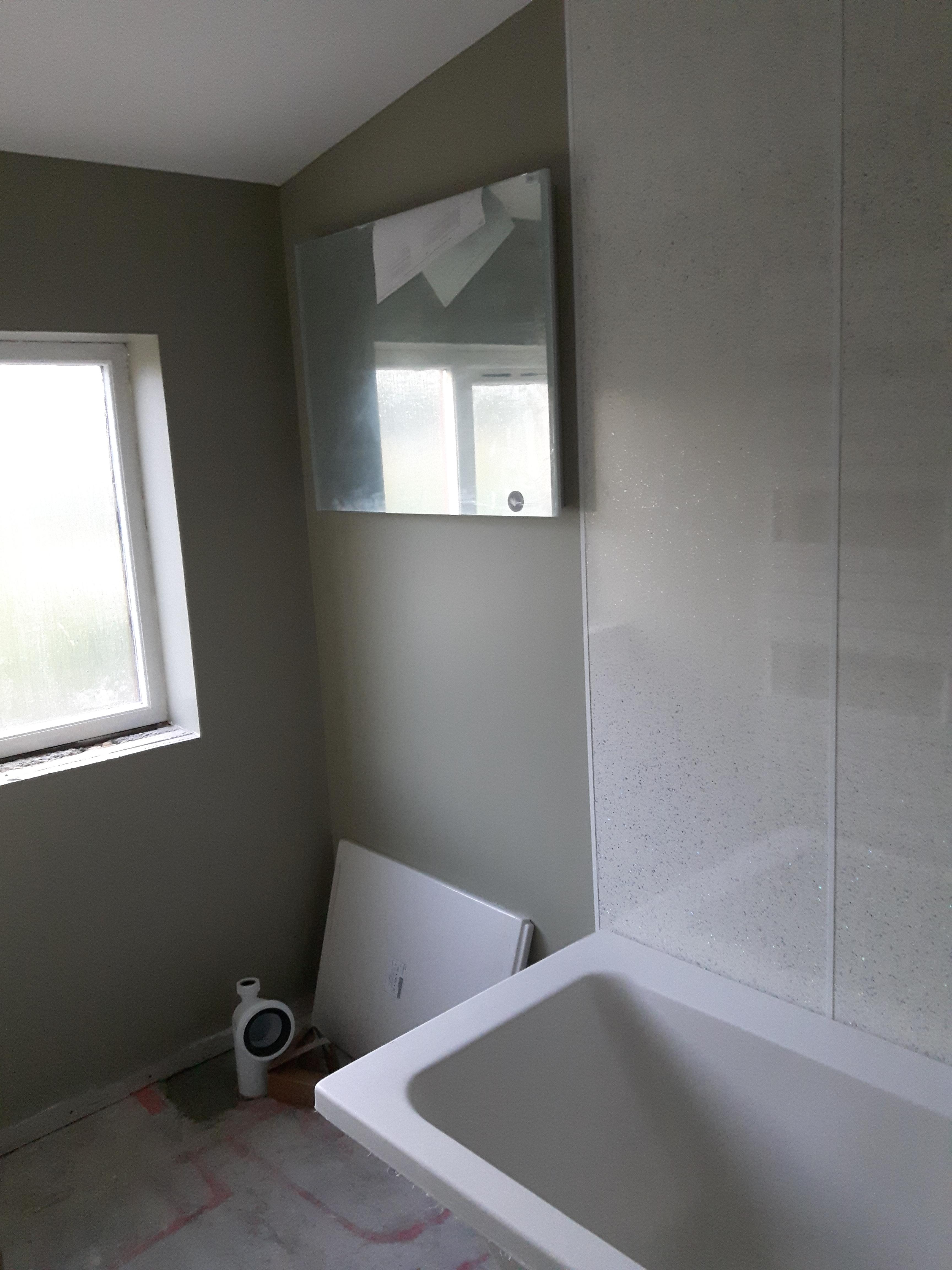

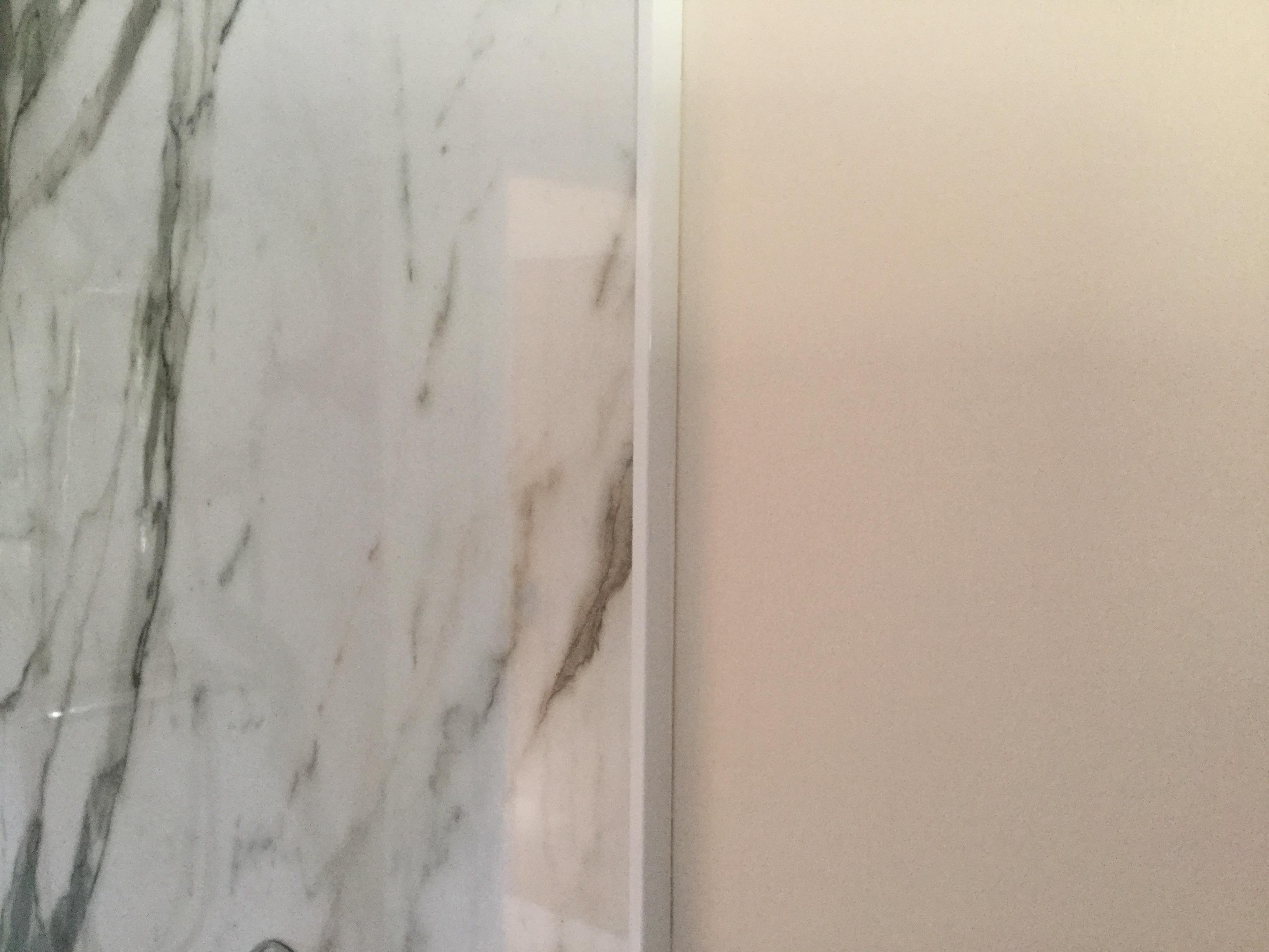

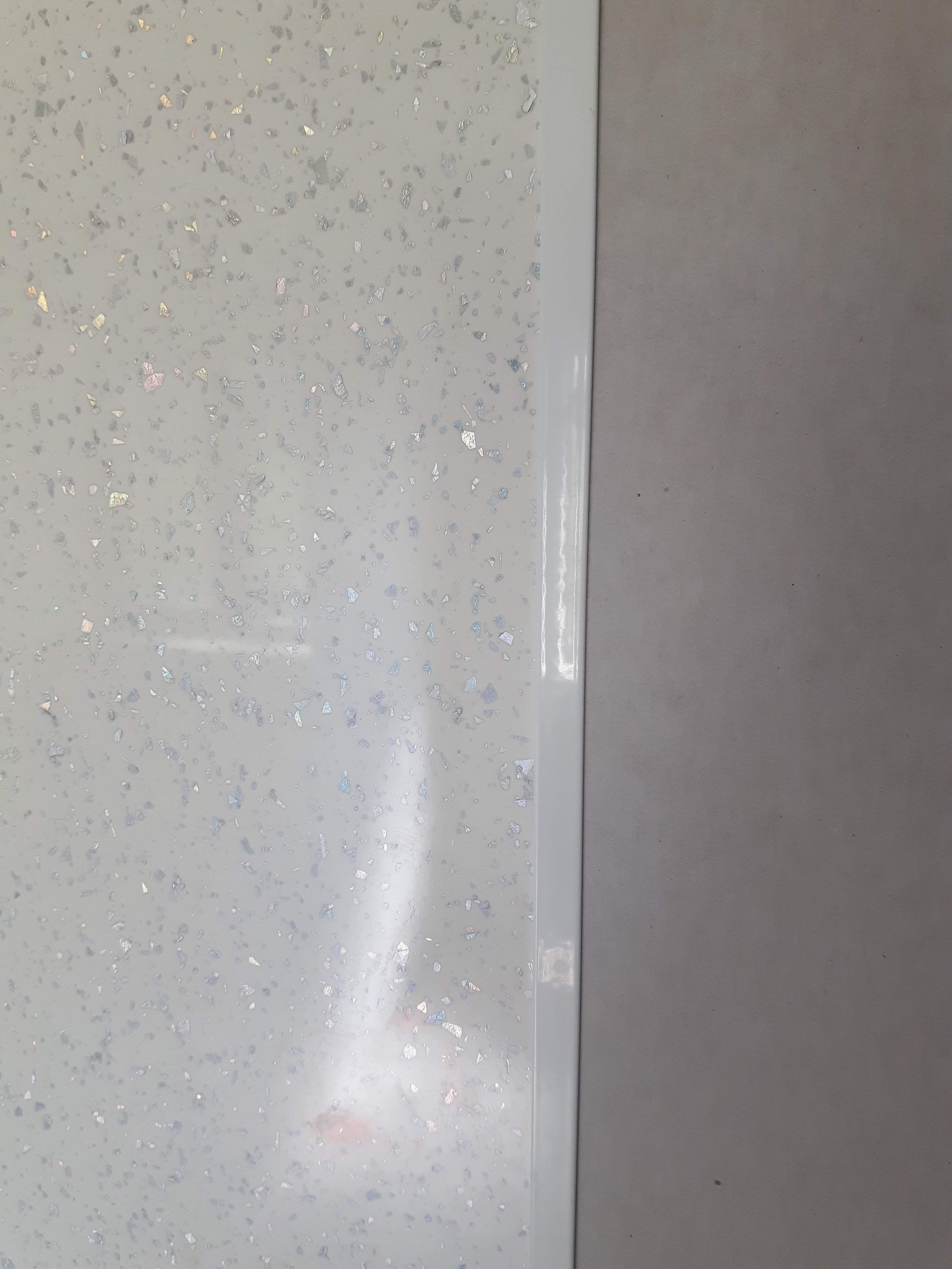

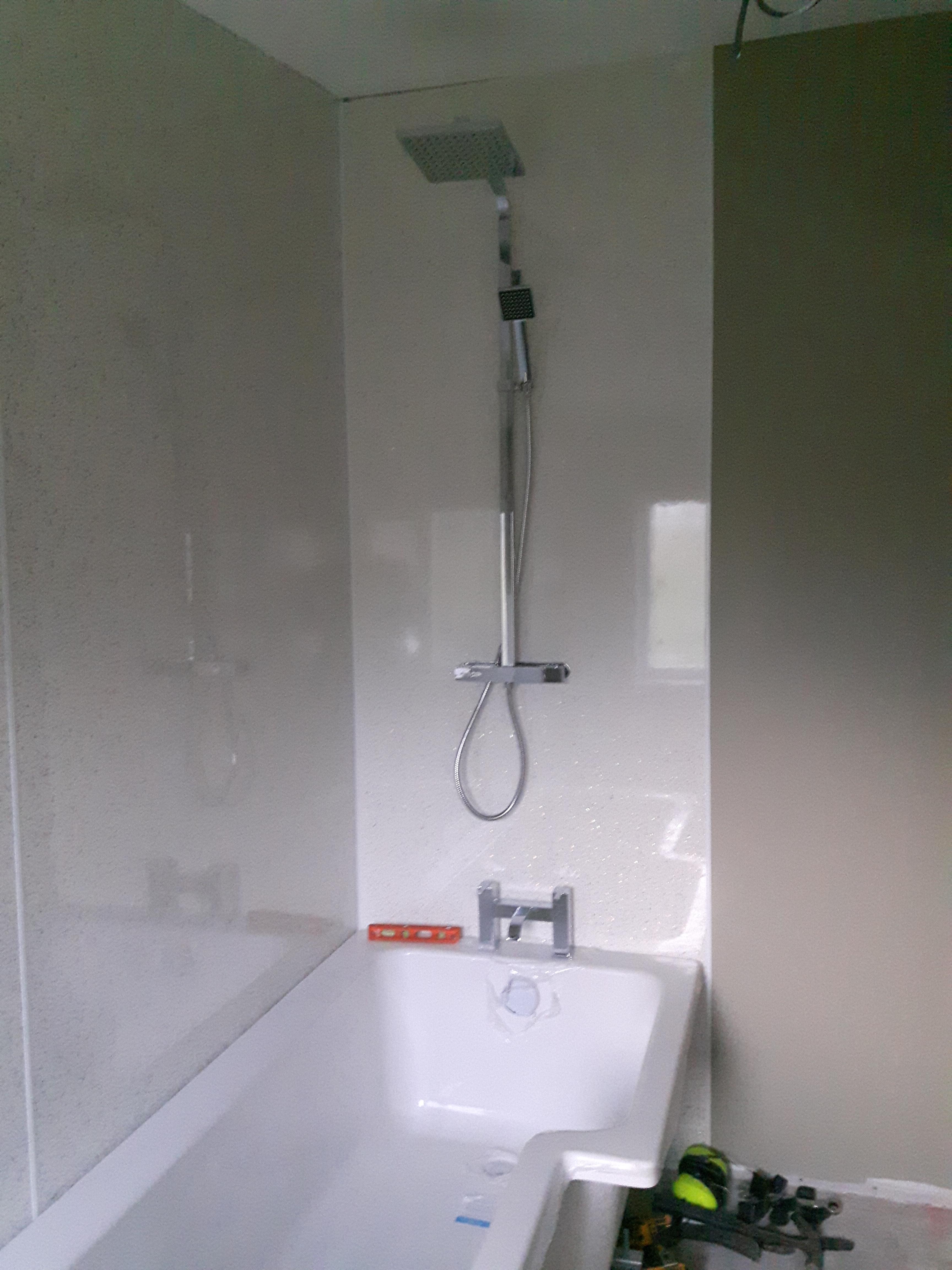

canalsiderenovation Posted November 2, 2020 Posted November 2, 2020 We are about to push the button on getting shower panels ordered but I'm worried about the trims. The end ones (in satin silver or white) and also the corner trims. I know some panels such as Nuance don't have these rather just rounded edges but in typical fashion we can't find any we like. Can anyone send me pics of the trims on their shower panels so I can see them please?
canalsiderenovation Posted November 2, 2020 Author Posted November 2, 2020 2 hours ago, joe90 said: Thank you. Is that trim on the second pic on a corner or joining the panels?

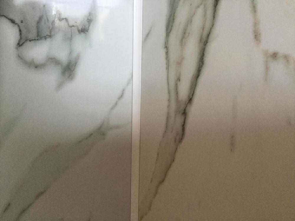

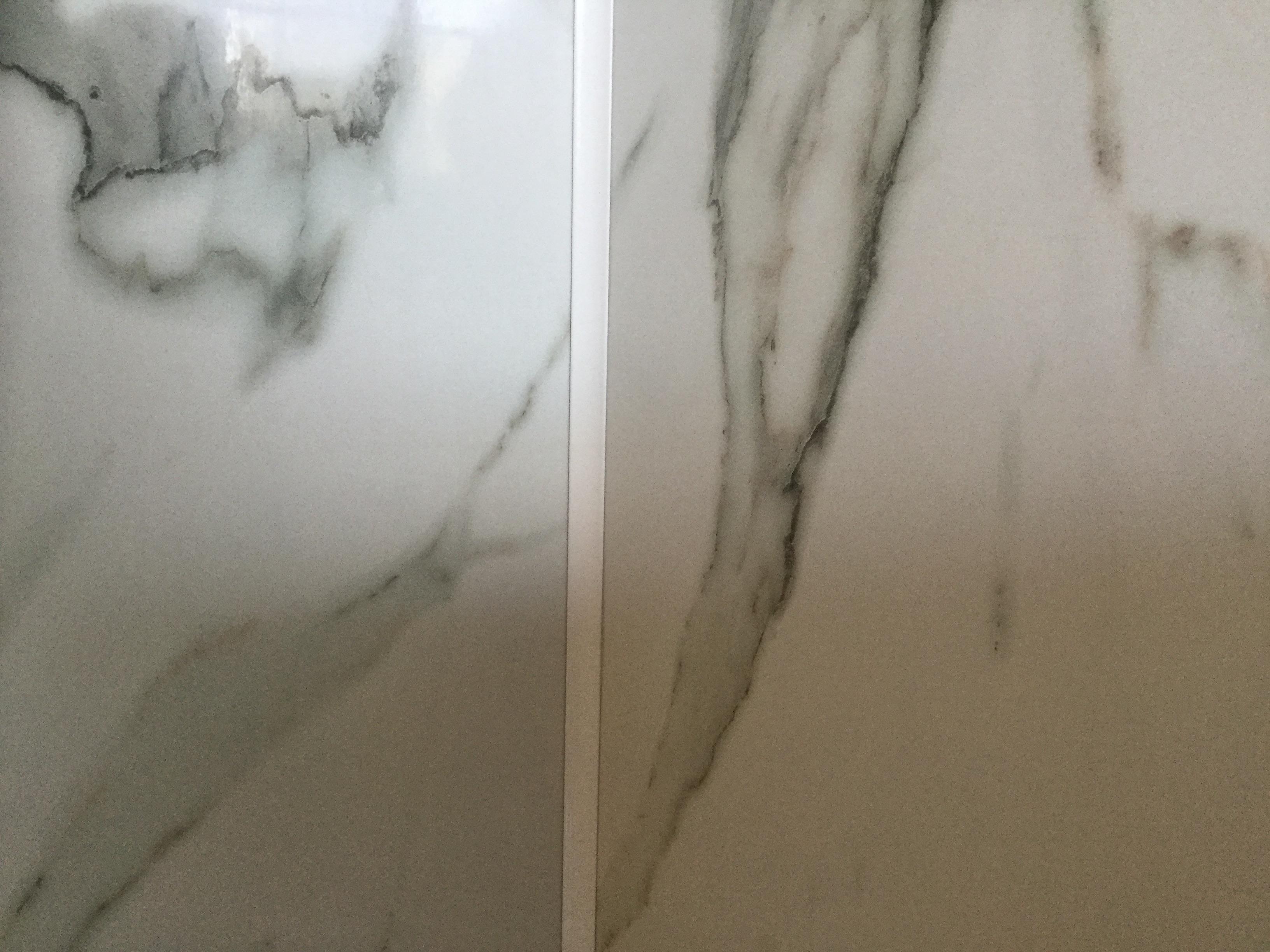

Hobbiniho Posted November 2, 2020 Posted November 2, 2020 This is my wetwall panel, it is from howdens i used "H" joints to join the panels onto plasterboard so there is not a step
joe90 Posted November 2, 2020 Posted November 2, 2020 16 minutes ago, canalsiderenovation said: Thank you. Is that trim on the second pic on a corner or joining the panels? corner!!! I don’t have any “joins”
canalsiderenovation Posted November 2, 2020 Author Posted November 2, 2020 35 minutes ago, joe90 said: corner!!! I don’t have any “joins” That's the same as us then. Thanks it actually doesn't look as bad as I was picturing the trims would look in my head.
canalsiderenovation Posted November 2, 2020 Author Posted November 2, 2020 36 minutes ago, Hobbiniho said: This is my wetwall panel, it is from howdens i used "H" joints to join the panels onto plasterboard so there is not a step Thank you. I see you have the strips joining the panels we will need to join the panels but I don't want strips so I think that's why showerwall have quoted the tongue and groove ones?
ProDave Posted November 2, 2020 Posted November 2, 2020 Multipanel also do a version with tongue and groove joints but I suspect you still need a corner joint piece.
