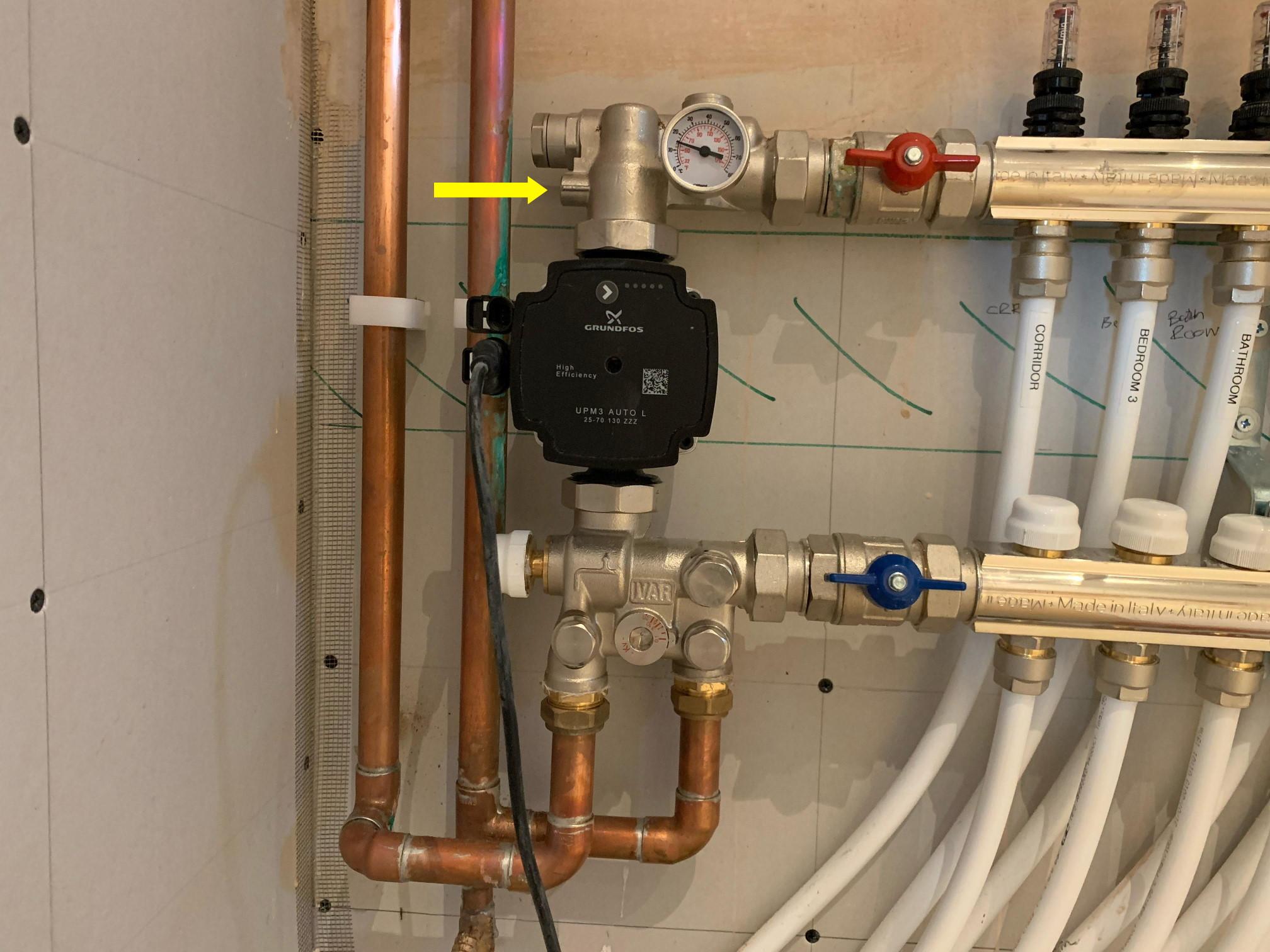

andy Posted October 23, 2020 Share Posted October 23, 2020 (edited) Hi all Been a while but have had my head well and truly in the build and work, nearly at moving in point... We've finally turned on the ASHP and UFH today and am unable to get any sensible flow rate through the two Ivar mainfolds - some short loops (20m) can get up to 2l/min but that's all even with all other zones closed off. The manifolds are these: https://underfloorparts.co.uk/product/unimax-blending-10-port-underfloor-heating-manifold-with-grundfos-upm3-pump-uni-mix-temperature-contoller-mixer-valve/ I've looked at the instructions for the Ivar here: https://www.underfloorheating.co.uk/Files/127465/UFH-Mixing-kit.pdf But I'm still none the wiser and I am sure it's just something I need to sort on the primary and secondary bypass valves. I am confused why I cannot get more flow through the zones but I am sure it's just something obvious on the Ivar themselves; my loop lengths vary from 20 to 78m and I've got 2 manifolds - a 4 port and a 10 port with pressure at 2 bar. What am I doing wrong? Edited October 23, 2020 by andy Link to comment Share on other sites More sharing options...

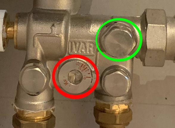

ProDave Posted October 27, 2020 Share Posted October 27, 2020 5 hours ago, andy said: Problem is even with all zones closed down I can only get circa 4l/min round a circuit, with all zones open I can barely get any flow to each zone - barely a movement at the top of the flow meter. The manifold has primary and secondary bypass - I've set the primary bypass to Kv0 as the local TMV is not yet fitted (long story, it is going on soon). Secondary bypass I took screw out by cannot seem to turn the 5mm key to turn and I don't want to force it. Explain these bypasses please, if possible with a picture of your actual manifolds? Link to comment Share on other sites More sharing options...
andy Posted October 28, 2020 Author Share Posted October 28, 2020 16 hours ago, ProDave said: Explain these bypasses please, if possible with a picture of your actual manifolds? Here you go, primary highlighted in yellow, secondary in green on zoomed in image: Link to comment Share on other sites More sharing options...
ProDave Posted October 28, 2020 Share Posted October 28, 2020 What's that actuator head position on the left of the blending valve? Surely with a blanking plug screwed on, that will be shut? Link to comment Share on other sites More sharing options...
andy Posted October 28, 2020 Author Share Posted October 28, 2020 1 hour ago, ProDave said: What's that actuator head position on the left of the blending valve? Surely with a blanking plug screwed on, that will be shut? It’s fully unscrewed. I wonder if it’s something to do with the pump in the loft and at manifolds interfering with each other but tbh I don’t get it at this point... Link to comment Share on other sites More sharing options...

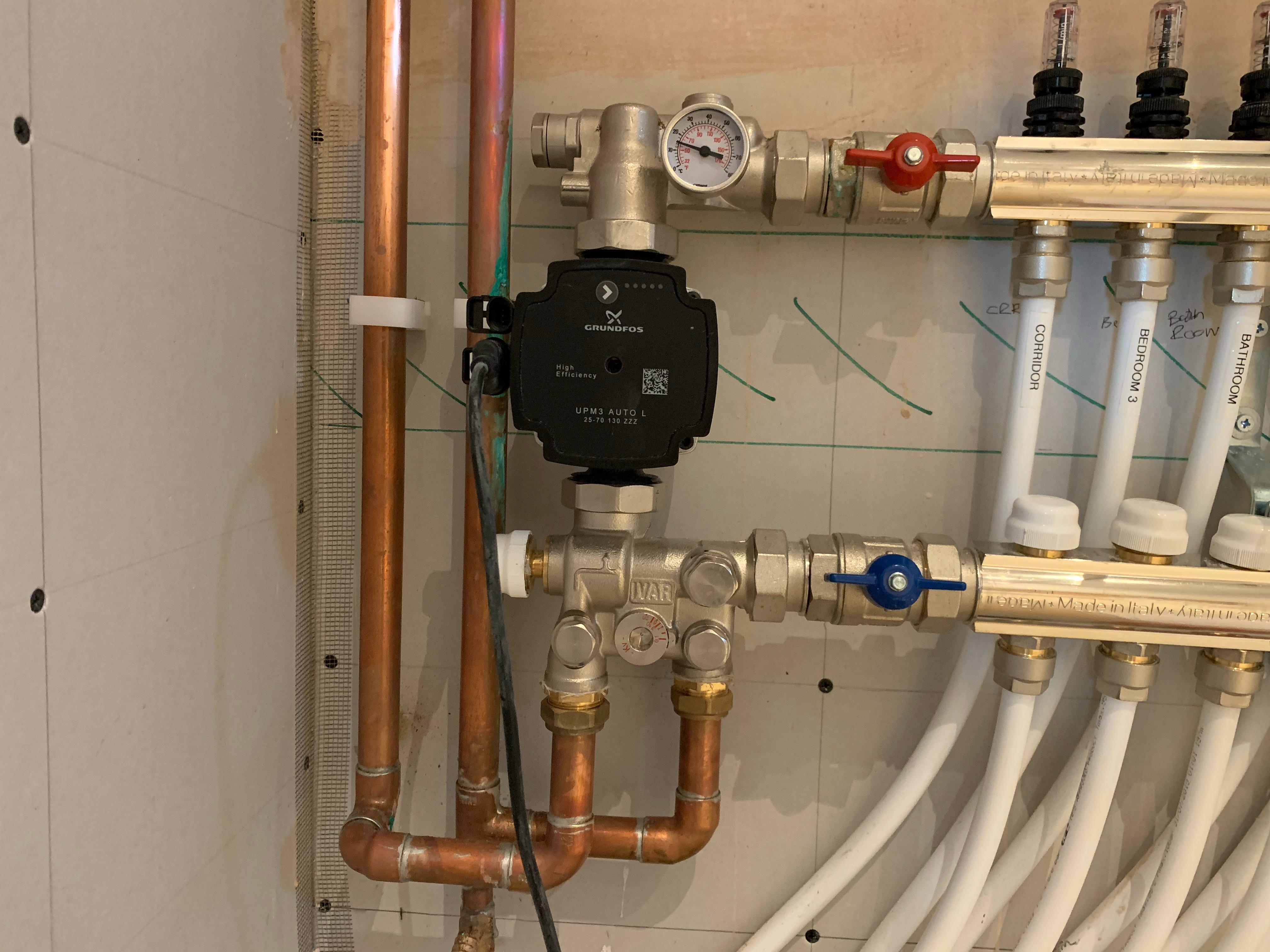

andy Posted October 30, 2020 Author Share Posted October 30, 2020 Problem was an un-noticed 1/4 turn valve that we'd all overlooked on top left... once it was opened, all fine. Grrrrrr.... Link to comment Share on other sites More sharing options...
andy Posted October 31, 2020 Author Share Posted October 31, 2020 22 hours ago, andy said: Problem was an un-noticed 1/4 turn valve that we'd all overlooked on top left... once it was opened, all fine. Grrrrrr.... And in case anyone else is caught out by this, the isolation valve wasn't visible once the unit had been installed and wasn't checked it was open prior to mounting. It's as per the pic below, flows are now absolutely normal. 1 Link to comment Share on other sites More sharing options...

PeterW Posted October 31, 2020 Share Posted October 31, 2020 It’s the weird bypass valve bit I don’t like / get as that is another set of issues all built into a single unit. What’s the manufactures warranty on those manifolds ..? Link to comment Share on other sites More sharing options...
