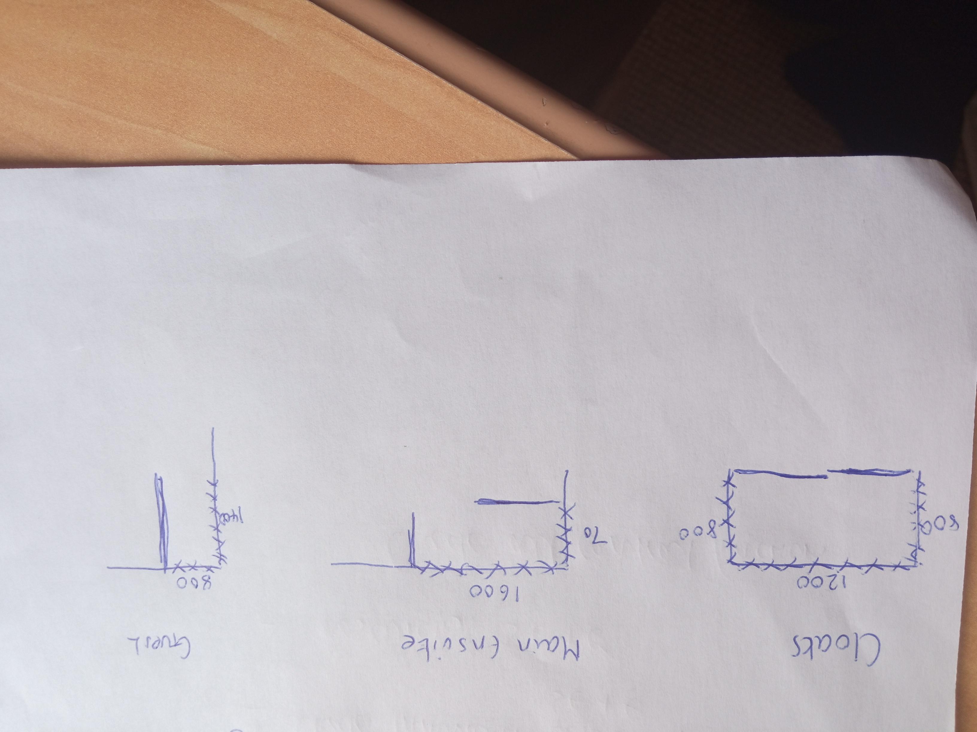

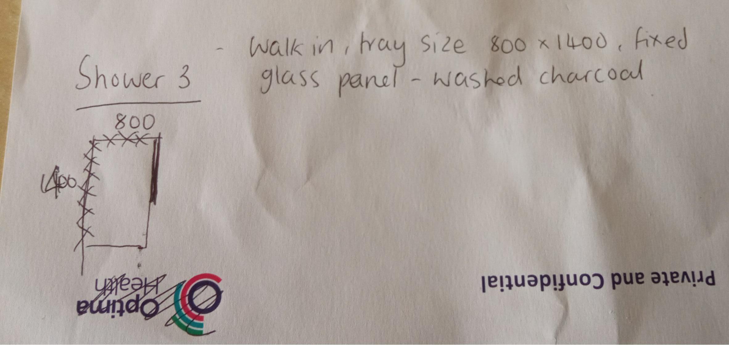

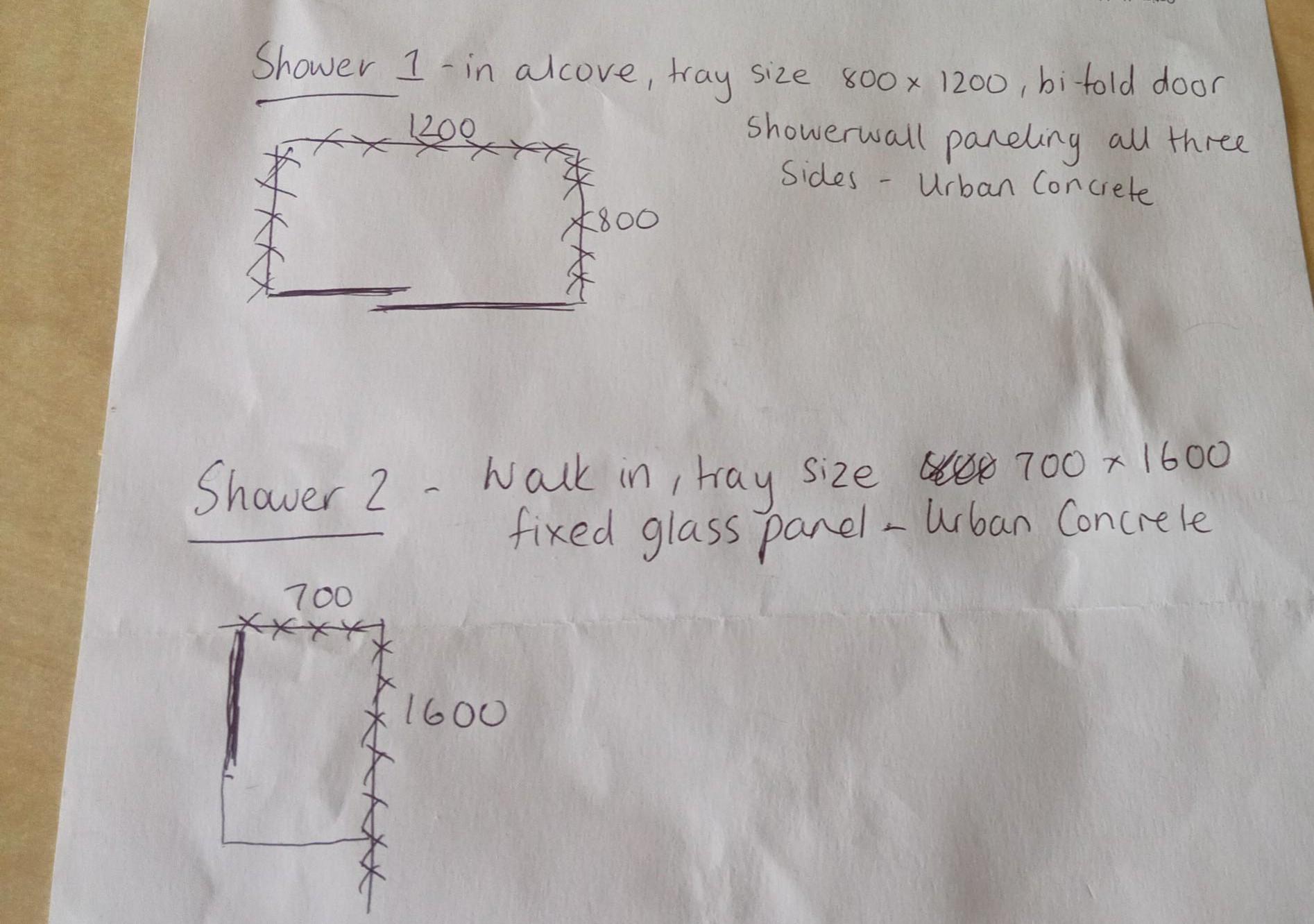

canalsiderenovation Posted October 22, 2020 Share Posted October 22, 2020 Shower wall panelling with builders discount from Huws Gray: Shower details indicated by an X are what we need. Crikey, tell me shower panels aren't worth it and we should just tile the lot.... Link to comment Share on other sites More sharing options...

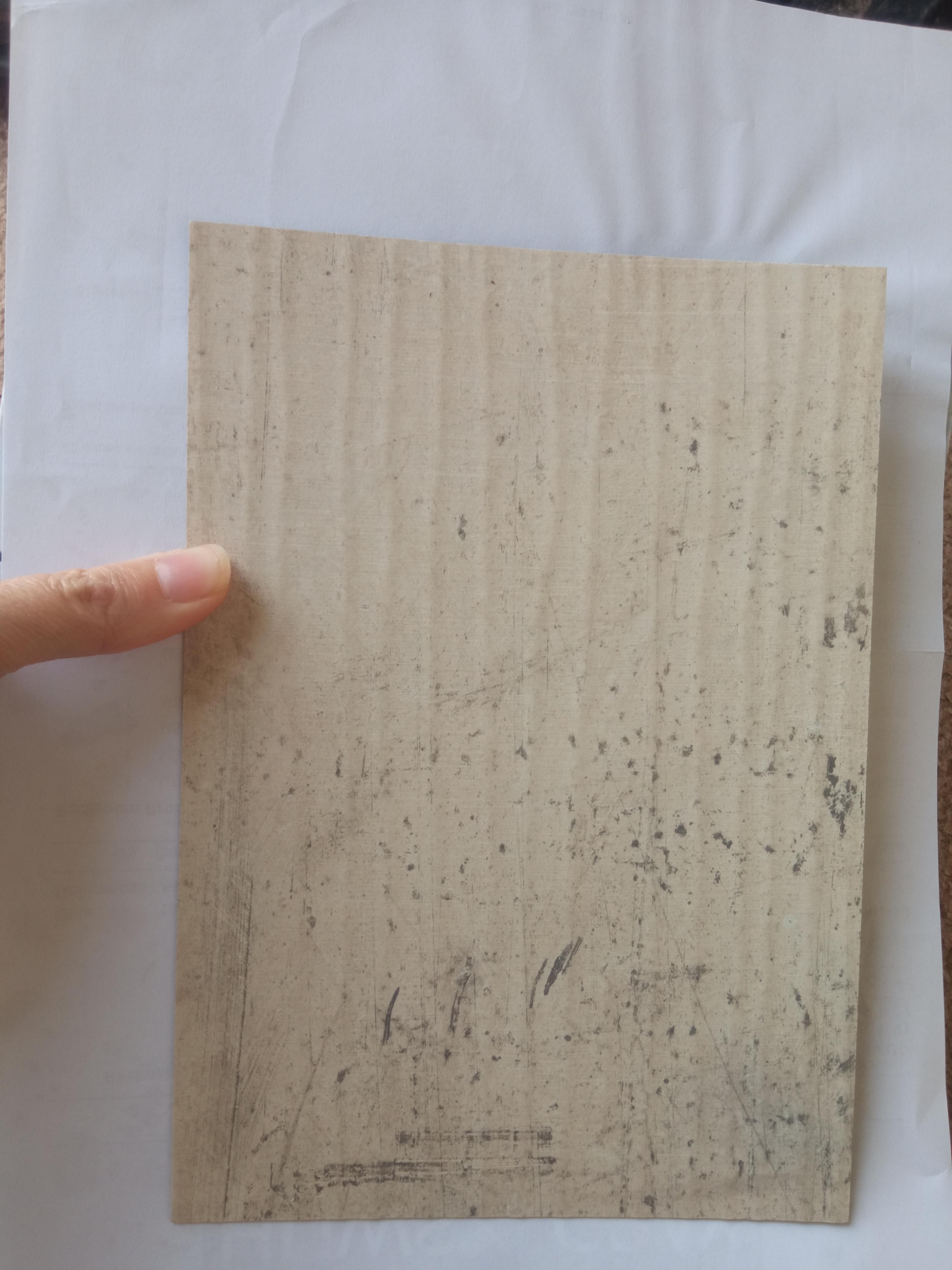

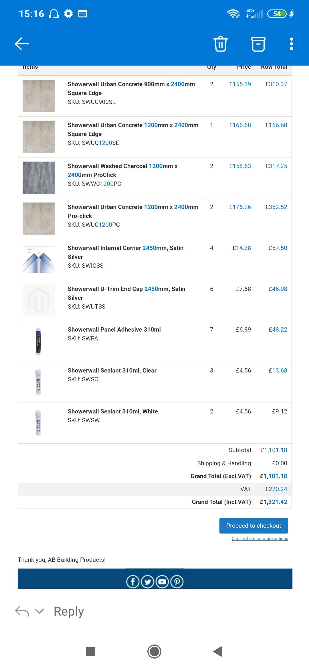

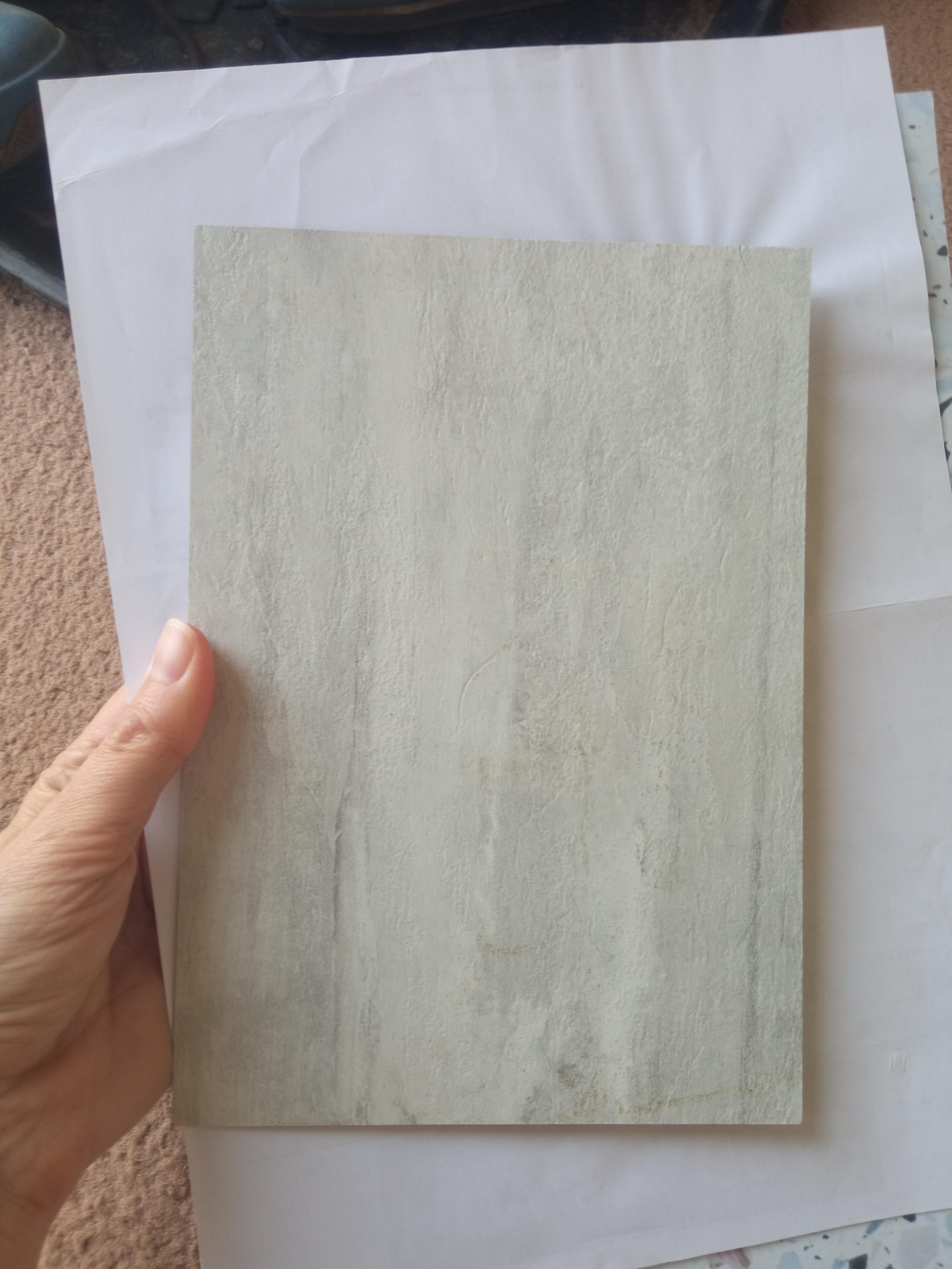

canalsiderenovation Posted November 16, 2020 Author Share Posted November 16, 2020 Ok, think we have settled on www.showerwall.co.uk These are both from the 'concrete' effect range and they are matt and textured which I quite like and with the proclick they shouldn't show the join as much as some of the glossy ones we saw. Has anyone had textured panels? We have three showers (two walk in ones and one in an alcove with three walls) and I'm down to around £1300 inc vat including Internal Corners, End Caps, Panel Adhesive and Silicone Sealant. Two of the showers we have settled on Urban Concrete which has sort of textured lines on it. And one shower in Washed Charcoal (the shower has a smoked glass screen). This again is quite textured. 1 Link to comment Share on other sites More sharing options...
joe90 Posted November 16, 2020 Share Posted November 16, 2020 My only reservation on textured is it holding onto soap/scum, ours are glossy flat and with a “blade” (bit like a windscreen wiper with a handle) its dead easy to remove “water” after a shower and leaves no marks. Link to comment Share on other sites More sharing options...
canalsiderenovation Posted November 16, 2020 Author Share Posted November 16, 2020 9 minutes ago, joe90 said: My only reservation on textured is it holding onto soap/scum, ours are glossy flat and with a “blade” (bit like a windscreen wiper with a handle) its dead easy to remove “water” after a shower and leaves no marks. Good point, I've had textured tiles before which have been ok (we are both ocd clean freaks) but it's the grouting that has caused problems. Link to comment Share on other sites More sharing options...

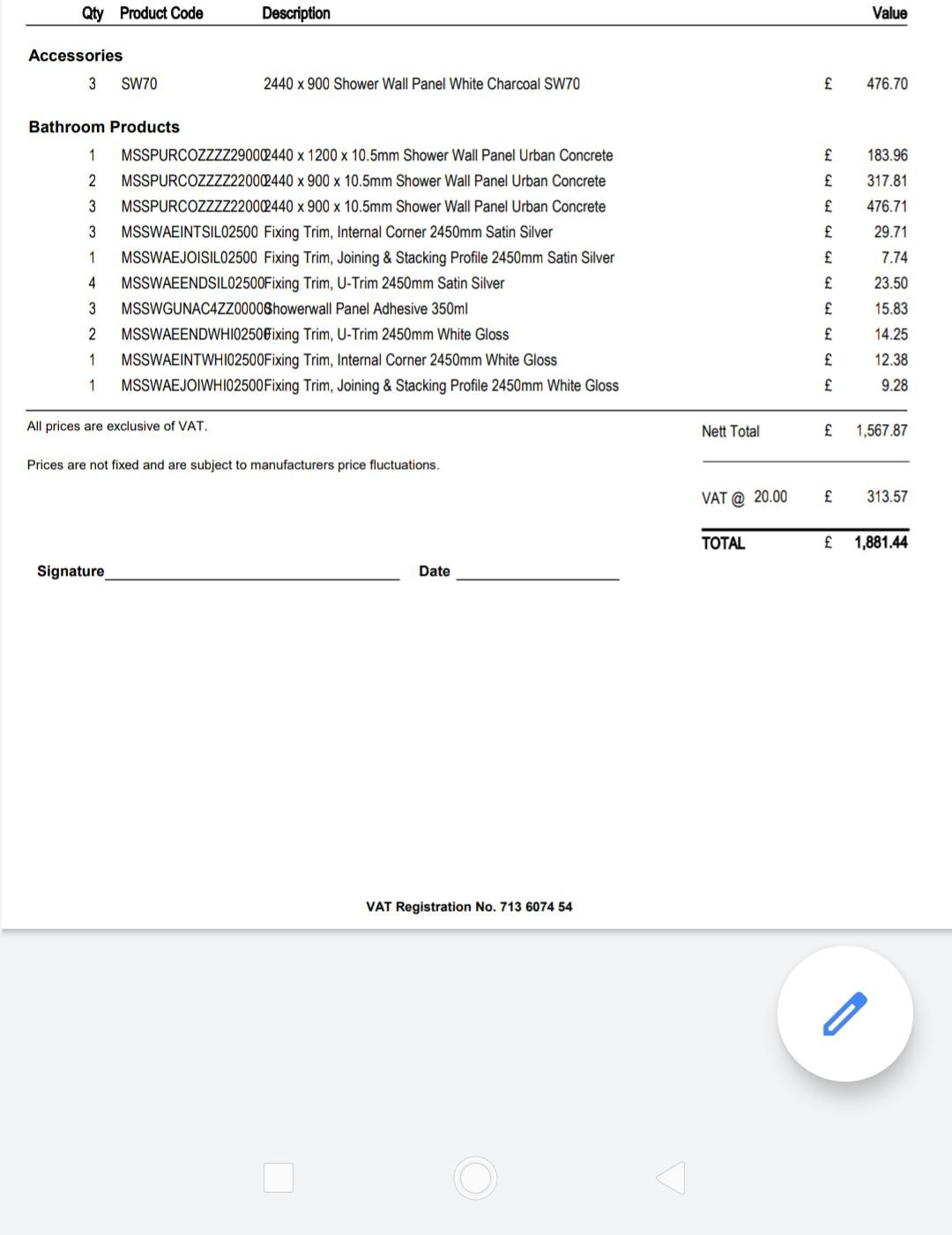

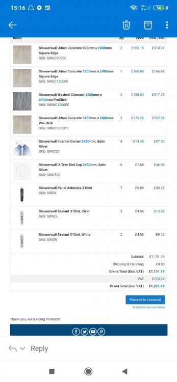

canalsiderenovation Posted November 16, 2020 Author Share Posted November 16, 2020 Would someone be so kind as to just look over this quote for our three showers and see if there are any alarm bells? Should there be something for sealing between the tray and panel. The showerwall brochure suggests a 'sureseal' Link to comment Share on other sites More sharing options...
