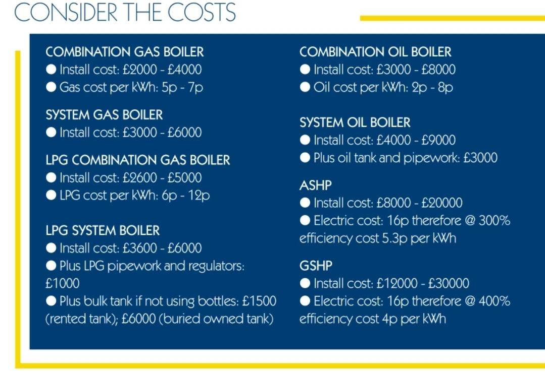

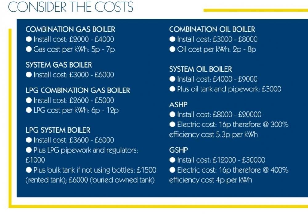

mjward Posted October 23, 2020 Author Posted October 23, 2020 One thing to add here is that I saw the below in a homebuilding magazine and was surprised that they say the running cost of the ASHP is comparable to a gas boiler. Given the larger equipment cost with ASHP, if the running cost is identical what makes people have a preference for ASHP?
DavidFrancis Posted October 23, 2020 Posted October 23, 2020 My current gas cost is just under 2.5p/kWh. Electricity is just under 15p. So you'd need a very, very efficient ASHP to improve on unit costs. But then there's a standing charge of about £80/year for gas that could maybe be eliminated. Using an ASHP may produce less CO2, but I don't know enough about the current grid mix and efficiencies to comment. I think the ASHP installation costs could be greatly improved-on with shopping around. Look at @ProDave's blog for example.
joe90 Posted October 23, 2020 Posted October 23, 2020 I think ASHP is ideal fir a new build where insulation etc can be maxed out and UFH installed, we have no gas (apart from bottled for a hob) I bought my ASHP on Ebay and self installed for less than a gas boiler would have cost. Every case is different.
ProDave Posted October 23, 2020 Posted October 23, 2020 The one thing against gas of course is for those who have no access to mains gas. That's us. So the only mains energy service available is electricity. Otherwise the choices are LPG gas, oil, or sold fuel. LPG gas is expensive, Oil is cheap at the moment but very volatile.
Oz07 Posted October 23, 2020 Posted October 23, 2020 It used to be a running theme on this forum people said if you had access to gas then use it. Regardless of how you build if you have mains gas is it not always cheaper? It's subsidised isn't it?
Conor Posted October 23, 2020 Posted October 23, 2020 51 minutes ago, Oz07 said: It used to be a running theme on this forum people said if you had access to gas then use it. Regardless of how you build if you have mains gas is it not always cheaper? It's subsidised isn't it? I was part of that crowd. But once you factor in servicing, standing charges, and the fact that you can get electric from as little as 5p/kWh on flexible tarifs, ASHP has a lower lifetime cost. But the main thing for me is I'm not directly burning stuff and pumping it in to the air. With SSE airtricity here, 80% of the electric over the course of the year comes from renewables. That, paired with my own PV means my carbon emissions are less than a gas boiler. 1
