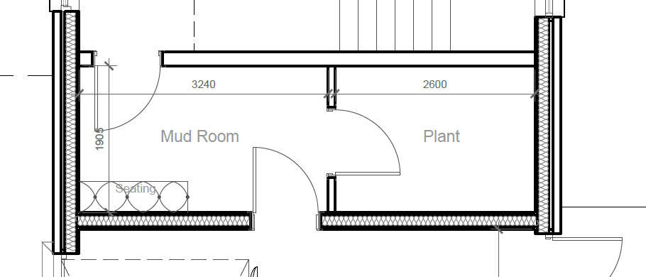

Russell griffiths Posted October 21, 2020 Share Posted October 21, 2020 Why not put a drain in the plant room. It will cost pennies, and take an extra couple of hours that’s all, better to have it than to need it. I have just changed 20m of 32mm water pipe and pulled and pushed it through the duct, two man job but very straightforward, install all ducts with pull cords in them or get one of the tools BT for pulling cables through, since buying the cable pulling tool I no longer need to leave pull cords in as I can push the fibreglass rod 50m through a duct. 1 Link to comment Share on other sites More sharing options...

SuperJohnG Posted October 21, 2020 Author Share Posted October 21, 2020 9 hours ago, Russell griffiths said: Why not put a drain in the plant room I think I was just avoiding putting multiple drain below the slab, I was trying to tie them all in the house so I had the minimal amount below slab tying together. I was thinking putting small waste pipes down through the slab and tying them in will be a pain to then tie them into the main 110m pipe. 9 hours ago, Russell griffiths said: I have just changed 20m of 32mm water pipe and pulled and pushed it through the duct, two man job but very straightforward, install all ducts with pull cords in them or get one of the tools BT for pulling cables through, since buying the cable pulling tool I no longer need to leave pull cords in as I can push the fibreglass rod 50m through a duct. What size duct did you use for the water pipe?, My mate has a cobra which I think will come in handy! 1 hour ago, Dan F said: No need to run cables, just put the ducts in with a pull-cord I was just thinking when I come to pull the cables in. Need to think about duct size just now for whatever size cable it will be. 1 hour ago, Dan F said: If you ensure there is a shallow bend on 110mm SVP ducting a 25mm MDPE will be a non-issue. 32mm is a much tigher fit with a standard shallow bend though. I went out to buy some 32mm MDPE just to ensure it went past shallow bend prior to pour. Do you just use a normal 110mm SVP pipe as the duct for this? or use a specific duct?. I should be 25mm MDPE, don't really see the need for 32mm I wouldn't think. 1 hour ago, Dan F said: We went with pre-insulated pipes for ASHP rather than ducting. Used REHAU RAUTHERMEX 25mm+25mm/111mm DUO PIPE". @ £22/m. These need to go in before the preperation for slab, as given the bend radius they need to go quite deep. Very helpful thanks - should look into part a little closer. Is this what most people do? thanks all - a lot of good input here. Link to comment Share on other sites More sharing options...
Dan F Posted October 21, 2020 Share Posted October 21, 2020 (edited) 22 minutes ago, SuperJohnG said: I think I was just avoiding putting multiple drain below the slab, I was trying to tie them all in the house so I had the minimal amount below slab tying together. I was thinking putting small waste pipes down through the slab and tying them in will be a pain to then tie them into the main 110m pipe. We ended up with two 110mm ducts in plant room for condensate/UVC overflow, just because this was easier than trying to pipe the condensate from one side of the plant room to the other. Ideally you don't have lots of SVP junctions under your slab, but using Y-junctions for drains that aren't toilets or kitchen sinks is acceptable. The is a NHBC guidance document called "‘Y’ JUNCTIONS IN DRAINS UNDER BUILDINGS" that talks about this. Quote Do you just use a normal 110mm SVP pipe as the duct for this? or use a specific duct?. I should be 25mm MDPE, don't really see the need for 32mm I wouldn't think. 110mm SVP pipe supplied and installed by MBC. If you need 32mm depends how many concurrent high-pressure showers you want to plan for ?. Costs a lot less to upgrade to 32mm now then do it later which might be impossible, is my POV though. Quote Very helpful thanks - should look into part a little closer. Is this what most people do? I don't know if most, but some people do. We felt it was the best approach for us. Depends how far away ASHP is, if you want it highly insulated, if you are happy to cement it in, and if you can go down under harcdcore to acommodate the bend radius or not. Clearly if you UVC is on an external wall, then this might make less sense and/or be less practical. The bend radius is about 0.5m+ from memory. Order pipe from https://www.loco2heat.co.uk/. Photo here. Note the long run is to a garden room, the short run on the left is for the ASHP. Edited October 21, 2020 by Dan F 1 1 Link to comment Share on other sites More sharing options...
SuperJohnG Posted October 21, 2020 Author Share Posted October 21, 2020 28 minutes ago, Dan F said: 110mm SVP pipe supplied and installed by MBC. If you need 32mm depends how many concurrent high-pressure showers you want to plan for ?. Costs a lot less to upgrade to 32mm now then do it later which might be impossible, is my POV So just normal drainage pipe. I was expecting it would done with an actual duct. Pictures are very helpful Dan thanks. Part that may be worrying me about drainage is the shallow invert levels I will have, but I think I changing the sewage treatment plant to a pumped type resolves all that. Then I cam just set it deep and also buy an extension for the head. Link to comment Share on other sites More sharing options...
Russell griffiths Posted October 22, 2020 Share Posted October 22, 2020 I ran 32mm mdpe water pipe in 80mm duct, it allowed for insulation around the pipe at the point it comes up through floor, you will pull 25mm in with your eyes closed. 110mm underslab, don’t run small 40-50mm under there. 1 Link to comment Share on other sites More sharing options...
SuperJohnG Posted October 22, 2020 Author Share Posted October 22, 2020 13 hours ago, Russell griffiths said: I ran 32mm mdpe water pipe in 80mm duct, it allowed for insulation around the pipe at the point it comes up through floor, you will pull 25mm in with your eyes closed. 110mm underslab, don’t run small 40-50mm under there. Makes better sense. Did you guys use a someone with a total station to get those drains bang on? or just measure them out. Link to comment Share on other sites More sharing options...

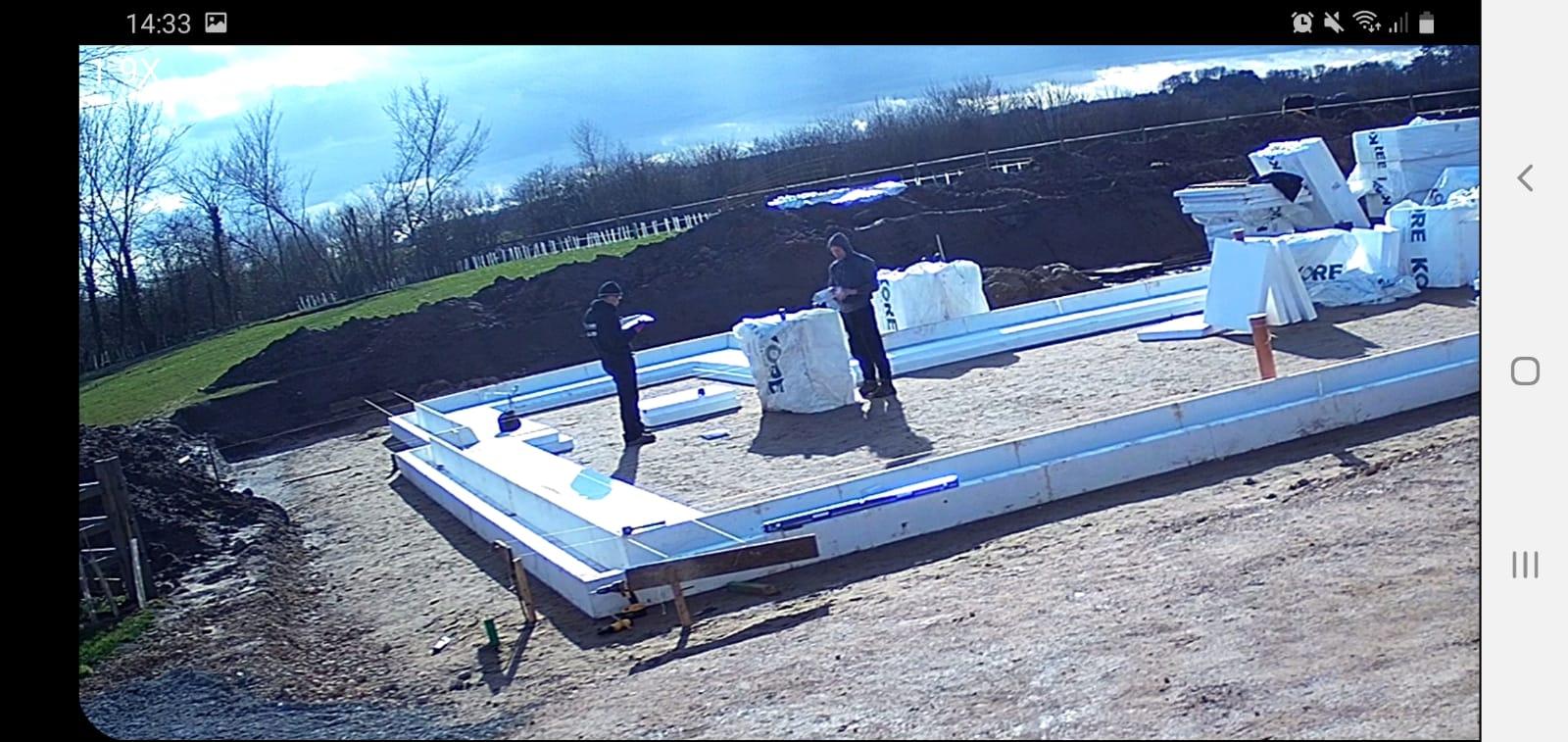

Dan F Posted October 22, 2020 Share Posted October 22, 2020 16 minutes ago, SuperJohnG said: Makes better sense. Did you guys use a someone with a total station to get those drains bang on? or just measure them out. In our case: - We had a surveroy set out foundation position. - MBC then measured drainage position from foundation edge based on drainage drawing provided by designer. Same with all ther other duct penetrations. 2 Link to comment Share on other sites More sharing options...
SuperJohnG Posted October 22, 2020 Author Share Posted October 22, 2020 6 minutes ago, Dan F said: In our case: - We had a surveroy set out foundation position. - MBC then measured drainage position from foundation edge based on drainage drawing provided by designer. Same with all ther other duct penetrations. Thanks Dan (you've been a great help here) Did the surveyor just peg out corners, I was thinking that might do then add profile boards or similar, just thought it might be difficult from the low position where there was no hardcore, as when you build might be a pain to keep the position of the EPS without getting surveyor back. I am maybe overthinking it...I am used to engineering tolerances. Link to comment Share on other sites More sharing options...
LA3222 Posted October 22, 2020 Share Posted October 22, 2020 (edited) 26 minutes ago, SuperJohnG said: Thanks Dan (you've been a great help here) Did the surveyor just peg out corners, I was thinking that might do then add profile boards or similar, just thought it might be difficult from the low position where there was no hardcore, as when you build might be a pain to keep the position of the EPS without getting surveyor back. I am maybe overthinking it...I am used to engineering tolerances. If you can, get your reference points outside the area you are building up. You need a datum somewhere that you can take your levels from, I hammered a nail into my fence post that serves this purpose as it was easily accessible but safely out of the way. Setting out is where I had difficulties. I had to excavate down which put me in a bowl for all intents and purposes and I couldn't set up profiles outside of this area as they would have been 1.5m above the ground - impractical. This meant i had to keep resetting out from scratch and then measuring as I went for things like drains - luckily its all worked out so far as I can tell. If your surveyor pegs out the footprint set up some profile boards out from them, say 3m or so should get you out of the 'working area'. Profiles about half metre wide then put a nail in on them and run string lines from them that line up with the setting out the surveyor did. You will have to tweet the nail positions slightly as you go in order to get the lines bang on. Once those nails are all in position it doesn't matter what happens with the work the surveyor did as you build the ground up. You can chuck some lines up between those nails and you've got your house marked out again. Ref drainage, like others I marked the house up and measured the 'x' and 'y' position of the drains from the outer walls. Think you can make out my half assed profiles in the pic? The shape of my house made the no. of profiles required a PITA! Edited October 22, 2020 by LA3222 1 Link to comment Share on other sites More sharing options...
LA3222 Posted October 22, 2020 Share Posted October 22, 2020 One other thing bud, give some thought as to how you set your profiles up - I'm trying to think back now but I recall i had issues at one point. I had a concrete toe beam cast in my EPS which didnt help with setting out. The insulated upstand which the soleplate sits on was quite a bit higher than the outer bit for mine and it was these diagonals I had to use to plumb the EPS. These dimensions are different to when you set the house out though as you do that use the outer corners so in my case the outer corners of the blockwork. I'm confusing myself here now with what I'm trying to get at?♂️ .....so I had to set the house out with outer corners of blockwork and then plumb it up with outer corners of soleplate dimensions. Both of which you'll need on your profiles potentially. Link to comment Share on other sites More sharing options...
Dan F Posted October 22, 2020 Share Posted October 22, 2020 (edited) 1 hour ago, SuperJohnG said: Thanks Dan (you've been a great help here) Did the surveyor just peg out corners, I was thinking that might do then add profile boards or similar, just thought it might be difficult from the low position where there was no hardcore, as when you build might be a pain to keep the position of the EPS without getting surveyor back. I am maybe overthinking it...I am used to engineering tolerances. They pegged out all the interecting lines that formed the corners (1-2 meters from actual house position) and also marked up levels on fence posts. Then: - Groundworker dug formation using these. - MBC then transferred this to there own small wooden frame type thing to fo mark the position of EPS corners once they'd compacted the hardcore. Edited October 22, 2020 by Dan F 1 Link to comment Share on other sites More sharing options...
SuperJohnG Posted October 22, 2020 Author Share Posted October 22, 2020 34 minutes ago, LA3222 said: If you can, get your reference points outside the area you are building up. You need a datum somewhere that you can take your levels from, I hammered a nail into my fence post that serves this purpose as it was easily accessible but safely out of the way. Setting out is where I had difficulties. I had to excavate down which put me in a bowl for all intents and purposes and I couldn't set up profiles outside of this area as they would have been 1.5m above the ground - impractical. This meant i had to keep resetting out from scratch and then measuring as I went for things like drains - luckily its all worked out so far as I can tell. If your surveyor pegs out the footprint set up some profile boards out from them, say 3m or so should get you out of the 'working area'. Profiles about half metre wide then put a nail in on them and run string lines from them that line up with the setting out the surveyor did. You will have to tweet the nail positions slightly as you go in order to get the lines bang on. Once those nails are all in position it doesn't matter what happens with the work the surveyor did as you build the ground up. You can chuck some lines up between those nails and you've got your house marked out again. Ref drainage, like others I marked the house up and measured the 'x' and 'y' position of the drains from the outer walls. Think you can make out my half assed profiles in the pic? The shape of my house made the no. of profiles required a PITA! This is great Jamie thanks. I fortunately have 4 stations already marked out on site with Hilti nails on fencepost from when the topo was done, Just the pisser is they are all +70m from the house footprint as that was the closest solid permanent structures on site as it was a field. I had used them to set out two closer new stations then marked out the house corners using arcs and a 50m surveyors tape, just so I could peg out corners and get a feel for where I wanted to place the house, they are accurate to a few 100mm, but obviously I want to mark perfect from them when doing the foundations. I'm similar that I need to dig down 600mm as I want my house 'in' the ground some what and that's where I may just have to do what you did to some extent. I have ACAD and all the drawings so getting X and Y positions is fine for everything. Profile boards now make perfect sense and should work, fortunately no blockwork just render board so might be a little simpler! BTW - The amount of soil you pulled out the ground - that's unreal almost! 30 minutes ago, LA3222 said: I'm confusing myself here now with what I'm trying to get at?♂️ .....so I had to set the house out with outer corners of blockwork and then plumb it up with outer corners of soleplate dimensions. Both of which you'll need on your profiles potentially. I'm also definitely confused here now ?. When you say plumb, I think 'Vertically plumb. Do you mean square? or am I just totally confused? E.g. when you measure diagonals on a square to make sure it is square and not a rhombus? Link to comment Share on other sites More sharing options...
SuperJohnG Posted October 22, 2020 Author Share Posted October 22, 2020 11 minutes ago, Dan F said: They pegged out all the interecting lines that formed the corners (1-2 meters from actual house position) and also marked up levels on fence posts. Then: - Groundworker dug formation using these. - MBC then transferred this to there own small wooden frame type thing to fo mark the position of EPS corners once they'd compacted the hardcore. Jammin thanks. Same as @LA3222 profile boards seem to be a good way forward. Link to comment Share on other sites More sharing options...
