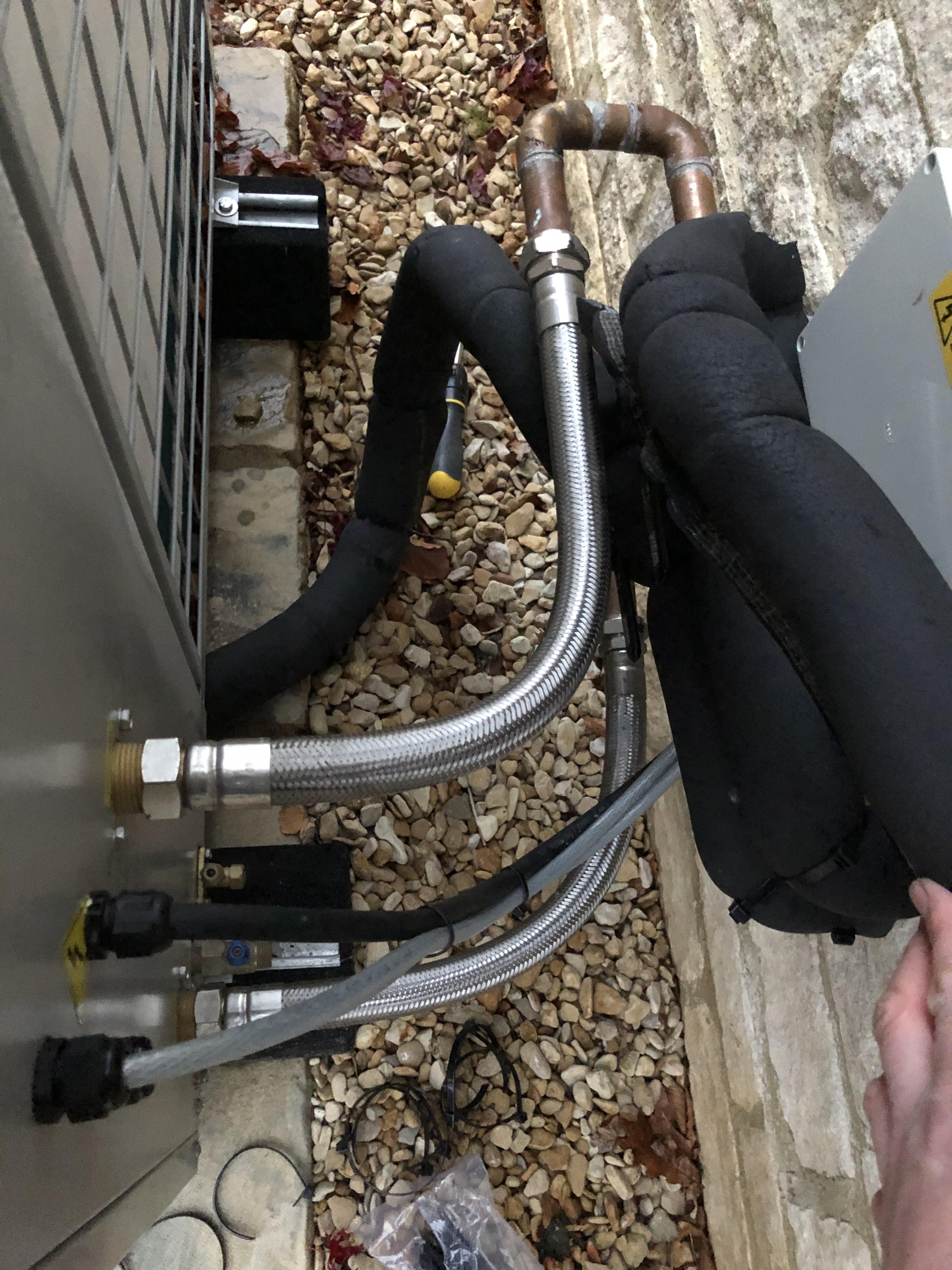

Jymmm Posted November 26, 2020 Share Posted November 26, 2020 (edited) We have ours placed outside our living room which i would not recommend. Installed with flexi hoses but still getting alot of 'mechanical' noise transferred into the room from the water pump and compressor. Its almost noisier inside the room than outside the house. The heat pump is only used for space heating. Acoustic Enclosures exist too Edited November 26, 2020 by Jymmm Link to comment Share on other sites More sharing options...
SteamyTea Posted November 26, 2020 Share Posted November 26, 2020 1 hour ago, Jymmm said: Installed with flexi hoses but still getting alot of 'mechanical' noise transferred into the room from the water pump and compressor Are the flexible pipes long enough? Link to comment Share on other sites More sharing options...
Jymmm Posted November 26, 2020 Share Posted November 26, 2020 21 minutes ago, SteamyTea said: Are the flexible pipes long enough? I'd have to check, is there any rule of thumb with the length? Link to comment Share on other sites More sharing options...
SteamyTea Posted November 26, 2020 Share Posted November 26, 2020 (edited) 2 minutes ago, Jymmm said: I'd have to check, is there any rule of thumb with the length? At least a metre, and not taught I think. Some hp manufacturers specify the length. Edited November 26, 2020 by SteamyTea Link to comment Share on other sites More sharing options...

Jymmm Posted November 27, 2020 Share Posted November 27, 2020 how long are your flow and return lines between the pump and the house? Mine is actually quieter outside than it is in the room it's attached to so something isn't correct in my installation. Link to comment Share on other sites More sharing options...
joe90 Posted November 27, 2020 Share Posted November 27, 2020 A previous member here (Jeremy) thought long flexible hoses were a waste so installed short ones and he suffered noise in the house, he replaced them with long ones (as specified in the MI,s) and the noise went away. Link to comment Share on other sites More sharing options...
Jymmm Posted November 27, 2020 Share Posted November 27, 2020 My flexi is approx 30cm and looks like this Link to comment Share on other sites More sharing options...
joe90 Posted November 27, 2020 Share Posted November 27, 2020 If I remember correctly Jeremy used 300mm flexes and had noise problems, he replaced them with much longer ones, in a loop, as per the MI,s and the noise almost disappeared. Shame he is not here anymore to confirm. Link to comment Share on other sites More sharing options...
Jymmm Posted November 27, 2020 Share Posted November 27, 2020 What do you mean by ‘MI,s’? Thanks for your info - I think I definitely need to try longer flexi Link to comment Share on other sites More sharing options...
