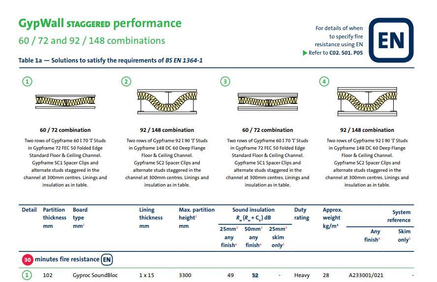

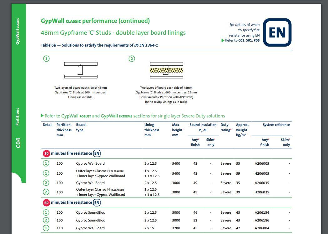

willbish Posted October 18, 2020 Share Posted October 18, 2020 Not that much to read on the forum regarding metal stud walling and the different configurations. Ive got 26 running metres of partition walling to put up, most at 2.4m high Having had a good gander at the 'White Book' Im drawn to a couple of options Either I studs staggered with 1 sheet of soundbloc each side, 50mm acoustic roll. 102mm depth overall Shown here, pic 1: Or C studs with double sheets of standard board, 50mm acoustic roll. 100mm deep. Closely pictured as number 2: I haven't yet done any cost comparison with timber yet, any good suppliers to approach? I'll give my local builders merchants a buzz tomorrow but I'm not confident they'll be at all competitive or even know what Im on about.. @Dreadnaught was going down this route, how far did you get? Link to comment Share on other sites More sharing options...

Moonshine Posted October 18, 2020 Share Posted October 18, 2020 Go staggered if you can, a 3 dB increase in sound insulation isn't to be sniffed at. Typically a metal frame wall will acoustically out perform a timber stud of a similar build up. Link to comment Share on other sites More sharing options...

nod Posted October 18, 2020 Share Posted October 18, 2020 Metal stud out performs timber Straighter Wont shrink Acoustically out performs timber Three time quicker to install Can be built 9 mtre high and remain plumb I stud is much stronger than timber You can nog out But most just use flat plate Each year we do groups of between 150 -200 roomed student accommodation Nearly always TF due to time restraints The partitioning would be easy for Tge TF guys to do as they go along But due to sound fire We follow them through with the framing Wiring and plumbing is also much easier with MF Pretty much like Possi v Solid timber joists 1 Link to comment Share on other sites More sharing options...
willbish Posted October 18, 2020 Author Share Posted October 18, 2020 Nice one thanks @nod Do you notice any difference in rigidity with say staggered I studs at 300 centres compared to C studs not staggered at 600. Neither are fixed top at bottom so I'm guessing no/not a lot of difference Link to comment Share on other sites More sharing options...
nod Posted October 18, 2020 Share Posted October 18, 2020 4 minutes ago, willbish said: Nice one thanks @nod Do you notice any difference in rigidity with say staggered I studs at 300 centres compared to C studs not staggered at 600. Neither are fixed top at bottom so I'm guessing no/not a lot of difference Any stud set at 300 will be more rigid than 600 It’s quite rare to set mf studs at 3 or 400 Usually I stud that is load baring We often build 5 mtr high walls and the strength comes from double staggered boarding I set our at 600 and used a 15 mil SB single layer Very solid at only 2.6 high Link to comment Share on other sites More sharing options...

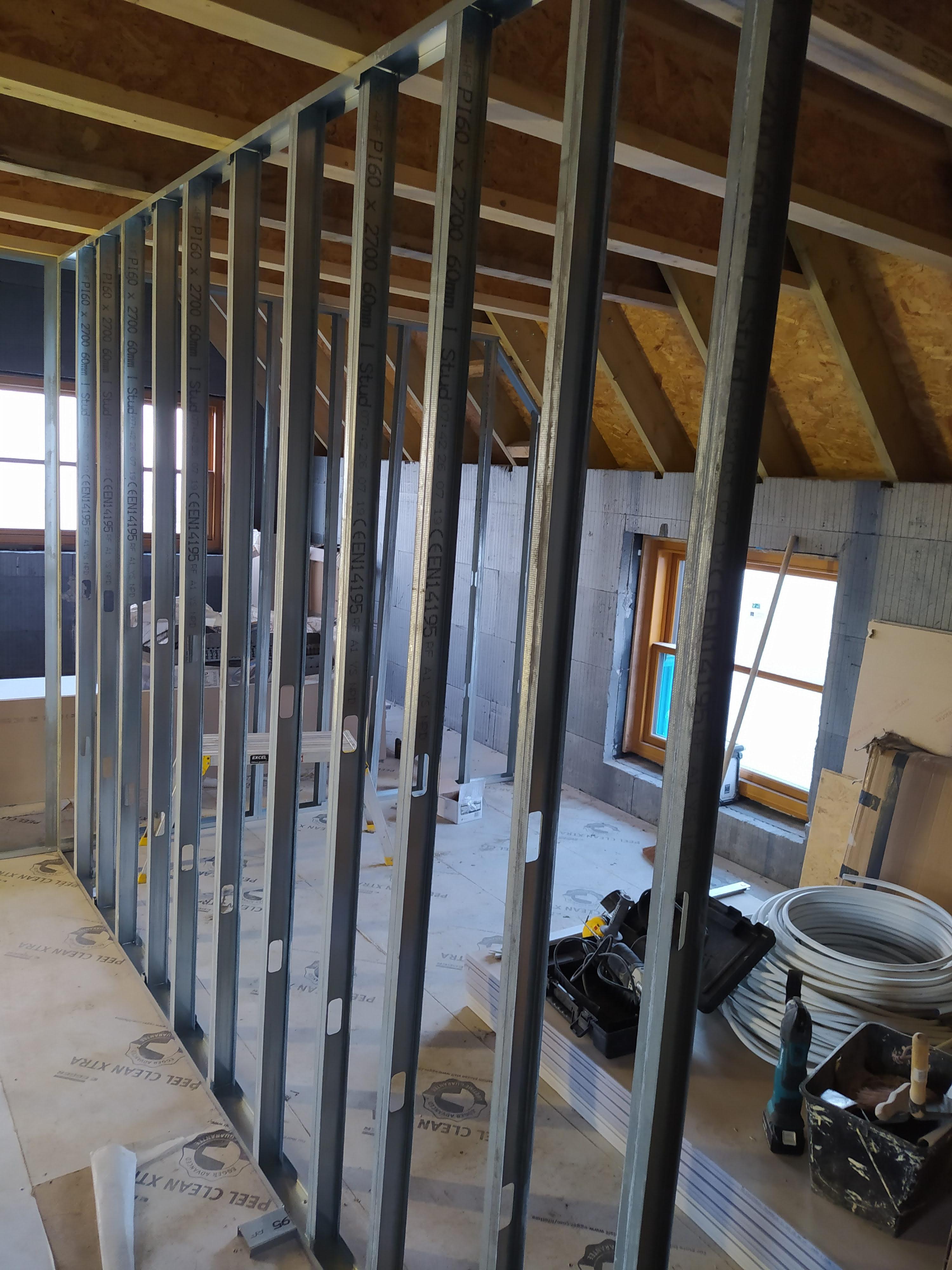

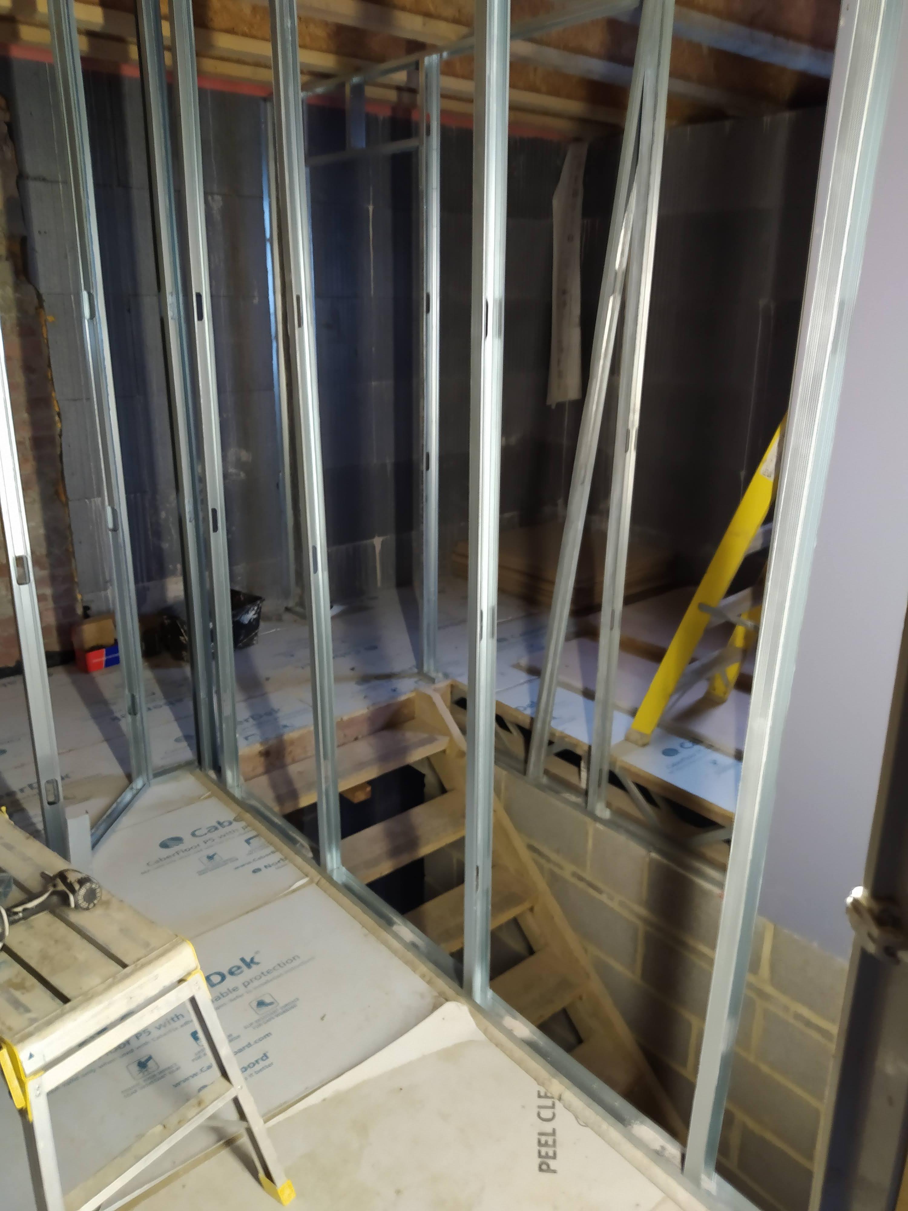

willbish Posted January 5, 2021 Author Share Posted January 5, 2021 I've been on a metal stud learning curve the last week. So far so good, only the single one inch laceration to my finger to mention. But it sure flies up quick once you get used to it I chose a mixture of wall make up. Between bedrooms and corridors I've used 72mm track with 60mm I studs staggered. For cupboard, wardrobes and areas where sound transmission is not so critical I went for 52mm track with 50mm C studs. 9mm ply then PB The British Gypsum white book is really useful for selecting the components, then when purchasing switched to Tradeline brand as significantly cheaper. Chatting with a plasterer today and he's saying I really should be using noggins, even though White book says not necessary. I mentioned that Im using 15mm soundbloc board and he said even more reason to nog, anyone know why this might be? So that got me thinking about chucking some in there just to be sure. But with the staggered studs this is not going to be possible. On 18/10/2020 at 20:13, nod said: You can nog out But most just use flat plate Is the flat plate really going to make much difference? I cant see how thin plate (0.3mm thick i think) is going to make any difference. All my boards are vertical, just under 2.4m ceilings, perhaps that makes a difference. 1 Link to comment Share on other sites More sharing options...
willbish Posted January 5, 2021 Author Share Posted January 5, 2021 A couple of pictures 1 Link to comment Share on other sites More sharing options...
nod Posted January 5, 2021 Share Posted January 5, 2021 No Nogs needed Tell him to stick to plastering ? 1 Link to comment Share on other sites More sharing options...
willbish Posted January 5, 2021 Author Share Posted January 5, 2021 1 minute ago, nod said: No Nogs needed Tell him to stick to plastering ? ? Consider it done Link to comment Share on other sites More sharing options...
Dreadnaught Posted January 5, 2021 Share Posted January 5, 2021 @willbish, beginner question. In your (splendid) photos, all the walls seem to run at 90º to your joists above. What what if a wall ran in-line with the joists but there wasn't a joist directly above, just a void? In your photos, is it only the second photo that has staggered studs? Are those 300 centres? These seems to be some sort of spacer at the bottom or am I just seeing things? Really great to read about your experience. Thinking of using metal studs in my build. Link to comment Share on other sites More sharing options...
nod Posted January 5, 2021 Share Posted January 5, 2021 If the stud lands inside a joist We normally Use a piece of shallow track (Floor Track) Cut 50 mil in at either end the flattened Turn it upside down Set them at 600 and they will also carry your ceiling 1 Link to comment Share on other sites More sharing options...
willbish Posted January 5, 2021 Author Share Posted January 5, 2021 That would be a neat and quick solution @nod has just proposed. In my amateur way I would have cut timber noggins in between the ceiling joists. 28 minutes ago, Dreadnaught said: is it only the second photo that has staggered studs? Are those 300 centres? These seems to be some sort of spacer at the bottom or am I just seeing things? Yes, yes and yes. Spacer clip SC1 1 Link to comment Share on other sites More sharing options...
nod Posted January 5, 2021 Share Posted January 5, 2021 You will also find it easier if you use deep track on tops Link to comment Share on other sites More sharing options...
