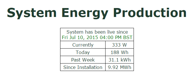

jack Posted January 16, 2017 Posted January 16, 2017 We have an 8.5kW array on two sections of flat roof on the Hampshire/Surrey border. About 40% of them are facing directly south at a fairly shallow angle. The remaining 60% are in a flat east-west concertina shape with a very slight tilt towards the north. There's some morning shading throughout the year. We went for Enphase microinverters following modelling that showed how much more power would be generated. This is the summary from about half an hour ago: It's dull and rainy here this morning, so I'm surprised we even have that much being generated.

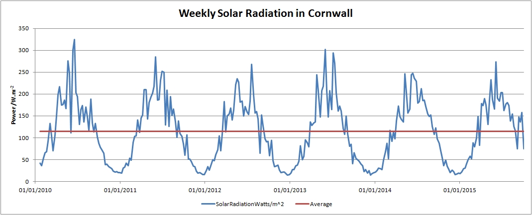

SteamyTea Posted January 16, 2017 Posted January 16, 2017 The UK had a brighter than usual year last year, unlike 2012 (I think), when it was unusually dark.
jack Posted January 16, 2017 Posted January 16, 2017 Wasn't 2015 pretty dim too? I seem to recall people talking about day after day towards the end of the year with zero production!
SteamyTea Posted January 16, 2017 Posted January 16, 2017 (edited) You can get the data here, if you ask nicely. https://badc.nerc.ac.uk/data/surface/radt_file_format.html I don't have time to look at it at the moment. Edited January 16, 2017 by SteamyTea

SteamyTea Posted January 17, 2017 Posted January 17, 2017 Quick chart to show the variation of solar radiation over a few years.
