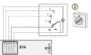

@larry @Olf @Levo I've been looking in to this a bit more. None of the standard Brink units come with a built in RH sensor - just temperature. So only boost option is single contact push button for a 30min boost. Also, if you want a RH sensor, you need to buy the "plus" version, so that's another £180 or so. And sensor seems to be another £140... so not so cheap after all.
Edited by Conor
My cunning plan is to hack the speed controller socket (X14): it's a bunch of volt-free contacts wired to RJ12 plug. Added benefit is that the humidity sensor can be made smart: response to spike of the level above average, rather than fixed level - which if set low, on some damp days can trigger MVHR to boost all the time.
