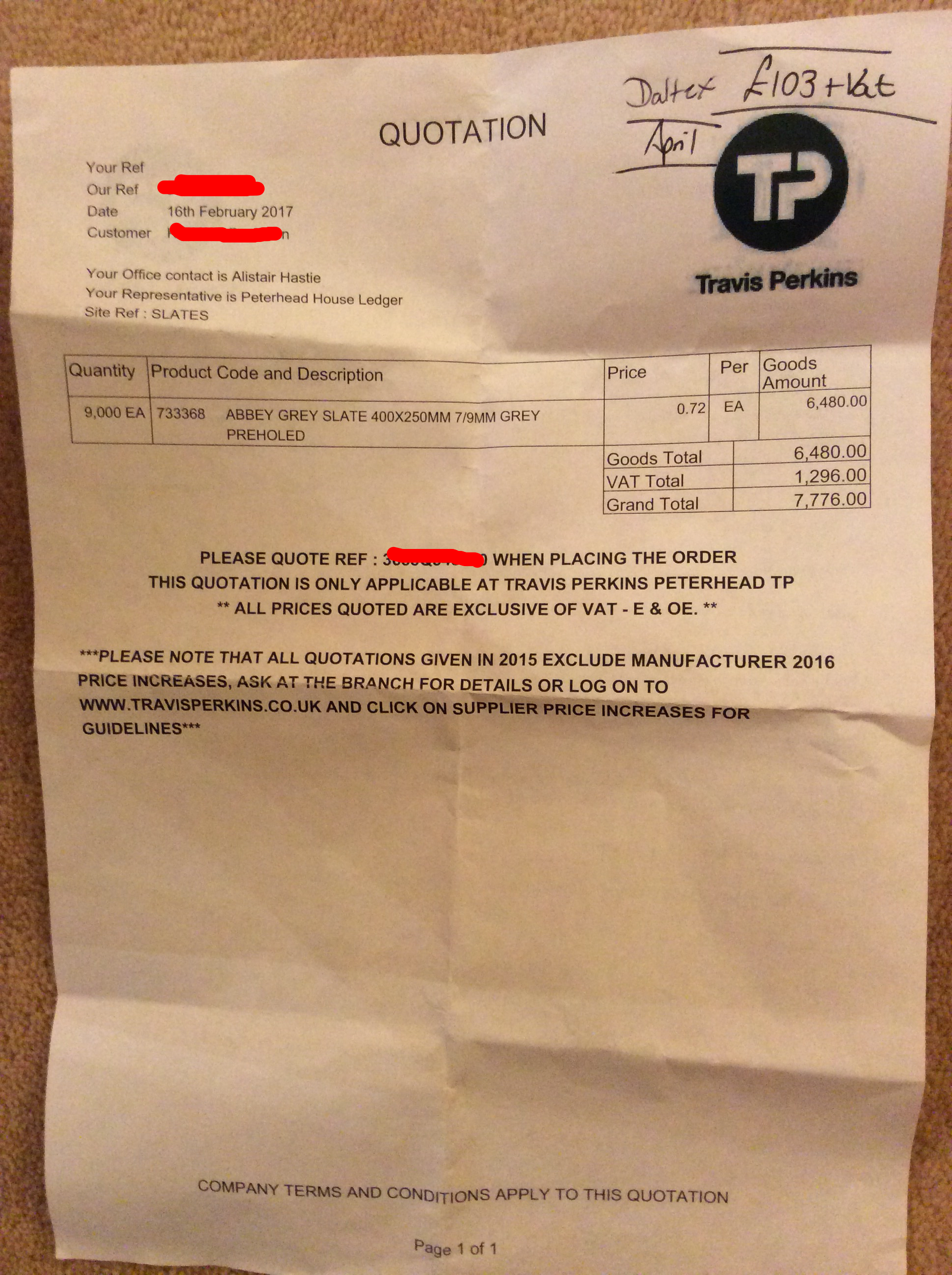

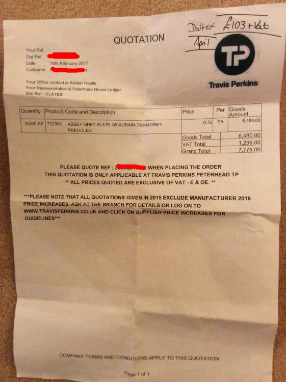

Thanks folks TP have surprisingly gave us the best quote of £0.72(+vat) per slate, 7-9mm, A1, S1, T1 , preholed, 400x250mm (16x10) grey Royal Ascot "abbey" slate.
if anyone else was working out their M2 of roofing that's 25/m2...
Couldn't see any visible pyrites in sample slate ?
Had a look on the TP web site and can't find any reference to these slates at all?

Posted
As below, but to be fair, I can't find them online either,  hope it helps ?
