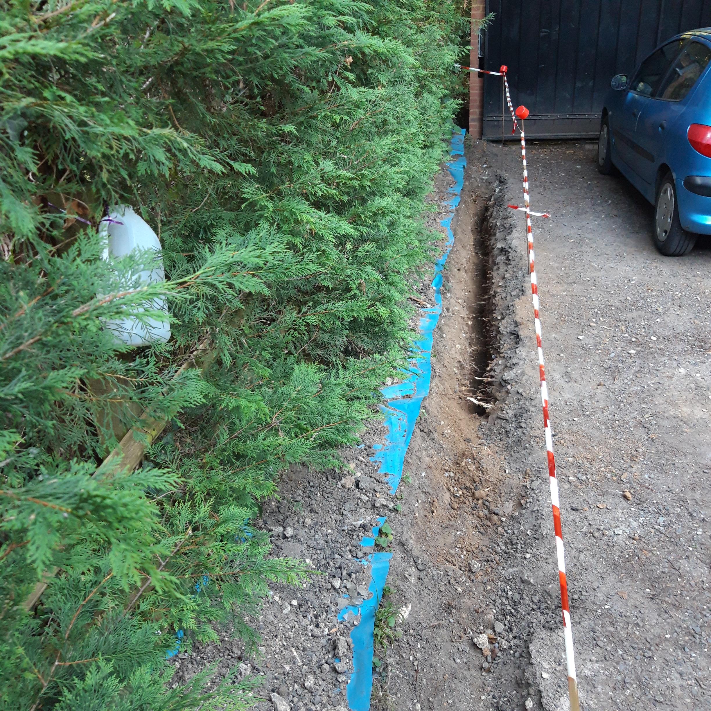

Dreadnaught Posted September 19, 2020 Share Posted September 19, 2020 My ground workers are moling my water pipe today in my access road. All going well. There is one duct for an electricity cable (see photo). They are proposing to go OVER the duct with the water pipe. The water pipe will be only 300mm deep at the point. Is that ok? Would it be at risk of freezing? Should I kick up a fuss and ask them to go UNDER the exposed duct SO its depth is 800mm as it is for the rest of the run? Link to comment Share on other sites More sharing options...
PeterW Posted September 19, 2020 Share Posted September 19, 2020 Frost won’t be an issue but your water company may not be happy as they may insist on it being 6-700mm. The site survey from the utility company should show that cable anyway - it seems very shallow for electric ..? Link to comment Share on other sites More sharing options...
Jilly Posted September 19, 2020 Share Posted September 19, 2020 (edited) I'm just going through the shared duct thing and my builder said the water needs to be lowest at 900mm and the electric above at 600mm, I think, but double check properly. Edited September 19, 2020 by Jilly Link to comment Share on other sites More sharing options...
tonyshouse Posted September 19, 2020 Share Posted September 19, 2020 300mm deep is NOT OK 760 is the norm and will be required bt the water company, take photos or better dont backfill, they would normally inspect Link to comment Share on other sites More sharing options...

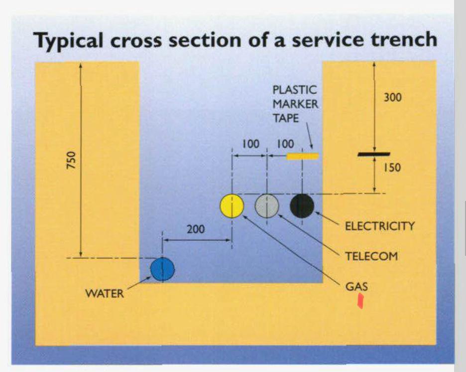

Bozza Posted September 19, 2020 Share Posted September 19, 2020 (edited) +1 see attached water needs to be lower Edited September 19, 2020 by Bozza Link to comment Share on other sites More sharing options...
Onoff Posted September 19, 2020 Share Posted September 19, 2020 When you say "my access road" is it yours or just the road to your property etc as there are specific depths to be adhered to when it comes to street works. Whatever, water is always 750mm afaik. Leccy 450mm min. They vary for instance if across agricultural land (say it might get ploughed). This might be of interest: V1-Positioning-Colour-Coding-Issue-8.pdf Link to comment Share on other sites More sharing options...

Nickfromwales Posted September 19, 2020 Share Posted September 19, 2020 Under, deffo NOT OK to come above, and a bit worrying that he would suggested it tbh!! Link to comment Share on other sites More sharing options...
Dreadnaught Posted September 20, 2020 Author Share Posted September 20, 2020 Thanks all! Very helpful. A busy day yesterday. The pipe is now (along with a fibre-option-cable duct) in and I have lots of photos that I can share with Anglian Water. In the end, we didn't remake the concrete road surface around the duct that I mentioned, with a road plate over for protection. This will enable us to easily revisit it again if Anglian Water requires it. Interestingly, a few days ago Anglian Water said that they don't come out to inspect the installation of a TBS. (temporary builders supply). I will send them the photos and see what they say. 1 Link to comment Share on other sites More sharing options...

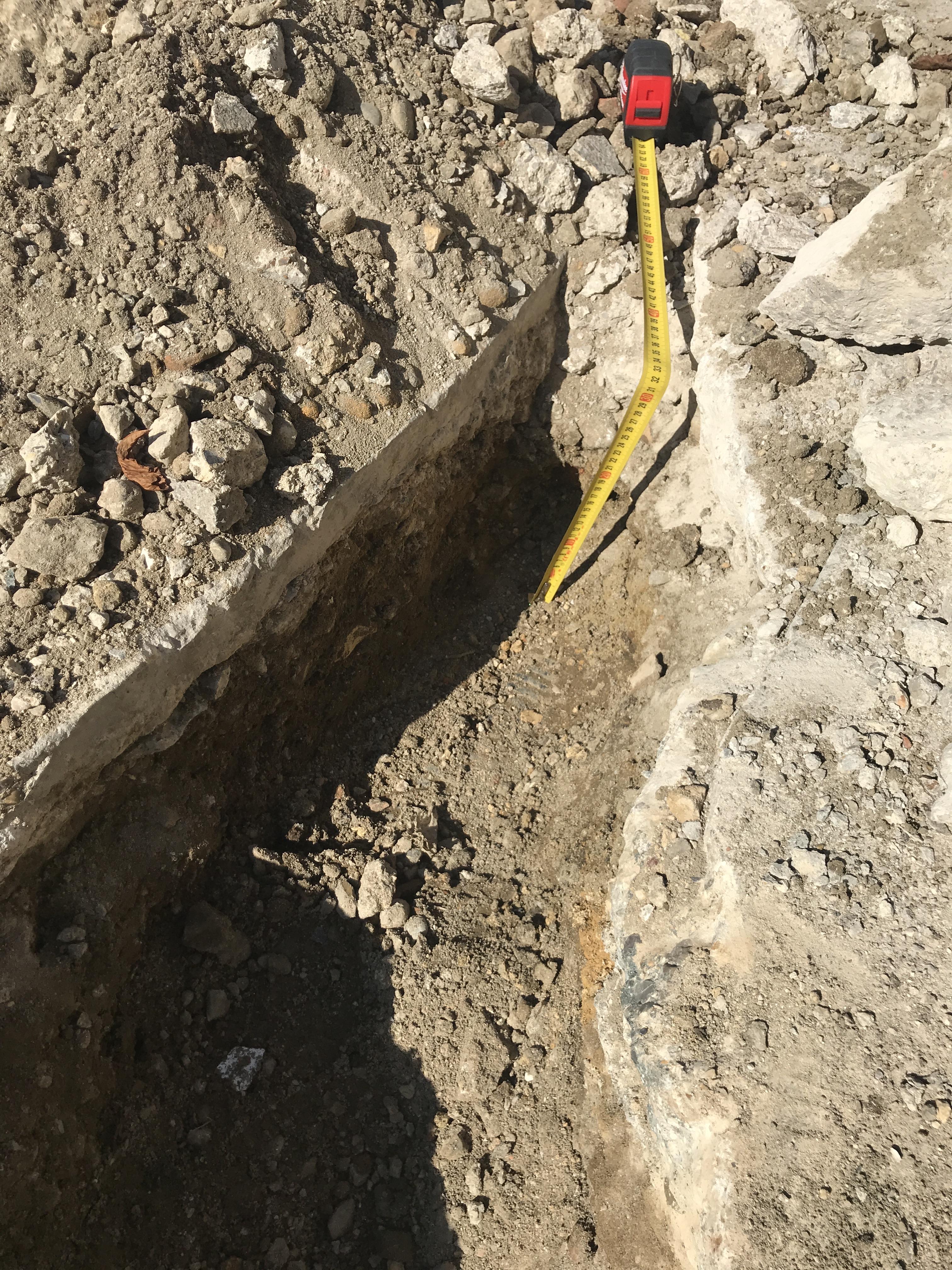

Oz07 Posted September 20, 2020 Share Posted September 20, 2020 Its all well and good saying 750mm which we do but have you ever seen the depths that the water boys actually put it in at. Multiple times i've seen them within 400mm of the surface they're lazy when it comes to obstacles and connections 1 Link to comment Share on other sites More sharing options...
Big Jimbo Posted September 20, 2020 Share Posted September 20, 2020 41 minutes ago, Oz07 said: Its all well and good saying 750mm which we do but have you ever seen the depths that the water boys actually put it in at. Multiple times i've seen them within 400mm of the surface they're lazy when it comes to obstacles and connections Agree with the above. I punctured a yellow gas pipe, 250mm below surface. Transco came out and fixed it, then sent me a bill. I sent the bill back and said that the pipe should have been deeper. Never heard from them again. So in that house, it is still 250mm below the surface. 1 Link to comment Share on other sites More sharing options...

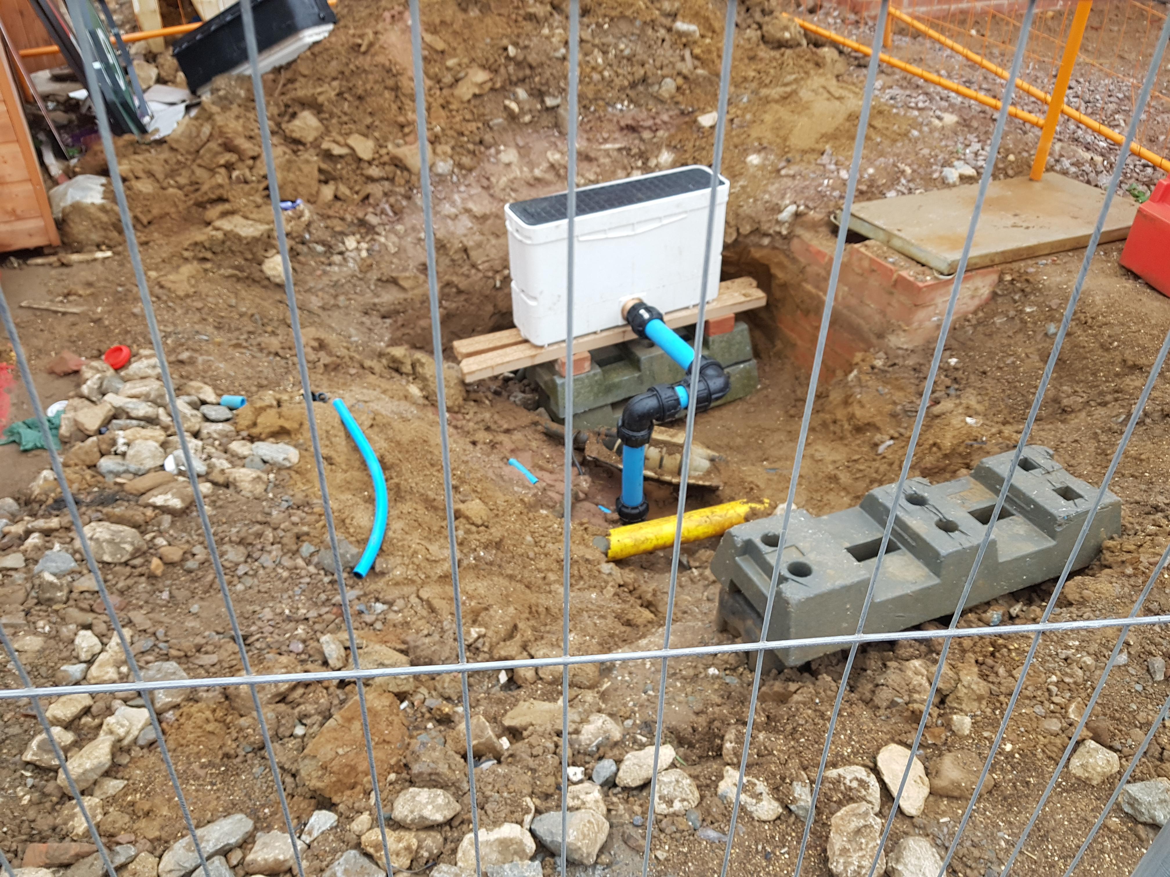

Oz07 Posted September 23, 2020 Share Posted September 23, 2020 Case in point. On today's job. All 3 within a nats bollock Link to comment Share on other sites More sharing options...
Big Jimbo Posted September 23, 2020 Share Posted September 23, 2020 2 minutes ago, Oz07 said: Case in point. On today's job. All 3 within a nats bollock Wow. could they not have got them any closer. That is real world, rather than the paper drawing. Link to comment Share on other sites More sharing options...
PeterW Posted September 23, 2020 Share Posted September 23, 2020 5 minutes ago, Oz07 said: Case in point. On today's job. All 3 within a nats bollock Wonder if those heras bases holding the water up will become a permanent installation..?? ? 1 Link to comment Share on other sites More sharing options...
Oz07 Posted September 23, 2020 Share Posted September 23, 2020 Well its stoned up and gone now was only ecposed from 4pm till 8am. I quickly snapped a pic this morning Link to comment Share on other sites More sharing options...
