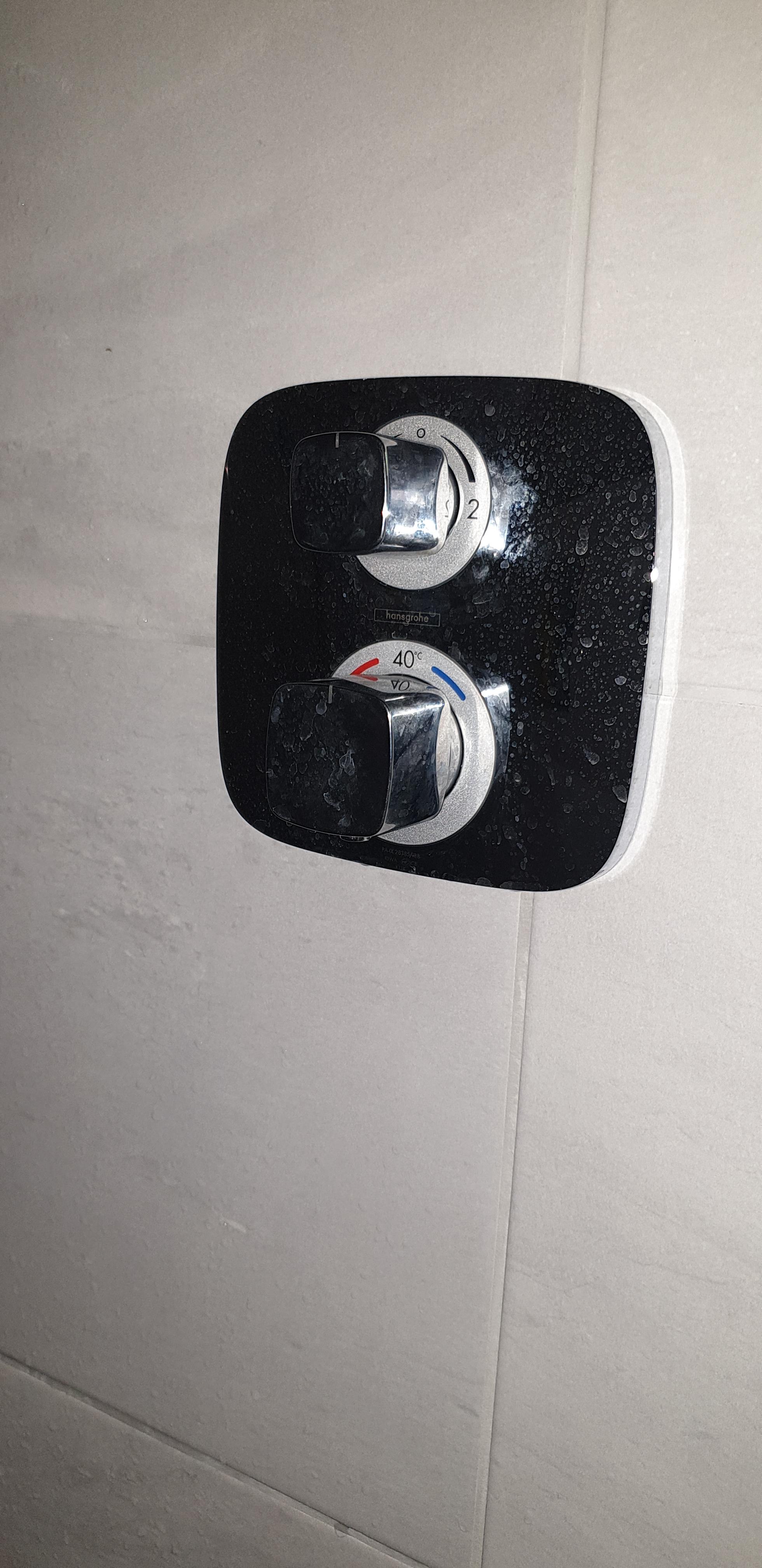

ToughButterCup Posted September 15, 2020 Posted September 15, 2020 I've used Hansgrohe iBox. It has a 'settable ' default temperature (40).
