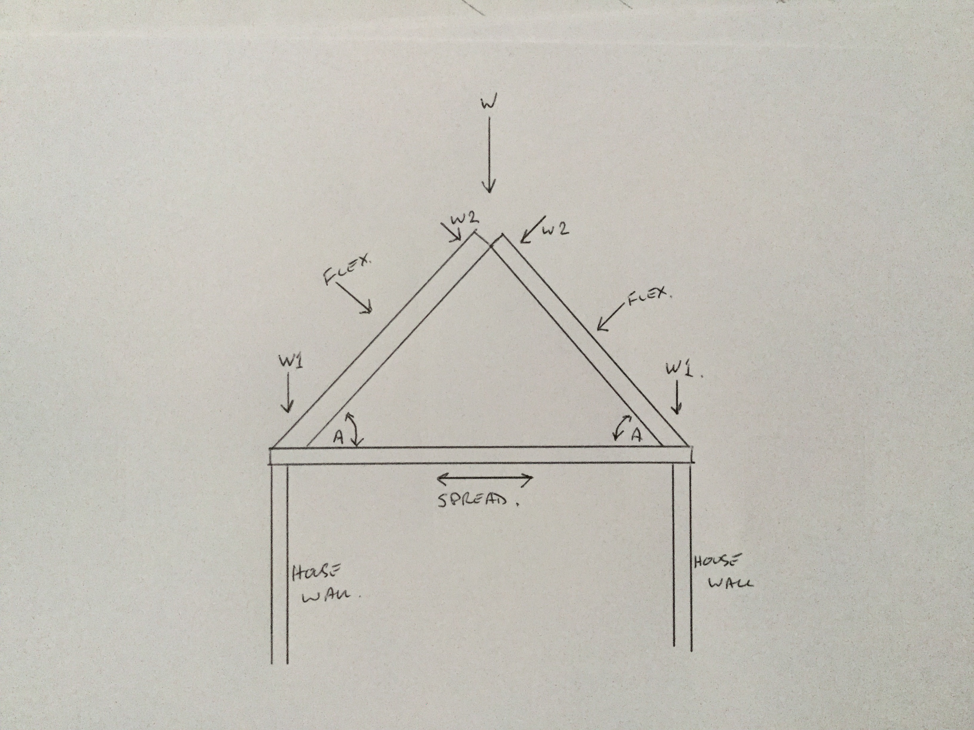

joe90 Posted January 12, 2017 Author Posted January 12, 2017 Sorry guys but this is bugging me so I needed to do a drawing, now from my very simplistic drawing I fail to understand why "W" needs support from below 1/. flex is the bend within the rafter and it depends on the weight and depth of the timber/ijoist 2/. Spread is the tension in the ceiling joists created by the weight of the whole roof ( I admit this could be less if a ridge beam were installed) 3/. W1 is the equal weight on both wall plates of the whole roof ( unless a ridge beam is installed) 4/. W2 is the equal and opposite weight both sides of the roof create by resting on one another ( think of house of cards) The various pressures are dependant on angle a. therefore if all the above is adequate there is no need for W to be supported I.e. No ridge beam.
DavidFrancis Posted January 12, 2017 Posted January 12, 2017 This probably does nothing to answer your main question, but in a strong wind I'd have thought your W forces could be considerably different one side to the other. Also possibly with wind-blown snow.
joe90 Posted January 12, 2017 Author Posted January 12, 2017 17 minutes ago, DavidFrancis said: This probably does nothing to answer your main question, but in a strong wind I'd have thought your W forces could be considerably different one side to the other. Also possibly with wind-blown snow. I would have to agree but there is still no difference between a lumber made roof and and I beam roof.
ProDave Posted January 12, 2017 Posted January 12, 2017 What your drawing misses, is Purlins to take part of the flex load, and transmit it partly to the gable walls, and partly to any supporting props they may have. But weren't you talking of a hipped roof?
joe90 Posted January 12, 2017 Author Posted January 12, 2017 The purlins are missed on purpose, I don't want them, need them.! The main reason for a clear roof space with a warm roof is to create a VCL with osb cladding and not have lots of "posts" etc poking through. ( yes I know I have to deal with ceiling joists) I want to stay away from tapes and rely on glued joins for air tightness. The span ( 5 mtrs) of the rafters is more than coped with using 302mm I joists, the walls and stretcher ceiling joists can also easily cope with the loads, it's just this ridge thing that has got under my skin as I don't see it's need ( enter an S.E. who explains why I am completely wrong ?)
Simplysimon Posted January 12, 2017 Posted January 12, 2017 On 09/01/2017 at 20:49, ProDave said: In a gable ended roof, with the ridge supported on the gables, the ridge beam takes half the weight of the roof, and importantly stops the roof spreading allowing room in roof situations where upstairs you might have half height walls. sorry @ProDave, it doesn't, the ridge carries no weight. it is there purely to make the fixing of the rafter easier. a trad roof can be built without a ridge and in no way stops the roof spreading, a collar tie would stop the spread. Joe is talking about a hipped roof. So there is no gable to take the weight, that is taken by the sloping beams at the hips. This type of roof needs ties at floor / ceiling level to stop the roof spreading, and usually intermediate support on purlins. again, no. the hips will transmit a small amount of load but not much, it would need to be a point load at the junction of the crown, hip and first pair of commons. again a ridge is not required, however, the main part of the roof would need to be sheeted to avoid the roof falling like pack of cards when the crown and hip rafters were placed. the best trad roof is a pole plate which cannot spread under any circumstance. On 09/01/2017 at 20:49, ProDave said: I can't see the loading on the gable beam being very high and am surpised someone thinks it needs a glulam beam. i agree! simon
Simplysimon Posted January 12, 2017 Posted January 12, 2017 @joe90 , if the i beams are both cut with the plumb cut and well cut to ensure full contact, there should be no requirement for a beam. there would probably be a need for a ply/osb solid brace cut and fitted into the web on both sides probably 500/600mm long to tie them both together. again once the roof cladding is fixed there should be no movement but isuppose belt and braces. simon
