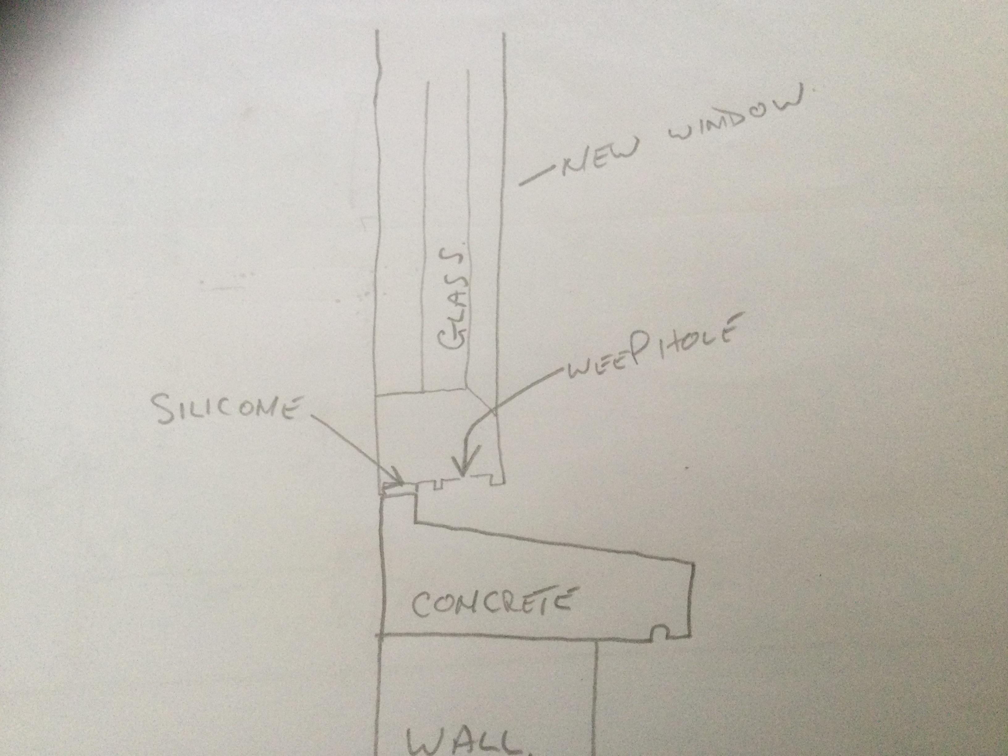

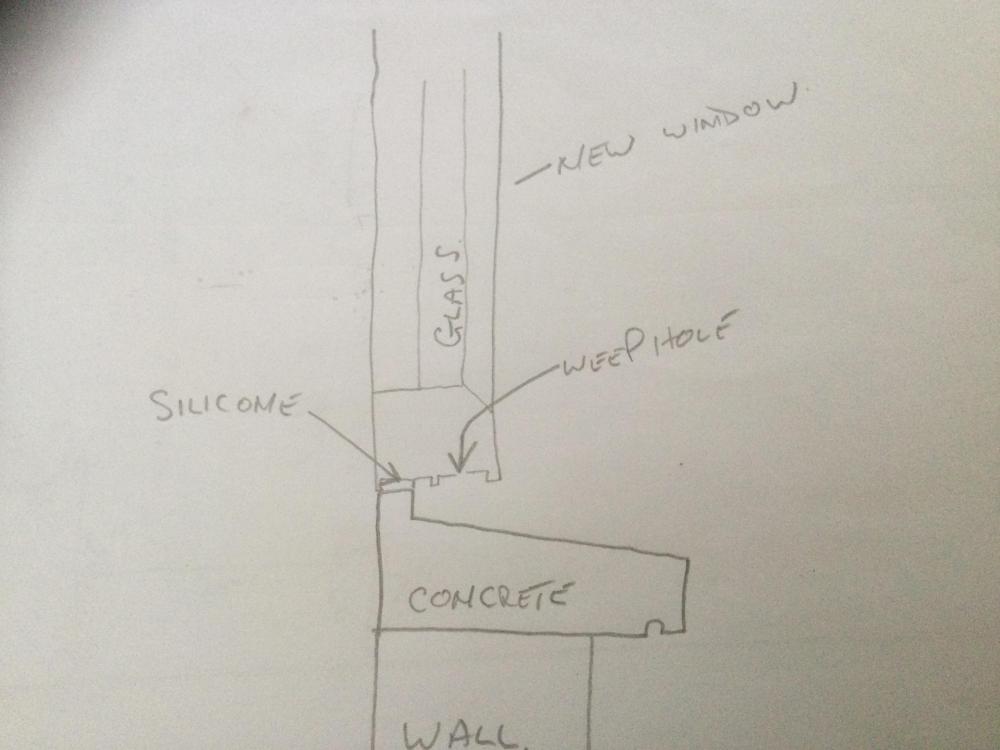

zoothorn Posted August 28, 2022 Author Posted August 28, 2022 On 02/08/2021 at 16:57, joe90 said: Yes, here is a (bad) drawing if what you will have. Your existing concrete cill should have a small upstand at the back when you remove the timber window. This will allow any moisture that gets into the window frame to drip out and run down your concrete cill. Just make sure to put sone silicone on the concrete cill only at the back so as not to block this weep hole Expand Hi J, thanks so much for this useful sketch.. a while ago! Finally onto the job, got 3 dry days. I just hacked away my old frame ok. At long last have new upvc frame. So all systems go. Only 3 pages so far (gone over replies before I started). Ok I've got this pickle confronting me.. a bit daunting. I wonder if you could shed a few thoughts what to do 1st? Thanks, zh
zoothorn Posted August 28, 2022 Author Posted August 28, 2022 Got my frame whittled in place, but problem I have is it doesn't sit on the concrete cill. Frame pretty much sits bang over the cavity. So do I need to form a new cill? It can't be more than 15mm H absolute max though whatever it is. Thanks, zh
zoothorn Posted August 28, 2022 Author Posted August 28, 2022 (edited) @PeterW or @joe90 I wonder if you could help. (I'm panicking a bit with gloomy skies, & a big ole in me house!). Was hoping the new frame would sit on the concrete cill, but misses it (pic 1 looking straight down). So I have to form some kind of shelf below or something. Got about 15mm H max. Any idea what I can do? Thanks, Zoothorn. Edited August 28, 2022 by zoothorn
