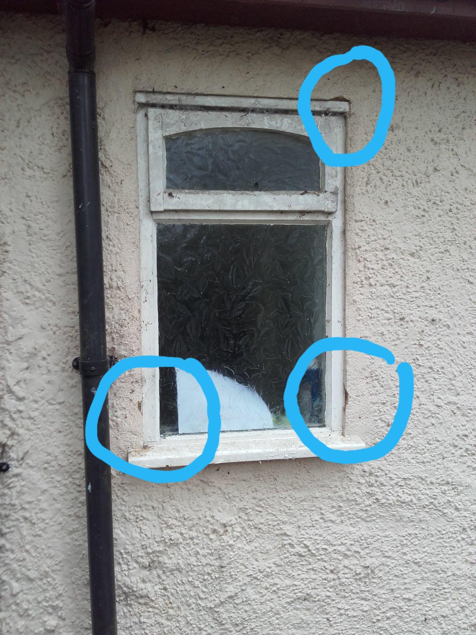

zoothorn Posted September 4, 2020 Posted September 4, 2020 Hi, I want to replace an old wood single glaze window, for my U T room renovation. Could I ask some basic Q’s, advice. Is this a fairly straightforward job on the whole? Should I be measuring the hxw of opening from inside, and addIng 5mm to each side, top, btm to get my new upvc size to order? Before whacking old one out? Any general tips appreciated, thx zh.
nod Posted September 4, 2020 Posted September 4, 2020 If you chip a bit of plaster off on all sides of the frame or remove the mastic on the outside You will be able to measure the frame that’s in and get the same size They normally take a week to ten days to come in
zoothorn Posted September 4, 2020 Author Posted September 4, 2020 3 hours ago, nod said: If you chip a bit of plaster off on all sides of the frame or remove the mastic on the outside You will be able to measure the frame that’s in and get the same size They normally take a week to ten days to come in You mean chip plaster off outside, &/or mastic.. both on the outside rather than chipping off inside?
craig Posted September 4, 2020 Posted September 4, 2020 Measure width and height inside and measure width/height external (not the window size) and you can take your measurement from there. Your window size will “generally“ be 5mm to 10mm larger than your internal size.
zoothorn Posted September 4, 2020 Author Posted September 4, 2020 5 minutes ago, craig said: Measure width and height inside and measure width/height external (not the window size) and you can take your measurement from there. Your window size will “generally“ be 5mm to 10mm larger than your internal size. .. and the same dims smaller than the external size then? I did some basics before I asked the q.. and consensus seemed to be these figs as a gap, smaller frame to hole.. but it’s the www and I trust here 1st, general www opinions 2nd.

nod Posted September 4, 2020 Posted September 4, 2020 1 hour ago, zoothorn said: You mean chip plaster off outside, &/or mastic.. both on the outside rather than chipping off inside? Just so you are able to get a tape measure in
Russell griffiths Posted September 4, 2020 Posted September 4, 2020 If you are fitting it from outside hack of the render to reveal your old frame size.
Onoff Posted September 4, 2020 Posted September 4, 2020 1 hour ago, Russell griffiths said: If you are fitting it from outside hack of the render to reveal your old frame size. Yarp.

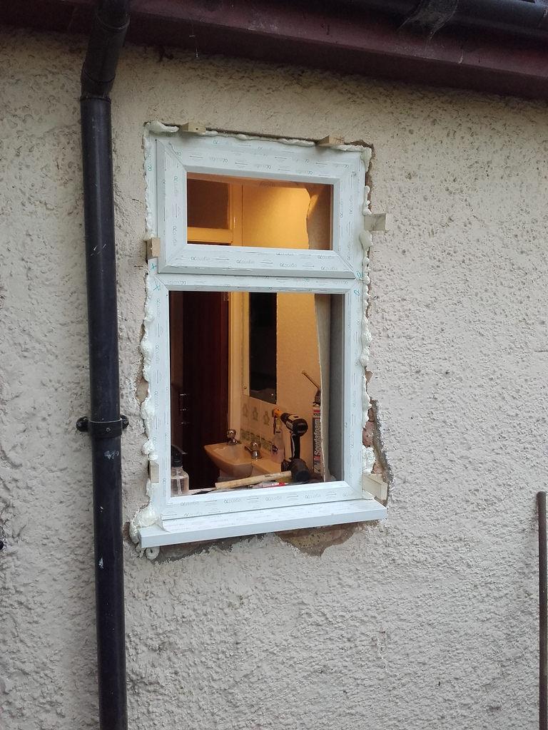

Onoff Posted September 7, 2020 Posted September 7, 2020 Some info here in a thread of mine. Wooden wedges are your friend:
PeterW Posted September 7, 2020 Posted September 7, 2020 17 minutes ago, zoothorn said: Once Ive got the old frame out, assuming just a lump hammer needed, & cleaning up the wall area.. is putting in the new frame in a fairly simple procedure, IE without the need for specialist fitting tools? I know how to put the glass & bead in- 5 min job & very satisfying too! thanks zoot. Old frame will probably be screwed in. Check the frame once you take the glass out and you may find some big screws. Get some hammer fix frame fixers as they just need a drill to fit them. Then foam in around the edges, let it go hard and trim back before you do a sealant bead and replace the render.
Nick Posted September 7, 2020 Posted September 7, 2020 uPVC windows are easy enough, you should be OK not having any specialist tools. A glazing knife is always handy but you can do without. If you are deducting from the narrowest point of a square/plumb opening and are very confident in what you're measuring then 5mm tolerance all around is fine. Would recommend nylon wedges and glazing packers over wood - less risk of them swelling / falling apart if they get wet.
Onoff Posted September 8, 2020 Posted September 8, 2020 (edited) 8 hours ago, Nick said: uPVC windows are easy enough, you should be OK not having any specialist tools. A glazing knife is always handy but you can do without. If you are deducting from the narrowest point of a square/plumb opening and are very confident in what you're measuring then 5mm tolerance all around is fine. Would recommend nylon wedges and glazing packers over wood - less risk of them swelling / falling apart if they get wet. If your referring to where I said wooden wedges above, I meant just to tap in and hold the frame square and plumb whilst the foam goes off. Edited September 8, 2020 by Onoff
Nick Posted September 8, 2020 Posted September 8, 2020 Gotcha. Suggested best practice is to use nylon shims to pack out the fixings and leave them in situ when you silicone to prevent later movement, but on small windows it's not really a huge deal.

Onoff Posted September 10, 2020 Posted September 10, 2020 4 hours ago, zoothorn said: Thanks for this link Onoff. Its mentioned yours was a one-piece with glass fixed-in ? is that right, or was it as I thought they all are, removable dg glass you put in last job. Always had removable glass that I've had to fit and bang the beads in. I did do a one piece window, below, i.e no openers but that was still frame first then fit the beads. I used Compriband and foam for the one. Wooden braces in there as to make good the render fillet that holds the glass in I needed to render up against something.

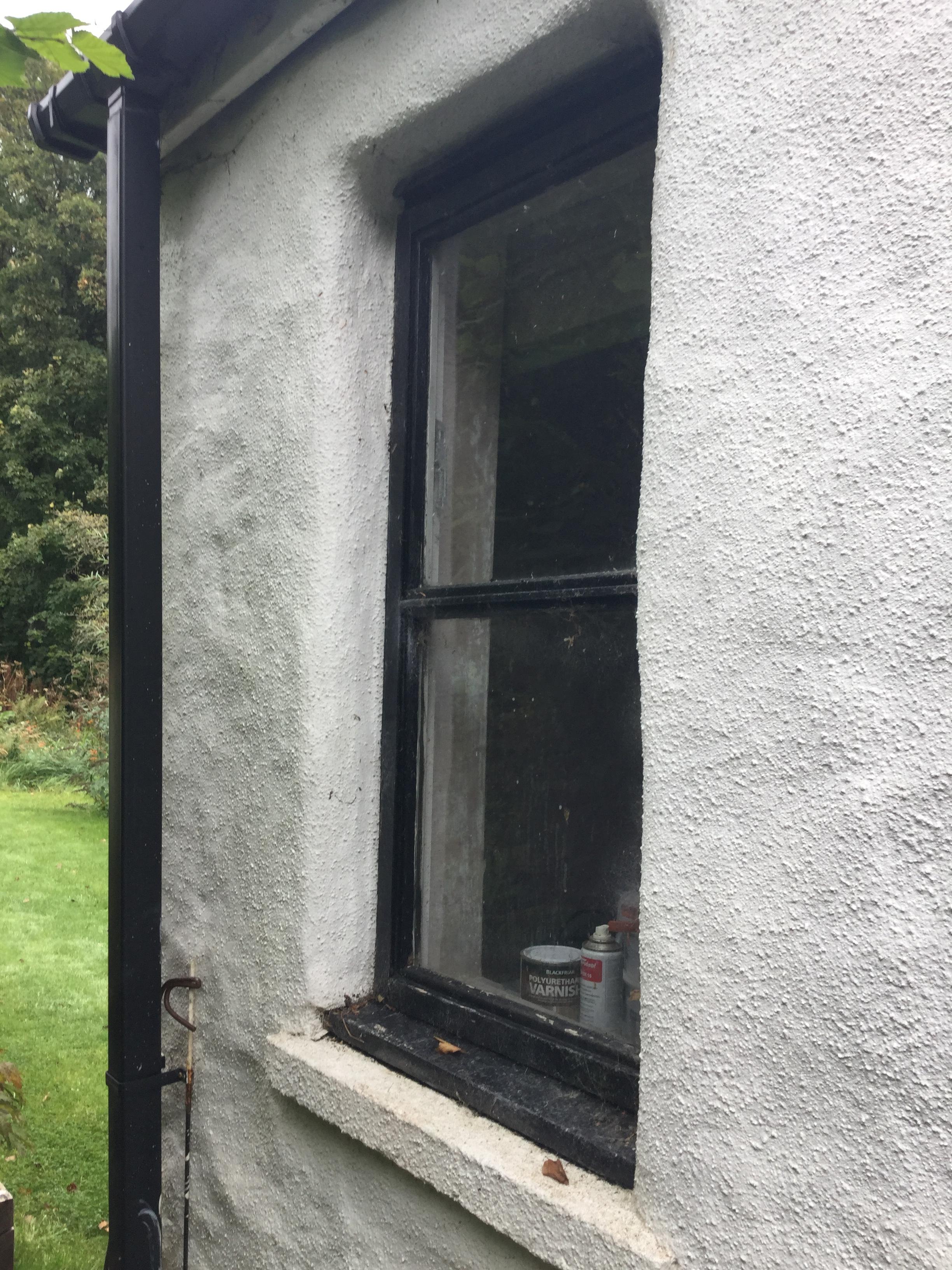

zoothorn Posted September 22, 2020 Author Posted September 22, 2020 On 10/09/2020 at 14:51, Onoff said: Always had removable glass that I've had to fit and bang the beads in. I did do a one piece window, below, i.e no openers but that was still frame first then fit the beads. I used Compriband and foam for the one. Wooden braces in there as to make good the render fillet that holds the glass in I needed to render up against something. Hi Onoff, ok get the general idea of this being a frame 1st then glass, beads etc.. i cant think how else its done tbh. Here is my old frame, its got the rounded reveal render i presume added after the whole window installed. Does this additional reveal render, as it seems i have here compared to normal ones like yours, make the job any more tricky?

zoothorn Posted May 14, 2021 Author Posted May 14, 2021 Hi- another question on this please. Can the frame be fitted from the inside-? The reason I ask, is the existing frame is tighter on the outside in its reveals (width is the thing) with contoured 'fake stonework' reveal render, which would be a shame to hack off too. The inside is alot cleaner/ squarer, I think it would be easier to fit any new frame from this side. Thanks zoot.
joe90 Posted May 14, 2021 Posted May 14, 2021 I would rather hack off plaster to fit a window than hack off render!.
zoothorn Posted May 14, 2021 Author Posted May 14, 2021 1 hour ago, joe90 said: I would rather hack off plaster to fit a window than hack off render!. Understood. I'm beginning to think now the frames been fixed in (at time of kitchen end extention put on, 80's maybe).. then both rendered over the frame by a little, and, on the inside the same: plaster I think has gone over the frame edge a little too. Looks tight & well fitted! but that doesn't help me tho. So I guess I have a choice like you suggest Joe. Defo chip away from inside? I guess you mean plaster is softer/ easier to hack off-? thanks zH
