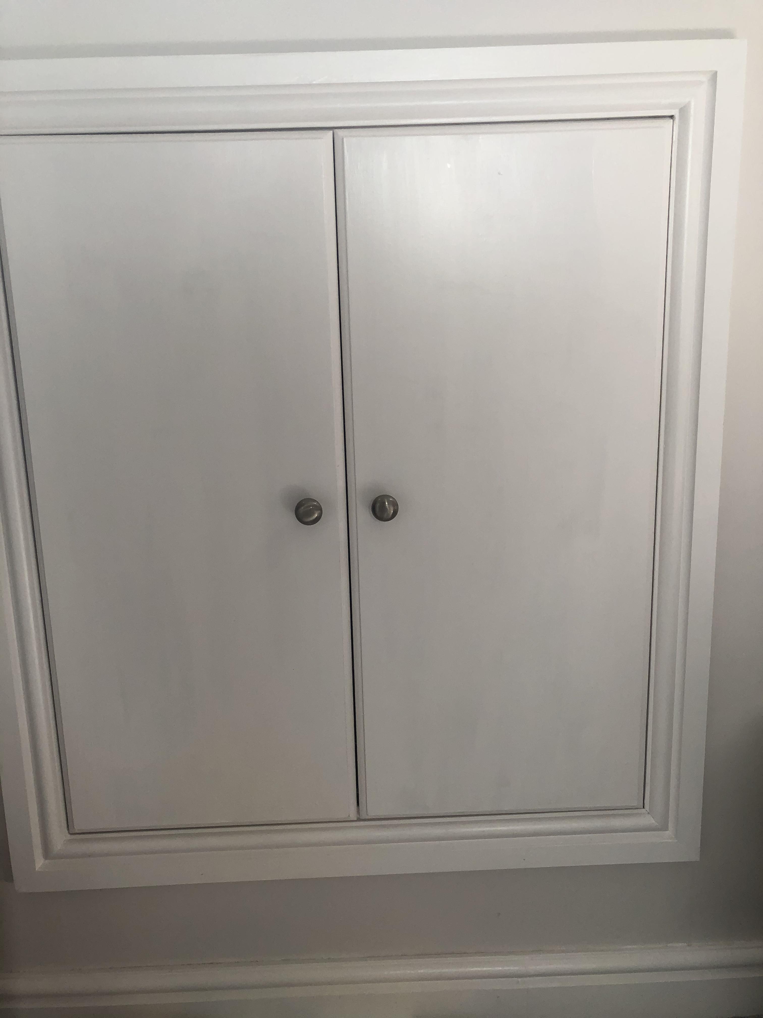

Rikki Holland Posted August 30, 2020 Share Posted August 30, 2020 Hi All We had our loft conversion completed a few years ago and each Autumn/Winter the room gets very cold, especially in comparison to other rooms in the house. I suppose the first question is - is that normal? More specifically, the set up of the room means that on both sides we have cupboards leading into the eves. The eves are quite breezy and I’m wondering if this is normal or if it should be more enclosed? The eves have insulation but aren’t boarded over, should they be? Lastly, the cupboard doors are “just” MDF, that I’ve now put a draft excluder on but they still let in a draft, are there better doors that are made more specially for something like this? Thank you in advance for any help. Rikki Link to comment Share on other sites More sharing options...

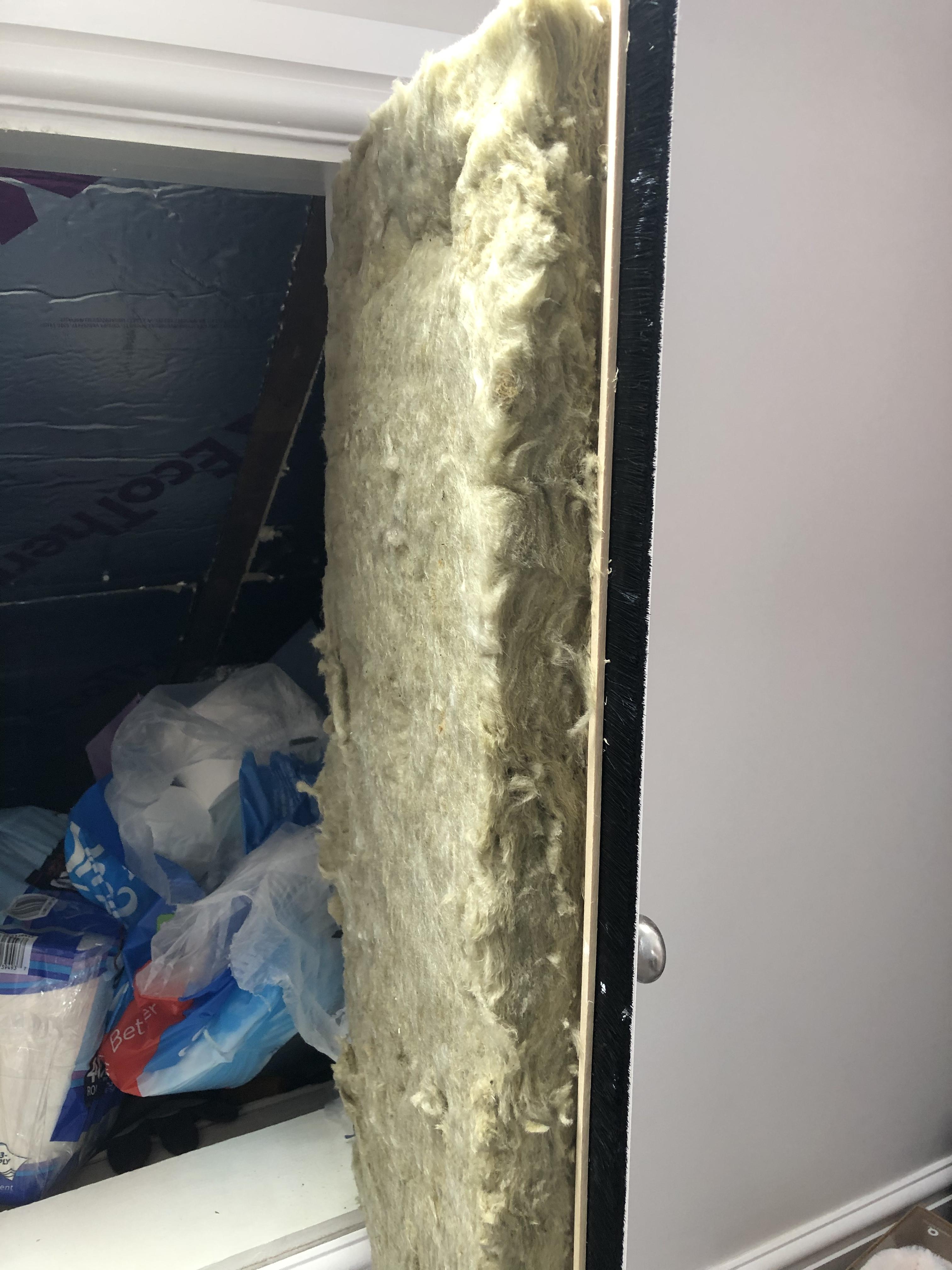

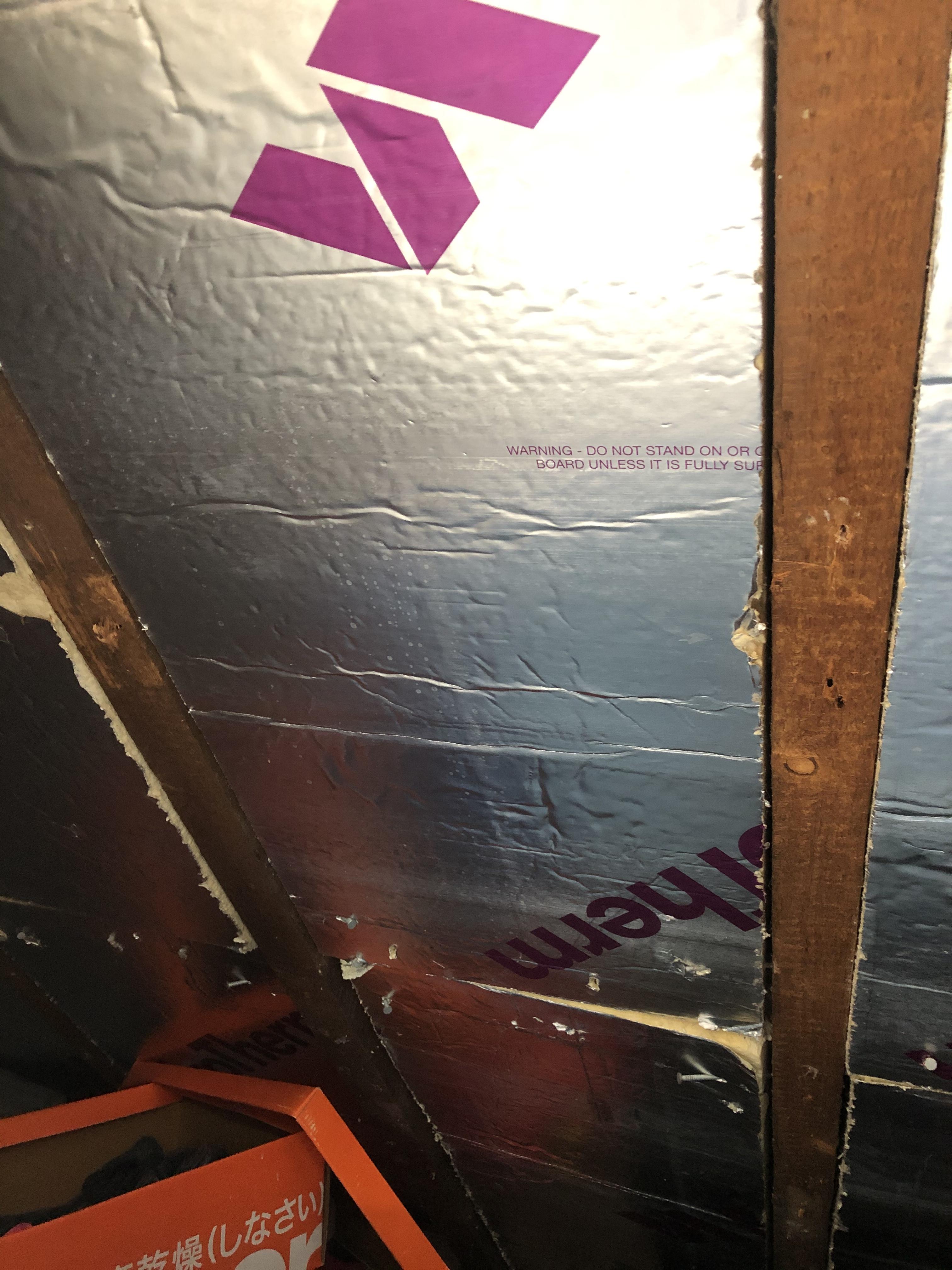

Rikki Holland Posted August 30, 2020 Author Share Posted August 30, 2020 Thank you for all the replies. I’ve uploaded a couple of pictures to be more specific. Link to comment Share on other sites More sharing options...
AliG Posted August 30, 2020 Share Posted August 30, 2020 The first obvious thing to try is foaming or taping between the rafters and insulation and also the joints between the boards. Other wise cold air all be blowing in those small gaps between the boards and the rafters. Looking at it they fit pretty tightly so you probably just need to tape them. Do you think cold air is coming in elsewhere, like at the bottom or tope edges of the insulation or through the floorboards? 1 Link to comment Share on other sites More sharing options...
Temp Posted August 30, 2020 Share Posted August 30, 2020 +1 Its quite likely there is a ventilated gap on the cold side of the insulation so if the insulation isn't tight fitting cold air gets through the gaps to the "warm" side. There are many ways a good design can be ruined by poor construction. You could also put another layer of insulation fixed to the rafters in addition to taping joints. However this only deals with the problem in the cupboards. Its likely you have same issue behind the plasterboard Link to comment Share on other sites More sharing options...
Declan52 Posted August 30, 2020 Share Posted August 30, 2020 Replace the doors with one piece of 25mm ply/MDF. Glue some 100mm pir insulation onto the back. Attach a frame of 2*2 around the edge of the opening. Drill 4 holes in the corners for screws. Use some foam draught tape around the inside edge of the 2*2. You will need screw cups and 70mm screws. Insert these in the 2*2 and then screw from the outside so it pulls the ply/MDF board tight against the draught tape so it forms an airtight seal. You will need a handle on the ply/ MDF to allow you to position it and pull it in close enough to attach the screws. Link to comment Share on other sites More sharing options...
Rikki Holland Posted August 30, 2020 Author Share Posted August 30, 2020 29 minutes ago, AliG said:Looking at it they fit pretty tightly so you probably just need to tape them. thanks, what kind of tape am I looking for? Link to comment Share on other sites More sharing options...
AliG Posted August 30, 2020 Share Posted August 30, 2020 Something like this https://www.screwfix.com/p/diall-insulation-board-tape-silver-45m-x-50mm/4806v 1 1 Link to comment Share on other sites More sharing options...
Rikki Holland Posted August 30, 2020 Author Share Posted August 30, 2020 37 minutes ago, AliG said: Something like this https://www.screwfix.com/p/diall-insulation-board-tape-silver-45m-x-50mm/4806v Legend. so I don’t have to look into boarding over the rafters? Link to comment Share on other sites More sharing options...
AliG Posted August 30, 2020 Share Posted August 30, 2020 I would do it in stages, try simple easy fixes first and they don't work you need to try something more. 1 Link to comment Share on other sites More sharing options...
ProDave Posted August 30, 2020 Share Posted August 30, 2020 There is a fundamental design flaw here. They have tried (whether successful or not is another matter) to run the insulation following the profile of the room, but then made cupboard door openings into the cold and ventilated eaves space. And of course the door is not insulated and lets in cold draughts. The proper way to do this would have been to run the insulation following the roof line all the way up both sides so that when it is sealed and taped, the eaves cupboards would be inside the warm envelope and there would be no draughts and no heat loss to worry about. You would expect this if it had been done a long time ago. But just 2 years? Just WHEN are builders going to start learning something about properly insulating and draught proofing buildings? Link to comment Share on other sites More sharing options...
tonyshouse Posted August 30, 2020 Share Posted August 30, 2020 Can’t see the point of insulation on the back of the loft door, where is the insulation barrier and where is the air barrier? what happens under the floor? Link to comment Share on other sites More sharing options...
dpmiller Posted August 30, 2020 Share Posted August 30, 2020 Fakro do a smart sealed and insulated door for this kind of application,. We've a couple of similar spaces in ours ( however they're "inside"in terms of insulation and airtightness) and we put a pair of these doors in. They're pretty good quality and not at all expensive https://www.fakro.co.uk/products/all-products/loft-ladders/dwk/ 1 Link to comment Share on other sites More sharing options...
