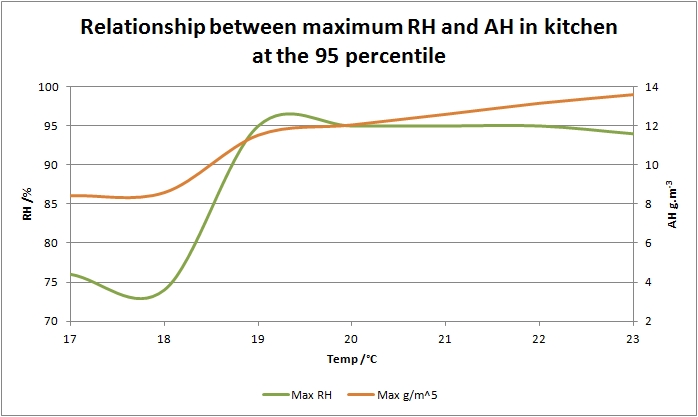

SteamyTea Posted January 8, 2017 Share Posted January 8, 2017 I decided to look at my temperature and RH data for my kitchen (25 m3) as this is the room I use the most, and is probably the one with the highest long term humidity (bathroom is short and sweet and is soon sucked out by the fan). By using the maximum RH and AH figures I can calculate what size extraction system I would need. In my place I don't think I have much of a problem. Link to comment Share on other sites More sharing options...
