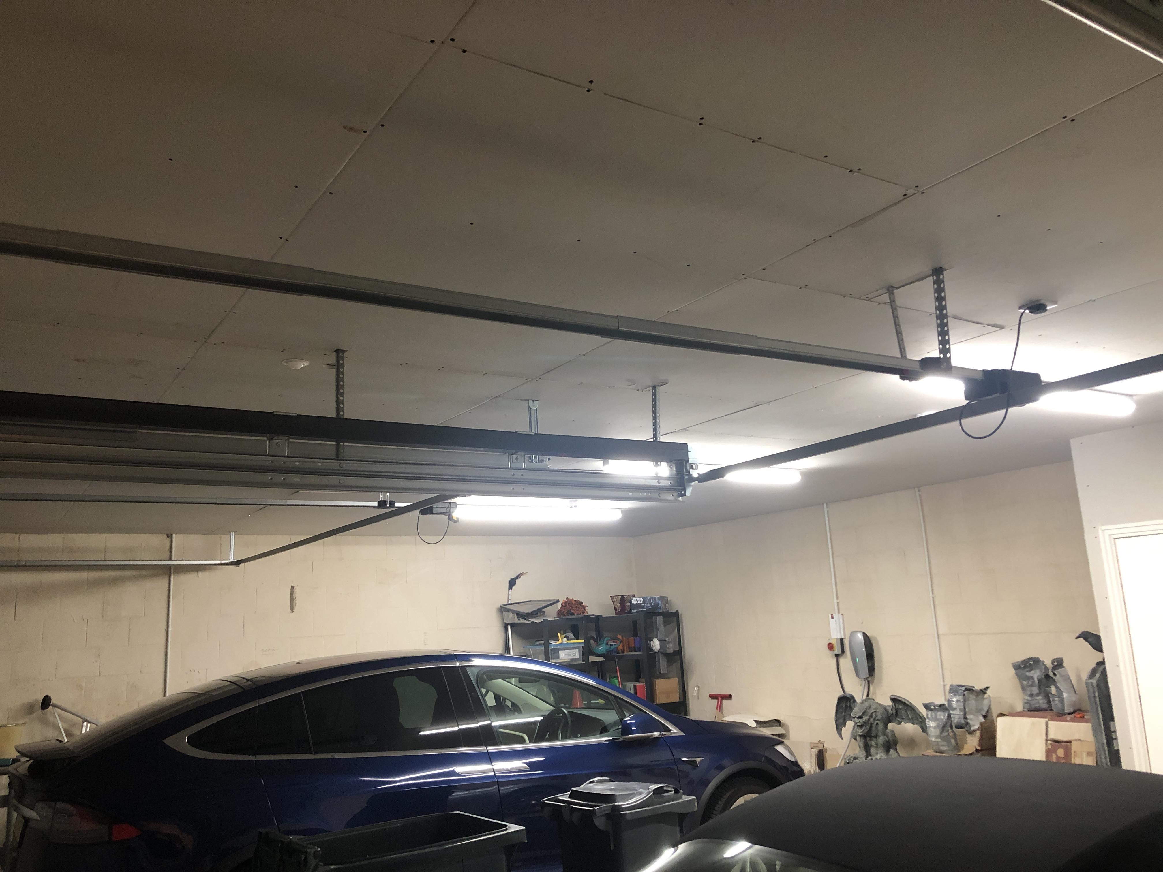

AliG Posted August 12, 2020 Posted August 12, 2020 (edited) We have the LED tubes in the garage which is 7x9. They are n a PIR which works well as they come on as soon as you open the door. The problem is that with sectional doors they didn't want to put them above where the doors would be when they are open and I do not find the garage is well lit. Doesn't matter for us as I don't spend any time in there but it would be annoying ifI was using it as a workshop. You probably need 6 lights to spread the light properly. Edited August 12, 2020 by AliG
