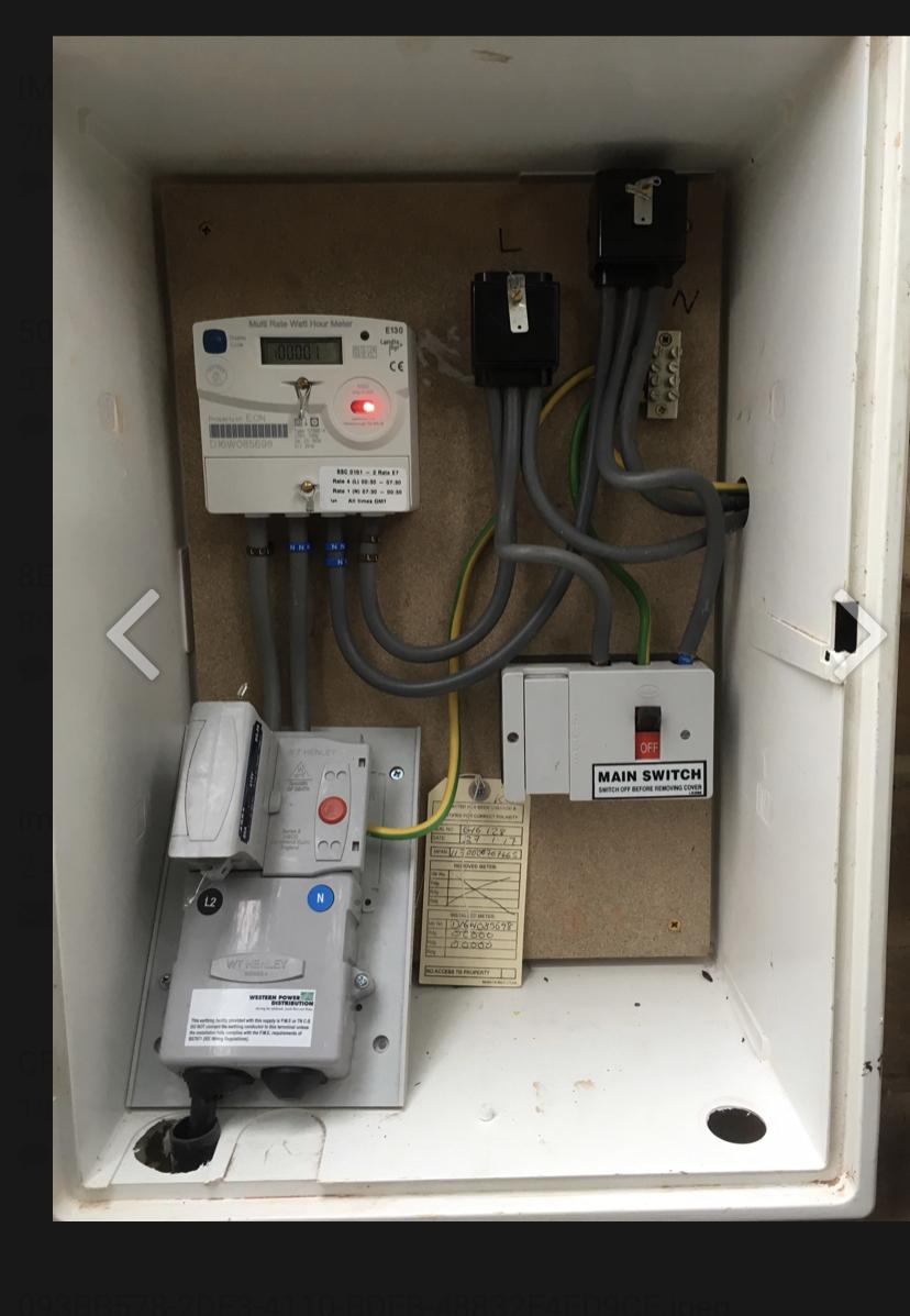

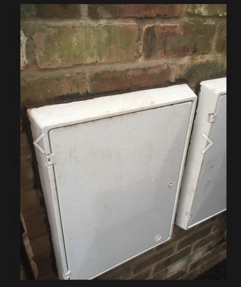

PeterW Posted November 21, 2020 Share Posted November 21, 2020 5 minutes ago, Dave Jones said: ah the non temporary bodge method of leaving a white box on a post. no thanks. Not at all - there are plenty of ways of doing it. These were installed in the back of a boundary wall - all permanent and signed off by WP and electrician. Link to comment Share on other sites More sharing options...
Dave Jones Posted November 21, 2020 Share Posted November 21, 2020 and still looks crap. Link to comment Share on other sites More sharing options...

PeterW Posted November 21, 2020 Share Posted November 21, 2020 2 minutes ago, Dave Jones said: and still looks crap. ..?? Looks like a standard in wall meter box to me. One to the right has a small CU and automation for gates / lights Link to comment Share on other sites More sharing options...
