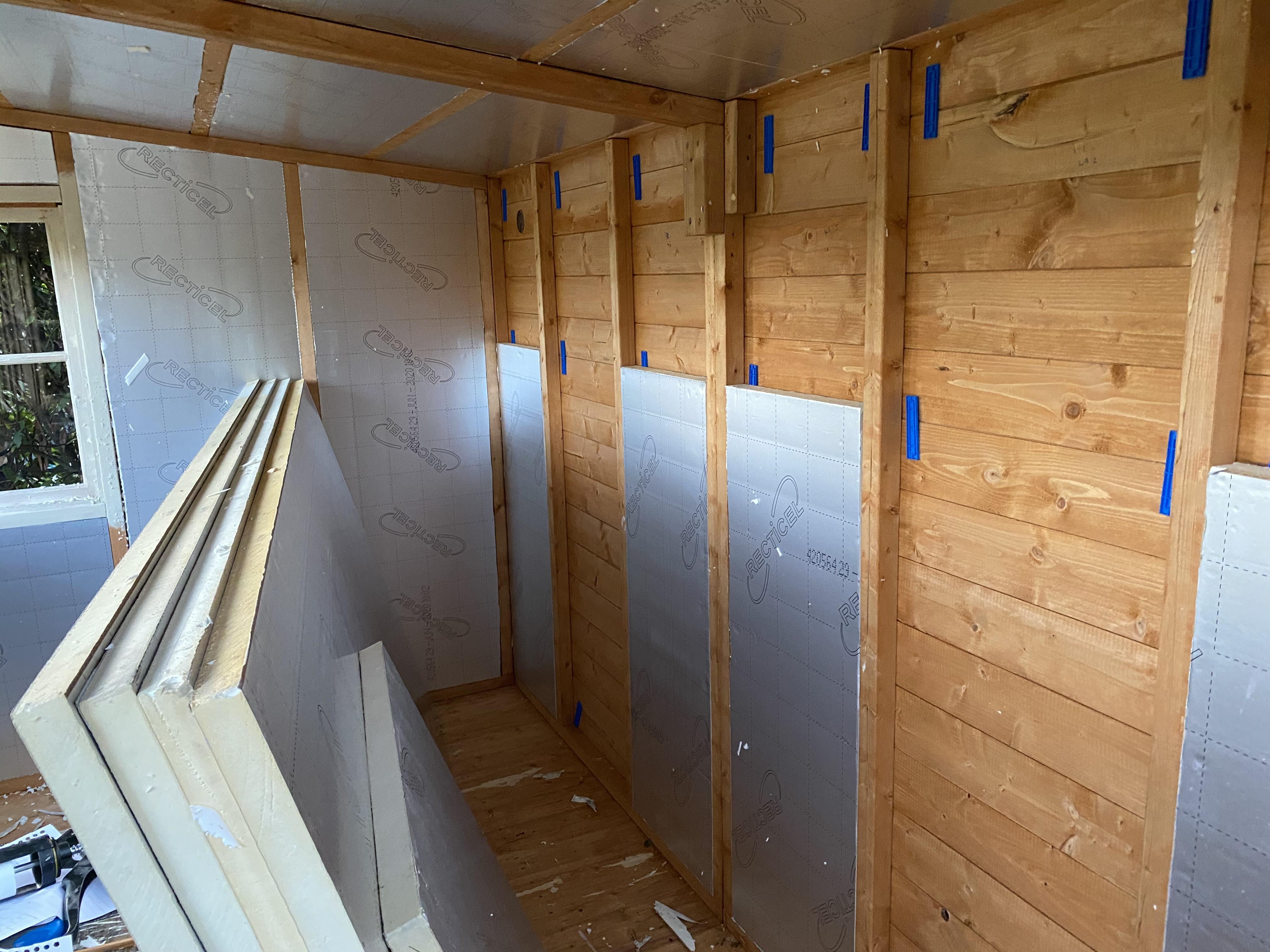

Gav_P Posted September 4, 2020 Posted September 4, 2020 Ok, so before I order some insulation board, what are people opinions on vapour barrier? It seems to be mixed as to whether it’s worth it on a shed. I have 44mm framing so was going to have 30mm Celotex, allowing a 14mm Air gap between the insulation and the exterior boarding. Or possibly 40mm with virtually no air gap. Then, use some foil tape to bridge any areas not covered in Celotex (in effect creating a vapour barrier), then 6mm ply to finish. I think it would be a bit of a ball ache trying to put a vapour barrier in, and possibly over kill??

A_L Posted September 9, 2020 Posted September 9, 2020 1 hour ago, Gav_P said: Anyone got opinion on whether vapour barrier is needed or not? The foil facings have a water vapour resistance significantly higher (1000MN.s.g-1 ) than the value normally used for polythene vapour barriers (300MN.s.g-1 ). Section 7.3 and 7.5 here https://insulation-uk.com/assets/5405_dry-lining_bba-certificate_nov2018.pdf So you will unavoidably have a VB anyway. 1

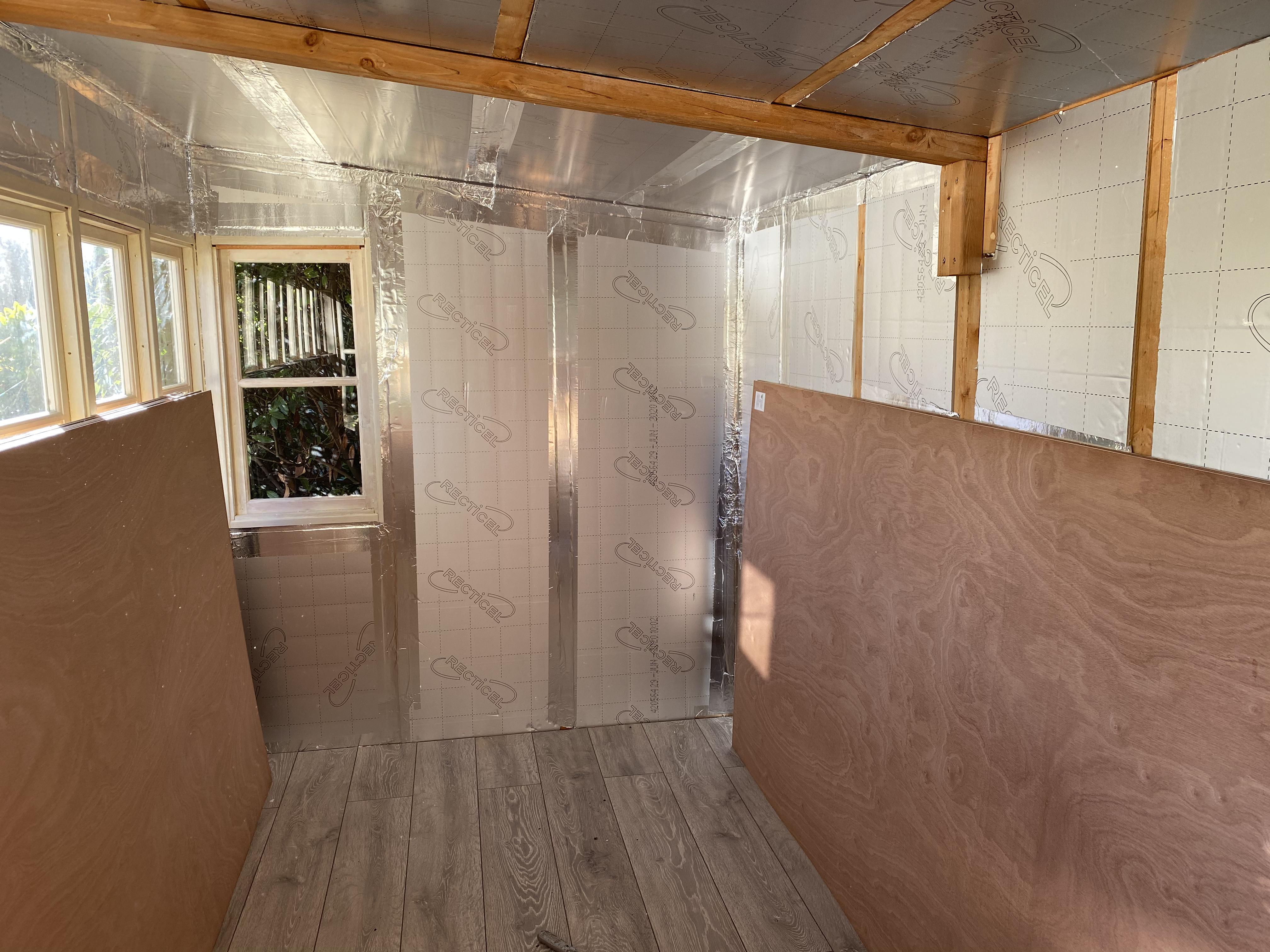

Gav_P Posted November 7, 2020 Posted November 7, 2020 I thought it was only fair that I reported back on my shed office. I bought a cheap potting shed. Went mad with the wood treatment to give it the best chance of repelling water, lined it with 40mm PIR, boarded it with 6mm ply. Power is currently by extension lead as I am just waiting for the electrician to connect the consumer unit. Cost about £900-£1000 in total. It’s south facing and so warms up quickly in the sun on these cooler mornings (it’s been frosty outside). If it’s a bit nippy I turn the oil radiator on for 10mins and it says warm for the rest of the day. So from my perspective it’s worked out really well, great place to work and have video conferences without being disturbed. Thanks for the advice ? 1

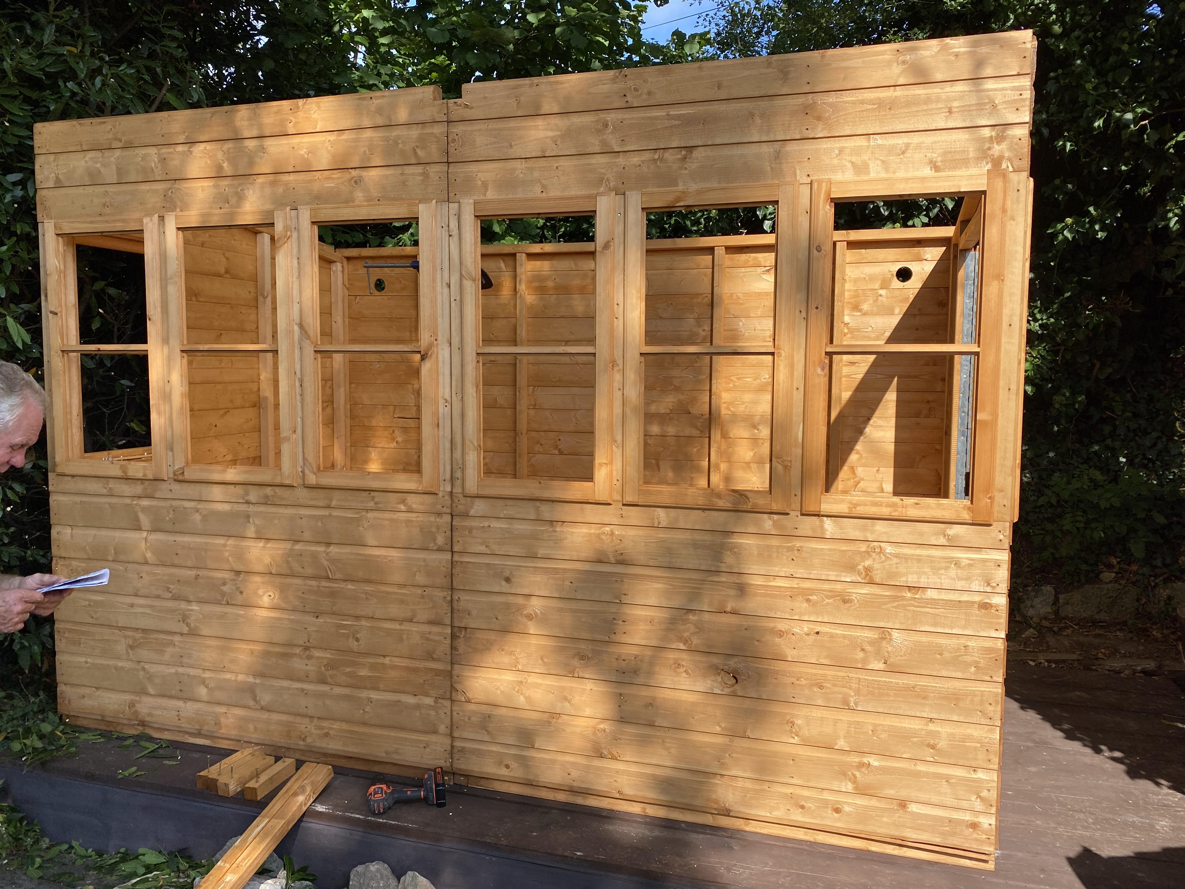

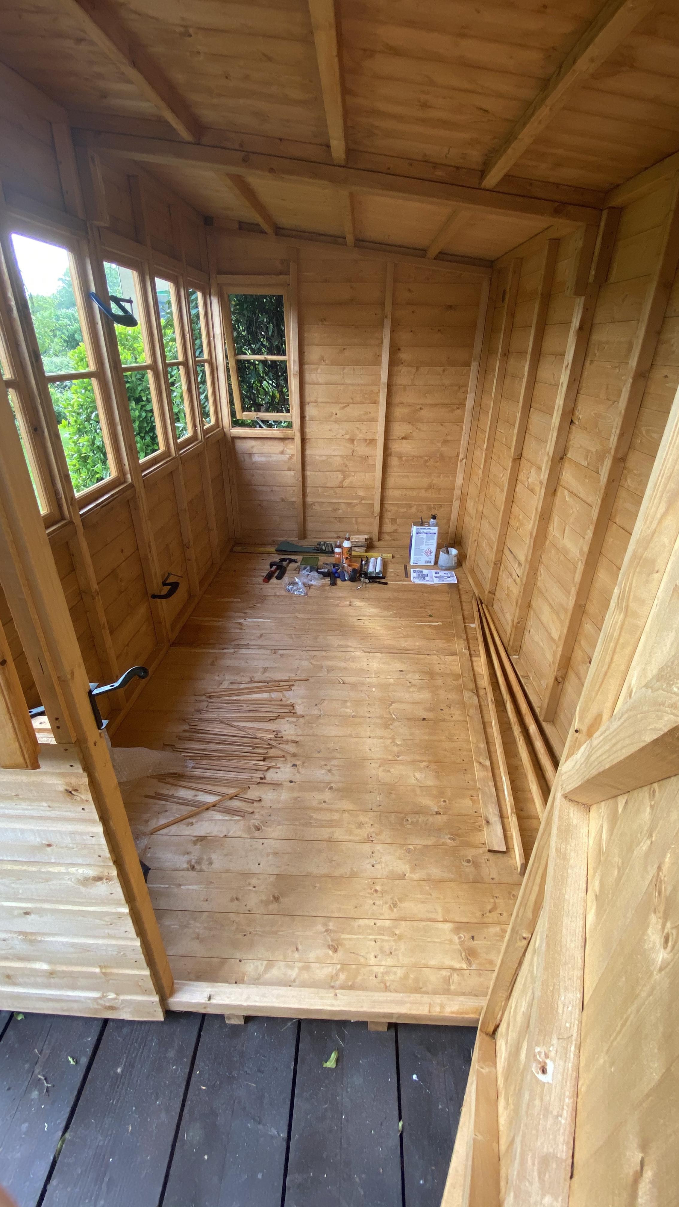

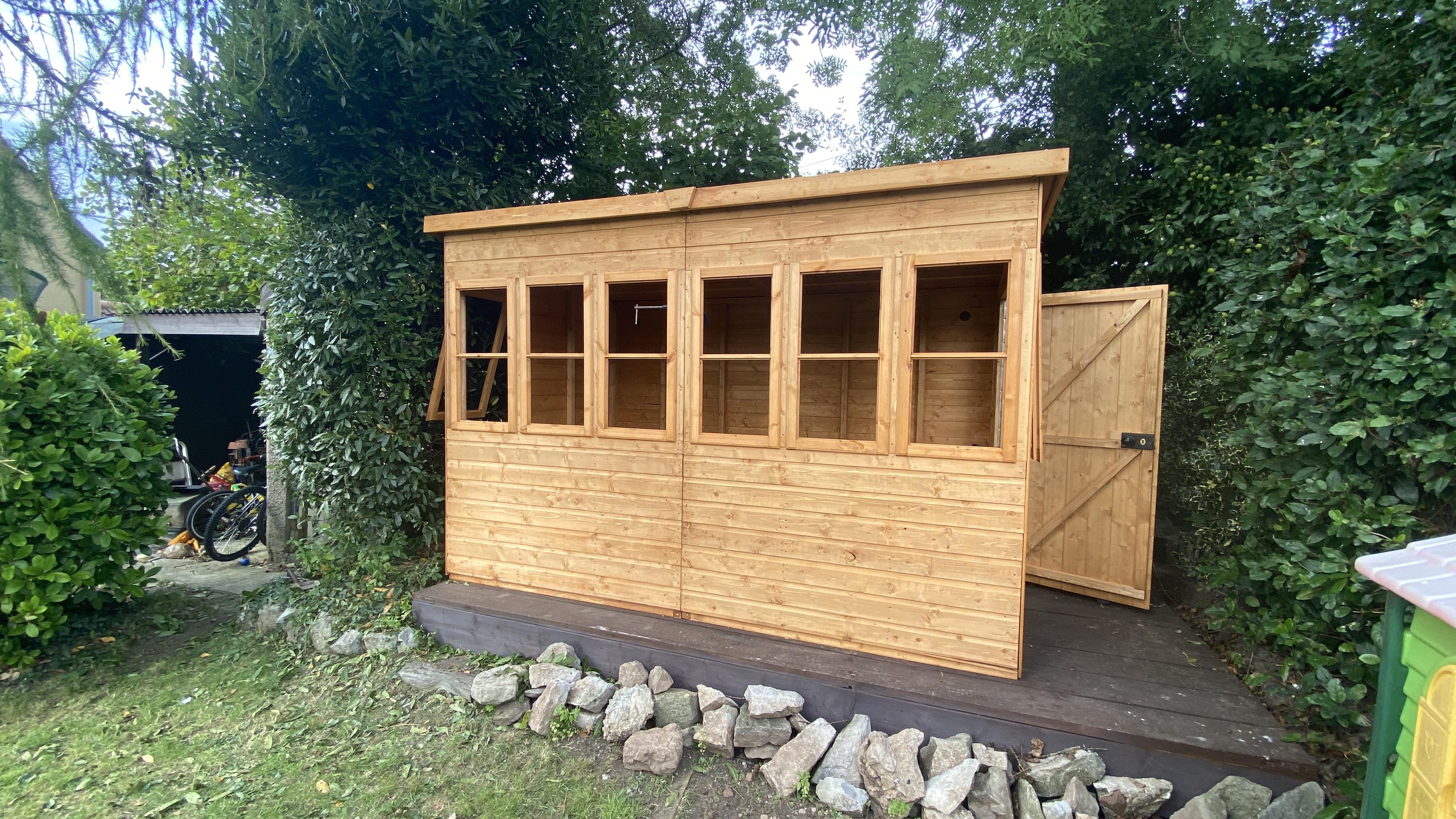

Gav_P Posted November 7, 2020 Posted November 7, 2020 (edited) some work in progress photos. Haven’t got any of it as it currently is. Will get some tomorrow. Edited November 7, 2020 by Gav_P 2
daiking Posted November 8, 2020 Author Posted November 8, 2020 That’s far too good a job ? What’s that flooring as well? You’re just showing off now.
Ferdinand Posted November 8, 2020 Posted November 8, 2020 That is based on a real live Potting Shed, isn't it? Larger windows so you get the extra light. Planning for growing cabbages in retirement ! F
ProDave Posted November 8, 2020 Posted November 8, 2020 That's looking good. All I will add, is if this is a "standard" shed, it probably just has a mineral felt roof covering. I would be replacing or over covering that with something far better like box profile steel or corrugated steel etc. Mineral felt will start leaking after not many years, horrible stuff I would never use it.
Gav_P Posted November 8, 2020 Posted November 8, 2020 2 hours ago, daiking said: That’s far too good a job ? What’s that flooring as well? You’re just showing off now. Haha. I had to put something down as I put PIR on the floor too. So I got the cheapest laminate flooring I could find (B&M home store).
Gav_P Posted November 8, 2020 Posted November 8, 2020 1 hour ago, ProDave said: That's looking good. All I will add, is if this is a "standard" shed, it probably just has a mineral felt roof covering. I would be replacing or over covering that with something far better like box profile steel or corrugated steel etc. Mineral felt will start leaking after not many years, horrible stuff I would never use it. You are correct, it came with the crapist felt known to mankind, it resembled tissue paper. I was thinking to use some epdm on it.
Gav_P Posted November 8, 2020 Posted November 8, 2020 1 hour ago, PeterW said: Is that a Tiger sheds one ..? No it’s not unfortunately. It was from wickes, made by Shires (who, from my experience, have shocking customer service).

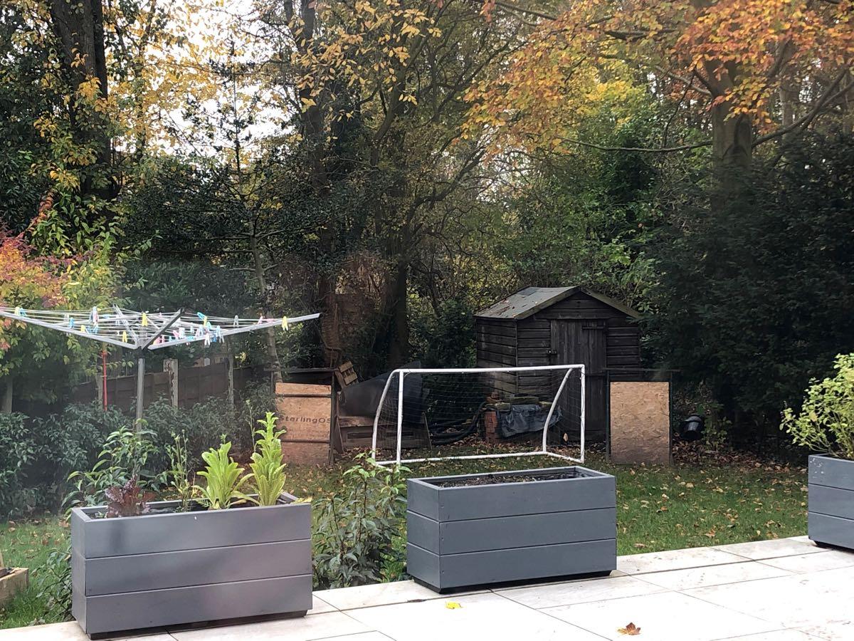

daiking Posted November 8, 2020 Author Posted November 8, 2020 Having ditched the micro-office we’re going ahead with a bigger build. OSB covered trestle to Trestle is 5m wide and the planned front face of a decent sized garden room. 1
