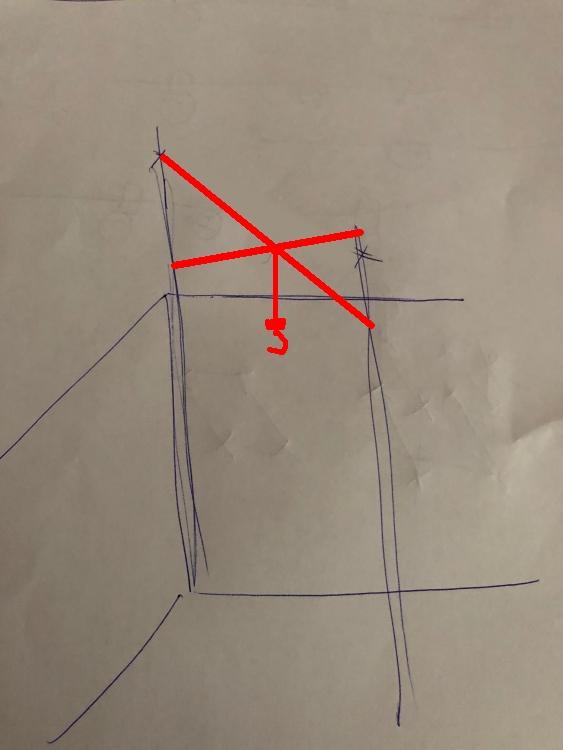

joe90 Posted July 31, 2020 Posted July 31, 2020 1 hour ago, pocster said: this arrangement feels better not sure I agree, loading the middle of a horizontal bar without triangulation????
Reiver Posted July 31, 2020 Posted July 31, 2020 2 hours ago, pocster said: Though..... Should I brace these? i.e. ... ( more wine please ; reality is slipping back in !) If it were me I'd have 2 bits forming an X between the poles, hang your hoist from the middle point where they cross.
JFDIY Posted July 31, 2020 Posted July 31, 2020 7 hours ago, pocster said: wooden pallet as lift floor ( would prefer something made of metal to be honest ) . Sling straps from that to a ‘spreader’ then straps to winch Have a look for a steel stillage, you can get them with solid or mesh floors.https://metalcagesandpallets.co.uk/collections/all/products/metal-steel-mesh-stillage-with-removable-front-shallow-refurbished?variant=31757722026081 3 hours ago, pocster said: Thanks . I’ve googled lap clamps - but not sure what I should be looking for .... I guess the scaffolders call them single clamps. https://www.scaffoldingsupplies.co.uk/products/details/25.html You could also use half clamps to secure to the masonry with Rawl bolts, but you'd need to be cock-on with positioning https://www.scaffoldingsupplies.co.uk/products/details/1318.html 2 hours ago, pocster said: So @joe90 using PAAI (pocsters Advance Artificial Intelligence ). this arrangement feels better .. ( doesn't mean it is better; just feels better ! ) Personally I'd leave the other two vertical poles long instead and run the lifting member to them. More stable due to being anchored to blockwork and leaves loading access from two sides The diagonals you show in later drawing will obviously help, but I doubt needed for 150kg 1
Pocster Posted July 31, 2020 Author Posted July 31, 2020 Just now, Reiver said: If it were me I'd have 2 bits forming an X between the poles, hang your hoist from the middle point where they cross. So you mean the same but with the other 2 corner posts ?. How do I fix the cross over point ?

Reiver Posted July 31, 2020 Posted July 31, 2020 (edited) 23 minutes ago, pocster said: So you mean the same but with the other 2 corner posts ?. How do I fix the cross over point ? No, if you're using just 2 poles, like this: But you could do a 4 pole version which obviously would have a bit more stability. Edited July 31, 2020 by Reiver 2
JFDIY Posted July 31, 2020 Posted July 31, 2020 (edited) 24 minutes ago, pocster said: So you mean the same but with the other 2 corner posts ?. How do I fix the cross over point ? Either a double scaffold clip, or buy another lifting sling and just wrap it around the cross-over and it will share the load through the two poles. Edited July 31, 2020 by JFDIY 2
Pocster Posted August 3, 2020 Author Posted August 3, 2020 On 31/07/2020 at 18:14, pocster said: I did think that type of arrangement is what you meant. But I'm more comfortable ( i.e. less chance of my death ) with 4 corner posts I can then stick scaf boards across as a 'loading' platform. Also I'm unhappy ( not as in sad, I've drunk some wine now ) with the counter leaver weight. A corner to opposing corner vertical with a horizontal gantry across means the weight of the lift load is central so doesn't need a counter balance ( if I'm wrong I'll die proving you were right )! Getting nowhere with this. Scaf companies being arsey. Tempted by @joe90 original suggestion. All I need is 3 scaf poles . The 'guides' etc. to stop it rotating could all be done with timber ( cheaper and easier to obtain ) I guess even the 'spreader' could be timber??? - bit worried about that crushing and therefore failing.

Onoff Posted August 6, 2020 Posted August 6, 2020 23 minutes ago, pocster said: If I got a swivel hoist clamped to a vertical Scaff pole ; then there can’t be a counter weight ? . So could I just have as originally planned 1 Scaff pole bolted to the wall right in the corner and use the ‘swivel’ to move a platform around i.e load it not over the hole - then simply swivel round over the drop and lower ?? Risk is the pole bending and or it pulling away from the wall. A diagonal tie back to a strong point able to take the load guards against this. 14 minutes ago, pocster said: Ooooooo . Won’t quite go high enough for a fridge freezer ... But ..... https://www.ebay.co.uk/itm/274393345019 Electric Jib Crane - 400Kg / 882lb Lifting Hoist, 240V Heavy Duty ~ Rhino AUTO BRAKE FAIL SAFE WINCH ~ 12 MONTH 100% UK WARRANTY Still needs a counterweight.
