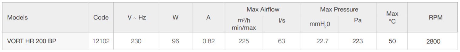

MikeGrahamT21 Posted July 21, 2020 Author Posted July 21, 2020 (edited) I was going to start another topic to ask this, as its not really related, but I'll ask in this one... Rather than going through the external wall for fresh inlet, and stale outlet, I've thought about going through the roof. I see on BPC they sell a 20,000mm2 roof vent, but I want something which is a bit more 'integrated' into the build. How many mm2 of free vent area do I actually require? Clearly the less restriction the better. I was thinking of using something like this: https://klober.co.uk/product/pitched-roofing/pitched-roof-vents/profile-line-15x9-tile-vent These give 10,000mm2, but if I need to get to 20,000mm2 I guess I can just have two of these side by side, and then join the vent pipes from them into the single 125mm ducting? Trying to make it look as invisible as possible, i've got one of these type tiles for an extractor in the utility (not part of the ventilation strategy) and it works very well in terms of performance and looks. Or is it more in terms of resistance? The MVHR i've got has a max flow of 63l/s, which gives the Klober 192pa of resistance, and this one (https://www.hambleside-danelaw.co.uk/wp-content/uploads/2016/08/Datasheet_TV10-Series_July19.pdf) 115pa of resistance. In comparison the 20K universal tile that BPC sell (https://klober.co.uk/product/pitched-roofing/pitched-roof-vents/universal-20k-tile-vent) gives 43pa at the same flow rate. So if I get two of the danelaw tiles, that would give less than 60pa of resistance per tile, which seems acceptable at maximum flow? I think the Klober Profile Line 15x9's are too restricted looking at the specs. Edited July 21, 2020 by MikeGrahamT21
Nickfromwales Posted July 21, 2020 Posted July 21, 2020 You’ll be up there every week cleaning those. The proper ones have either no restriction or just a fine 10x10mm mesh. Also, the type you show from BPC is for outlet only. For inlet you need the one that looks like a gas boiler vertical flue, and I believe it’s to do with sucking in excess rain / spray that bounces off the roof in bad weather. ?
MikeGrahamT21 Posted July 22, 2020 Author Posted July 22, 2020 Ahh ok, didn’t know you needed different one for inlet, good to know. I guess I’ll have to go with the uglier more free flowing solution, or go back to through the gable end
