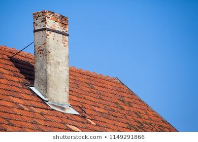

joe90 Posted July 6, 2020 Share Posted July 6, 2020 Old fashion chimney brace 3 Link to comment Share on other sites More sharing options...
epsilonGreedy Posted July 6, 2020 Author Share Posted July 6, 2020 16 minutes ago, joe90 said: Old fashion chimney brace Thanks I was not aware of such a device, my chimney will be a similar size though having a hipped roof means less support from surrounding roof carpentry in my case. Some chimneys on the older properties in the village could benefit from such a brace. One reason my chimney is 2.5 bricks wide is that when I mentioned to the architectural technician that the local heritage style is 2 bricks wide he quipped "how many of them have a lean?". Link to comment Share on other sites More sharing options...
joe90 Posted July 6, 2020 Share Posted July 6, 2020 A big old house near where I lived in Bristol had these which is where I got the idea ?. 1 Link to comment Share on other sites More sharing options...
epsilonGreedy Posted July 6, 2020 Author Share Posted July 6, 2020 15 minutes ago, joe90 said: A big old house near where I lived in Bristol had these which is where I got the idea ?. My house is meant to look as though Jane Austen might have visited 220 years ago, a chimney brace could help reinforce that impression. 1 Link to comment Share on other sites More sharing options...

Gus Potter Posted July 6, 2020 Share Posted July 6, 2020 2 hours ago, joe90 said: Old fashion chimney brace Thanks Joe90. Simple, elegant? and proven to work..but how? Seems to me it mostly works in tension to stop the chimney falling towards the side of the roof we can see as we look at the photo rather than the other way? Anyone here know why? Link to comment Share on other sites More sharing options...

joe90 Posted July 7, 2020 Share Posted July 7, 2020 9 hours ago, Gus Potter said: Thanks Joe90. Simple, elegant? and proven to work..but how? Seems to me it mostly works in tension to stop the chimney falling towards the side of the roof we can see as we look at the photo rather than the other way? Anyone here know why? it simply stops any movement of the brickwork by being braced against a triangulated roof structure. Link to comment Share on other sites More sharing options...

Gus Potter Posted July 8, 2020 Share Posted July 8, 2020 Yes Joe90 is bang on. But to dig a bit deeper and this leads into solar panels. Lots of chimney braces are say 1 a half inches wide x say 1/4 to / 3/8 inch thick in old money so the they work in mostly tension if they are long. In other words they act like a bit of rope. Good for tension “pulling on the rope” but have you tried standing on the end of a bit of rope? Thus putting it into compression? Never mind, Joe90 is pretty close I think so no need to split hairs. One reason I picked up on this is that I ask.. is it akin to when you stick something on a roof like a solar panel? Is a solar panel subject to wind load? Will the wind either push the panel into the roof or more importantly suck the panel off the roof. Or damage the panel it’s self? Do we just trust the manufacturer of the panel that it will all be all right on a windy night? Yes, the supporting brackets for solar panels are designed to carry the weight of the panel and any snow that falls on it but does anyone know how you deal effectively with the wind loads on solar panels etc. Question for the experts? How much can a panel bend before it stops working? If you live in Scotland say at a higher altitude and in the UK generally the wind can be pretty severe to say the least. So can the wind loads not outweigh the snow loads from time to time? If you live in Scotland/ Wales and parts of England the snow loads can be pretty severe but so is the wind. Can anyone give advice on buying solar panels for windy places too? Input on this would be much appreciated. Any advice from the solar experts or anyone really would be much appreciated. Every day is a school day! Link to comment Share on other sites More sharing options...
joe90 Posted July 8, 2020 Share Posted July 8, 2020 (edited) 33 minutes ago, Gus Potter said: Lots of chimney braces are say 1 a half inches wide x say 1/4 to / 3/8 inch thick in old money so the they work in mostly tension if they are long. In other words they act like a bit of rope. Good for tension “pulling on the rope” but have you tried standing on the end of a bit of rope? Thus putting it into compression? I disagree, a steel bar 1 1/2” x 1/4 -3/8” is not like a bit of rope, yes it may give a little under extreme compression but a lot more than wind load on a chimney that would probably survive even without a brace. with regards solar panels they must be “fit for purpose” so the wind load calcs must have been done, different if you just did a DIY job. Edited July 8, 2020 by joe90 Link to comment Share on other sites More sharing options...
