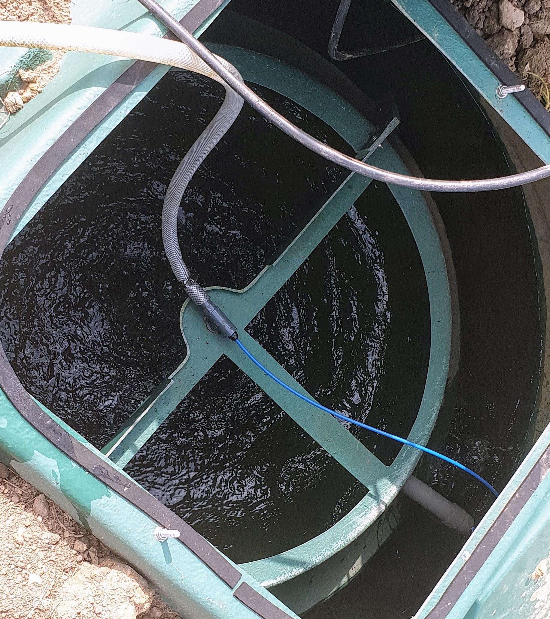

ToughButterCup Posted June 23, 2020 Posted June 23, 2020 51 minutes ago, Gymwear7 said: ...bio pure, ... Switched mine on for the first time last week. It was like switching on a log flume or jacuzzi. (Clear fresh water I hasten to add) No moving parts. Pump breaks? Take the lid off replace the pump , reconnect, go. Found a great crested newt clinging to a piece of PIR, tried to rescue it, leaned in - glasses straight off the end of my nose never to be seen again, but Sharpies float. NotAlotOfPeopleKnowThat 1

ToughButterCup Posted June 23, 2020 Posted June 23, 2020 (edited) 17 minutes ago, Gymwear7 said: thanks Tough Buttercup - what model is that ? thanks Jim The 3 to 15 people version (BioPure 3 maybe ?) Jim, because we decided to put two houses on it. £3000ish delivered. Also decided to bed it in concrete (high water table sometimes) - easy - attach 4 concrete fence posts with chain to 8 shackles and drop them in first. The a tonne or two of concrete. Get the tank in the right way round (who can guess why I thought it useful to point that out), and then above say a meter from the bottom - above the concrete - put a whole load of 10mm in with a French drain sleeve bedded in that lot ... so it becomes a soak away ... and duct the soakaway to the outfall. Tickety Boo. I had the fear of God put in me by someone pointing out that Digesters can float even when full of packed lunches. He'd seen it happen. And I believed him. Edited June 23, 2020 by ToughButterCup
