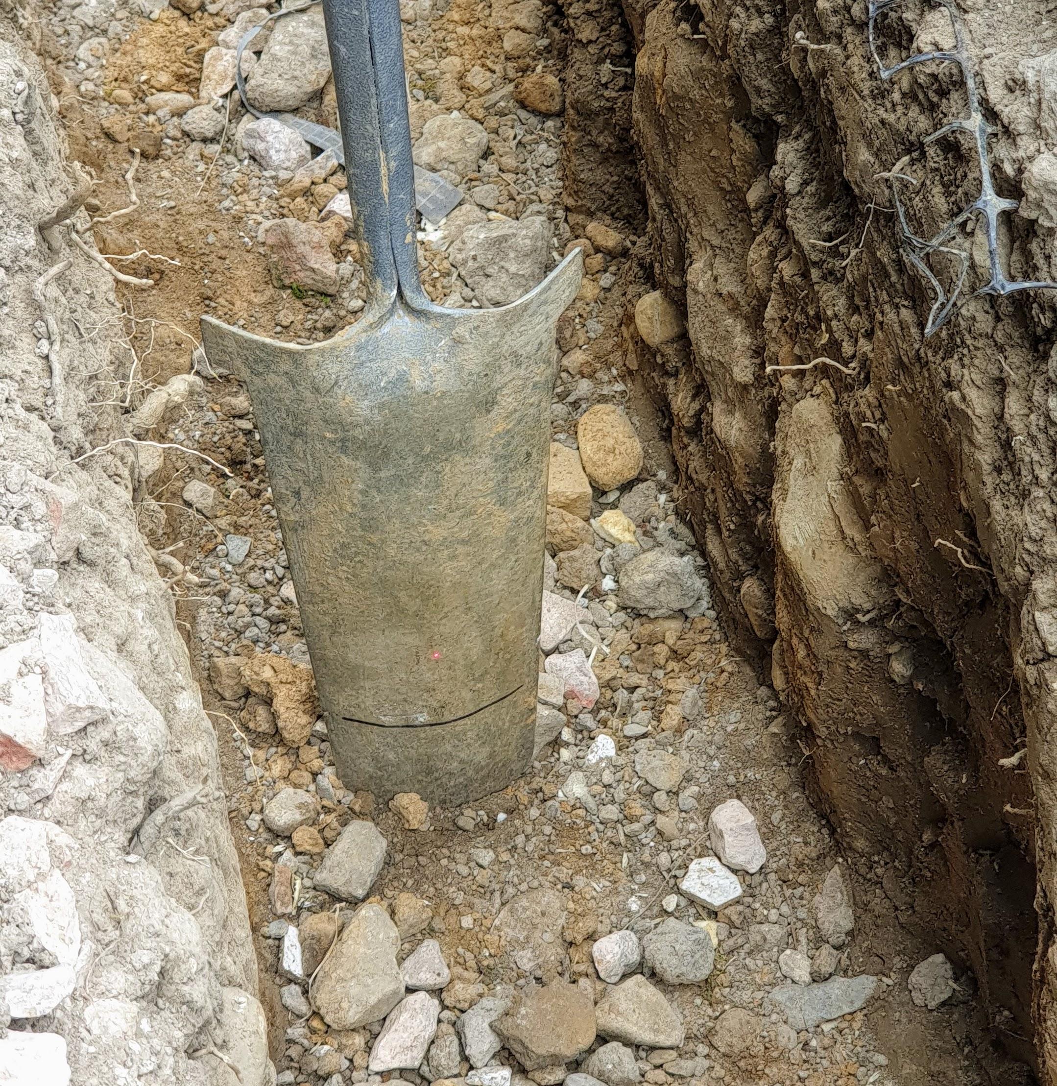

redtop Posted June 21, 2020 Author Share Posted June 21, 2020 On 20/06/2020 at 08:15, ToughButterCup said: I had exactly the same problem right when C-19 struck. That meant about a month digging 35 cubic meters by hand. At the time I cursed a bit. I've already forgotten the irritation, but I do know - now - exactly what's involved in accurate digging to a fairly precise fall. In brief Keep checking for level - over-digging by hand is soooo annoying Make sure the width is right, pipe width plus space for one foot either side of the pipe- too wide is as bad as too narrow Plan for spoil - topsoil one side, clay / whatever else 'other side. Backfills easier that way. Make a set of trench boards to prevent, where necessary, collapse- scaffold Jacks to brace between boards on either side. Plan how to drain the trench : thunderstorms. Buy a clay spade. Brilliant bit of kit. Two people digging (machine or hand) speeds the process significantly. Debbie helping more than doubled the rate of progress Plan for where the backfill 10mm gravel is dumped. It's a much bigger task than I thought. A laser level really helps. never heard of a clay spade, which one did you use? Link to comment Share on other sites More sharing options...

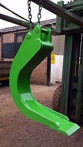

ToughButterCup Posted June 23, 2020 Share Posted June 23, 2020 On 21/06/2020 at 21:30, redtop said: never heard of a clay spade, which one did you use? This is a hand one And a clay spade for a digger is a thin bucket with its cheeks cut off You're on clay ... unavoidable expense... Link to comment Share on other sites More sharing options...
