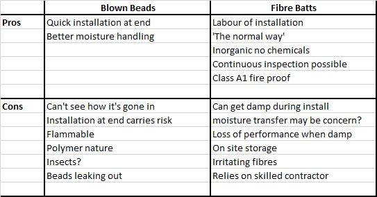

Well I thought I knew exactly what we were going to do for cavity wall insulation years ago, but just before placing the order for the fibre batts I (re?-)discovered blown beads (Ecobeads). I don't know if the Ecobeads have got better in the last 2-3 years since we decided on Knauf Dritherm Ultimate 32, but they look quite attractive. I got some quotes and the price for Ecobeads installed is essentially the same as the Dritherm material cost. I'm finding it difficult to make up my mind now.
Some pros / cons:
Kingspan did a white paper on fibre batts and, whilst they have a commercial interest in knocking full fill insulation, they do make some good points. I haven't seen many sites, but I don't think I have ever seen people installing fibre batts as set out in their BBA documents. Outer leaf first, snot boards and properly orientated batts. I have seen loads of YouTube videos of clearly skilled brickies who don't follow much of this and if you look carefully are dropping and leaving snots on the batts. I don't want to be a nightmare for my brickies breathing down their necks and insisting they work in a way they don't normally, but I'd want fibre batts installed as per the BBA certificate as otherwise there can be a loss of performance even if not an actual damp problem.
There were loads of bodged blown bead installs for retrofit, but I'd expect that is due to narrow cavities as well as other unsuitability issues. I don't like the thought of them and any future work could mean beads blowing about for years to come. I also worry about insects living in them as I have seen that with PIR insulation. There is also a lot of faith in that one day of install. If the installer is a joker then you're stuffed whereas a more gradual install can be understood and rectified much more easily.
We're building in East Anglia so it's the best part of the country for fibre batts, but still.
Blown beads feel like a no brainer for large cavities (e.g. 200mm or more) but I'm not so sure for us (100mm cavities).
Your help and experiences please making this decision would be massively helpful.

I'm still pulled in two ways on this. If I could be certain they were installed correctly, I think I'd go with the Knauf Dritherm Ultimate fibre batts as they are more 'normal'. Blown beads could give a possible future purchaser concerns since there have been horror stories associated with their retrofit use. I like the labour saving of the blown beads and the fact that it wouldn't need the constant monitoring of how the insulation is installed that fibre batts would require. That said, if they mess it up on the day of blown bead install then it would be a nightmare.
These decisions often come down to minimising the downside rather than optimising the upside. Maybe that sounds a big 'glass is half empty', but you don't get giddy about your cavity insulation being slightly better than it could have been, but you would get sick of it being a lot worse.

Well we've surprised ourselves here because we think we will got with the Ecobeads. The U-value is essentially unchanged (Ecobead platinum lambda=0.033W/mK vs Dritherm Ultimate lambda=0.032W/mK) and I have quotes for confidence on the price. We talked to some insurers to see if there were any concerns, of which there was none.
I think the factors that swayed it were:
  1. Intrinsic water handling - drains rather than dries.
  2. No on site storage - I would have worried about the fibre batts getting wet and they would have taken up space as well as being a marginal theft concern.
  3. Ease of wall construction - No fibre batts to put in correctly.
I'm going to get guidance from the installer about how to build with beads in mind to make sure that things like cavity trays fill up with beads nicely.
We are trying to build with a low chemical (VOC) approach and liked that the Knauf Dritherm used their Ecose technology that was Formaldehyde free. We ruled out PIR for chemical reasons. I will double check with Ecobeads that they are equally good in that regard. We're far from obsessive about this sort of thing, but would like to preserve air quality in the house as we are reasonably rural.
