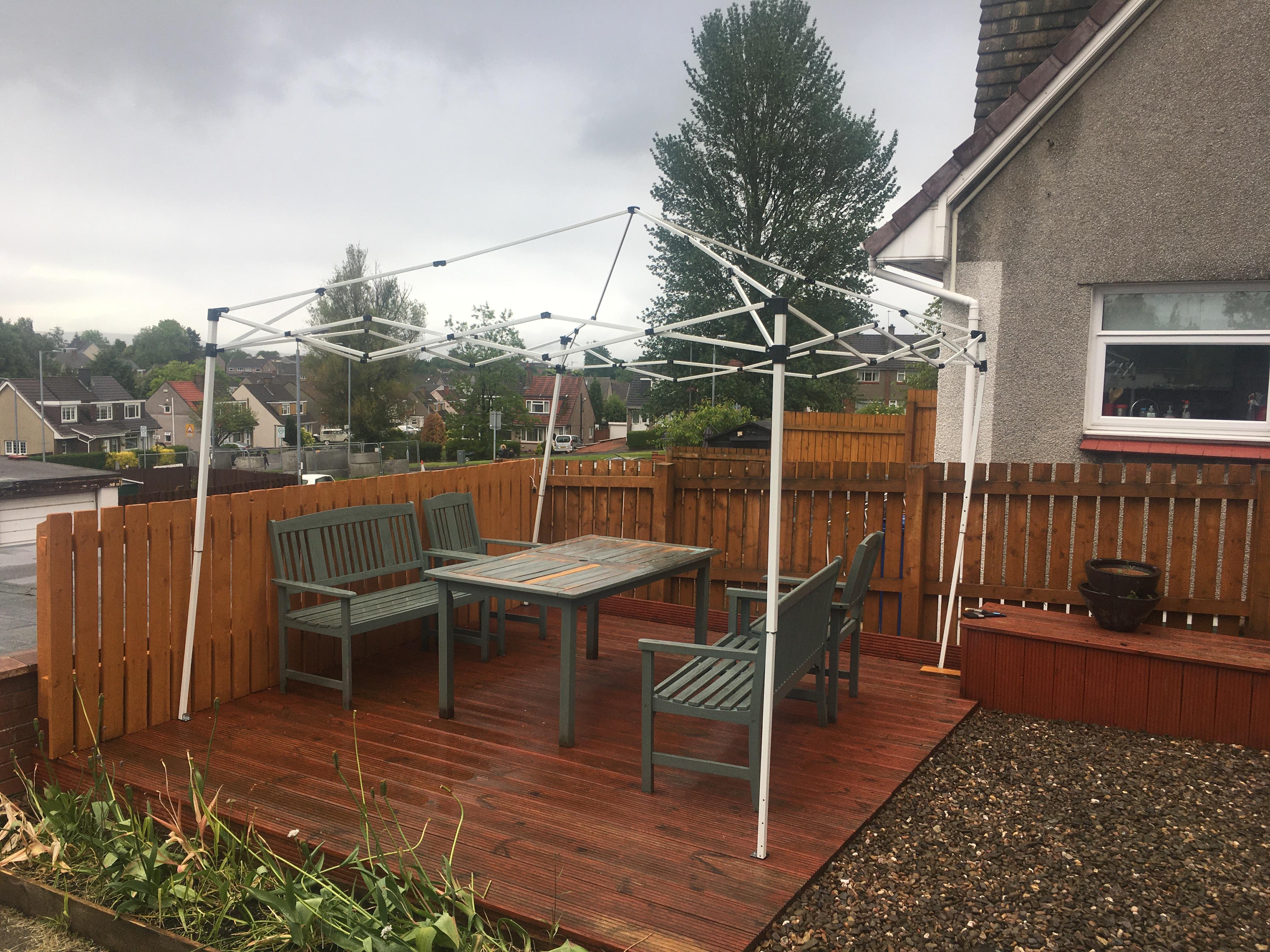

Tennentslager Posted June 4, 2020 Posted June 4, 2020 North Glasgow so winter winds can be wild and it’s a little exposed. 3.5m sq, same shape as the wrecked Aldi fabric gazebo, killed by last nights May winds. New Expensive patio furniture is on order and it’ll protect this in winter too It’s to cover this decking, meets Scottish permitted development rules, snip The permitted development rules for an ancillary building are: it's located at the back of the house it's not used as a separate home to live in it, and any other development, does not take up half or more of the 'curtilage' – this means half or more of the grounds behind your home it's not higher than 4 metres at the highest point any part that's a metre or less from the boundary is no higher than 2.5 metres the eaves (the part where the wall meets the roof) is no higher than 3 metres if the land is in a conservation area or in the grounds of a listed building, the ancillary building has a footprint of less than 4 square metres something like this but just posts on the corners. How to anchor the posts? Roof structure for a square hipped roof, I’m not bad with timber but by no means professional? I’m inclined towards a beefy structure with say 6x2’s for the perimeter of the roof edge? Appearance from underneath, thinking frame it, paint/stain the frame and then sheet it in ply (maybe pre painted in a contrast from the frame) then felt tiles as they easy and neat? Don't plan gutters but maybe? id welcome the collective knowledge...
daiking Posted June 5, 2020 Posted June 5, 2020 I’m gazing at my Aldi special now worrying about the wind. Gusting already but not supposed to windy till later. Took it down last week when it was 40mph ?. Forecast is 35mph+ later. Wont you have to lift the decking and fix your post into the ground?
Temp Posted June 5, 2020 Posted June 5, 2020 Whats the ground like? Screw in anchor for 4x4 post. Shop around as might well find cheaper versions.. https://www.amazon.co.uk/Mayne-580D-BK-Dig-Ground-Anchor/dp/B00191RWKA

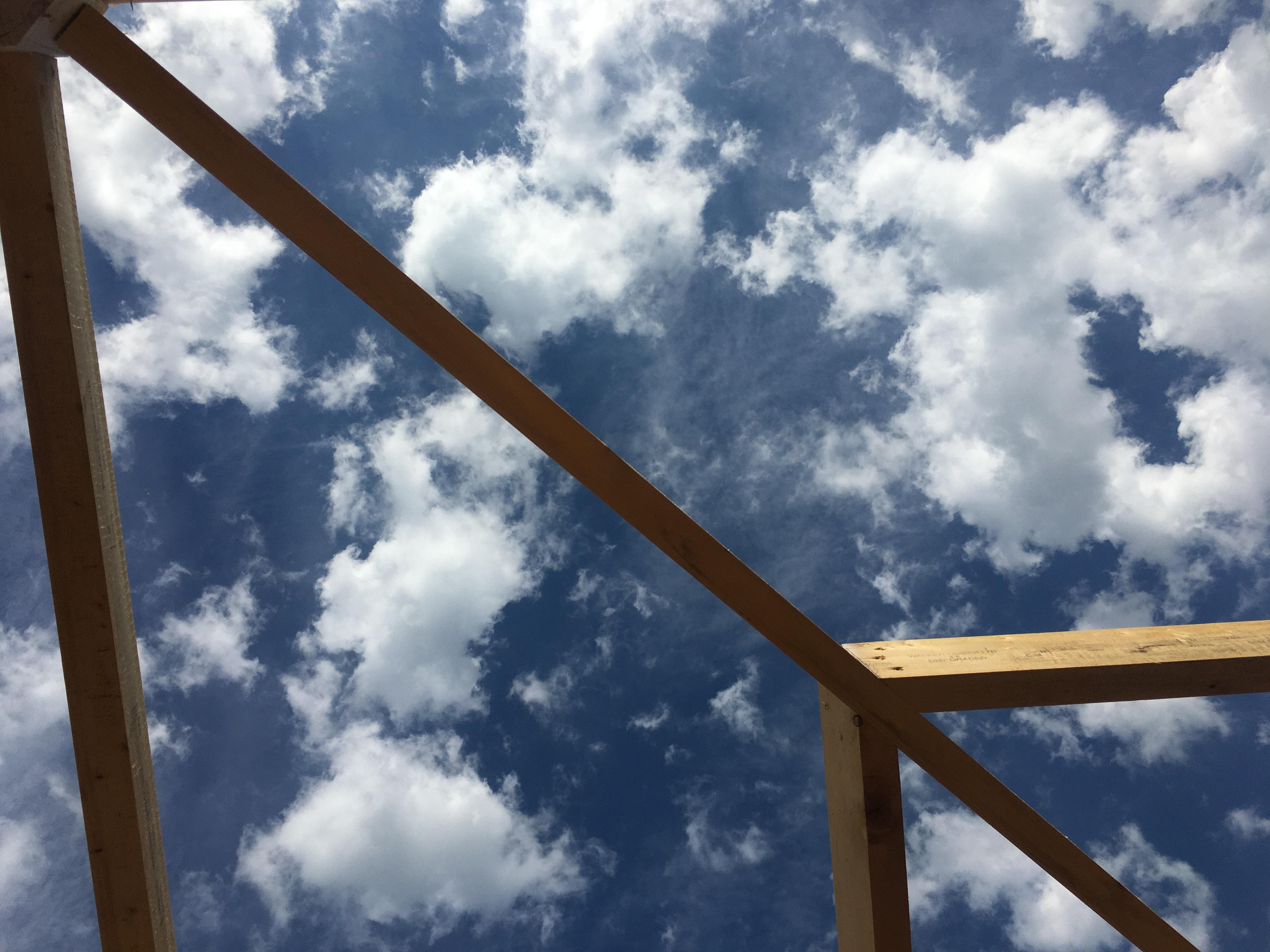

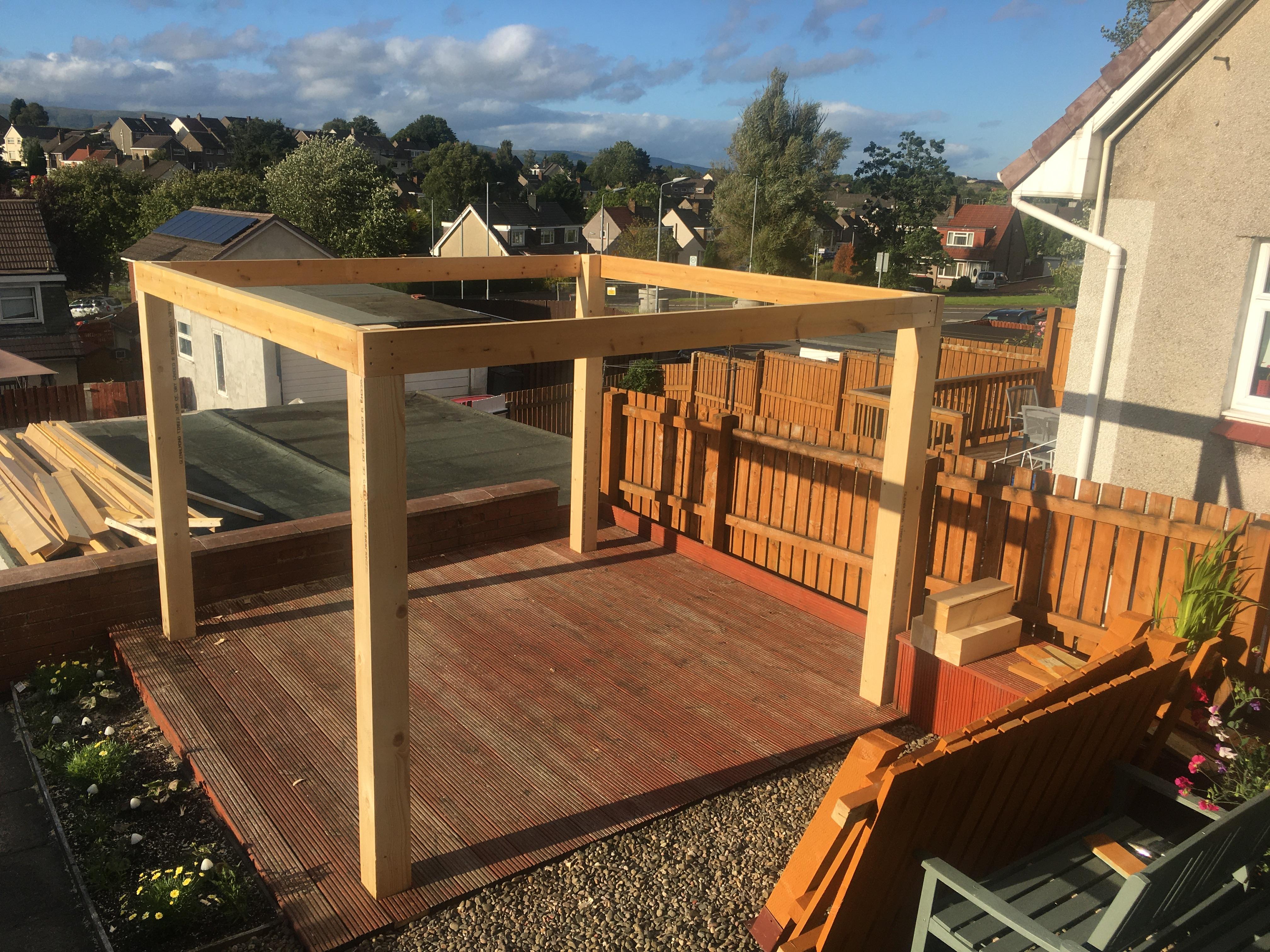

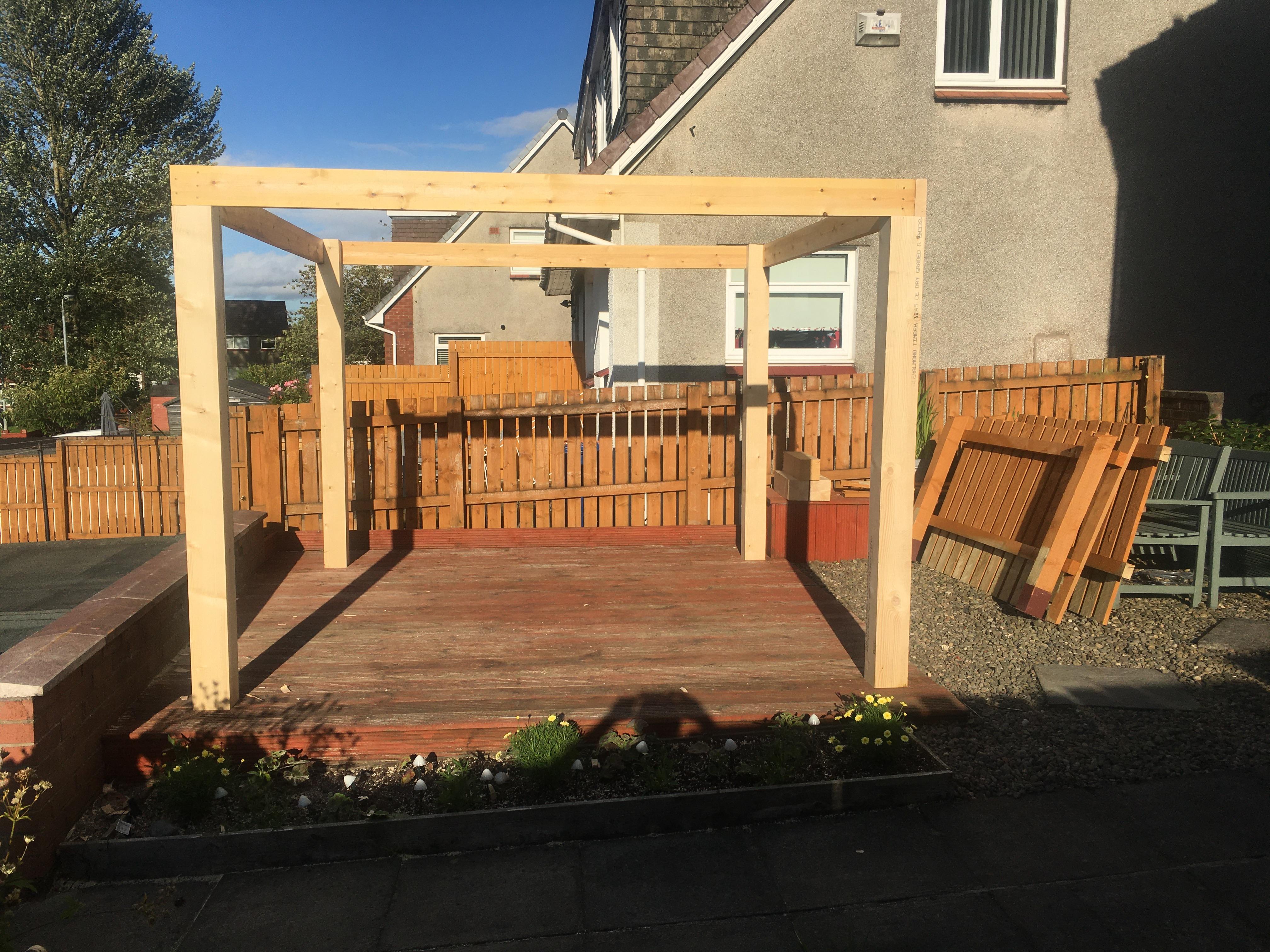

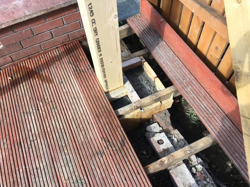

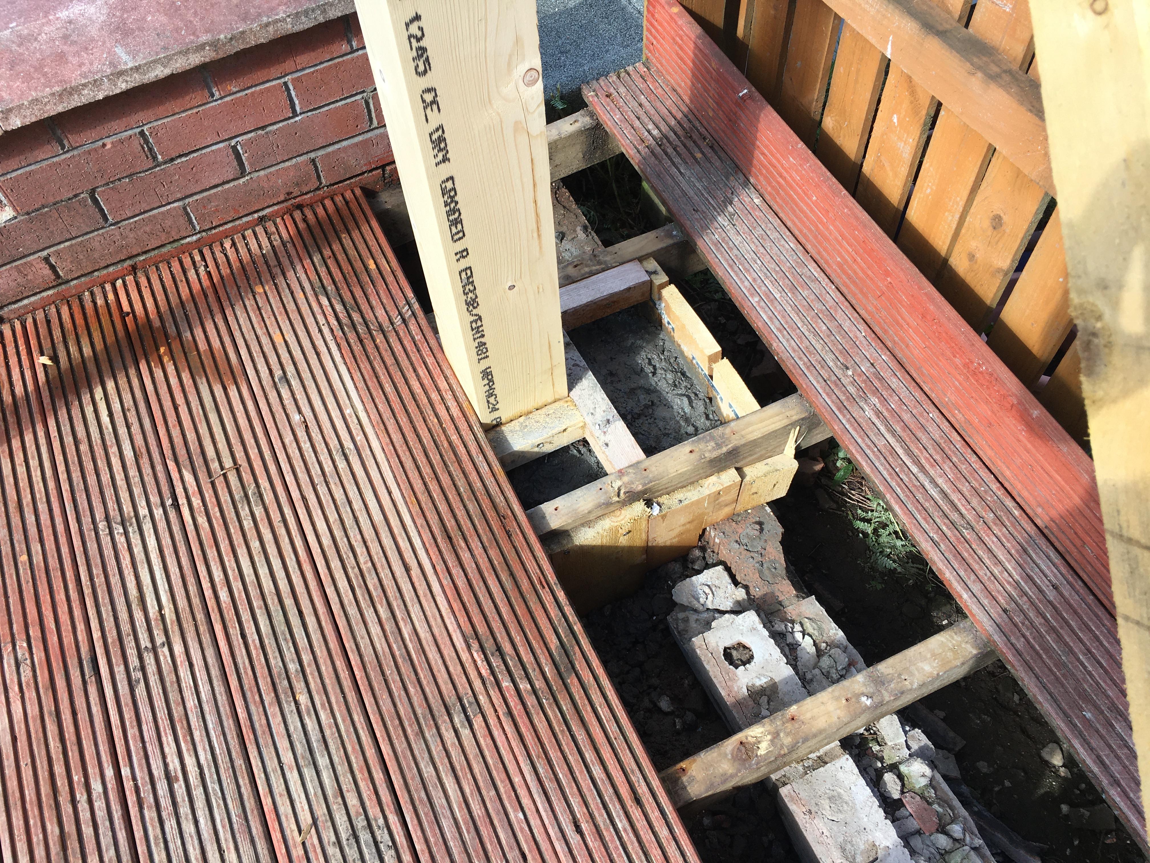

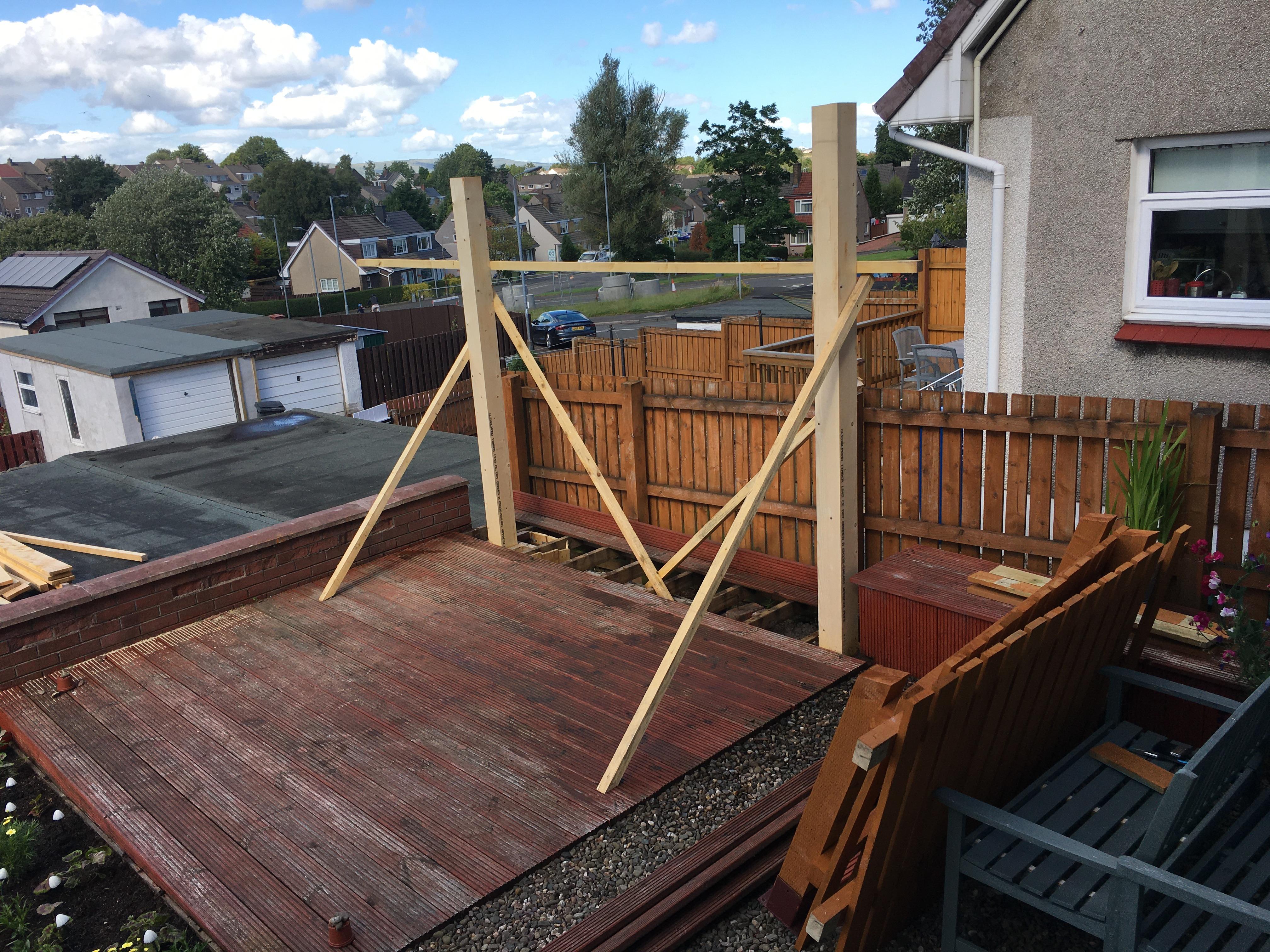

Tennentslager Posted July 26, 2020 Author Posted July 26, 2020 Back from holiday, first time I’ve chosen Aberdeenshire, lovely people, lovely wee fishing village, everyone great with CV19 precautions and so nice to sit outside and have a pint. Anyhow, started today. Decided to drop the posts 500 below the decking, batten and screw into the joists then shutter around that and pour in a cement and stone mix. Think it will withstand the winter gales. Two of the big corner posts in, two more then the wall plate and I’ll post more pictures then

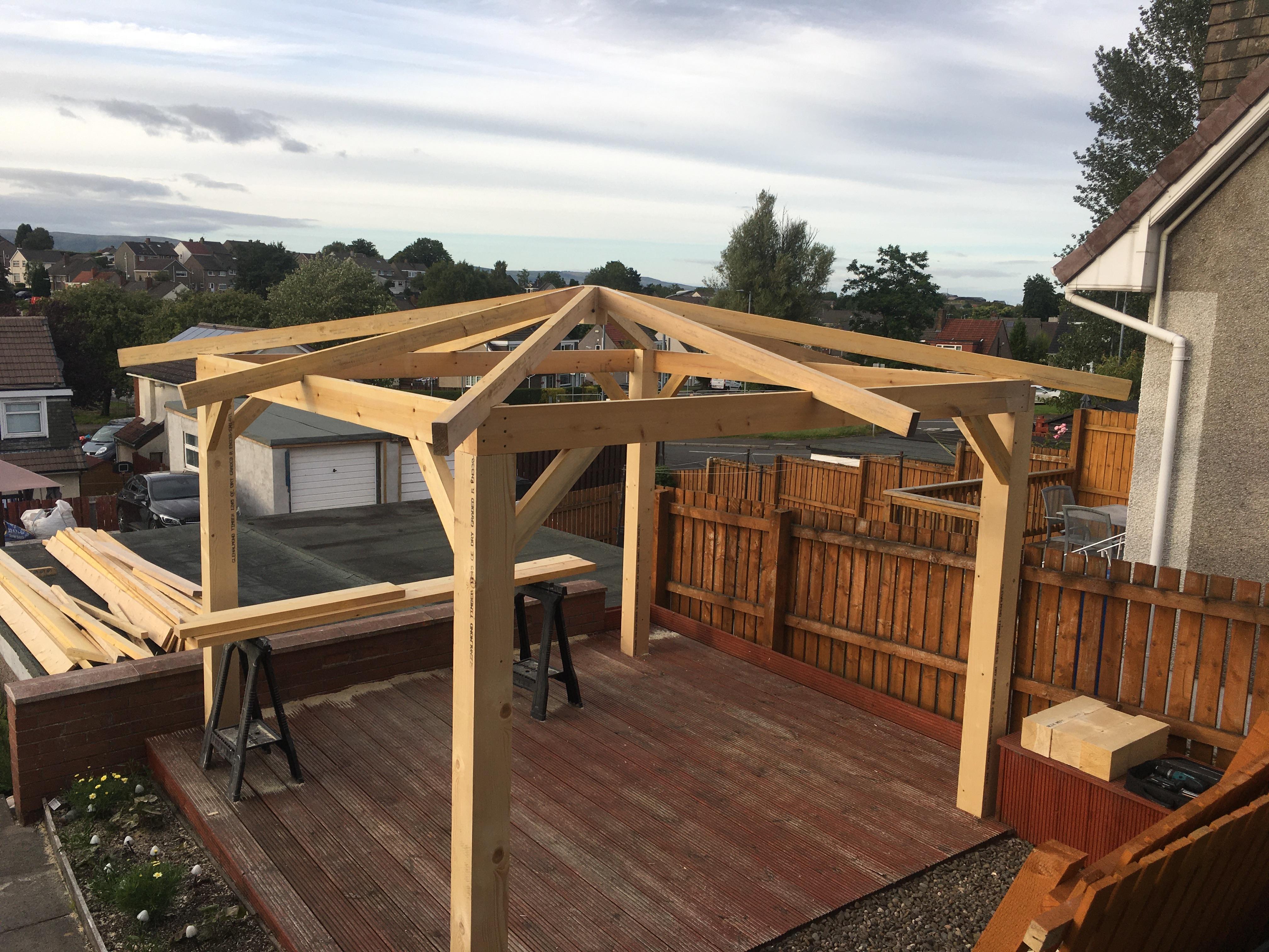

Tennentslager Posted July 28, 2020 Author Posted July 28, 2020 Okay, got out of the ground...next the roof.So, not sure of the correct terminology so I’ll make some up? I’m having a floating octagonal king post, fashioned out of a cut off of the big posts. I’m planning to make up the diagonal truss on the ground and offer it up to mark the birds tooth notch. Once that’s done, I’ll do two more and then pop it up in place. I will put in a centre post directly under the king post and screw home to keep everything supported. I also feel fairly confident about the standard rafters (from king post to the centre of the wall plate) but will be asking for help (thanks for the kind pm @Simon offering help) with the angle nightmare that is the jack rafters. Can I ask one thing? I plan to leave the rafter ends long and cut them after the roof frame is complete. Is this correct? Should I cut the diagonal rafters to the correct size (300mm overhang) or also leave them proud?
Declan52 Posted July 28, 2020 Posted July 28, 2020 These are both worth a watch. And this. Lots of very good roofing tips.
Simplysimon Posted July 28, 2020 Posted July 28, 2020 hi @Tennentslager leave all rafters long, string line through when finished and then cut plumb and seat cuts.

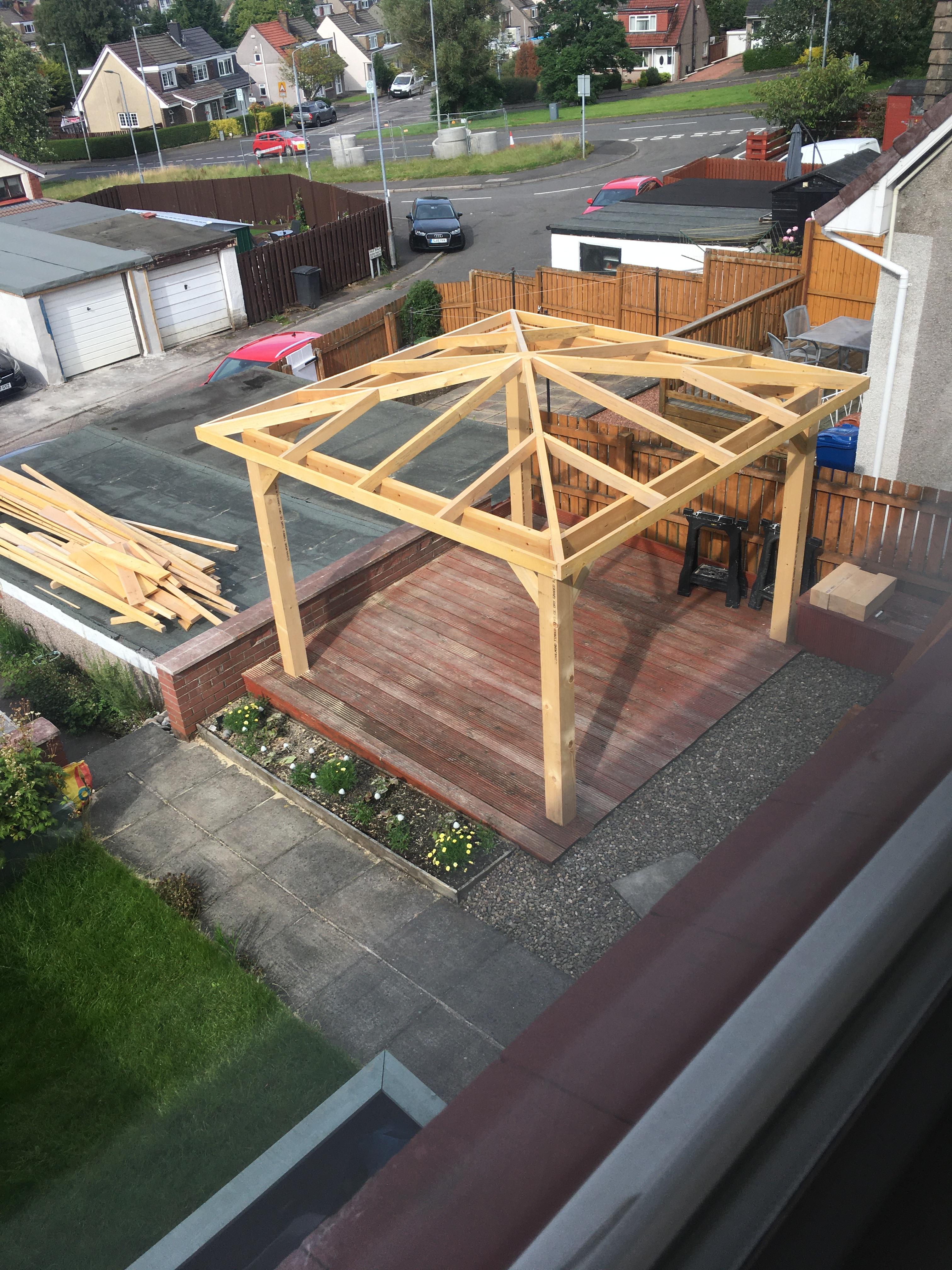

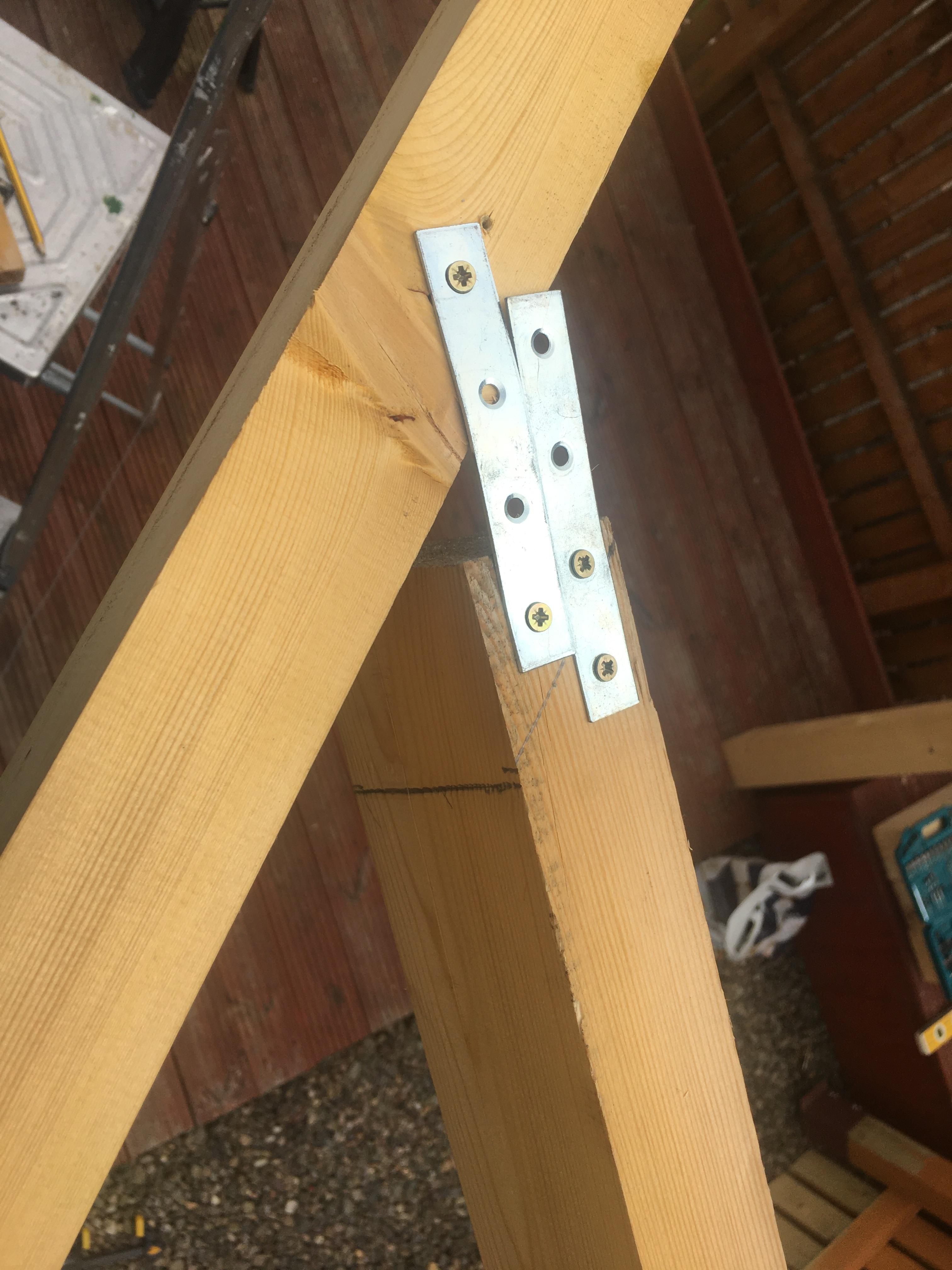

Tennentslager Posted July 29, 2020 Author Posted July 29, 2020 Did this after finishing work early... I’m happy so far, a couple of dodgy joins, can I use decorators caulk to fanny them up as it’s getting painted? Jack rafters still to do and think it’ll be Monday evening before I get a minute??
CC45 Posted July 29, 2020 Posted July 29, 2020 Looks tidy. Decorators caulk won't like any wet on it - its not silicone. What about some wood filler? https://www.screwfix.com/p/ronseal-high-performance-wood-filler-natural-550g/51811
Nickfromwales Posted July 29, 2020 Posted July 29, 2020 Dec caulk will be fine if it's not in direct rainfall. If you use silicone you wont be able to use any water-based products thereafter. Prob best to paint it all up and look at whats left. If necessary, then choose a product to fill with, probably frame sealant would be best at that stage and is over-paintable when you tart it up next..
Tennentslager Posted July 29, 2020 Author Posted July 29, 2020 (edited) No nonsense exterior frame filler from Screwy does it, 3.5 squid and one tube will cover a multitude of sins? I have a plan to measure/cut the jack rafters but I’ll holler if I get stuck oh and those videos are great @Declan52 but double Dutch mostly to me Canny quite beleive how strong it is, even with 4 rafters I could stand on it, with 8 it is solid Edited July 29, 2020 by Tennentslager

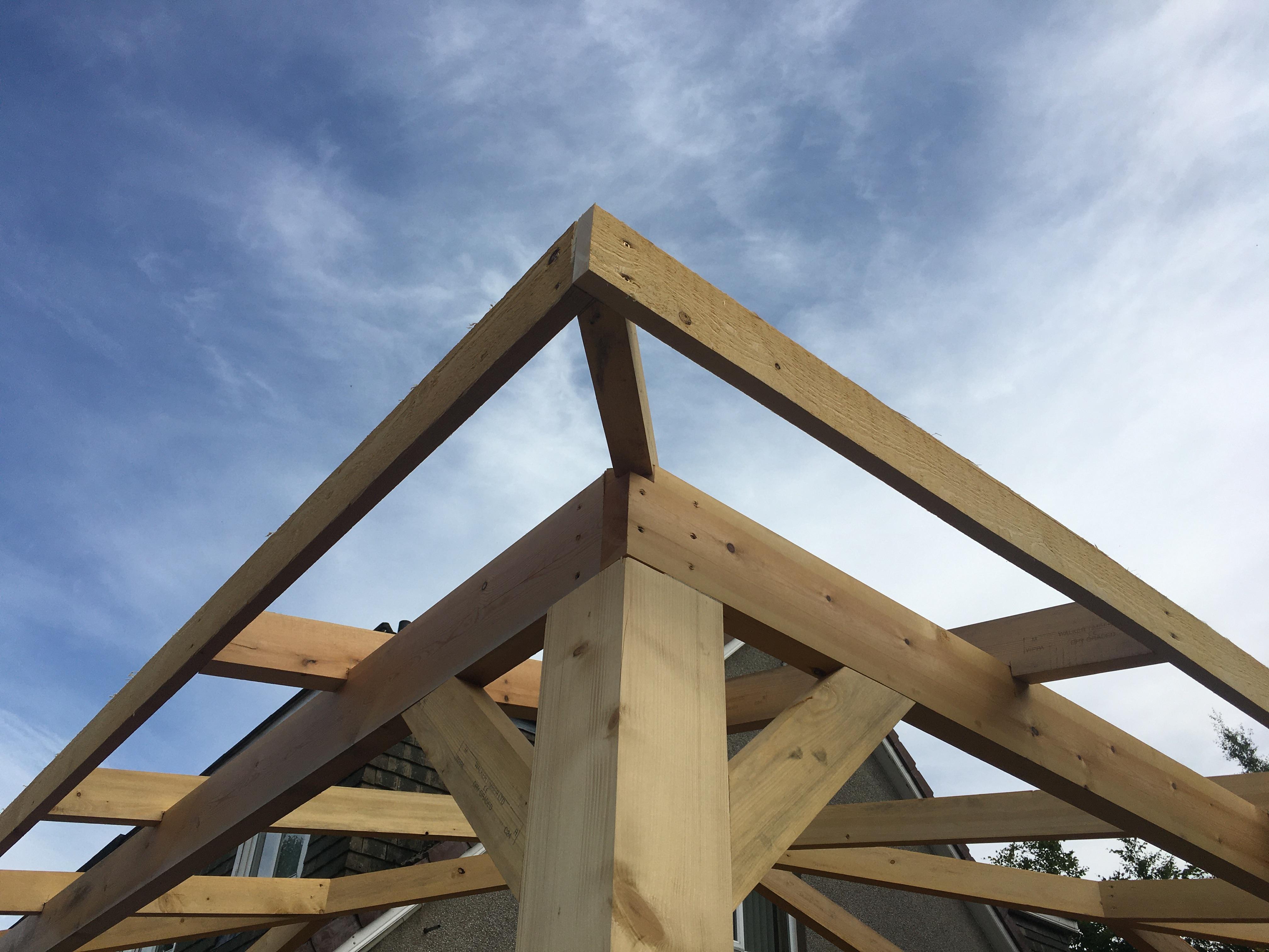

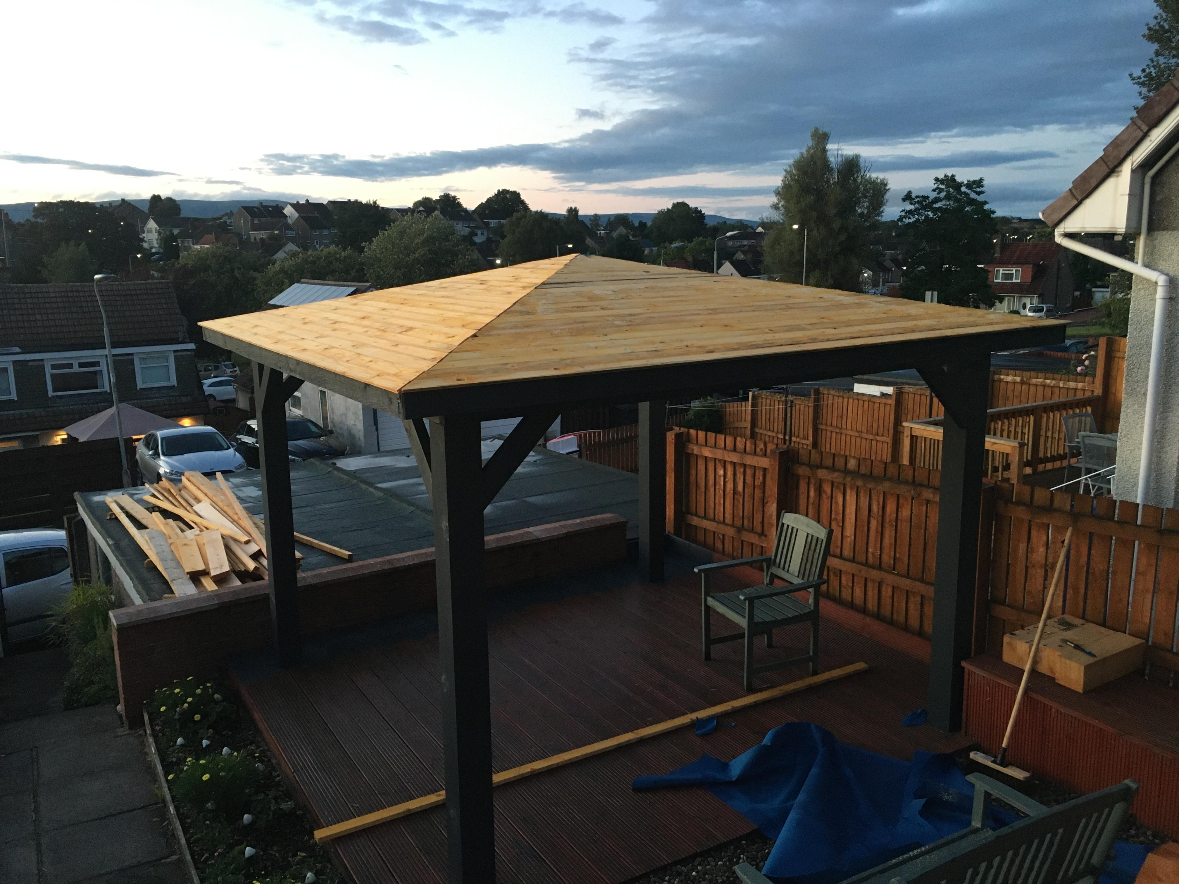

Tennentslager Posted July 31, 2020 Author Posted July 31, 2020 Got a half day off so cracked on in the sun. I offered up the jack rafter, wee plate to hold in place and carefully marked and cut it. Once you’re doing it, it’s much easier to visualise than the videos One of my better joins ? Got the end plate on as it’s getting a mini gutter bingo bango...time for a wash and as it’s Friday Hello lovely 1
Nickfromwales Posted July 31, 2020 Posted July 31, 2020 Looking good And the gazebo is shaping up too

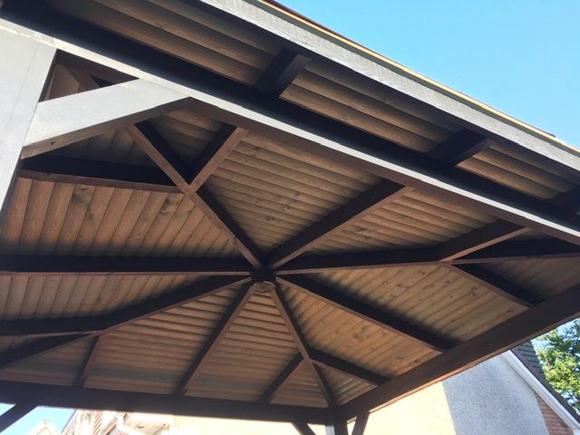

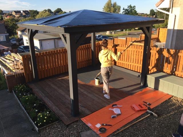

Tennentslager Posted August 7, 2020 Author Posted August 7, 2020 (edited) Bon voyage BBQ Sunday so have to get a wiggle on... latest, it’s been pouring proper rain up here stopping progress BTW went for loglap for the roof, painted on the inside face, looks good Edited August 7, 2020 by Tennentslager Drunk 2
Tennentslager Posted August 8, 2020 Author Posted August 8, 2020 Inside roof, Cuprinol Shades is a great product And we are nearly ready for the BBQ tomorrow 4
