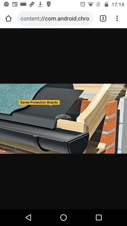

So, almost finished the felt tiles (just need to get a final bit of trim for the apex) and got the gutter on.D2DFDFA7-4E3D-4B15-809C-578BEA532221.thumb.jpeg.86026d79b20b6f6a4af6a152e961e208.jpeglooks nice but today it rained and good news is the roof does not leak but sumfink is up with the gutter
Profile of how it’s fitted
F48F33DE-0CE3-4930-A62D-A7BB30758F59.thumb.jpeg.efd2f61c5bb9592aae6637c4929ab373.jpegThe drips on the board the gutter is fixed to is the problem...
97A00A82-08AD-4F69-9BB9-BCF9B1C592A9.jpeg.d374ed181d884d56f5a14dbb7c0020b4.jpegSome water (most) is following the blue line but some is following the green line and dripping like fcuk
Very little overhang into the gutter, plus shallow angle must be allowing water to hug the surface and come back underneath.
If possible bend the end of the felt downwards so the droplets have to fall off the end
Can you tuck something like this up under the tile? Link
That would get sealed to the tile with black CT1 / similar frame sealant  and will provide a barrier from wind blown rain, plus a drip into the gutter that should solve the problem.
None is getting on the end of the roof board is it?
Maybe slip something like eaves protectors up between the felt tile and roof board if that's doable?
The felt tiles are prone to strong winds so followed the MI’s and put a good bead of adhesive on the bottom edge so no chance of sliding a trim up there.
But ordered a couple of rolls of 50mm flash band tape and although footery I can stick this to the underside of the tiles and down onto the inner face of the gutter!
Ill report back once it’s dry enough, Scottish weather forecast tonight was next dry day sometime after the weekend, ffs it’s August, rain all week
