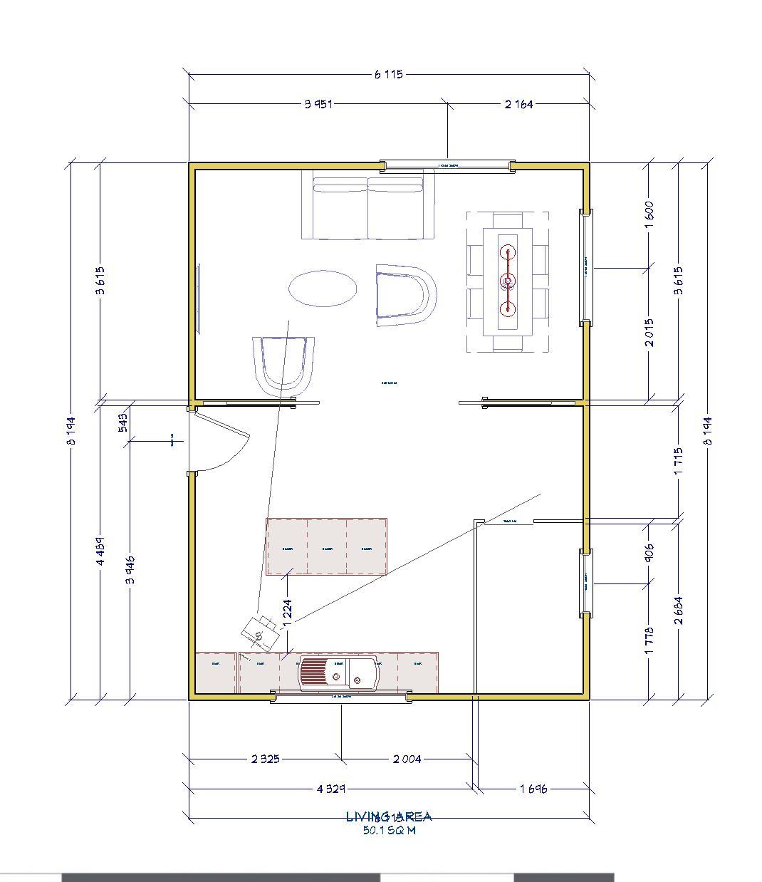

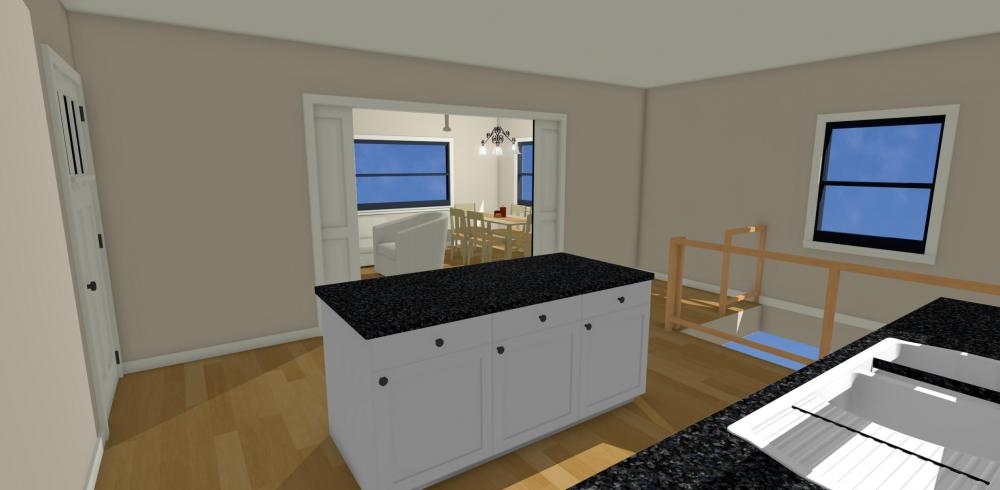

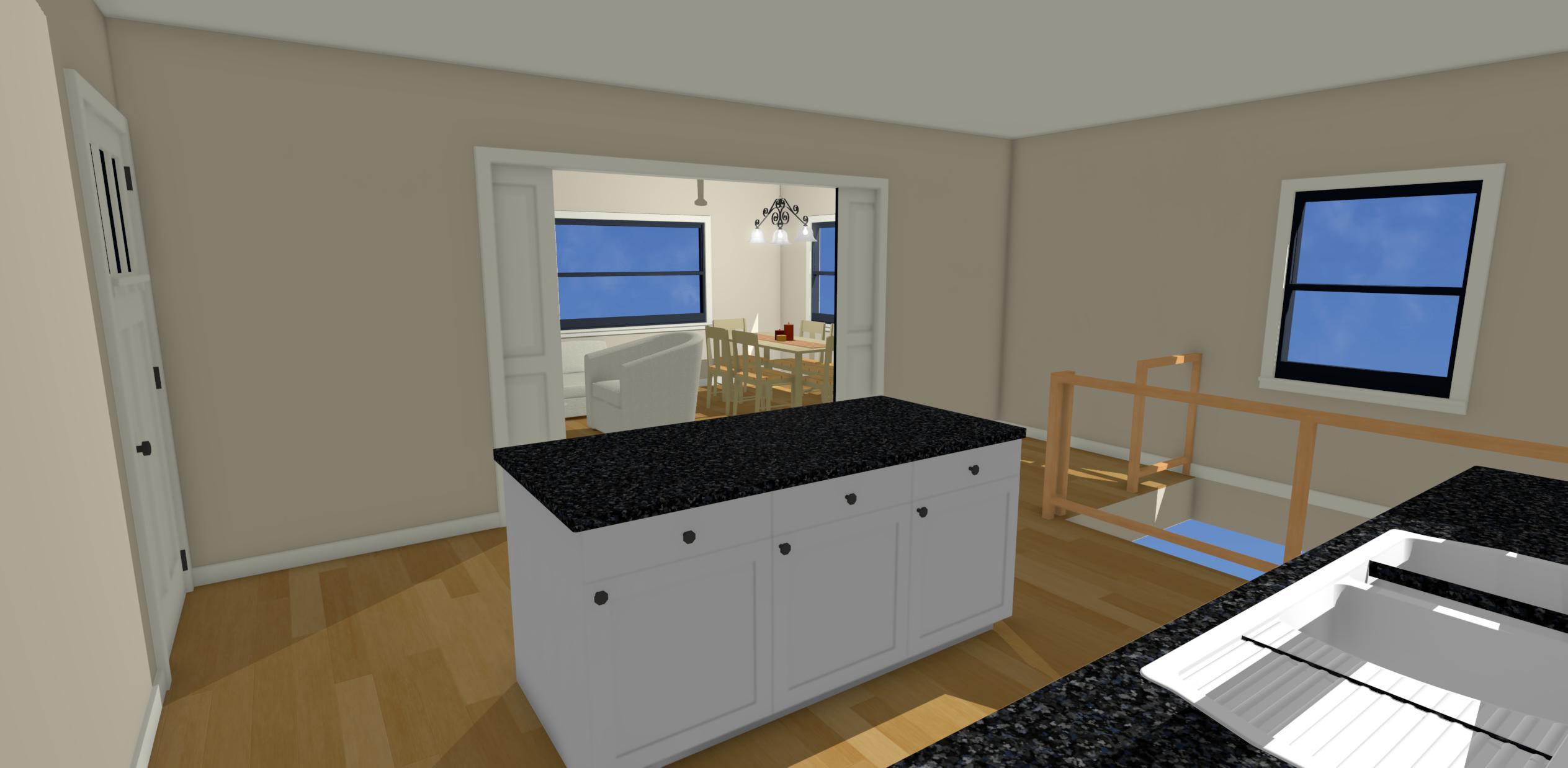

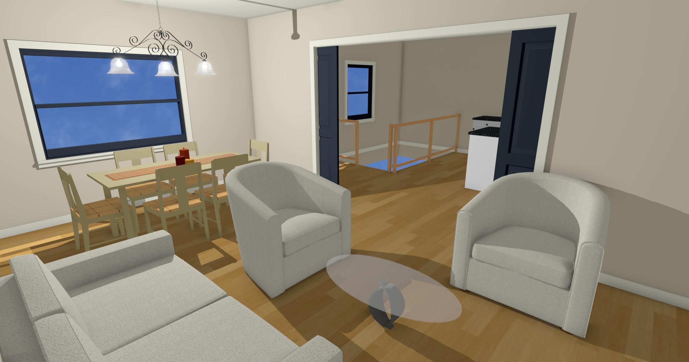

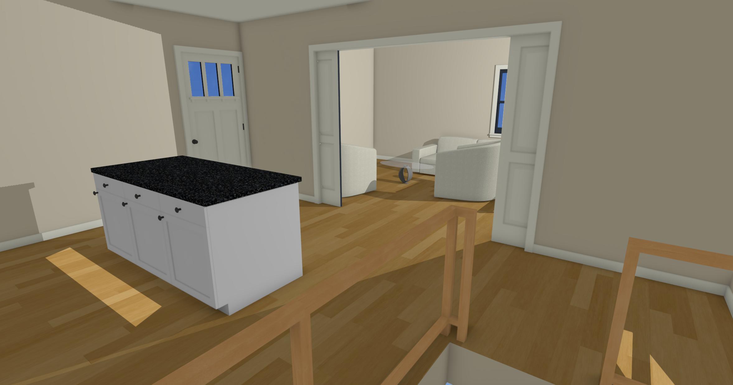

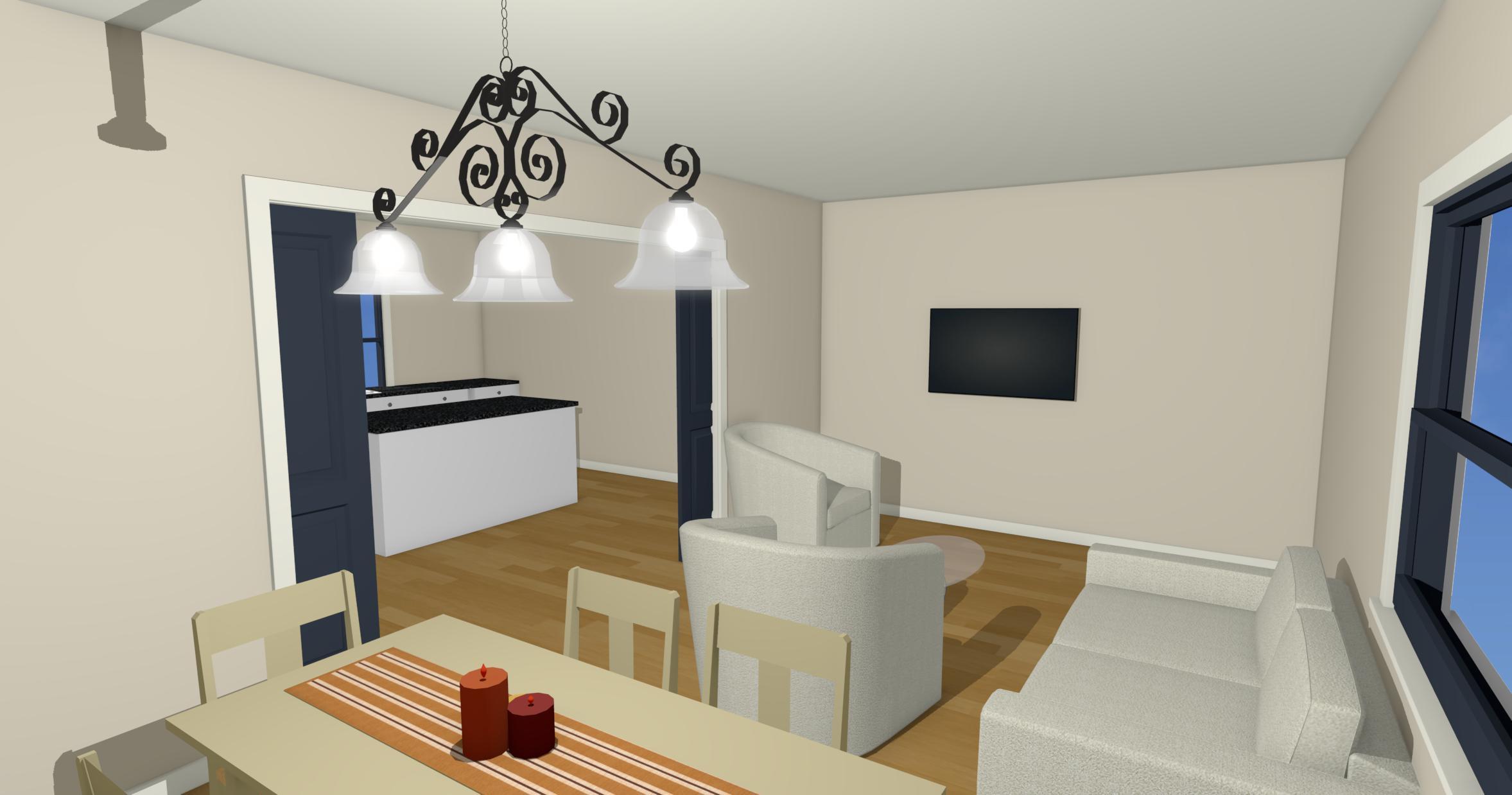

puntloos Posted June 3, 2020 Posted June 3, 2020 Just giving some offhand comments, I've browsed through this thread quickly so if I'm redundant or way off, just consider it as some minor food for thought and/or confirmation of agreement.. - No issue with master & living being close, at first floor, although I would increase sound separation. You have one thin wall between your bed and your master. You could perhaps consider sealing off the stairs to buffer the sound. - Not ideal to have no bathroom near kitchen/living. I'd consider sacrificing the end of the utility, which is currently massive. - The word 'snug' to me always translates to 'I have no idea what to do with this space'. Are you certain it's a good idea? Why not a larger bed2 (ensuite?) - The porch is sealed? I can kinda see the point of a open space, but if it's basically a room before your house then unless you have horses you need to scrub I'd skip. - The living space feels a bit 'tennis-court-y' - no real separation of features, which includes kitchen noises and smells. Haven't thought deeply on if it's fixable - If TV/movies is not your thing, fine, but obviously putting a TV in that corner will not let you get close to a nice viewing experience. - Have you thought about storage space in dressing area? Can you fit all your clothes in 1.6(?) m of wardrobe? Offhand, I'd put the stairs in the bottom right corner, and reclaim a larger amount of space for a living area, perhaps even separate it off (pocket door? dressing door down as far as possible?) 1
Omnibuswoman Posted June 5, 2020 Author Posted June 5, 2020 On 03/06/2020 at 23:24, puntloos said: Offhand, I'd put the stairs in the bottom right corner, and reclaim a larger amount of space for a living area, perhaps even separate it off (pocket door? dressing door down as far as possible?) I’m interested in this, but can’t quite picture what you mean. Do you mean put the stairs in the dining table corner?
puntloos Posted June 10, 2020 Posted June 10, 2020 (edited) On 05/06/2020 at 11:42, Omnibuswoman said: I’m interested in this, but can’t quite picture what you mean. Do you mean put the stairs in the dining table corner? Something like this. Clearly the table is a bit of a squeeze - perhaps it can fit somewhere better with some movement. Just something to think about. Edited June 10, 2020 by puntloos 1
Omnibuswoman Posted June 18, 2020 Author Posted June 18, 2020 On 14/06/2020 at 15:14, puntloos said: I guess that settles it then thank you @puntloos!! I showed your layout to my other half and we both thought there was real merit in having a sitting area that we could close off from the kitchen/dining area. Great idea! 2
puntloos Posted June 20, 2020 Posted June 20, 2020 (edited) On 18/06/2020 at 23:47, Omnibuswoman said: thank you @puntloos!! I showed your layout to my other half and we both thought there was real merit in having a sitting area that we could close off from the kitchen/dining area. Great idea! Nice to hear! Clearly i've just 'thrown it together' in a free moment so do have a pro check it through, but I've been playing with various room designs for a while so it's not absolutely crazy I think Quick note: I'm probably going to go for a telescoping pocket door which give you even more gap space. https://www.eclisse.co.uk/telescopic-sliding-pocket-door-system-double/ is on my shortlist. Also do make sure you have enough storage in the kitchen. Not that I changed anything to yours but it seems a bit thin on shelf space? I would probably try to use the side wall too. Edited June 20, 2020 by puntloos 1
