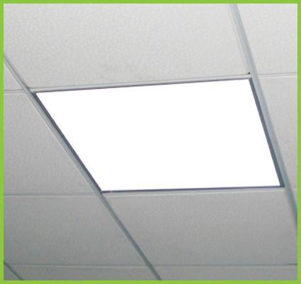

Carrerahill Posted June 1, 2020 Posted June 1, 2020 1 hour ago, Onoff said: Your best bet, pre skimming and depending on the impact on room height, might have been counter battens to create a service void then another layer of pb as the finished ceiling. Then low profile LED panels. With hindsight I should have done that. I have Thermahoods. LED panels! It ain't an office!
Carrerahill Posted June 1, 2020 Posted June 1, 2020 46 minutes ago, dpmiller said: to the OP are you looking for focussed pools of light or diffuse light from above? If the latter, then the slim LED panels fit within the PB layer, but you'll need a bit of space above (slack membrane between joists) for the clips and driver. Again, this mention of panels! Do you, @dpmiller and @Onoff know what an LED panel is? This is a panel...

Carrerahill Posted June 1, 2020 Posted June 1, 2020 14 minutes ago, joe90 said: Or https://www.ebay.co.uk/itm/LED-Ceiling-Light-Round-Panel-Down-Lights-Bathroom-Kitchen-Living-Room-Wall-Lamp/283782887813?_trkparms=ispr%3D1&hash=item4212c73985:m:mVeG8bdHNC4IlW-dO2MdtPA&enc or you can get them that fit flush with the plasterboard and barely thicker than the plasterboard! That isn't a panel and never has been though, that is a low profile down-light. That is a case of someone calling it a panel because it is thin but it is not more a panel than a search-light. If you want diffused light there are far better ways of achieving it while keeping a smart domestic look, multifaceted reflectors or etched diffusers etc. even some GU10 lamps now come with an optic system which will give uniform distribution without the tight beam angles and sharp cut-offs.
Onoff Posted June 1, 2020 Posted June 1, 2020 46 minutes ago, Carrerahill said: Again, this mention of panels! Do you, @dpmiller and @Onoff know what an LED panel is? This is a panel... Yes and neither of us meant that! ? 1
dpmiller Posted June 1, 2020 Posted June 1, 2020 I don't care what shape it is, it's still the same tech- an edge-lit panel.
