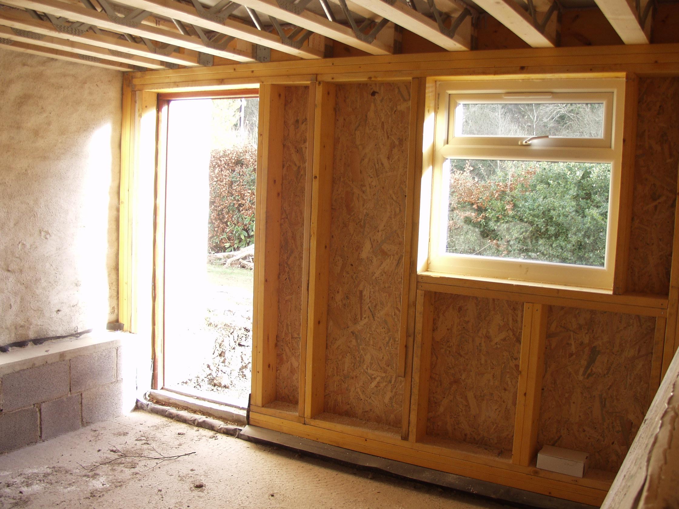

zoothorn Posted June 23, 2020 Author Posted June 23, 2020 @Onoff hi Onoff or anyone. Could you give thoughts on my last area in my lower room to do: the 'retaining'/ covering 2 block high wall whacked up over the (alarming) exposed earth area below my old wall shallow foundations. Pic: you can just see it LHS. Its back-filled with mortar ~ 6" so pressing a dpm onto the earth side = a long low small shelf. I got plants growing up out from behind the vertical dpm.. fantastic.. god knows what I do about that. Board it over? if so fixing.. Ive seen soudal foam specifically to fix board onto block/ brick ( I wonder if soudal LE foam be useable even.. having got 1/2 a can here). Thanks, zH
Onoff Posted June 23, 2020 Posted June 23, 2020 Soudal low exp will fix boards to that as long as you hold the boards in place with something. Blocks, bags of sand etc. gas bottle whatever.
zoothorn Posted June 23, 2020 Author Posted June 23, 2020 4 hours ago, Onoff said: Soudal low exp will fix boards to that as long as you hold the boards in place with something. Blocks, bags of sand etc. gas bottle whatever. Understood.. so you've never used the soudal board-fix-foam specific stuff? looks pretty similar I must say. Its just the moisture in it & its only adhesion being its paper that concerns me. I got 1 board to do it/ must prep & do it once & right. This plastering-reveals & doors etc is holding me up hugely. Not only hugely time consuming (3x the pB job itself & all the sanding to do yet).. but the plasters taking 3-4 days to dry. I don't understand it. Ive gotta sand, then redo another coat & another few days to dry > start main sanding.. its almost unbearable. I'm sure I'm not doing something right here.
Onoff Posted June 23, 2020 Posted June 23, 2020 Yes the specific stuff for sticking boards is excellent. I've used it. Does what it says on the tin. Thought you didn't want to buy anything else and use that 1/2 can up?
PeterW Posted June 23, 2020 Posted June 23, 2020 37 minutes ago, zoothorn said: looks pretty similar I must say. It isn't... the board foam sets in about 10 minutes, the standard stuff takes a while longer
Cambs Posted June 23, 2020 Posted June 23, 2020 6 minutes ago, PeterW said: It isn't... the board foam sets in about 10 minutes, the standard stuff takes a while longer I used this to fix foil backed insulation to blockwork. It's good stuff and does go off quite quickly. I think it said on the back of the tin that it'll do 5 or 6 sheets of plasterboard, so about £2.50 a board. https://www.screwfix.com/p/dow-insta-stik-expanding-foam-grab-adhesive-gun-grade-750ml/72793
PeterW Posted June 23, 2020 Posted June 23, 2020 That’s the same stuff as the Board Fix one as it’s rapid curing. Think that one is a lot cheaper though than £12/tin
zoothorn Posted June 23, 2020 Author Posted June 23, 2020 2 hours ago, Onoff said: Yes the specific stuff for sticking boards is excellent. I've used it. Does what it says on the tin. Thought you didn't want to buy anything else and use that 1/2 can up? No I was just asking if you've used it, whether it was the ~same product 'rebranded'. So you have used it.. & its not/ got that. So as Ive only 2/3rds of 1 board of pB area (my diddy block 'covering' wall).. it makes sense to up my 1/2 can soudal LE & brace it with s'thing as suggested. saving even £12 helps at the mo. It doesn't have to be perfect here. thanks.
