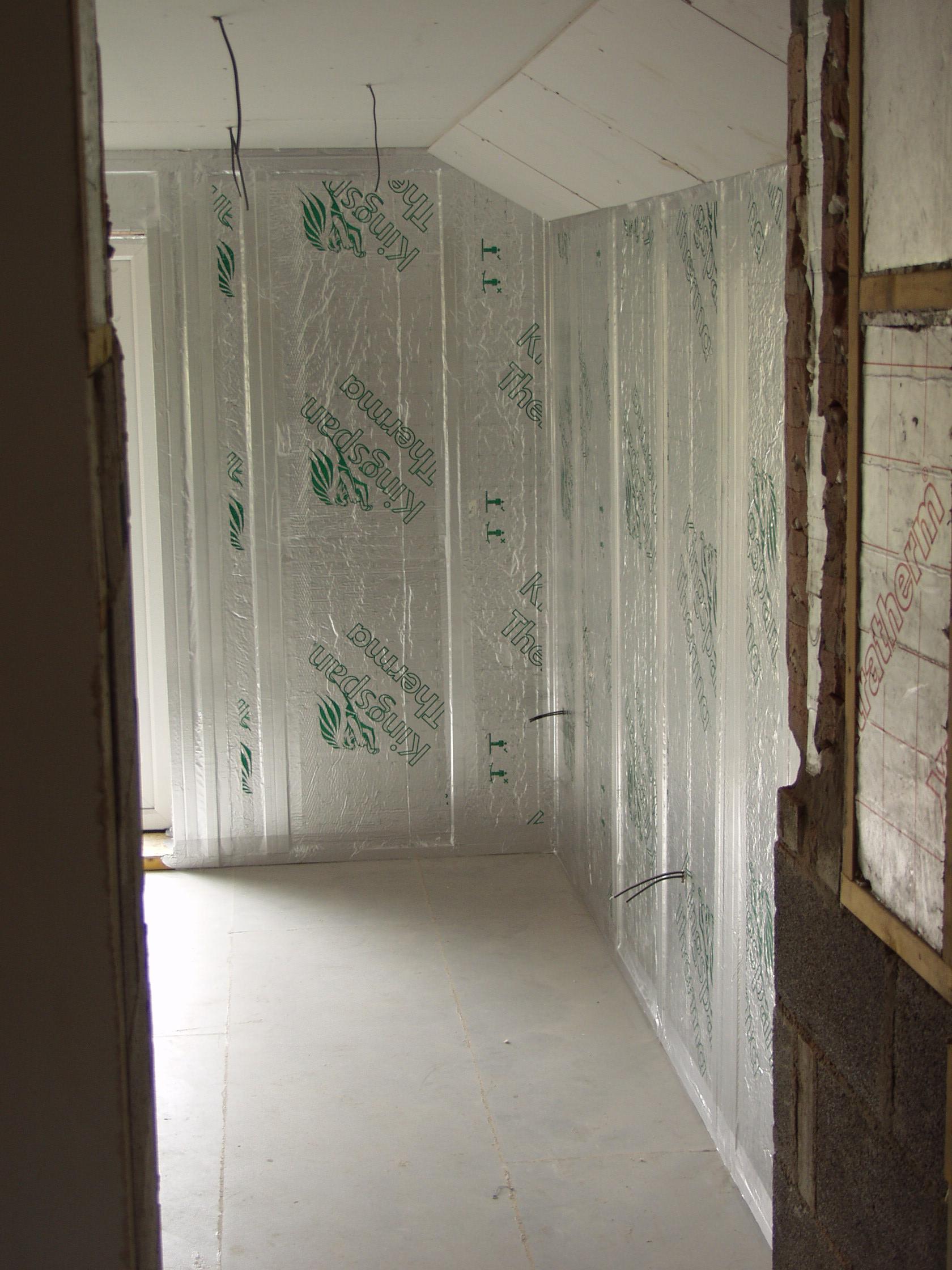

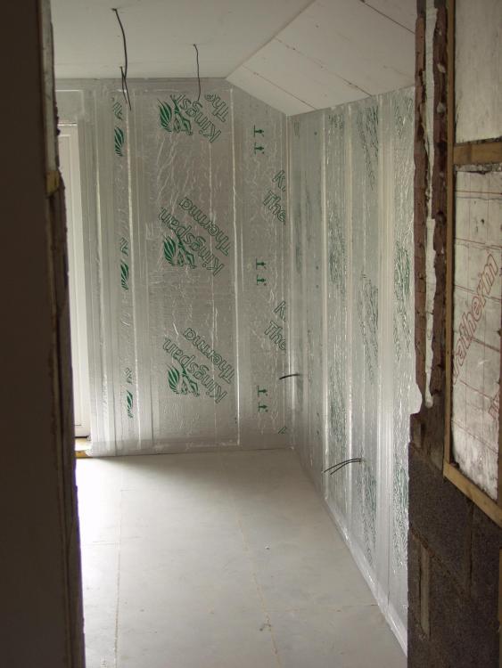

Actually I need to check my basic board plan before anything. Pics of room below (french doors midway between 2 pics as it were).
The easier wall to start is 2nd pic @ only 2.1m high. So what I've done is look for studs @ W 1200mm & find some twds middle. So I can get two full W boards to fill most of middle area.. leaving a 460mm gap LHS, & 900mm gap RHS.
Do I start with one of these two full boards? or, from the LH corner with say the 460mm offcut > then a full W board?
thanks- zoot schmoot.
Link to comment
Share on other sites

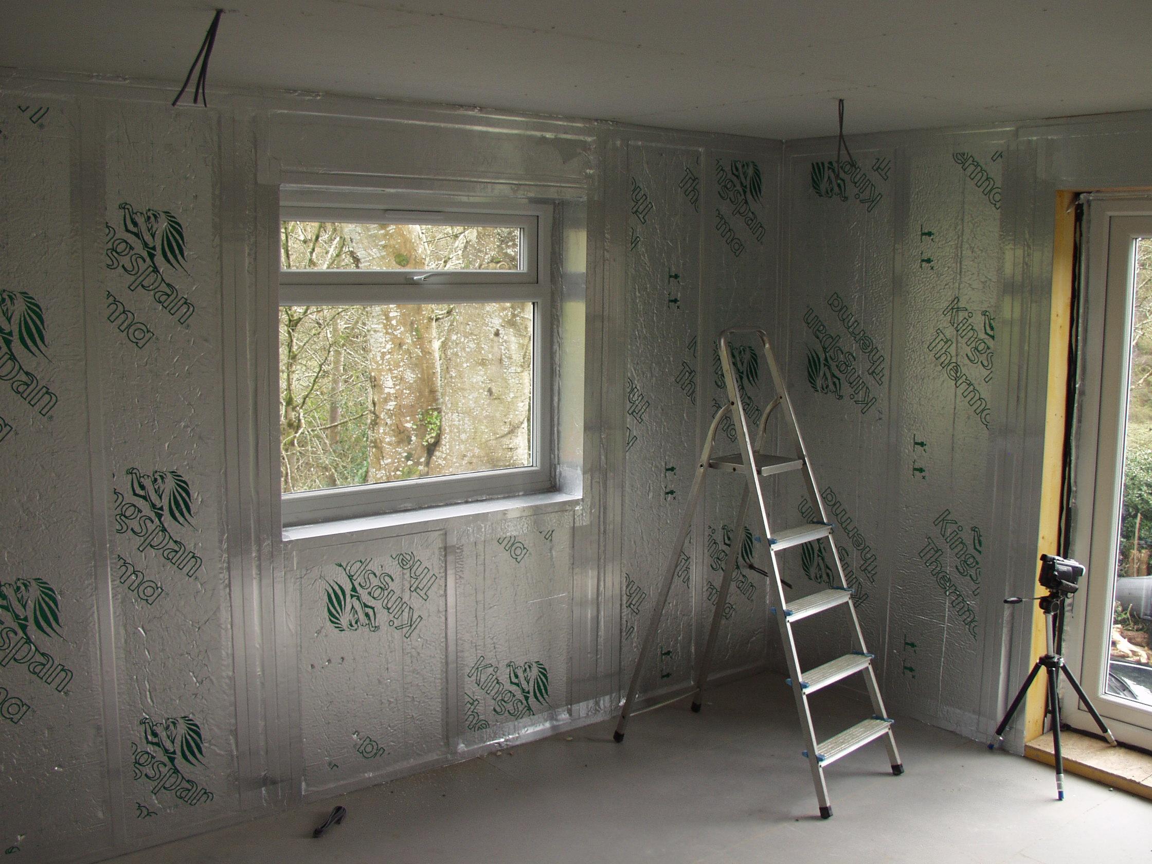

Hi chaps. Can anyone lend a hand..
Now weather's broken its last prep for this job. I need to establish where I start boarding from, which board to place 1st. Walls.
I find 1200mm width's between studs, only twds the middle of my walls. Do I start with these (2 in my case) full boards.. & fill in the remaining offcut/ smaller area (farthest L, & farthest R) afterwards?
Or, should I start at the corner with the offcut, then the two full boards, then the other smaller W offcut?
thanks- zoot.
Link to comment

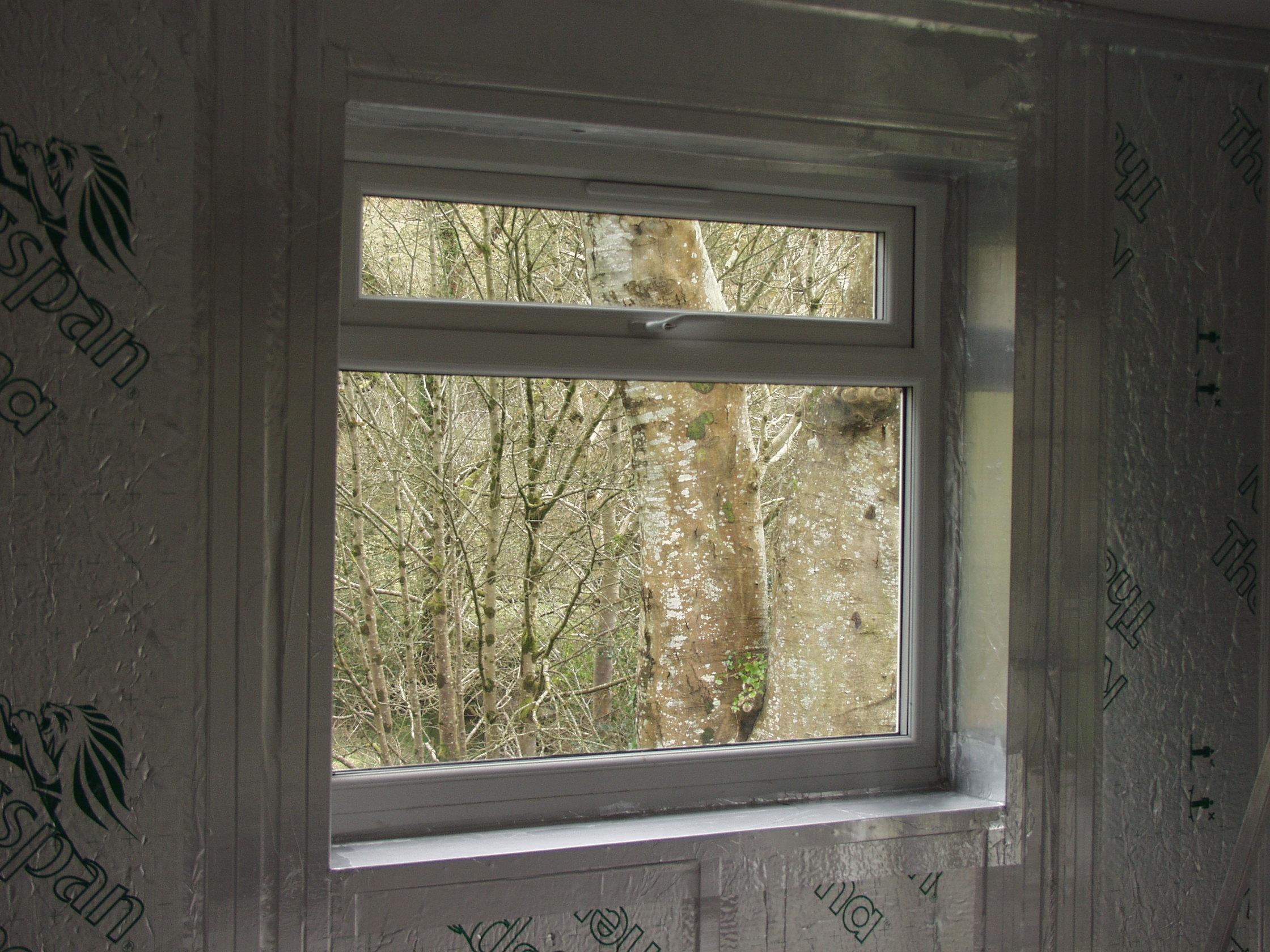

Ok let me try & simplify. Imagine that I haven't lined my window reveals. I pB up to the window reveal edges. This is a hyperthetical situation.
Then, I add the 27mm ins-pB lining to window reveals. So you can see all of the 27mm ins-pB edges.
Ok: can the finishing filling work be carried out ok now, or, is the fact that the 27mm ins-pB edges are visible (& not covered over) mean the finishing work cannot be carried out?
Link to comment
@PeterW ok pic from before here. Window not yet lined.
The W of the reveal, is a very convenient 1200mm. So here I could have happily cracked on, pB'ing above & below the reveal with a full-width board (cutting across/ sticking another section above window).. & the adjacent board L& R will meet at the reveal corner point. Perfect.
But onwards from this pic, I lined the reveal with 27mm ins-pB (top one irrelevant because there's no taper on this lower edge/ my pB comes down & hides the 27mm lining edge).
So the addition of 27mm ins-pB to the L & R reveals, due to the placement of the join-point of the pB -exactly on the timber cornerpoint seen in this pic- means I cannot hide these two added 27mm edges with pB.
Link to comment
