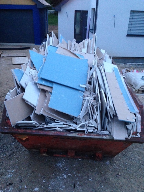

Bitpipe Posted May 23, 2016 Posted May 23, 2016 (edited) So after filling a few skips so far and being told "no plasterboard", the penny only dropped that this might be difficult stuff to get rid of at the plastering stage. We have quite a large house so generated quite a bit of scrap, especially the rooms in roof where there are lots of triangular sections. Turns out that the local skip firm will do a plasterboard only skip but at an increased cost to normal to cover the additional landfill cost. I got a 4.5 yd for £265 inc VAT (Berkshire) and it was just big enough (note to self, always get a skip one size larger than you think you need). Quite tricky to fill it efficiency too, I ended up stacking larger bits up the sides and kept the middle for small bits, which I regularly compacted with a sledge. I did call a few of the industry recycling schemes but they're only geared up for big sites. A few skip companies go by weight but the challenge of keeping a skip of board dry put me off, not paying to dispose of rain water Note that there's no issue in disposing of plaster itself in a normal skip, we've accumulated quite a few bags of scraps and will have quite a few more before we're done. Edited May 23, 2016 by Bitpipe

ProDave Posted May 23, 2016 Posted May 23, 2016 Okay, this is brobably a dumb question, but what is the significance of blue plasterboard? I know about green, pink, and ordinary grey, but what's the blue stuff?
Bitpipe Posted May 23, 2016 Author Posted May 23, 2016 Just now, ProDave said: Okay, this is brobably a dumb question, but what is the significance of blue plasterboard? I know about green, pink, and ordinary grey, but what's the blue stuff? It's the soundblock version, about half as dense again as the normal (35kg a sheet). We have it on ceilings in the basement and ground floor and also used where we had pocket doors as the void obviously can't be stuffed with rockwool. Also enclosed the downstairs loo in it to prevent any awkward situations when entertaining 1
Bitpipe Posted May 23, 2016 Author Posted May 23, 2016 25 minutes ago, Declan52 said: My front garden is full of my of cuts. Tip wouldn't take it so I dug a hole when doing the drains and buried it. About half a large skips worth . We had an old brick soakaway in the back for the old house that would have taken the lot...had we not filled it in a while back. As I understand*, disposal is only an issue in landfill where the high sulphur content in the gypsum reacts with biowaste to form Hydrogen Sulphide gas. *Ok, I googled it...

thomas Posted May 27, 2016 Posted May 27, 2016 Gypsum is used to break down heavy clay soils, if you throw it in the cement mixer with a couple of bricks it'll powder up, then just line the bottom of your skip with it or bag it as sell it :D 1
Jeremy Harris Posted May 28, 2016 Posted May 28, 2016 We had no problem at all with plasterboard in skips. Our skip company (Maidments: http://www.rvmaidment.co.uk/ ) recycle a hell of a lot from every skip load; they empty every skip on the floor of a big warehouse and then sort it and give you back a certificate with all the constituent parts in each load and how much of it was recycled and how much went to landfill. I rang them and said we had a load of plasterboard and did they want to send a second skip for it, to keep it separate. They just asked if I could keep all the plasterboard waste at one end of the skip, separated from the general waste. I got a labourer to make a plasterboard vertical divider in the skip and break up all the plasterboard into small bits and keep it at one end. Worked a treat, we had no extra charge from the skip company and they recycled all the gypsum from that load. I'm not sure what you're supposed to do with all these recycling certificates, no one seems to want to see them, so I've just kept them in a folder.
