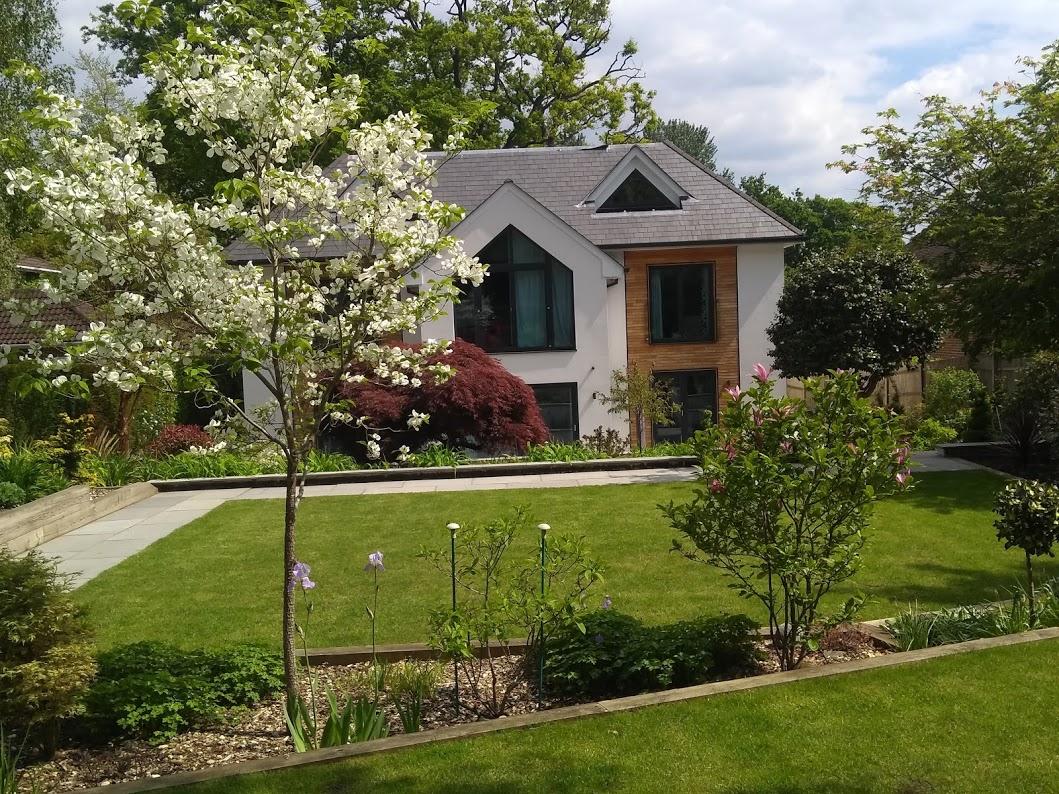

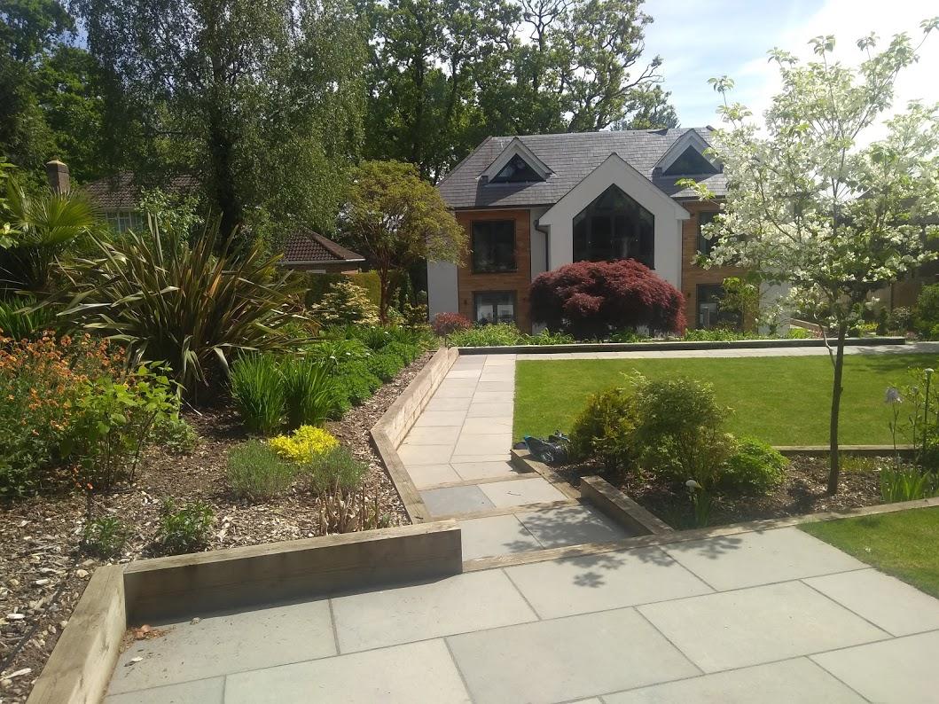

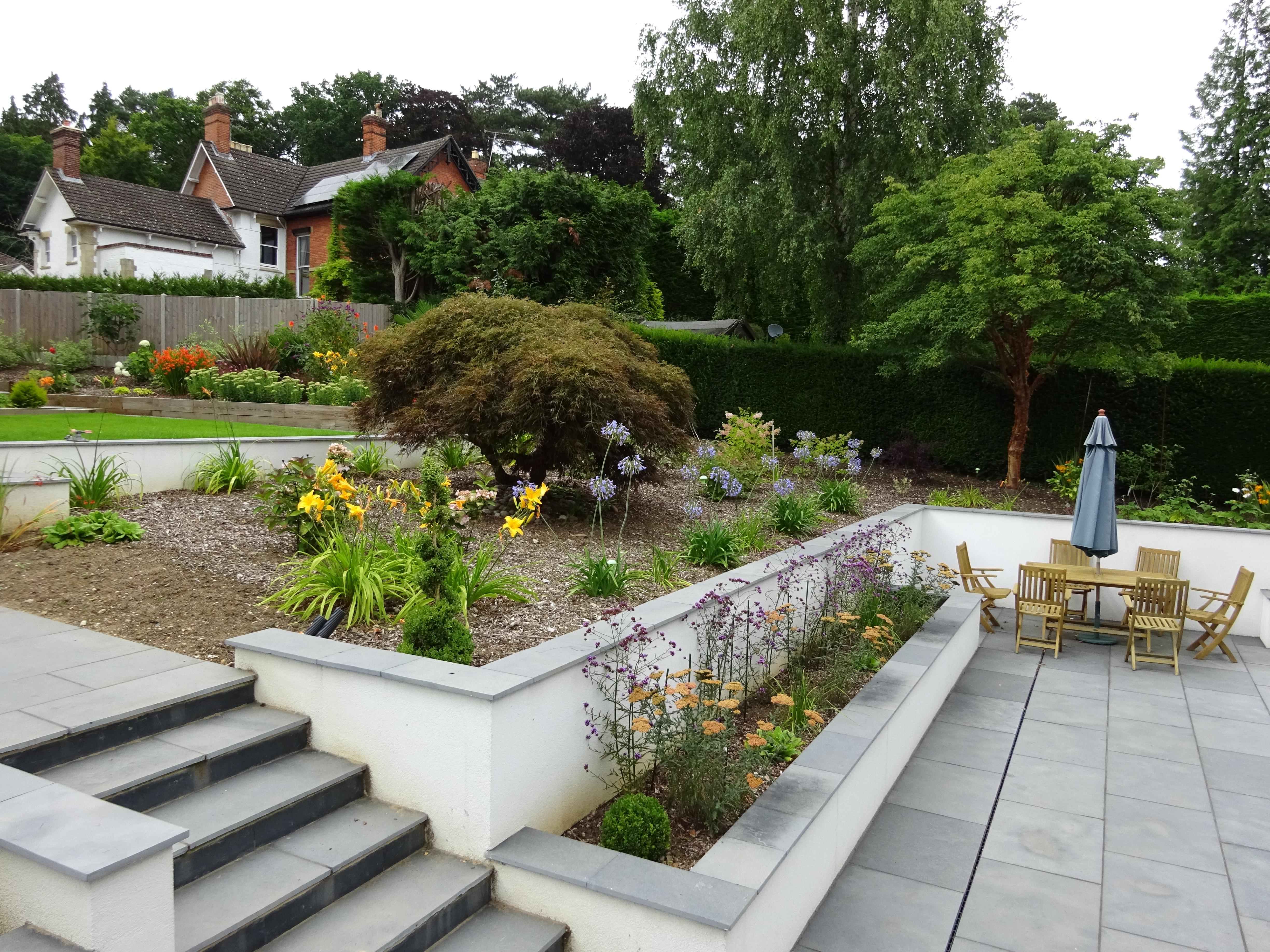

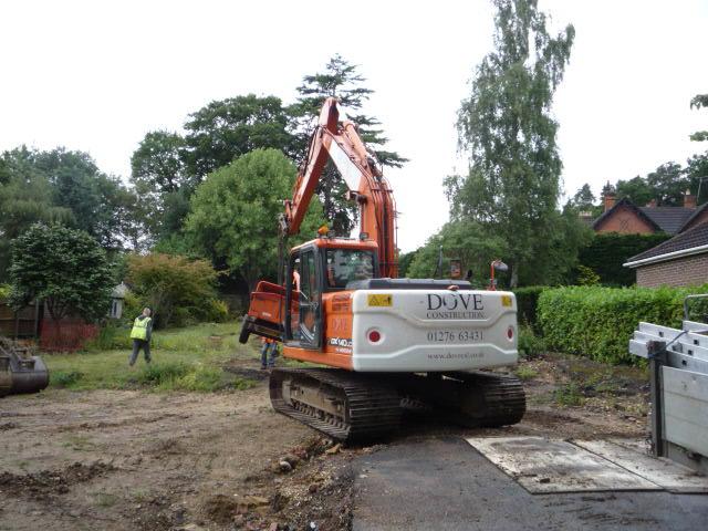

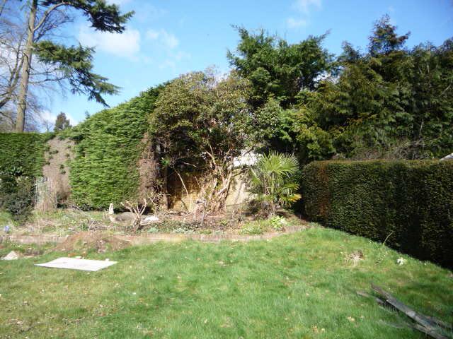

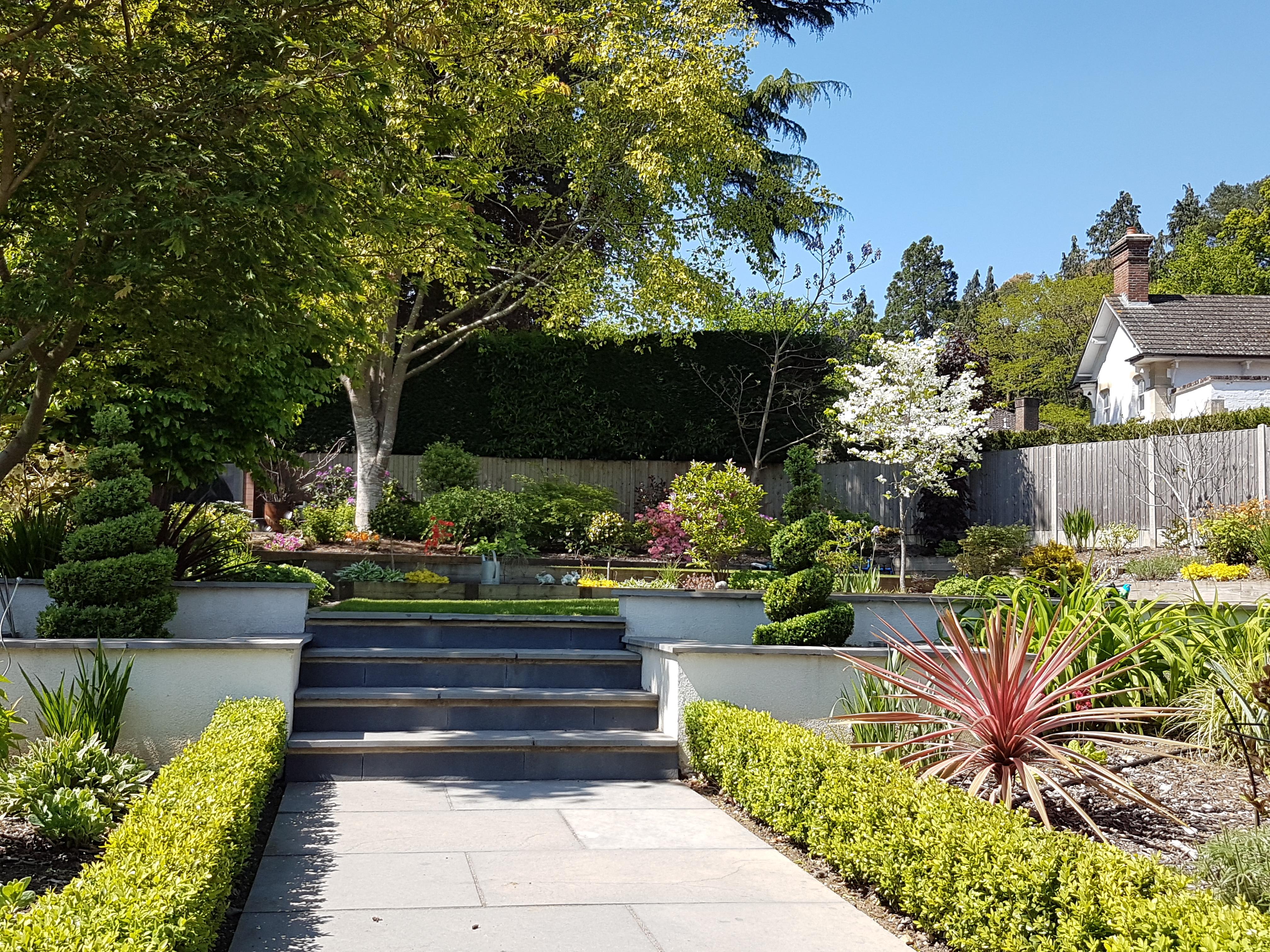

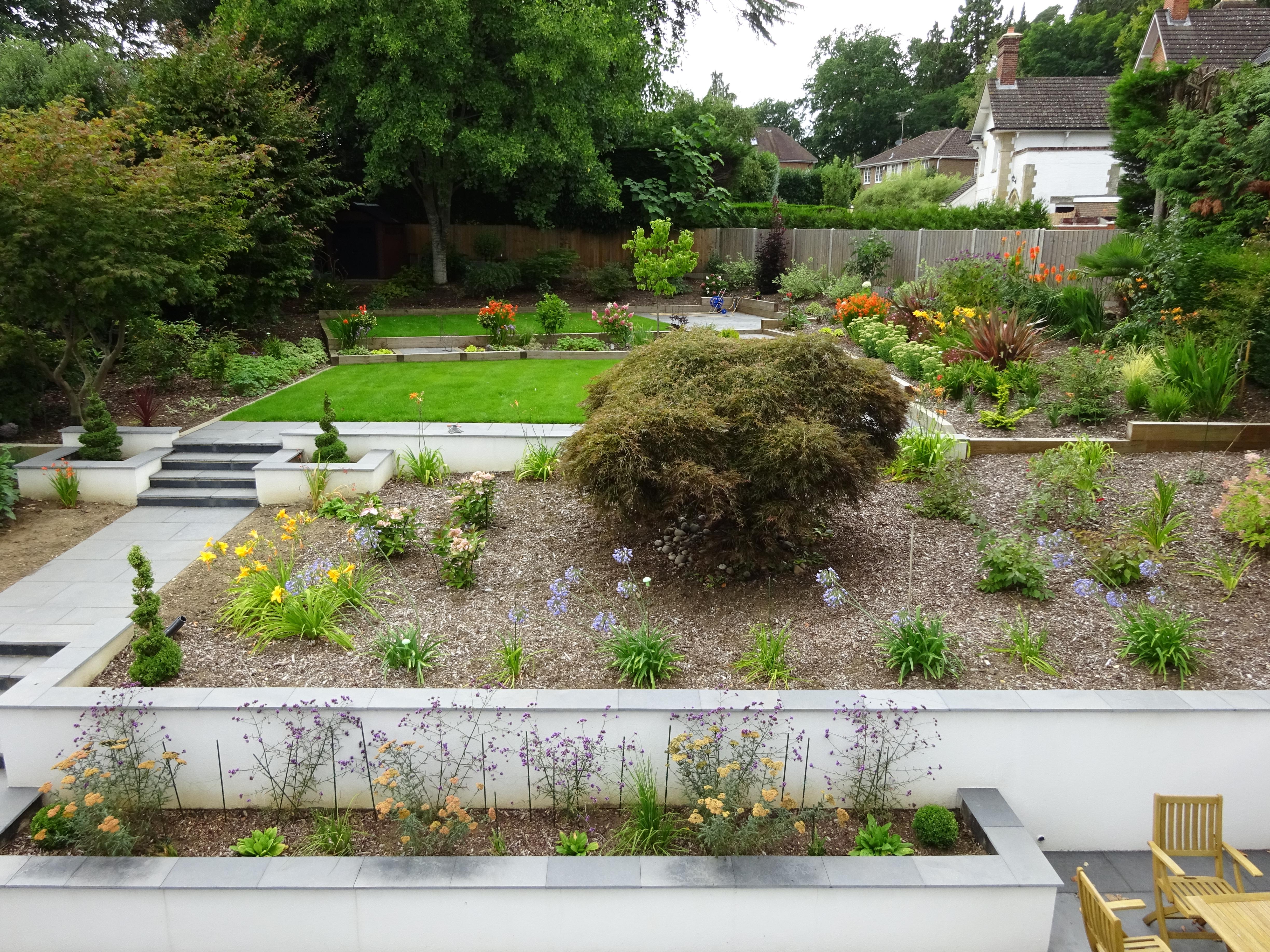

HerbJ Posted May 18, 2020 Share Posted May 18, 2020 (edited) We used a landscape/garden designer for our garden. Our site sloped up from front to back and side to side. We could not envisage a way forward but the landscape designer developed a clear design that we incorporated in the PP and in construction plans. It was expensive but well worth it, as it provided a clear plan for groundworks and landscaping, which allowed us to utilise the heavy construction equipment as part of our ground works contract. Broadly, they gave us a landscaape concept design, incorporating existing trees and shrubs and using the topographic survey daata. . SWMBO did the planting plans and did all the plant (with a little manual help from me) I attach the concept design, some early ground clearance photos and a couple of recent photos. The company we used was PC Landscapes based in Farnham. pclandscapes_Concept_Design_a.pdf Edited May 18, 2020 by HerbJ further info added +typos 2 Link to comment Share on other sites More sharing options...

Gem77 Posted May 18, 2020 Author Share Posted May 18, 2020 25 minutes ago, HerbJ said: We used a landscape/garden designer for our garden. Our site sloped up from front to back and side to side. We could not envisage a way forward but the landscape designer developed a clear design that we incorporated in the PP and in construction plans. It was expensive but well worth it, as it provided a clear plan for groundworks and landscaping, which allowed us to utilise the heavy construction equipment as part of our ground works contract...... pclandscapes_Concept_Design_a.pdf 4.69 MB · 0 do Thanks for sharing this with me, your garden looks lovely ? when you say expensive would you be comfortable giving me a rough idea of the cost for just the design? Link to comment Share on other sites More sharing options...
HerbJ Posted May 18, 2020 Share Posted May 18, 2020 (edited) @PeterW absolutely correct about pricing and how it ramps up if you require all the services, especially in Surrey and Berkshire, where we built.. For our concept design, the total cost was £3,500 (including VAT which could not be claimed back as it was design service). I will admit to being horrified at this but SWMBO was adamant that it would add value to our overall scheme - she was right, as usual.... The proposed costs estimate for the next phases, including detailed design and then supervision of construction (hard landscaping) and planting would have been £ 6 to 10,000 , depending on the cost of the landscaping works - see my post below The photos I attached were last year. The garden is now looking great, especially with the lock down and all the work that SWMBO has been putting into the garden recently Edited May 19, 2020 by HerbJ To correct incorrect cost data 8 Link to comment Share on other sites More sharing options...
