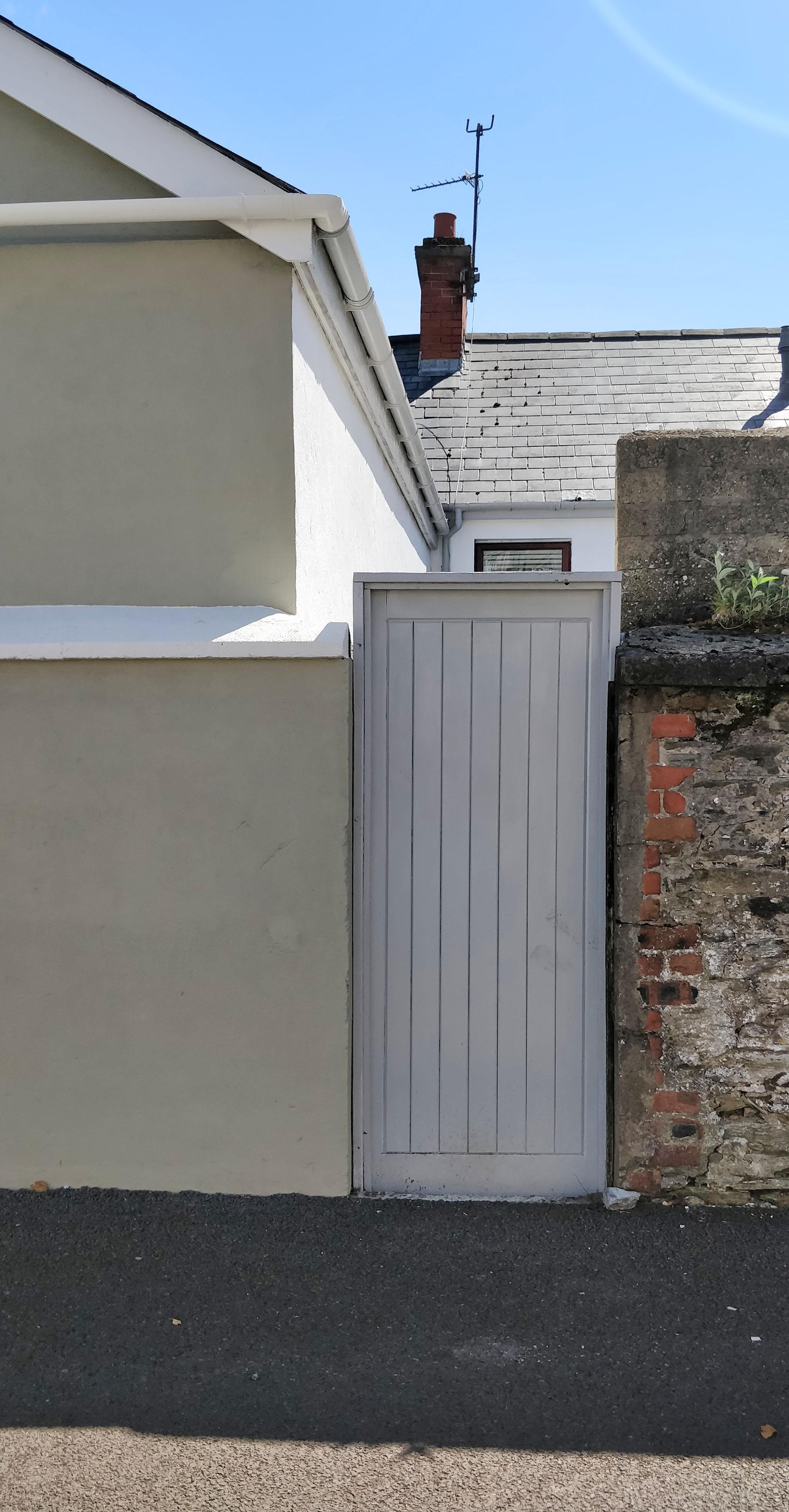

There is no garden - we both have concrete yards which are about 137cm (54") wide with 9 steps up to the back gate.  Beyond planning service and council's. influence, the bottom line for me is the surety that he can't carry out works to my wall without my permission.
Posted
I mentioned the garden as the place to take a photo of the rear of the houses to identify the boundary line. Do you have a photo of the rear from the yard or behind the gate?
Posted
Posted.
Posted
I'm assuming your house is the cream rendered bit. If your land genuinely goes up to your neighbour's gate then no part of your property overhangs his land and you actually own a narrow strip of land underneath the gutters of the extension, but I think you would be wise to take a few measurements and be 100% certain that no part of your extension overhangs his property before you get into a dispute.

Thanks but doesn’t really help much ? Any chance of one with the gate open so we can try and identify the boundary line?

Ha-ha, you asked for it.  One with the gate open would need to be accompanied with the Mission Impossible theme.

Oooh! So the gate is solely access to their property? Didn’t realise and thought there was some kind of shared or dual access to each property. Tbh, the additional photo is probably irrelevant anyway. Just wait and see if they decide to proceed with the works in the future and contact the Council as and when that happens.

I'll mention it the next time I bump into him and ask him to show me exactly what he plans to do (before he engages someone to do plans).  If he says he definitely intends to attach to my wall, I'll have to turn him down as gently as possible.
Posted
41 minutes ago, Gummo said:
It's his.
If its his chimney and his aerial it looks like your gutters and fascia and maybe foundations might be on his side.
Just a thought, but how are you going to proceed if you say no, don't attach to my wall and he then says, ok get your gutters and fascia off my land and btw, you cannot discharge your roof water onto my land either!? So be 100% sure that your extension is on your land only before you start. Either way at some point you'll want to be in his yard to paint your render.

wow, that looks like “you’re “ wall is on his land.?.? Party wall?

If it's his mast on your chimney stack did you give him permission to put it there?

ah, I took that to mean the chimney and mast were his??? Which? Both?

His chimney and mast.

Others say that the centre-line of the chimney is the boundary.

The water from his gutter runs onto mine and is released via the downspout on the other side of my extension.  The only indicator of the boundary-line, according to some people, is that it's the centre-lineof the chimney.
Posted
IMO, if it’s his chimney, the chimney breast will be in his rooms, party wall will be roughly 9” brickwork so boundary is 4 1/2 “ from your side of chimney line!!!!, anyway I would not be happy with fixings in my wall which could lead to damp issues.
