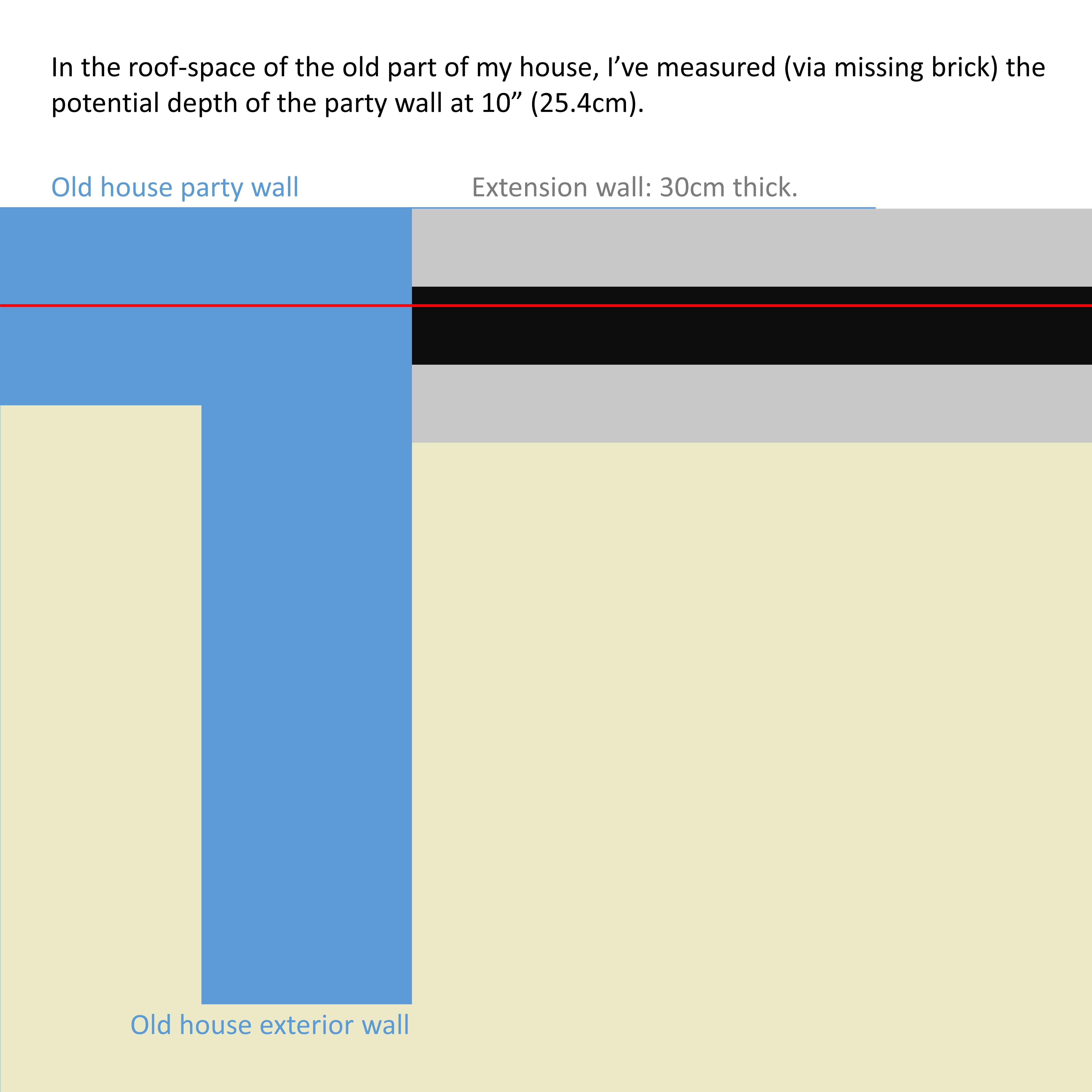

  7. The extension, built in 1981, runs along the line of the old scullery that was there beforehand. You may infer from the attached diagram that the old scullery's exterior probably aligned with the furthermost line of the party wall.

  9. The chimney is his (my fireplaces are on the other side). It's looking very much like it's a party wall after all. ?
  10. So, using that logic, it is almost certainly a party wall. If so, how do I have the right to stop such fixings?
  11. The water from his gutter runs onto mine and is released via the downspout on the other side of my extension. The only indicator of the boundary-line, according to some people, is that it's the centre-lineof the chimney.
  12. Others say that the centre-line of the chimney is the boundary.

  16. There is no garden - we both have concrete yards which are about 137cm (54") wide with 9 steps up to the back gate. Beyond planning service and council's. influence, the bottom line for me is the surety that he can't carry out works to my wall without my permission.
  17. I'm sincerely indebted to all the sound advice if received and I'm going to need all of it. The only loose end is that there are some differences of opinion im establishing the boundary line and it's consequences for whether my wall is a party wall.

  22. On the inside of the house, the extension is 55mm nearer to me.
