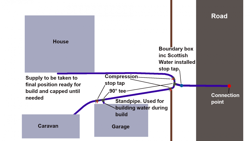

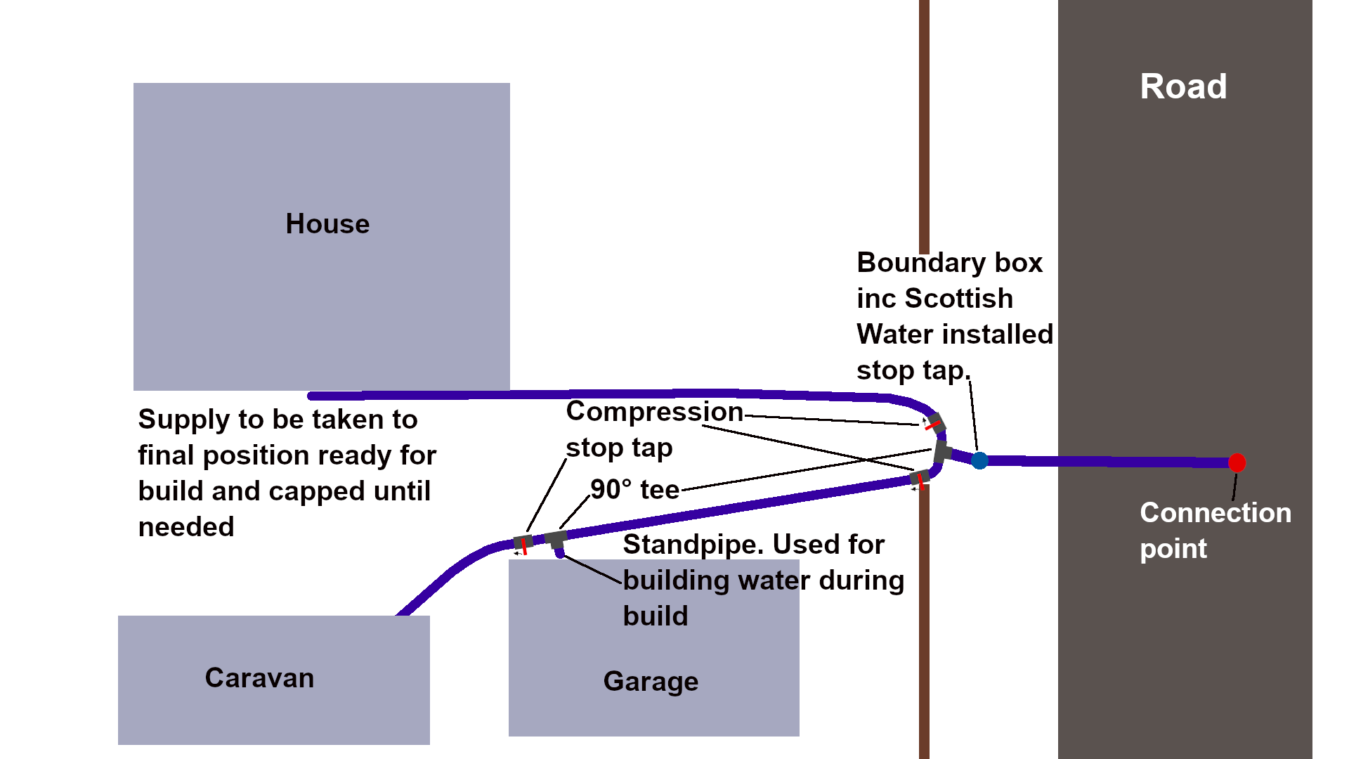

djcdan Posted May 5, 2020 Share Posted May 5, 2020 Apologies if this is not the correct area of the forums. Please move if needed. I am planning to self-install our water connection beyond the boundary after Scottish Water has installed our new connection to a stopcock on boundary edge. Before I purchase materials for the job, I'd like to delve in to the knowledge/experience of members here to make sure I have everything covered and the layout of the connection is suitable. Site We will have a supply for the house (yet to start), garage (which will double as the point for building water supply) and temporary caravan. In the future, we may run this part of the water connection beyond the caravan where we plan to have a greenhouse. Layout Scottish Water have confirmed they will install up to a stopcock on the boundary border, which is to be enclosed within a boundary box. As you'll see on the drawing, beyond this, I have the supply splitting with a 90° tee and each line with it's own stop tap. I'll aim to have all three stop taps (x1 SW installed and x2 self-installed) accessible from the boundary. The north line will go towards the finished position at the house, capped and waiting for the build to start. The stop tap will be shut off until supply is integrated to build and needed. The south line will serve the garage (long term as garden tap, short term as building water) as well as temporary static caravan. Just beneath the standpipe, there would be a 90° tee taking the supply to the standpipe. Beyond the stand pipe would be a stop tap to control supply to the caravan. Material list Before purchasing materials, have I got everything covered below: MDPE 25mm blue pipe (enough length as required) x3 Compression stop taps x1 Stop tap chamber (boundary box) x2 90° tees x1 Underground water main warning tape x1 25mm pipe cap x1 Stand pipe (non-return valve and compression inlet) Is the layout are materials list suitable for what is required of the job. Due to current circumstances, local merchants aren't open so would prefer to correctly order everything is one go. Thanks in advance! Link to comment Share on other sites More sharing options...
PeterW Posted May 5, 2020 Share Posted May 5, 2020 Turn the main tee round and send the spur off to the garage leg. Run a straight run to the house, no breaks and no restrictions. Water pressure drops when you put Tee's in the way you have at the boundary. I'd also only put a stop tap at the house where it is accessible, and not the underground ones you have shown. 2 Link to comment Share on other sites More sharing options...
Russell griffiths Posted May 5, 2020 Share Posted May 5, 2020 Yep as peter said. 1 Link to comment Share on other sites More sharing options...
djcdan Posted May 5, 2020 Author Share Posted May 5, 2020 @PeterW Thanks. I'll do that. Other than that, everything looks ok, and the materials list shown will complete the job? Link to comment Share on other sites More sharing options...
Mr Punter Posted May 5, 2020 Share Posted May 5, 2020 Make sure you get pipe inserts for the fittings. 1 Link to comment Share on other sites More sharing options...
Dave Jones Posted May 5, 2020 Share Posted May 5, 2020 if it was me, id run it all in 32mm from the meter. For a little increase in cost the flow losses are as small as you can make them. 1 Link to comment Share on other sites More sharing options...
djcdan Posted May 6, 2020 Author Share Posted May 6, 2020 @Mr Punter Thanks. That has been added. I came across an inspection chamber offered by jdpipes.co.uk advertised as a boundary box for those in Scottish Water areas - https://store.jdpipes.co.uk/scottish-water-boundary-box-meter-chamber/ Has anyone used this or am I best just using a standard stop tap chamber with stop tap and non-return valve installed within? I also noticed in the connection guide provided by SW that during their inspection, they would need to see the double check value (non-return valve) and drain valve installed. What is the drain valve? Link to comment Share on other sites More sharing options...
Russell griffiths Posted May 6, 2020 Share Posted May 6, 2020 I don’t know how much room you have, but I have a concrete inspection chamber 600x 450 with all my bits in, I like that I can lift the lid and actually get both arms in with spanner’s if I ever need to change a tap or non return valve. It has a normal metal lid just like a manhole cover. Link to comment Share on other sites More sharing options...

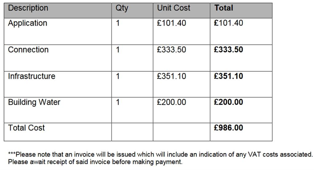

djcdan Posted May 26, 2020 Author Share Posted May 26, 2020 @Simplysimon My quote from Scottish Water for the connection is roughly the same. The works in your quote box relate to the opening of the road, resurfacing and the laying of the tar access. It'd be great if someone who has had similar road works and tarred access laid could confirm if this is the sort of quote I should be expecting? Link to comment Share on other sites More sharing options...
