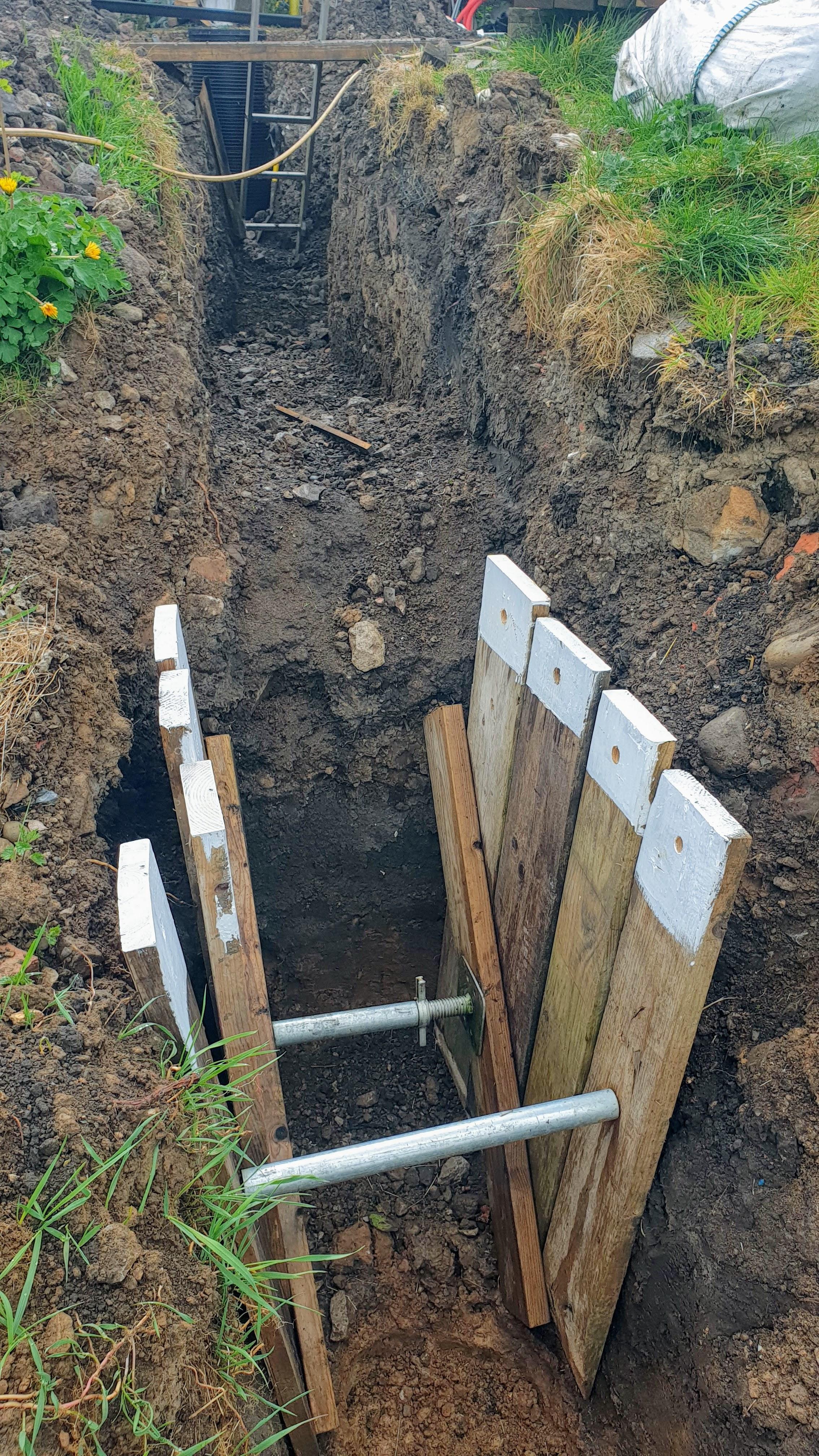

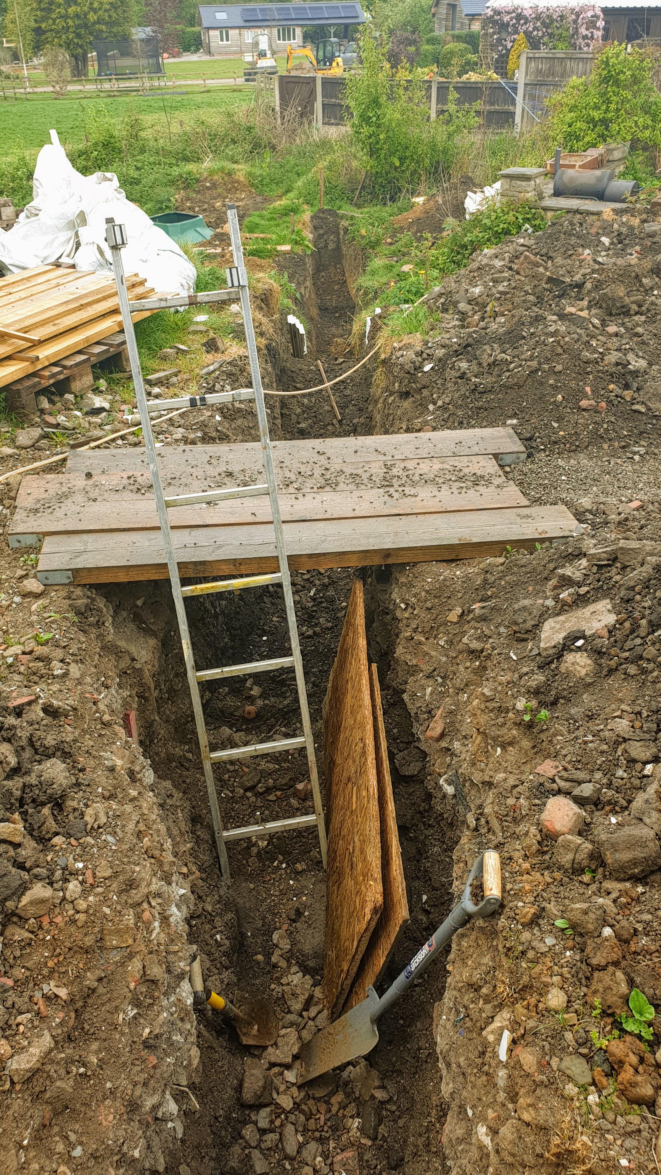

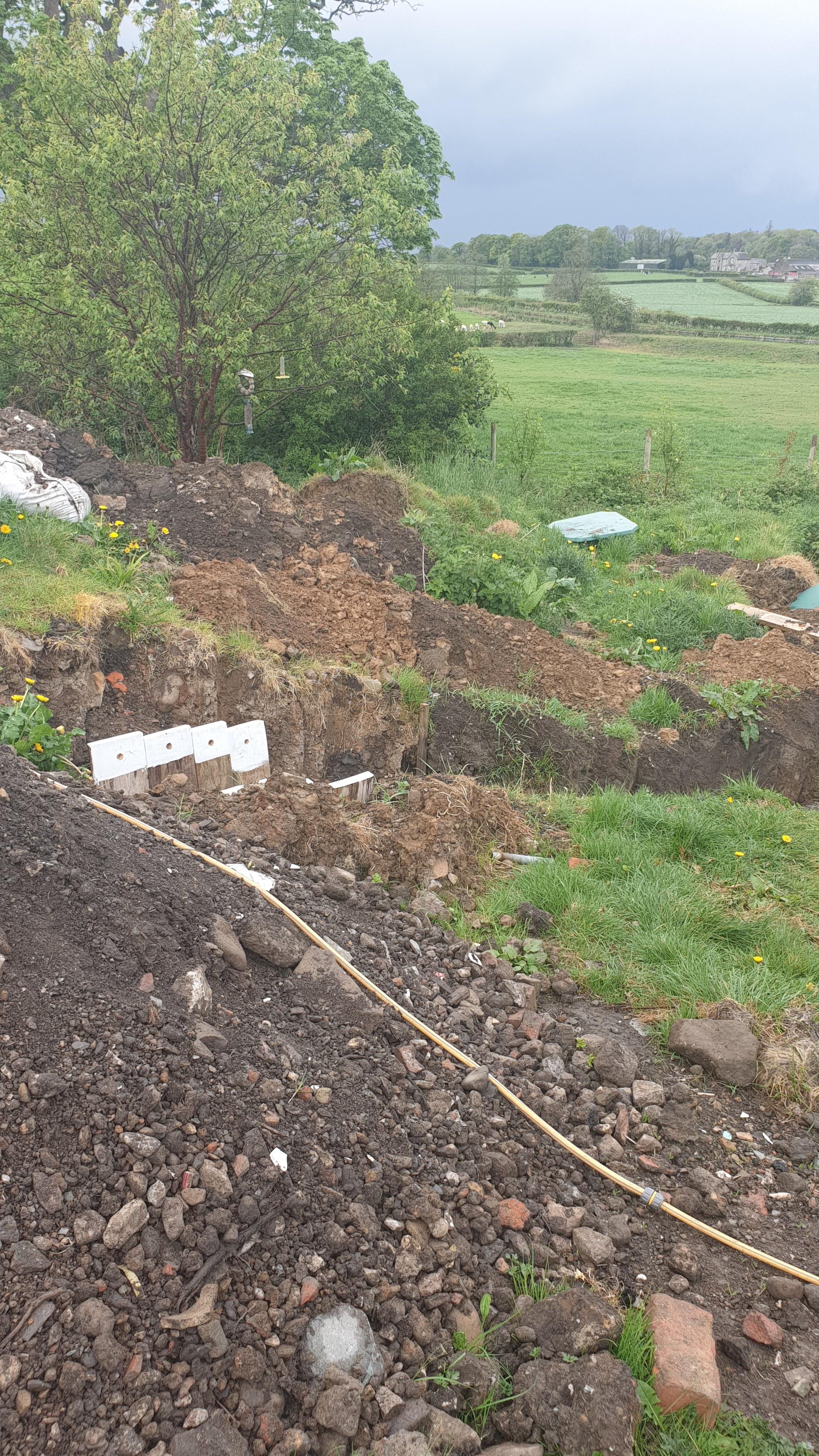

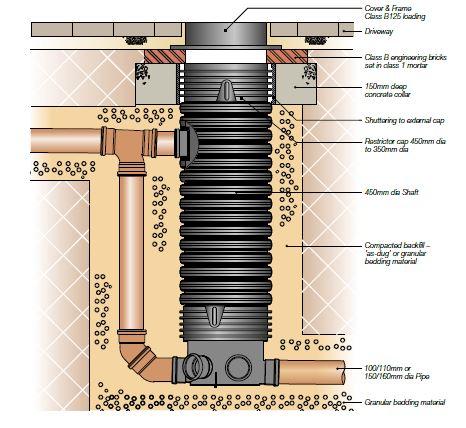

ToughButterCup Posted May 5, 2020 Share Posted May 5, 2020 I wish I could sort this problem out with one of Billy Connelly's Jobbie Wheechas: but "ah caanee, hen." (tr. from the Scottish : I couldn't possibly do that, dwaahling). Look at this. The flow is from the I/C at the back towards the viewer standing next to the 'top-of-the-drop' - the white topped shuttering. From there it goes .... off down to the digester ( green thing at the back) - about 8 meters. The drop's not far off 2 meters, from top invert to bottom invert. The banking in which it sits is no more than 40 degrees Backdrop? OR 45 degree Helter Skelter as @epsilonGreedy would put it? Link to comment Share on other sites More sharing options...
PeterW Posted May 5, 2020 Share Posted May 5, 2020 Hmmm where did you find that picture as a backdrop really should use a rest bend !! 2m drop over 8m is a 1:25 slope - that isn't too unreasonable although i can't see the entry point into the treatment plant..? does it change direction to get into the tank itself as that will be your "slowest" point in the flow. Link to comment Share on other sites More sharing options...
ToughButterCup Posted May 5, 2020 Author Share Posted May 5, 2020 Where did I find it? Wavin brochure! Thing is , the main drop ( 2meters vertical) occurs over about 2 meters horizontally ... maybe a bit more. Which is 1:1 innit? Backdrop with a rest bend? Link to comment Share on other sites More sharing options...
Jeremy Harris Posted May 5, 2020 Share Posted May 5, 2020 I thought that backdrops were now a thing of the past, and that they were no longer needed in Part H, as some further research had shown that there is no maximum slope for a foul drain? I'd be inclined to just run a run of pipe down to the treatment plant, unless there's a good reason not too, like having to dig a really deep trench in places. Got to be less hassle having just a straight pipe run, I'd have thought. Our's drops pretty steeply, about 1.5m over a distance of around 15m, and just goes straight in the side of the treatment plant. Link to comment Share on other sites More sharing options...
ProDave Posted May 5, 2020 Share Posted May 5, 2020 The "issue" appears to be you have already dug the step for a backdrop. So the problem now is filling it back in again and compacting it all if you go for the steep slope method. The time to have asked the question would have been before digging that deep (sorry) Link to comment Share on other sites More sharing options...
Mr Punter Posted May 5, 2020 Share Posted May 5, 2020 I would just use a couple of 30 or 45 degrees and pipe between. Link to comment Share on other sites More sharing options...

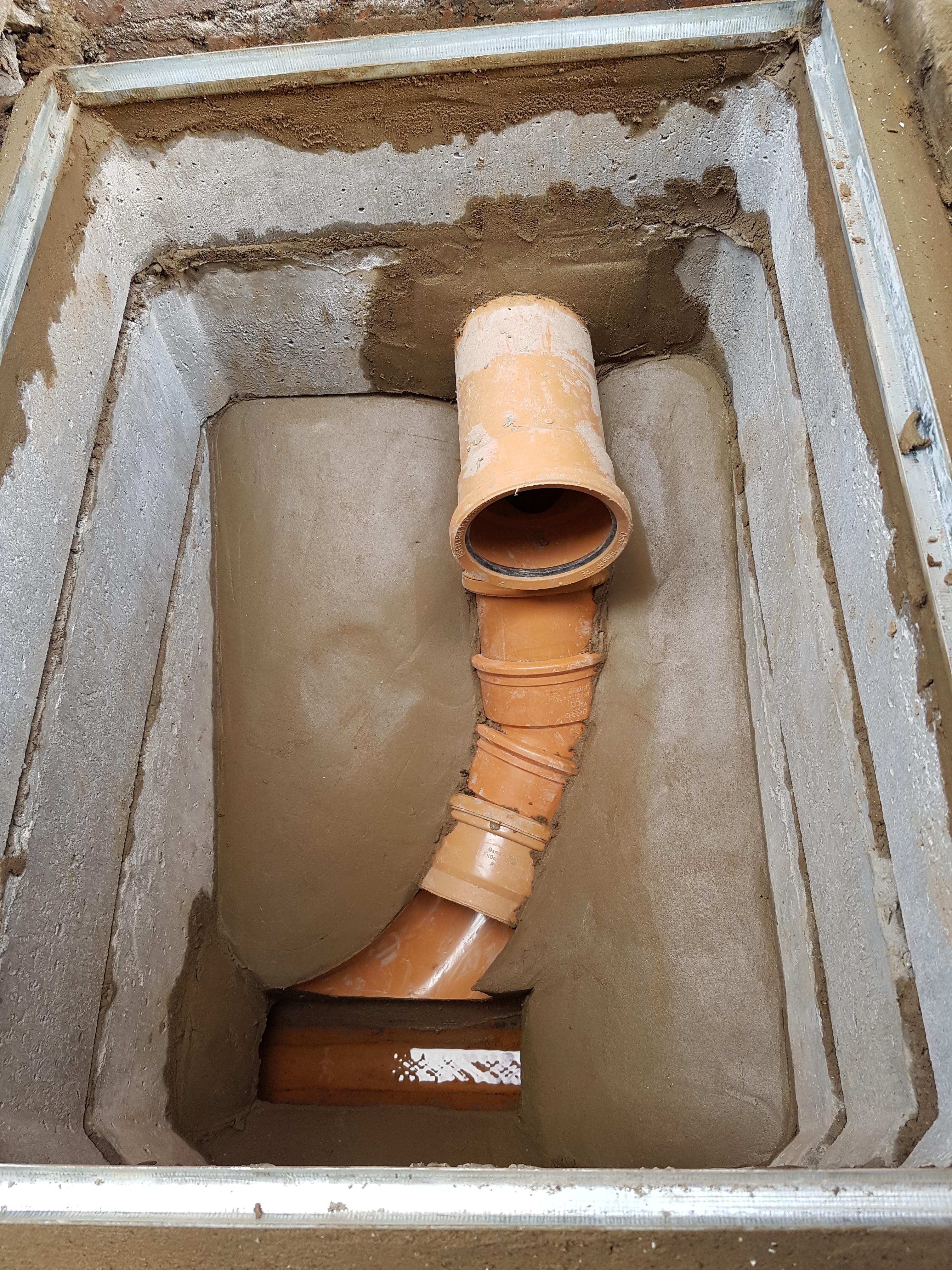

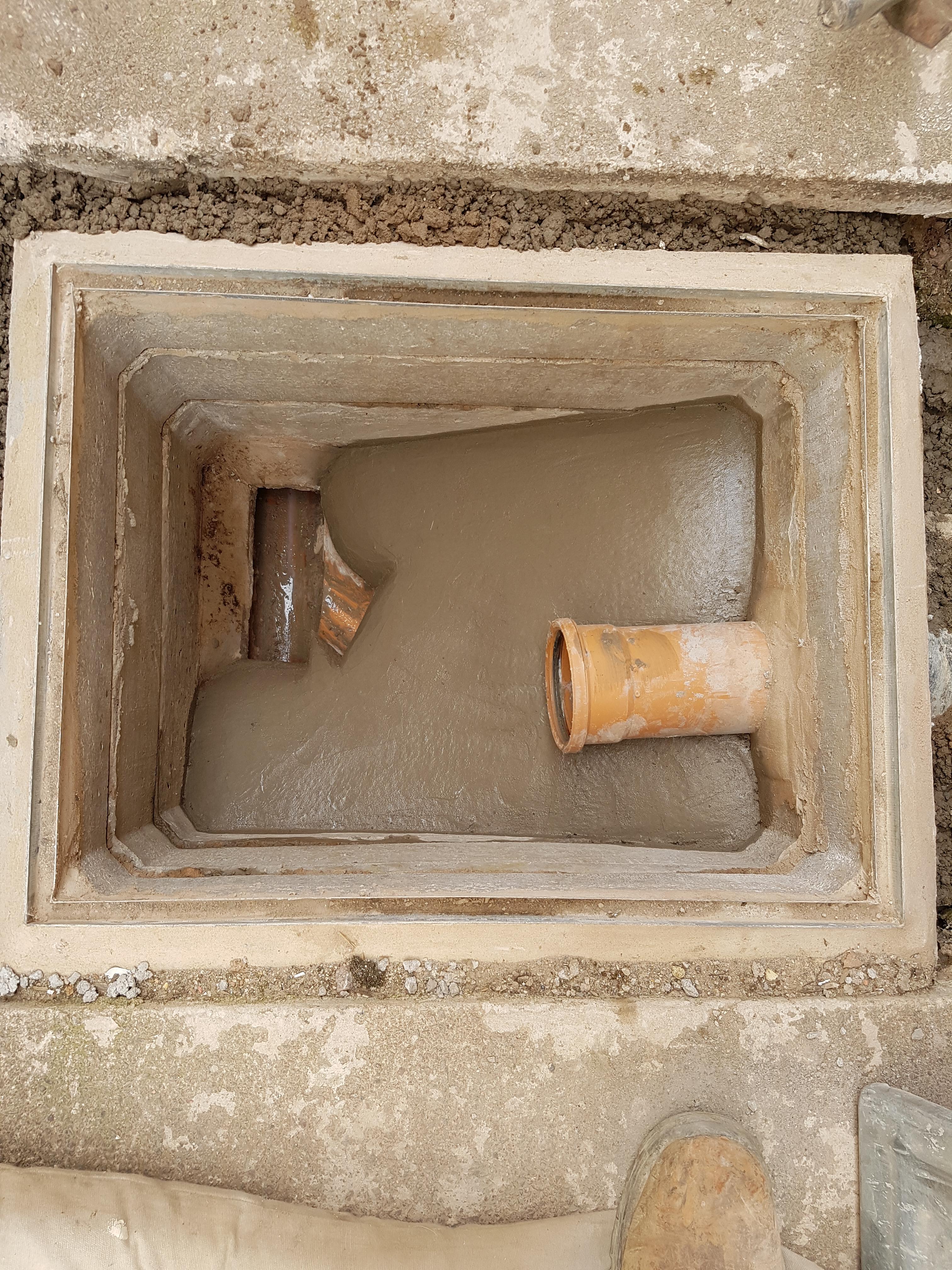

Oz07 Posted May 5, 2020 Share Posted May 5, 2020 Stepped invert backdrop for inspiration. Not perfect but has done the job for 18 months without issue. No rest bend just couple of 45s. Was a storm on same level hence stepped invert 2 1 Link to comment Share on other sites More sharing options...
Mr Punter Posted May 5, 2020 Share Posted May 5, 2020 Nice neat benching. 1 Link to comment Share on other sites More sharing options...

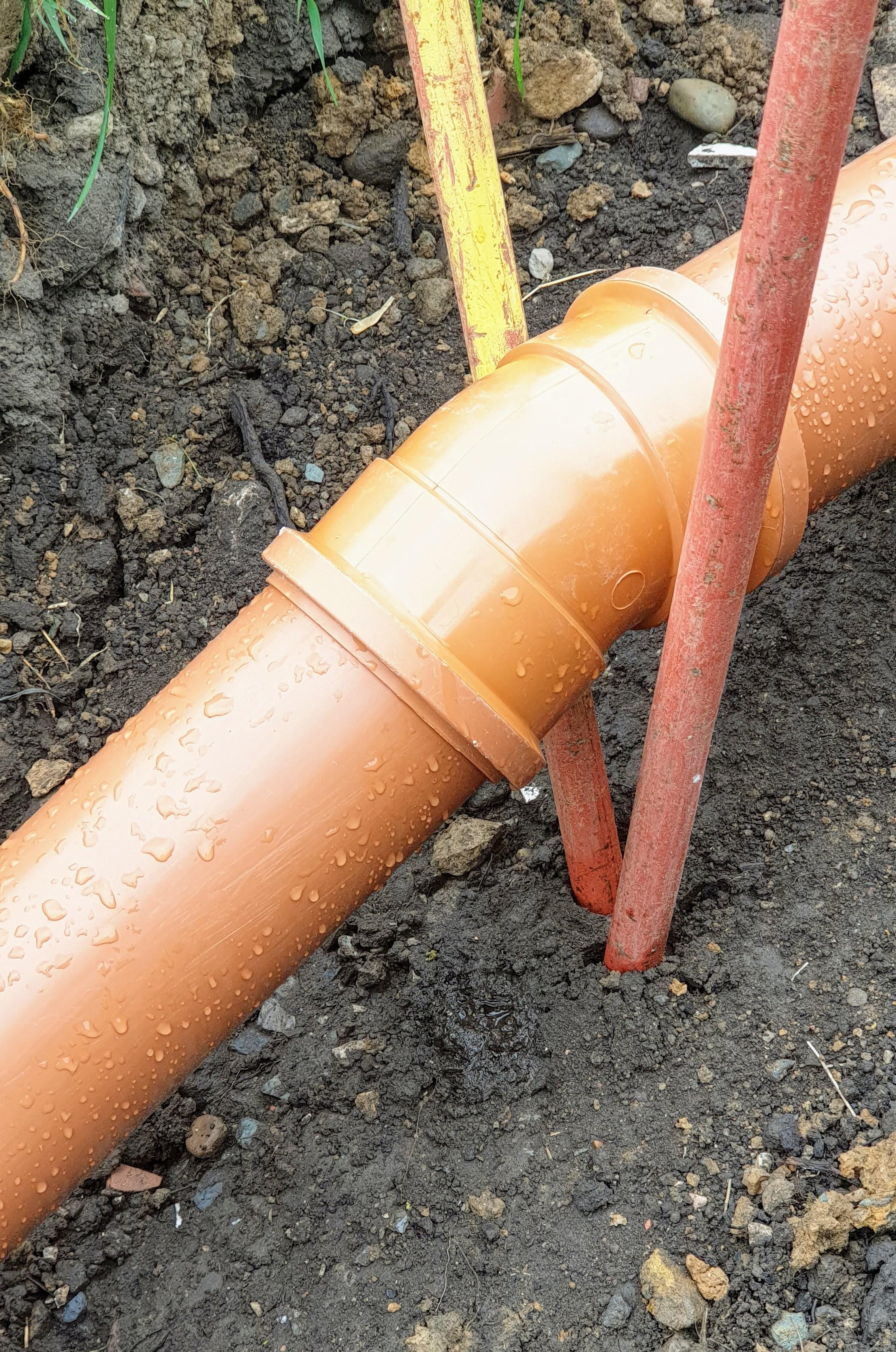

ToughButterCup Posted May 19, 2020 Author Share Posted May 19, 2020 On 06/05/2020 at 17:11, Russell griffiths said: Just concerned with the trench bottom settling and ending up with a dip in the pipe, I know it’s flowing down hill so it’s never going to sit there. Oh dear, the sainted @Russell griffiths is right, too right for comfort. And so's @PeterW. I suppose I should be grateful, - really hard to write that word in present company...... It piddled down here last night. Look at this Look at the ground, just above the pipe on the left hand edge of the photo. The big crack in the backfill (not the best photo). It's just as if the ground sighed with relief at the rain, and sank 10mm or so - bit more maybe. So, a la Russel Griffiths advice, I'm going to wait another fortnight before I doing anything to that pipe trench (backfill with pipe bedding) - to let it settle some more and a la Peter W's advice, later still, I'll need to bed that 30 degree bend in a concrete boot won't I? 1 Link to comment Share on other sites More sharing options...
