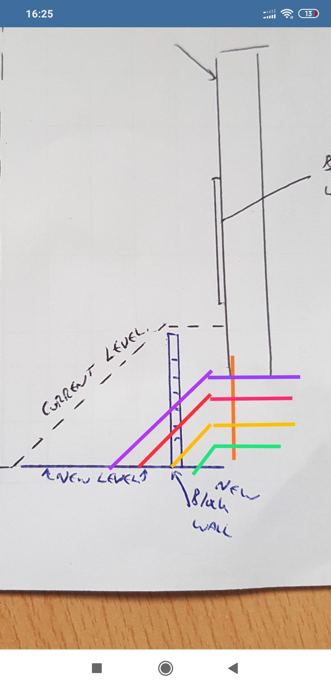

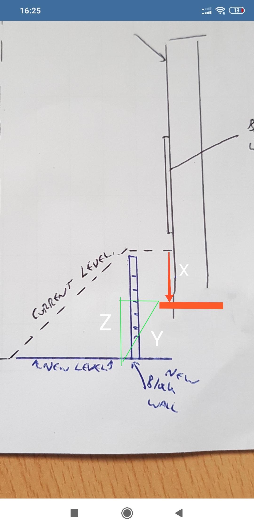

Margaret dailey Posted April 26, 2020 Author Share Posted April 26, 2020 if that really is the case, then ill have to abandon the whole thing. i was trying to understand the procedure of using the imaginary line to work out how far we can go back but im still having trouble understanding how to do that Link to comment Share on other sites More sharing options...

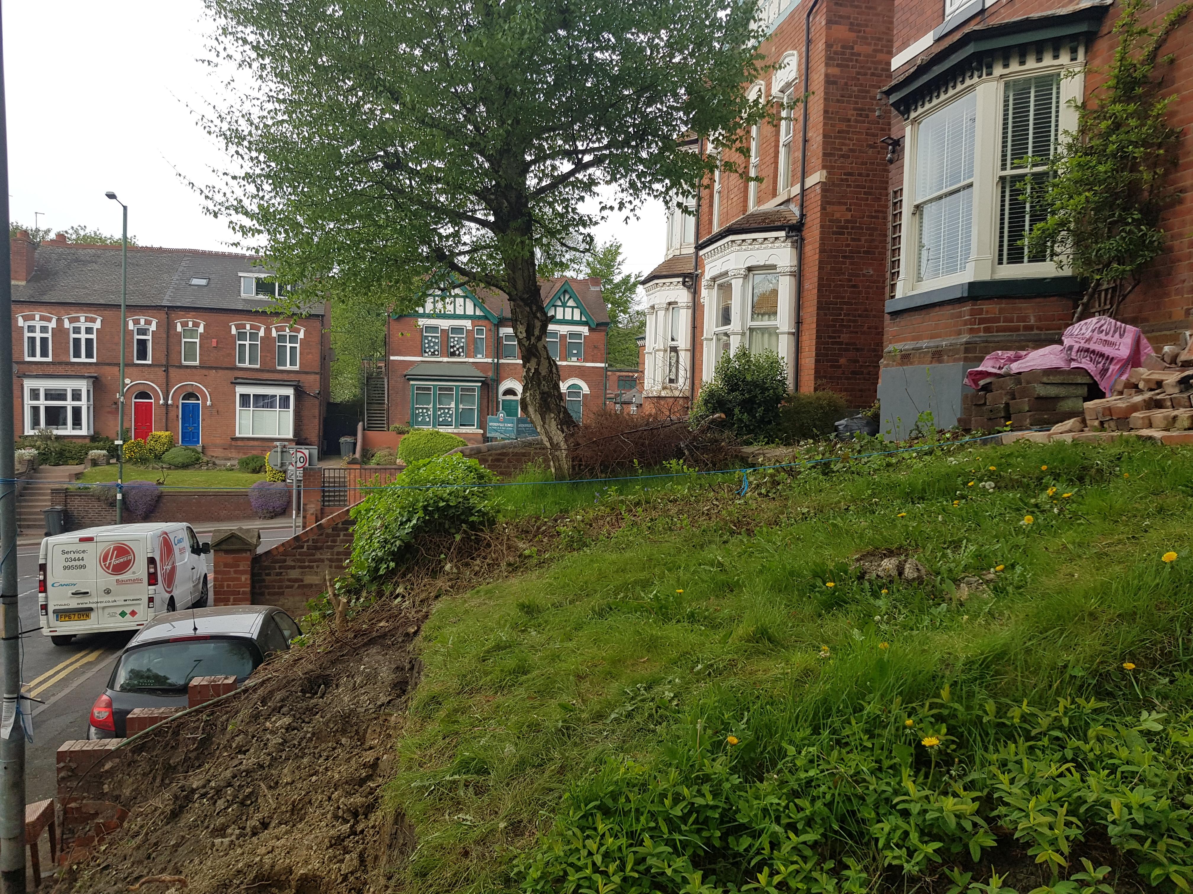

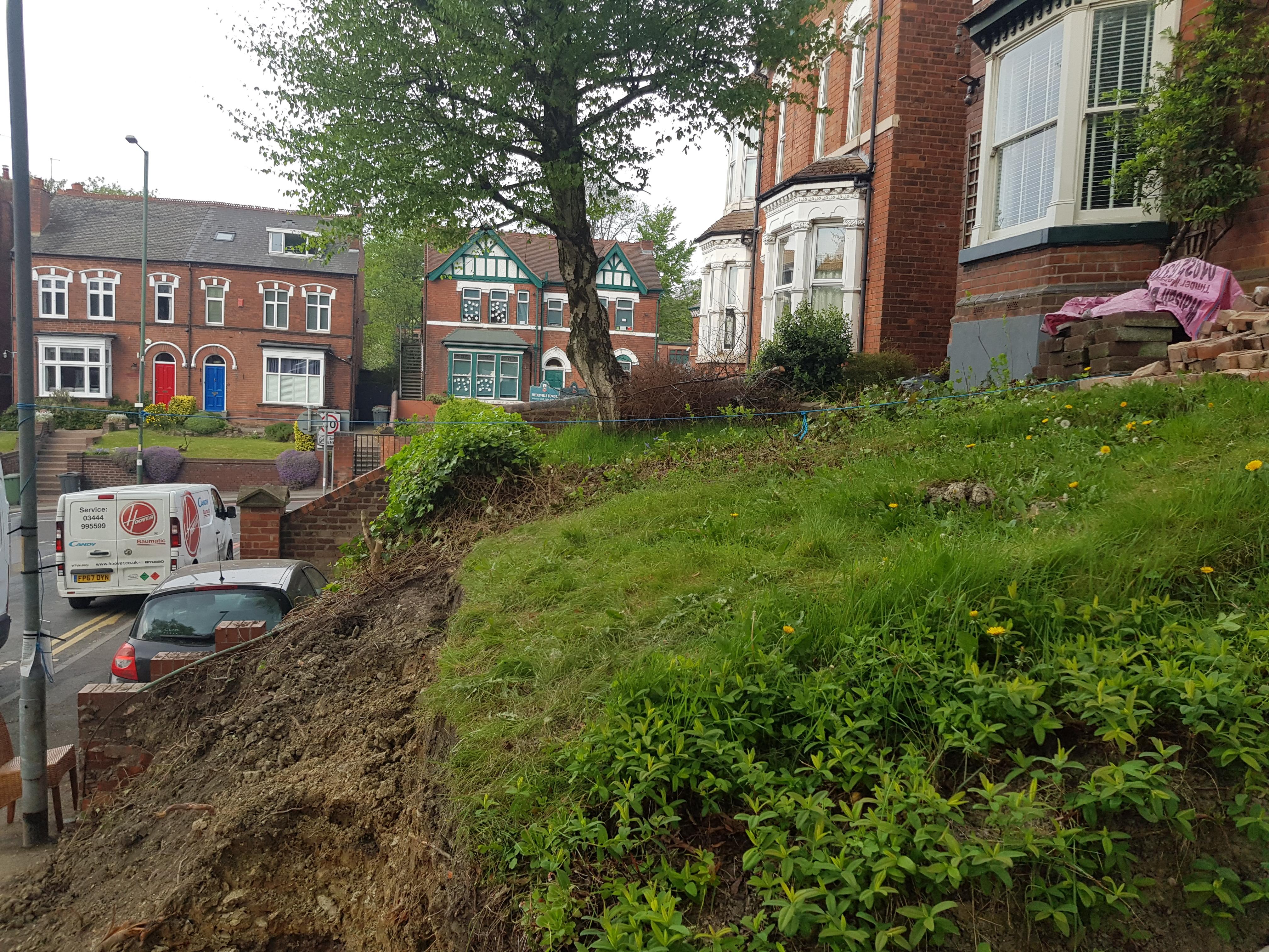

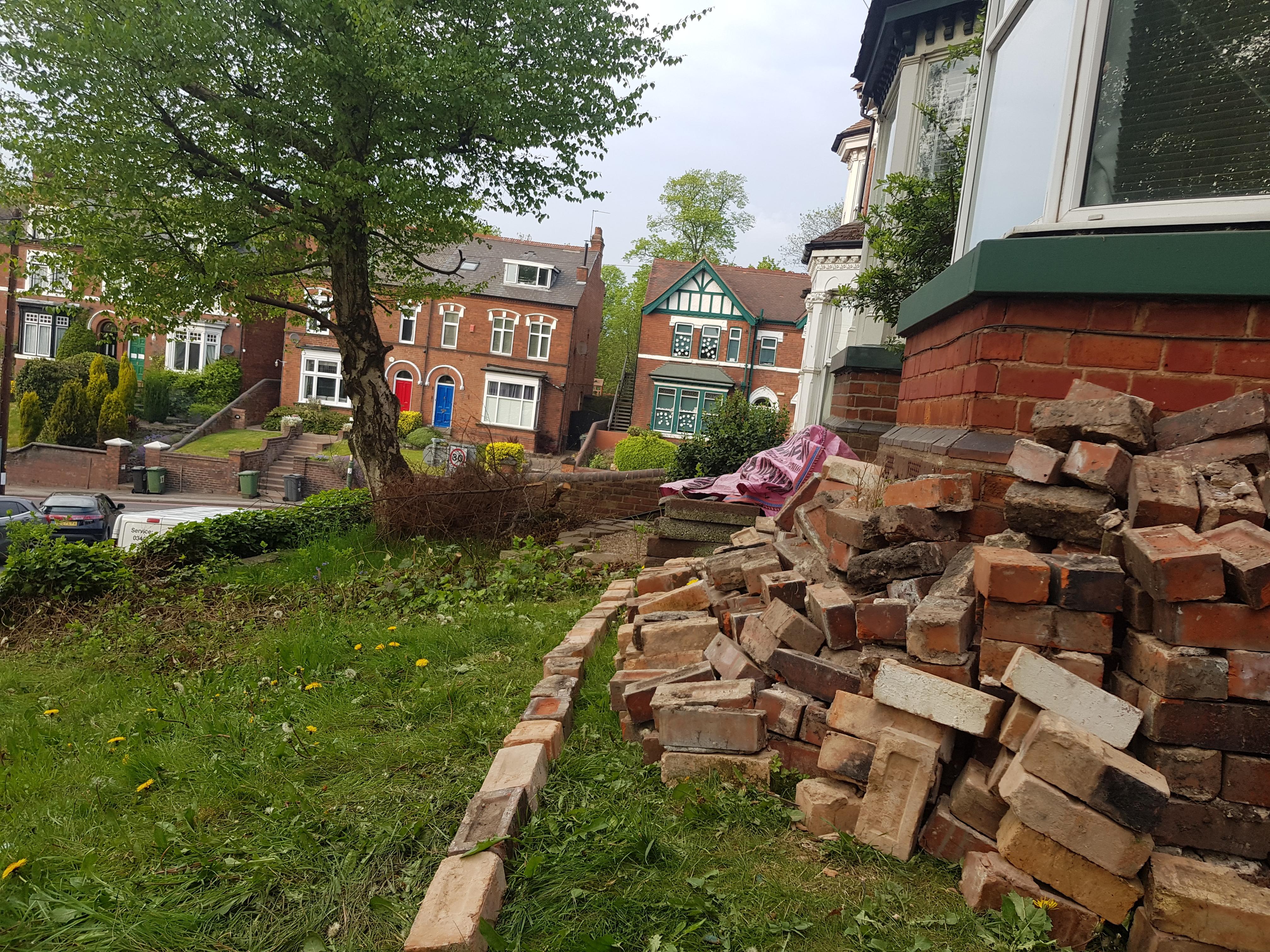

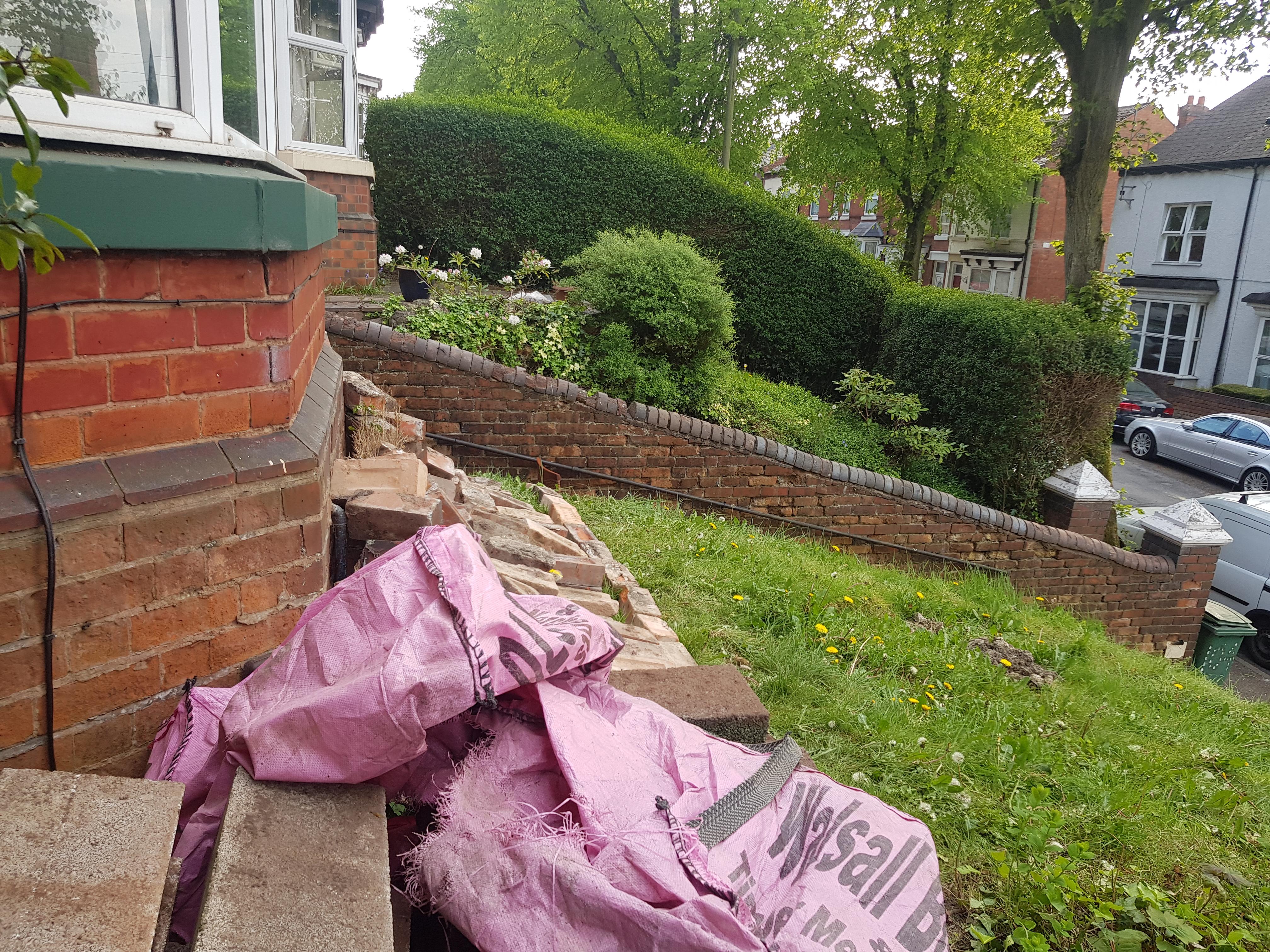

Margaret dailey Posted April 26, 2020 Author Share Posted April 26, 2020 i think the reason i am having difficulty in understanding the 45 degrees rule is i think because the drawings illustrate the level of the land needed to be dug out is straight not slopped but if you look at the pcis of the front of house, you can see the current level is sloped. so dont know if that clears anything up Link to comment Share on other sites More sharing options...

Declan52 Posted April 26, 2020 Share Posted April 26, 2020 The 45 degree explanation is the safe option. So dig down at the front of your house frontage and keep going till you hit concrete. Will take an HR or 2 but then you will know the depth the concrete is at. Once you know that then you can make a judgement call on the rest. If the concrete is deep enough and you won't be within the 45 degree line then great. Otherwise your risking the front of the house sliding and that's not where you want to be. Thats where a SE will earn their money. Keeping your house where it's meant to be. Have you considered a slight slope as in maybe up to 25/30 degrees to park on. Will mean not as much soil needs removed and should get you closer to the front before you cross that 45 degree line. But the important bit to find out is the depth of your house concrete. So don't remove anymore soil until this is found and then it's a decision on of you can proceed safely or not without involving a SE. Link to comment Share on other sites More sharing options...

Declan52 Posted April 26, 2020 Share Posted April 26, 2020 18 minutes ago, Margaret dailey said: Declan52, thanks for your advise, im not stable on my feet so i cant have any slope at all. so it needs to be flat ground which i park on. in regards to digging at the front of the house, once we reach the concrete, how will we know if the concrete is deep enough? You will have a measurement of X cm to your concrete. Then it's a bit of maths to work out a Y cm of the 45 degree angle and where it will come into contact with your flat driveway. You will already know the difference in height from your path at the front of the house and the path on the road. So you will subtract X from this measurement to give you Z. But the most crucial thing to find out is this concrete depth. Everything rests on this. See how much a difference this makes on this pic. You want it as deep as possible. Link to comment Share on other sites More sharing options...

epsilonGreedy Posted April 26, 2020 Share Posted April 26, 2020 1 hour ago, Margaret dailey said: if that really is the case, then ill have to abandon the whole thing. One of your later photos shows an already sharp incline from pavement upto the base of your house, so you need to move ahead cautiously. You say you cannot afford a SE so I assume you cannot afford the £50k plus costs of structural fixes to your house and also the neighbours if both houses start to slip & crack a little towards the new carport hole. 1 Link to comment Share on other sites More sharing options...

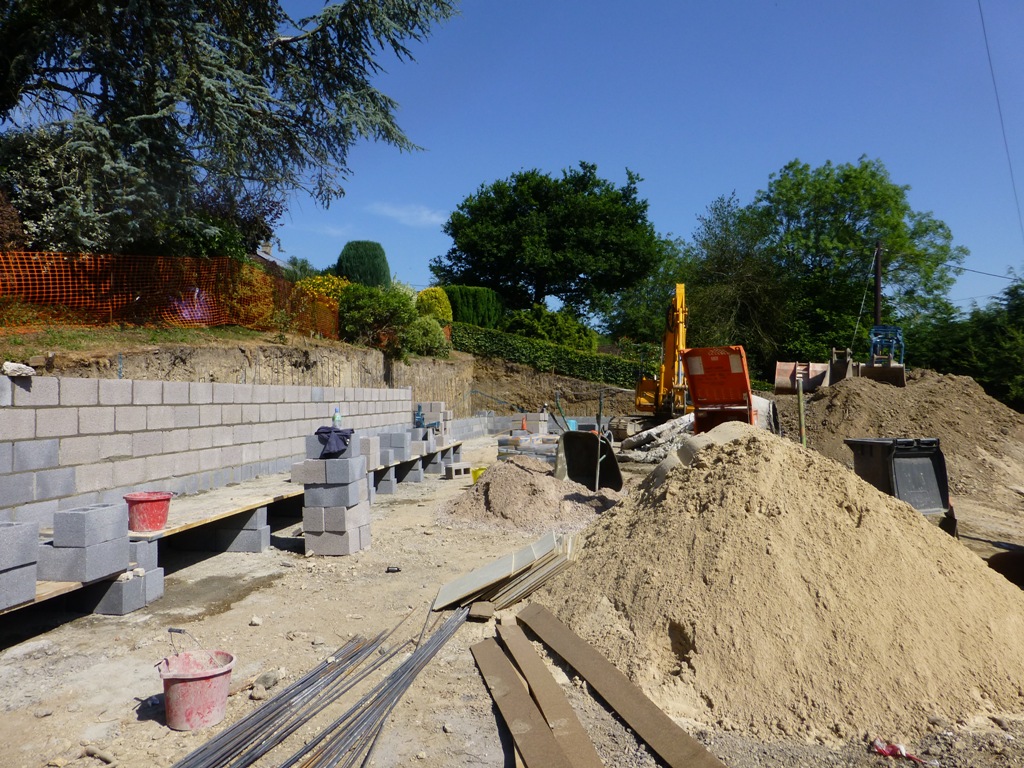

Jeremy Harris Posted April 26, 2020 Share Posted April 26, 2020 I'll add emphasis to the above. Retaining walls are very serious structures, we had to build a big one when we built our house. Any retaining wall that is more than 1.2 metres high MUST be designed by a structural engineer, or use an approved retaining wall product that has been assessed as being suitable for use in those circumstances. I'd also add that a critical factor will be the surcharge load imposed by the mass of the house - you cannot assume that the "45° rule" will be acceptable without knowing the exact nature of your soil, the surcharge load from the mass of the house and the nature of the house foundations. The latter could be pretty much anything, from almost no foundations (building on corbelled bricks was fairly common in older houses) to a deep trench foundation. The consequences of continuing to dig that bank away without understanding all the above could easily be very serious indeed, especially if we get a period of heavy rain. As an idea of what a proper block retaining wall, that has zero surcharge load (only supports a garden above, not the very much greater mass of a house) looks like, these are photos of ours. It's built from 215mm wide hollow blocks, double thickness at the base, with steel reinforcement bars running through the hollows, which are embedded in RC35 concrete. This wall is 430mm thick at the base, and sits on a foundation that is 500mm thick reinforced concrete, between 1.5 metres and 2 metres wide: 1 Link to comment Share on other sites More sharing options...

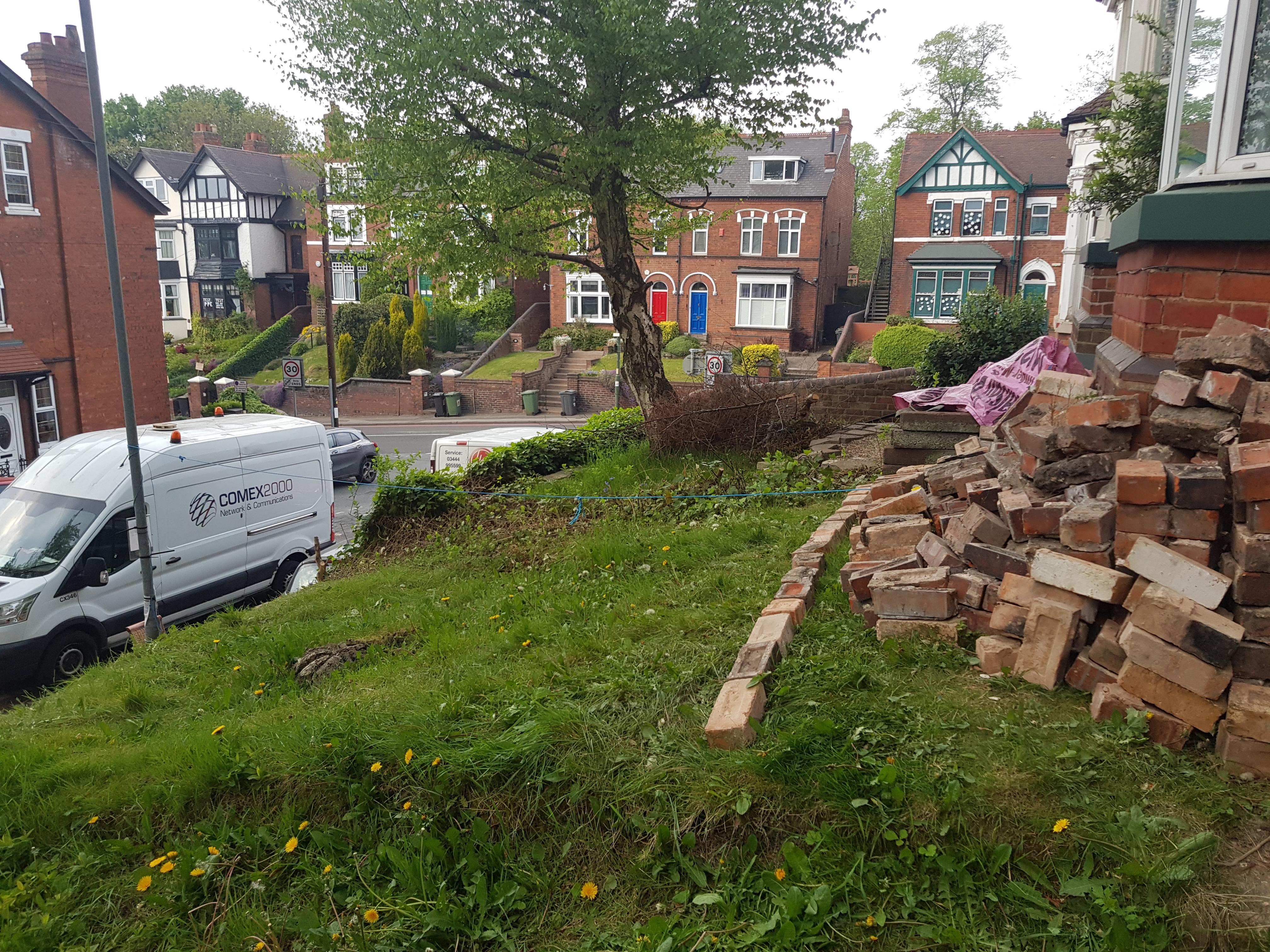

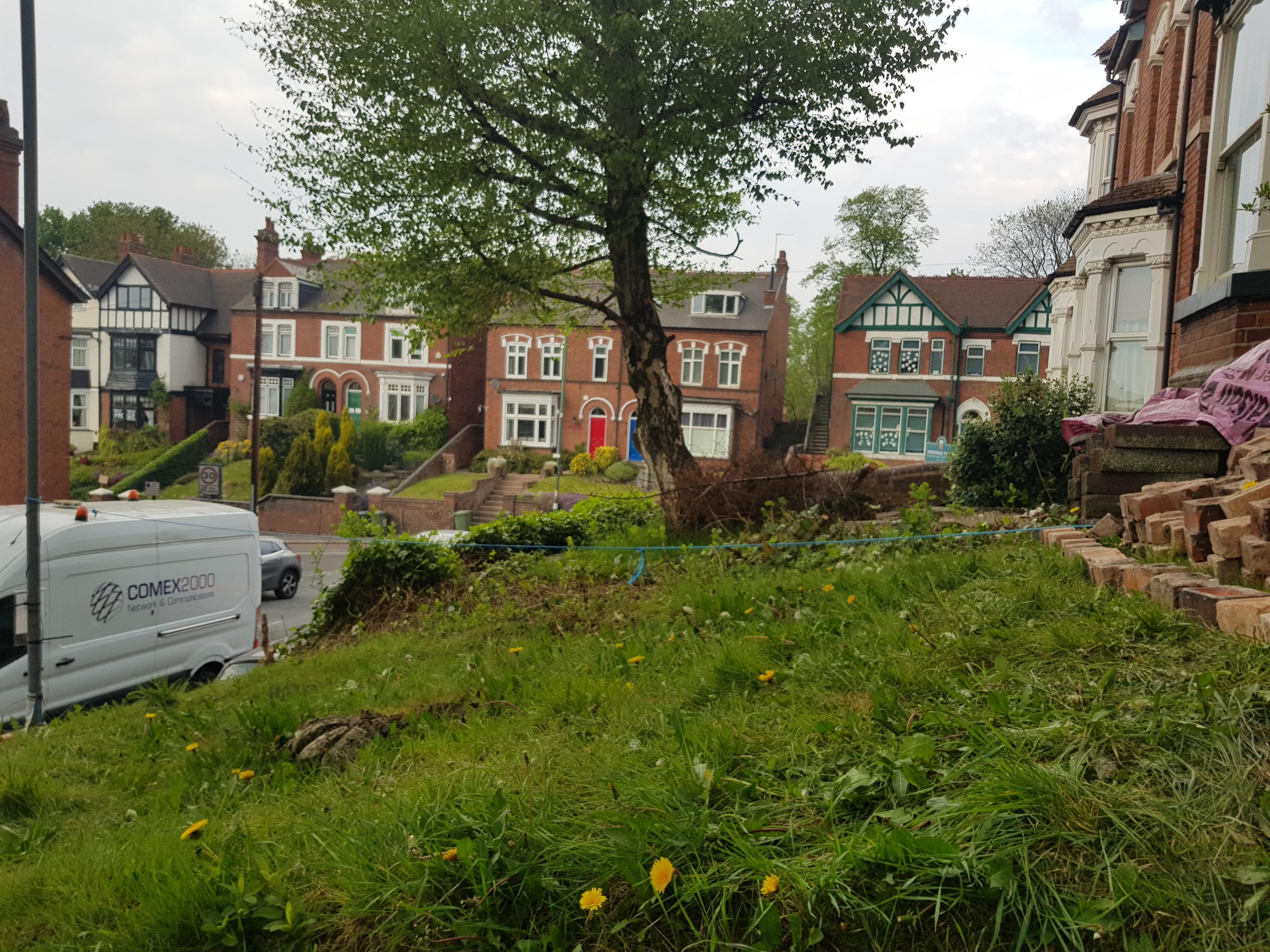

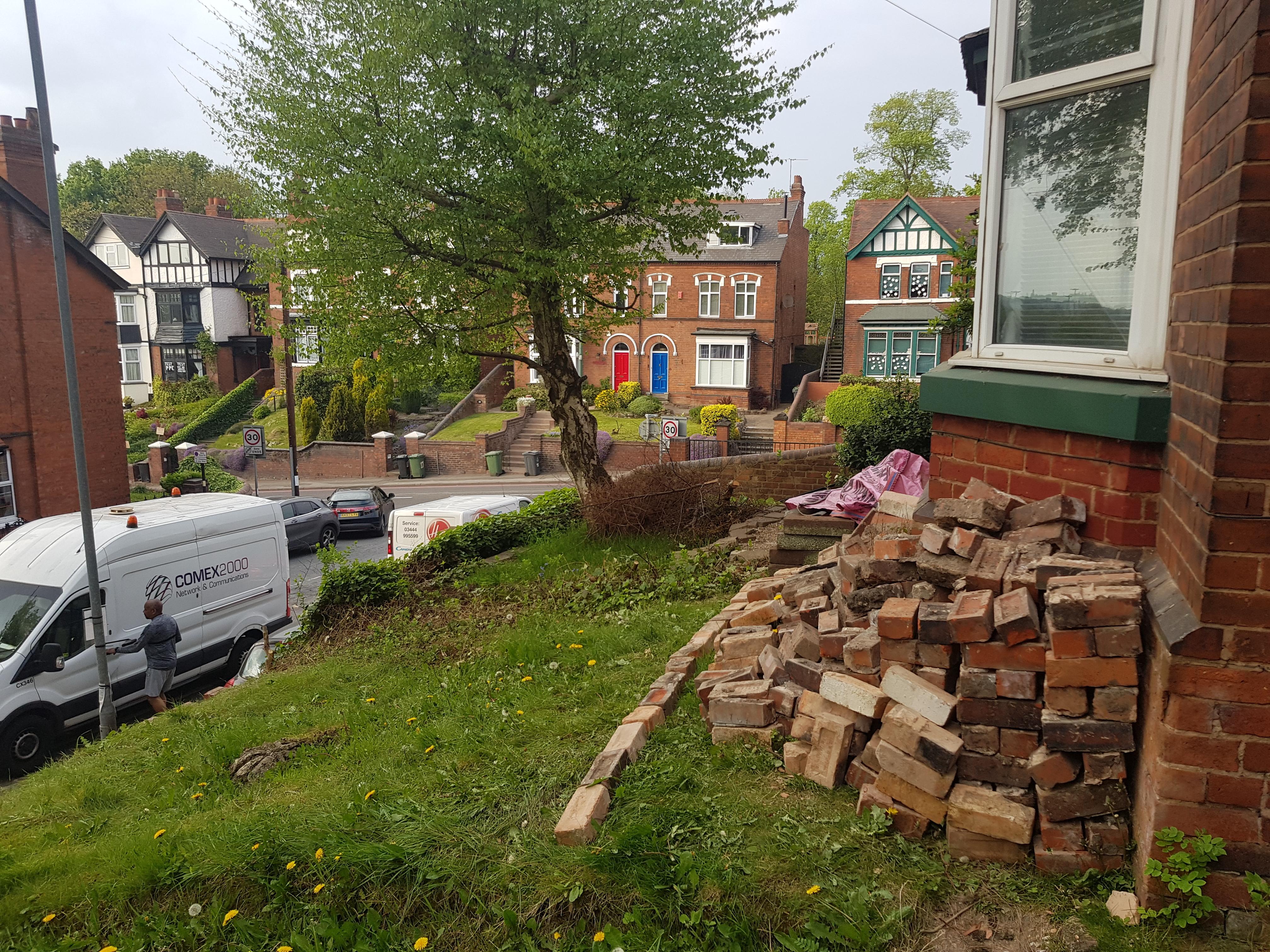

Margaret dailey Posted April 26, 2020 Author Share Posted April 26, 2020 Hi thanks all for advice. Budget wise is only a few hundreds for parts. All labour is free as my neighbours and brother in law is helping me. I respect your advice on here and if its the case i need a se then ill have to give up and stop everything. And leave the front as it now. Prodave, i have taken the measurements you have asked for. So from the top at the bay window, to the bottom at the boundary line, ensuring it stays high and level and straight, the distance was 29ft As for how high, i used a rope, tied to bottom of wall at bay window and ran down straight and tied it to the lamppost adjacent to front of house and then used a spirit level to check rope was straight and then messaged from rope down to footpath at boundary. On one side it was 9ft high and the other was 7.4ft high. And thats because of slope of fooftpath. So 29th length from bay wall to boundary And max height is 9ft. Link to comment Share on other sites More sharing options...
Margaret dailey Posted April 26, 2020 Author Share Posted April 26, 2020 Link to comment Share on other sites More sharing options...
Margaret dailey Posted April 26, 2020 Author Share Posted April 26, 2020 If you look at last 2 pics you can see the blue rope going from bay window wall across to lampost. Kept tight to give a straight line and then measurement taken down which was 9ft. Link to comment Share on other sites More sharing options...
Jeremy Harris Posted April 26, 2020 Share Posted April 26, 2020 6 minutes ago, Margaret dailey said: And max height is 9ft. That is going to be a very substantial retaining wall that's needed, it's very close in height to our 2.5 metre maximum height wall, so you can expect the design of a vertical block wall to be very similar to the one shown in the photos I posted earlier, I think. Very definitely not a DIY job at all, unless you have the skill and experience to design and build reinforced concrete structures to Eurocode standards Link to comment Share on other sites More sharing options...
